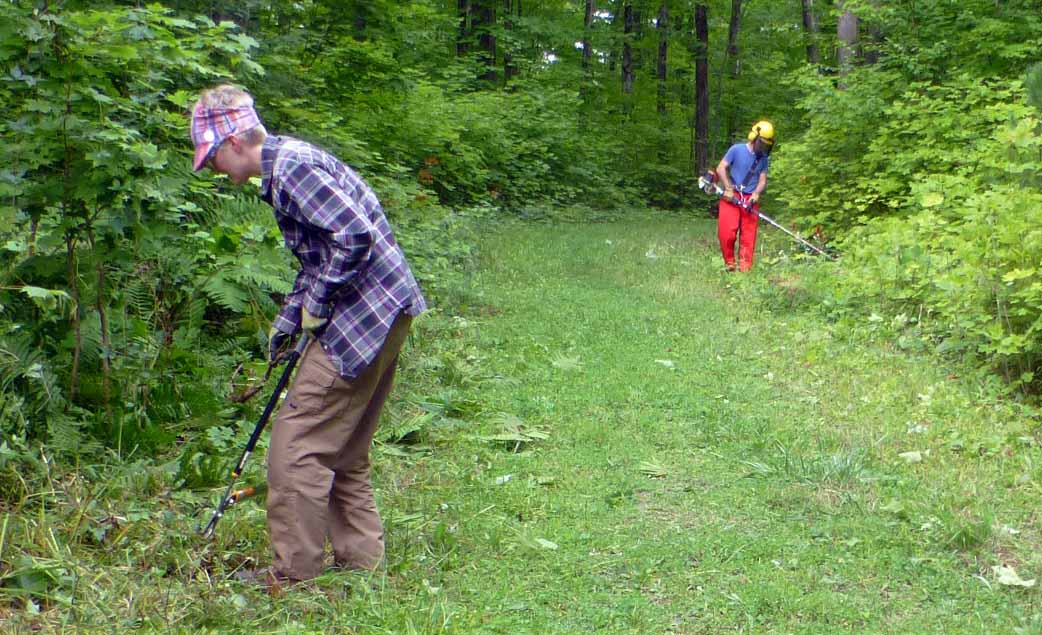

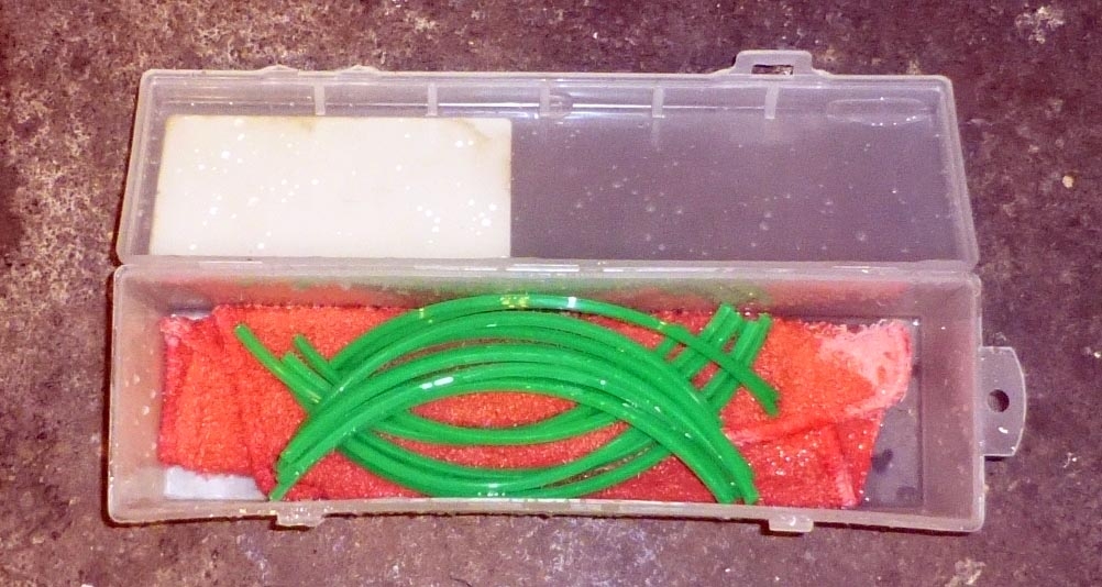

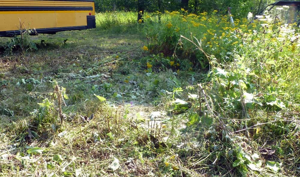

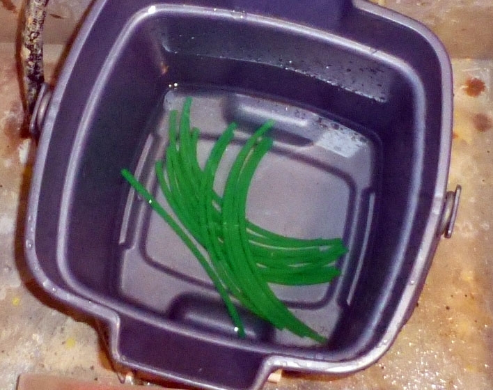

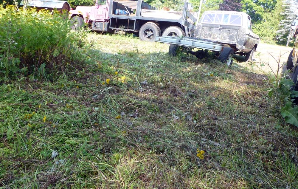

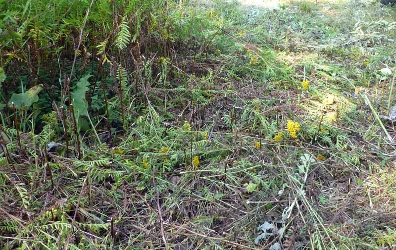

My Stihl dealer suggested that strings will do better if soaked in water so i put some in water for 24 hours (or 48 hour, can't recall which) then put them in a "wet box" to take to work. They did slightly better when cutting these weeds. No tree shoots in here.

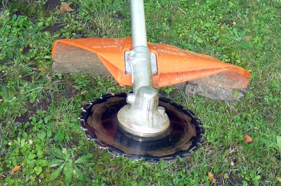

Also tested a new steel cutting blade for small tress reputed to "can cut thousands acres of trees with". When we cut small trees, there are hundreds of them. That means when you cut one, it falls over and keeps you from seeing others. Keep cutting along as best you can and visibility goes further down and trees you think we cut, are actually 90% off and can't be removed.
Conclusion. Limited use when have a thick growth of trees to remove. Limited usability at best.

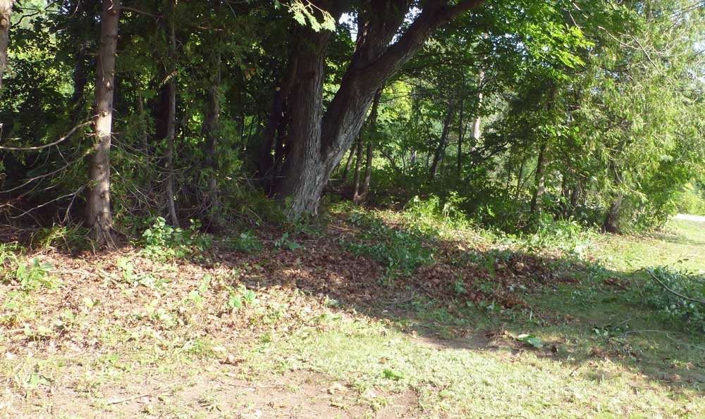

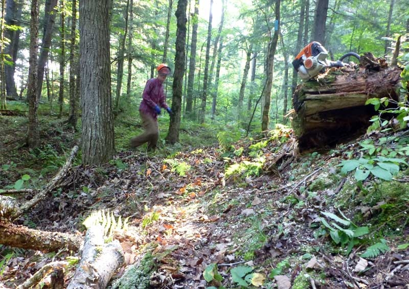

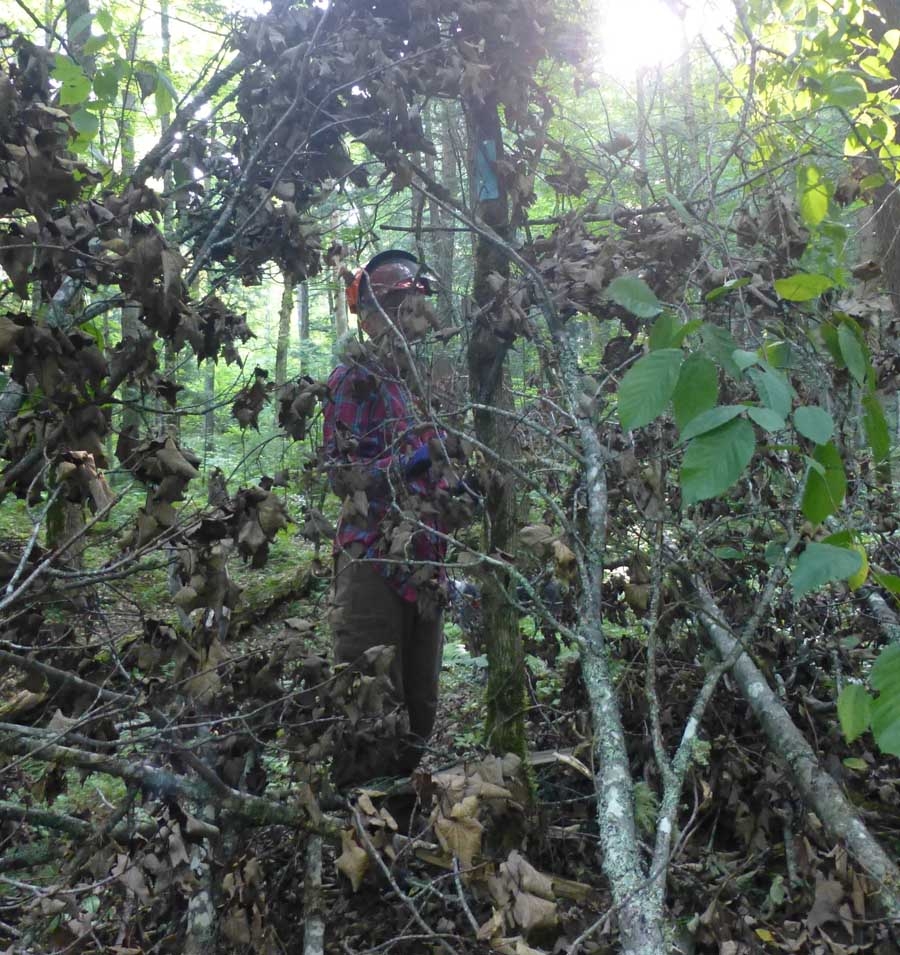

On the NCT over the weekend. Top photo is a tree that fell along the trail (not across) earlier this summer. Wally is on the trail and it ascends this hill. Last photo is its gone.

From:
STIHL Trimmer Heads and Line
"Actually, STIHL premium line will absorb 5% of its own weight in water. Trimmer line does tend to dry out over time and becomes more brittle. Storing it or soaking it in water will help reduce line breakage and make the line more flexible."

I use a 9" version of that with carbide chain saw teeth to cut sweet gum saplings out if my pines. It does larger vines and other stuff too. Have to take a smaller swath for sure. I tried an 8" one once and it didn't work nearly as well. Have you tried the one that looks like a 3-blade edger blade?

yes, used them for about 14 years.

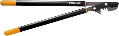

Our favorite Fiskar loppers dropped in price a LOT on Amazone. We've been paying $55 for the last few!
Fiskars 32-Inch PowerGear Bypass Lopper​
Pay $34.79 $33.63 after using available Amazon Visa rewards points.
/ trail clearing technique and tools #1,073
I love these, very easy and powerful to use.
Occasionally I put a nick in the blade by cutting hard dead wood :( but the blade is very easy to replace too.
#1,074
These and all loppers should be occasionally sharpened. If you guys are interested in that lll do a post concerning that.
/ trail clearing technique and tools #1,075
My fiskars are quite a few years old, never been sharpened, probably could use sharpened
/ trail clearing technique and tools #1,076
They should be sharpened, yes. They should also not be used on dry wood for the most part; dry pine doesn't seem to be a problem but these are a bypass lopper and you should use an anvlid lopper for dry wood of any significant strength like oak (or, preferably, a saw).
#1,077
When we are out in the field, we can only bring so many tools along and for loppers, that is bypass type. Sharp ones really cut well.
