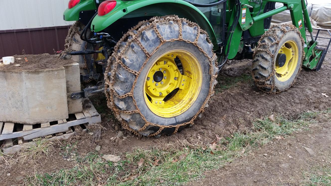

I run my talons loose, they seem to clean out better but I noticed that if I'm driving cross slope I have almost walked them off. I would make sure the tail chains and outer loops are exactly the same length. My instructions said I should be able to get a fist between the sidewall of the tire and cm the chains and that's how I have been running them. They are on 16.9-30 tires.

I know they say that but if they almost fall off they are to loose. I have 30 to 40mm on my chains and that works well. Can you tighten them more?

Well I have a fist under my 16.9-30 rears and it seems to work very well. I have only ever had problems on a side hill one time but that's about it.

My chains
I have a set like these, I believe they are "Norse" brand and they do need be tighter. Great in the woods not so much on the flat, very rough and we would have to constantly pull them back to centre to keep them on the tire. Now we are using a trygg chains, they run loose and have had no issues falling off and they are smooth on the road.
What works for one chain installation may not apply to another brand.

I adjusted my chains with success. In summary, the tensioner spacing and tension on the tensioner was consistently 2 to 5 lbs of pressure. Consistency I believe is the key.
For those who like to read more:
Inside fastener was put tight and adjusted so that the chain would be in placed if tensioned down strongly from the outside. No change here.
The outside fasteners was put snug but not supper tight.
The tensioners were adjusted with consistent spacing and consistent tension which was about 2 to 5 lbs. The tensioner spacing at the chain was not more than 20 inches apart. The more consistent for both spacing and tension the better.
To describe how tight the chain was put on, I could lift the tensioners with one hand and inch the chain into position on top of the tire with the other hand. Yesterday I drove up steep driveways and drove about 15 km on the road. The chains stayed in place. 2 to 5 lbs of pressure it not much tension but I have lighter chains for compact tractors. The heavier the chain the more zcenrafugicial and gripping force thus more pressure may be required. Hope this helps somebody else.
