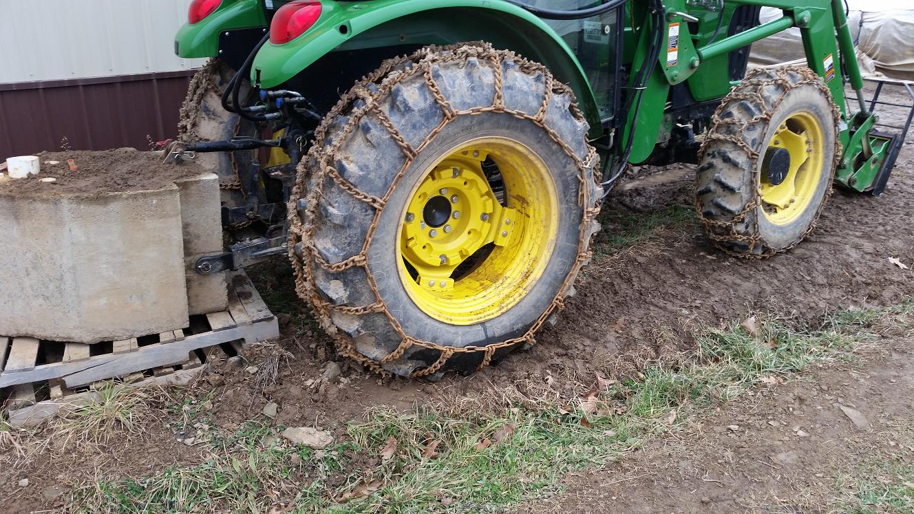

tire chains.jpg Here is a pic of my chains installed. Approximately 1.5" standoff.
