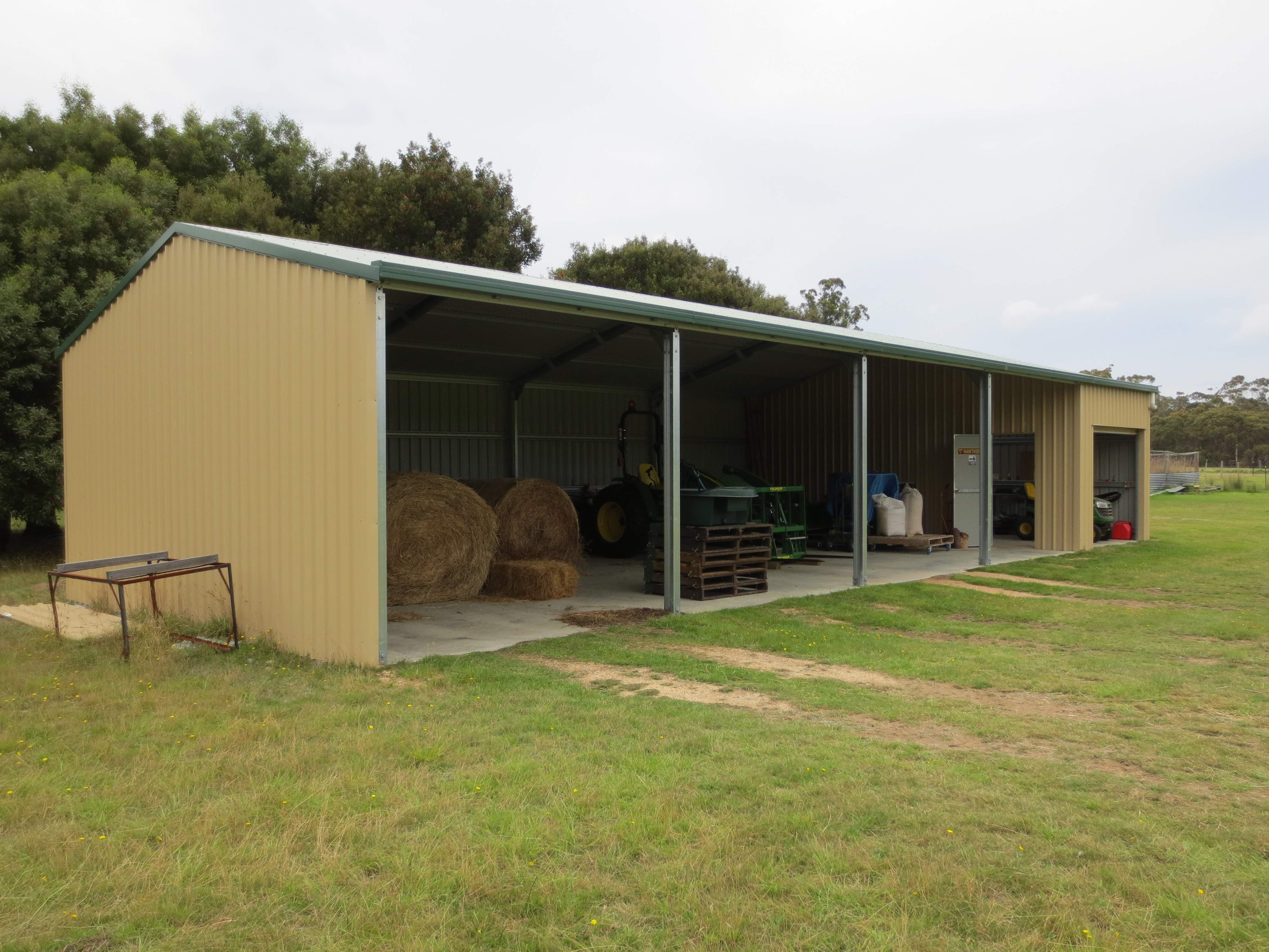

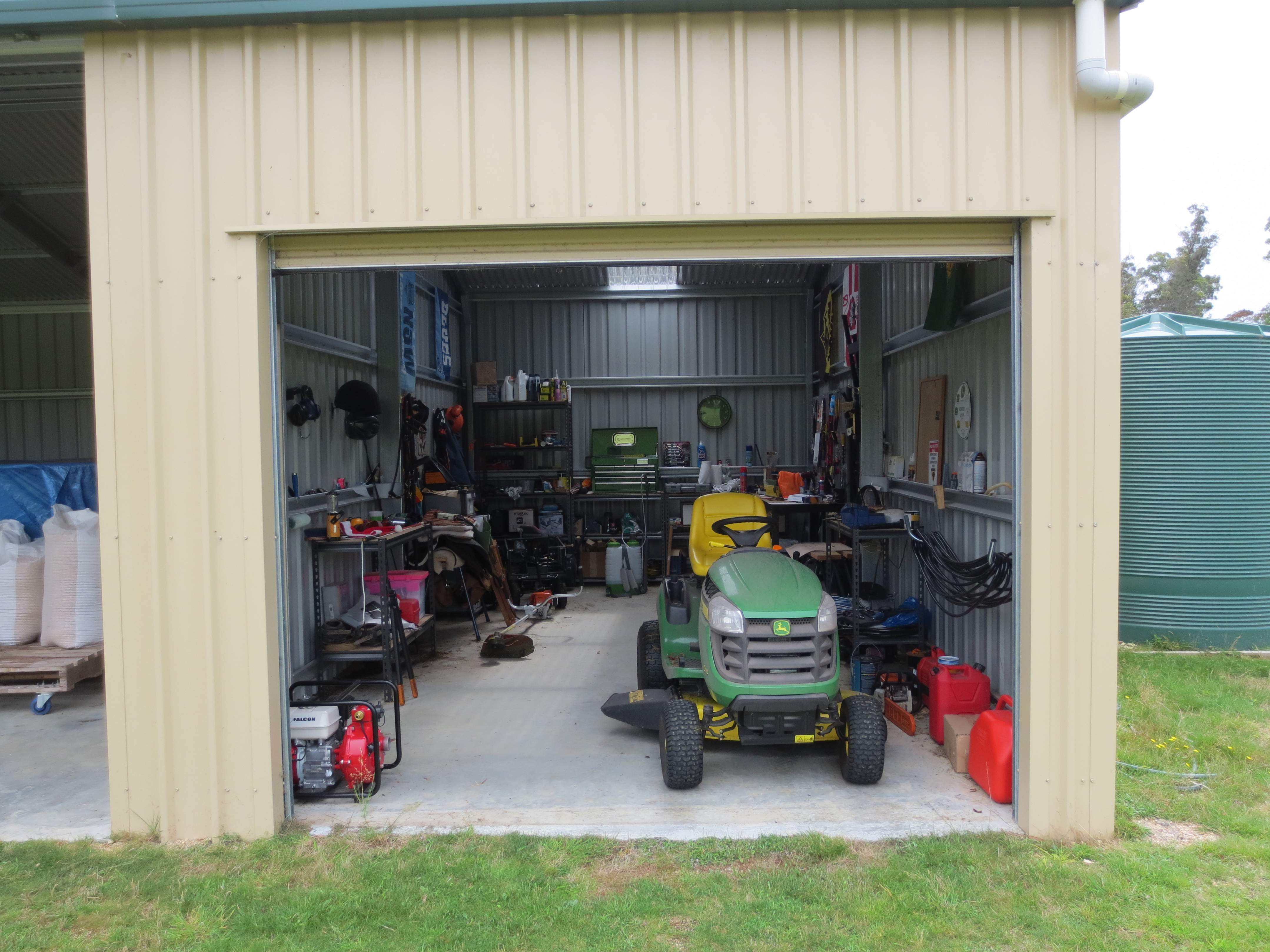

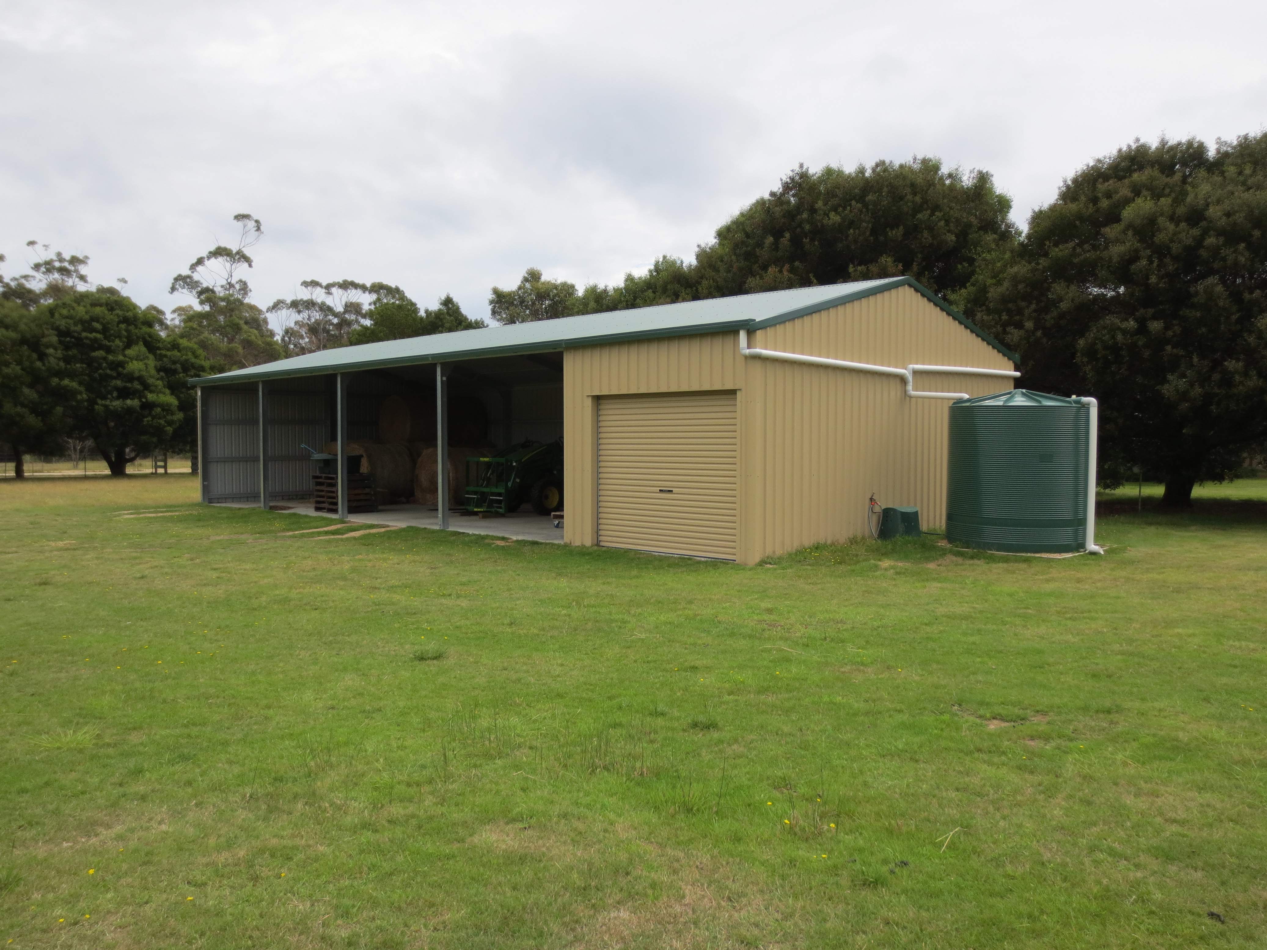

Personally, I went with the 'one stop shop'. The only thing that I had to do (although they would have) was prepare the site, which, with the help of my tractor/tiller/FEL-bucket I was able to do using nothing but my eye.
A competent 'one stop shop' does a lot more than simply erect the shed... (here in Tassie and, therefore other places) they'll submit all of the paperwork that the local council/government require for erecting. There's more involved than you might think as buildings are rated for your area's slope/exposure/maximum wind/snow-load/roof drainage etc...
The footings for my open 5-bay shed were properly set into the concrete pad = the shed as erected straight and true. I put in a 5,000 litre water tank for rain water collection + ran an extension cord from my house out to the shed to power the tank's pump and any power tools that I use. Nothing heavy that would require a 230v/3phase.
My shed is oriented facing South, to minimise sun entering, you, in the Northern hemisphere would/may want to face North, depending on your circumstances as predominant wind direction and average intensity would be factors to consider.
Natural light can be employed via 'clear' roofing panels or skylights.
