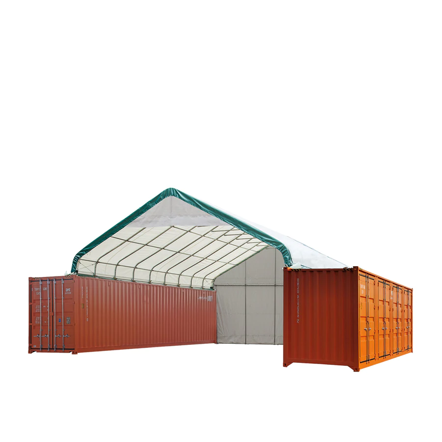

MY plan in the next two years is to place TWO sea containers / big steel boxes on the yard ...
- one 40 ft long High Cube sea can (9'6" high, 7'8" wide, 40' long) on edge of property - wind, water, rodent proof
- one 20 ft long High Cube sea can (9'6" high, 7'8" wide, 20' long) - wind, water, rodent proof
- parallel to each other, locking doors at the same end, sea cans placed 16 ft apart
- covered dome roof (ie: 32 ft wide, 20 ft long) over both sea cans, from the front, outside widths, far left to far right, for the length of the 20 ft sea can (goes to the midway point of the longer sea can), there will then be covered storage "shelves" at the top of the sea cans (9"6" ft high, 7'8" ft, for the 20 ft length) - for supplies, displays, man cave items, keep sakes ...
- security doors / swing gate / chain link, at the front end for the 16 ft space between the sea cans
- solid wall with high window (plastic) on the back side, offers security, privacy
- this 16 ft gap between the sea cans will be ample side by side parking for two of my vehicles (or whatever equipment)
the 40 ft sea can will be for general storage; and the 20 ft sea can will be for farming supplies, tools, work bench, car parts.
that's my plan, maybe it gives you some ideas also
(this image has a peaked roof instead of domed, and the roof connects on the inside edges, not the outside edges of the sea cans)
   / Help me Design Building for Tractors and Pickup #19
Nice idea, except why only 20 ft long, many pickups are longer then 20'.
Also with only 16' in width it will be a bit narrow for two full sized vehicles.
