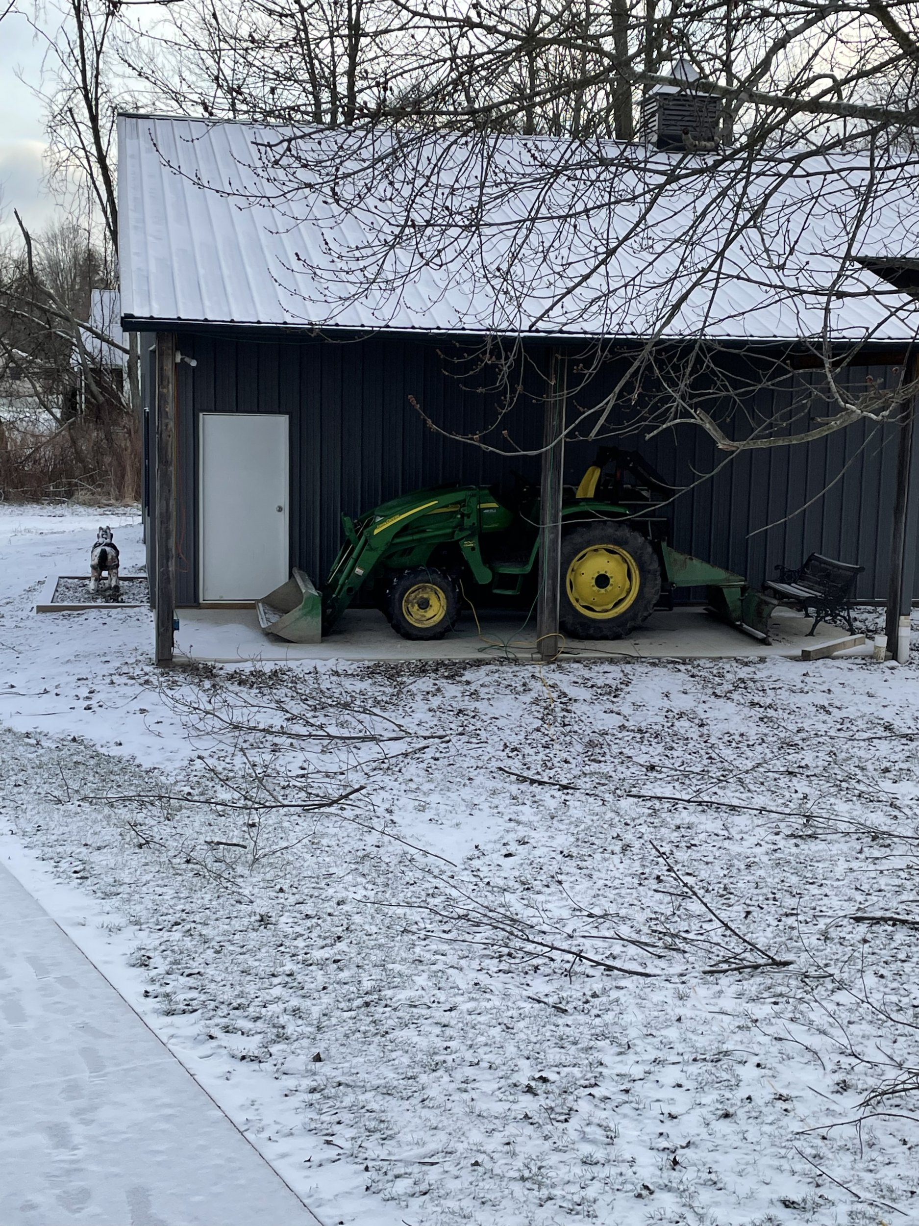

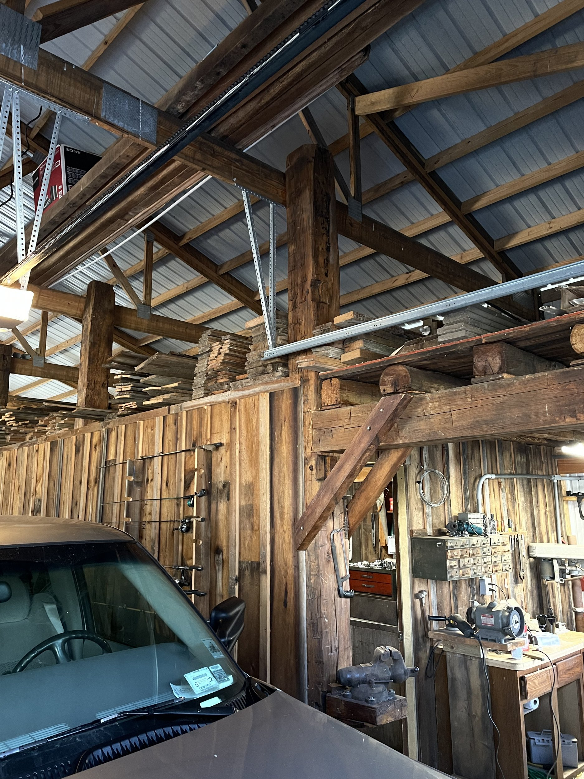

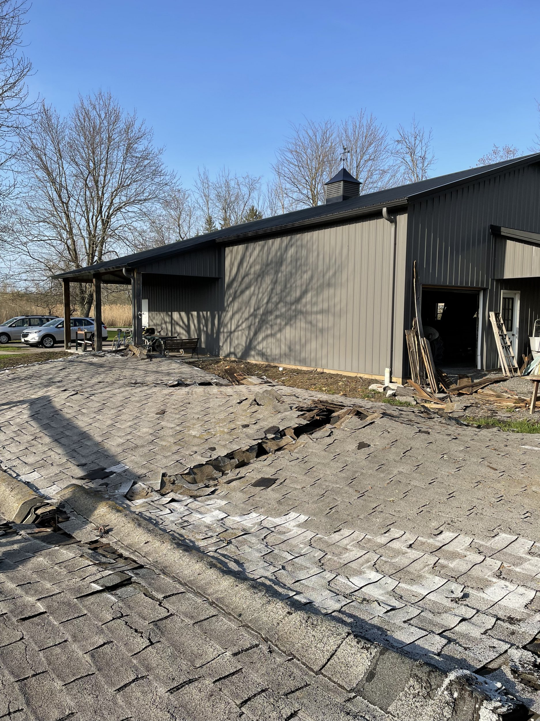

I put up a 36’ wide x 50’ long x 12’ tall metal sided and roofed building with (2) 10’ wide x 25’ long covered porches in 2018. Prior to that, I had kept all my “stuff” in (2) old 36’ wide x 46’ long x 16’ wall post and beam barns that my great great grandad had built in 1883.
Knowing how much room I had before, made sizing the new building relatively easy. I live way up north near the Canadian border and heat my house with wood in the winter. With those old barns, I had plenty of inside storage for firewood. Since taking them down, I have been storing that outside, on pallets and under tarps, which is not nearly as nice as it was having it inside of a building.
I had planned on using one of the 10 x 25 ft porches on new building for firewood storage, but I had too much other stuff that needed to be kept out of the weather. My new plan is to use some of the lumber, and wood posts and beams recovered from the last old barn that I took down, to add a 8 ft wide x 25’ long woodshed onto the back of the back porch, and enclosing that porch with salvaged barnwood.
I will roof that shed with green steel sheets that were used as protectors for the bundles of gray steel sheets that were shipped with the “Stockade” barn kit. The cost of that kit was $ 27k in 2018.
When that woodshed is complete, I should have plenty of inside storage. Most of the floor inside is gravel, except one porch has a concrete floor as does a 12 ft wide x 30 ft long interior area, under a loft. That area has a heated, enclosed, 20 ft long woodshop and a 10 ft long metal shop that is open to the interior.
For doors, I have (2) 9 ft wide x 8 ft tall overheads on the front (side doors don’t work well here in the winter with all the snow we get), a 10’ wide x 10 ft tall on the side (I use that to put my camper in over the winter and for my rops canopy tractor the rest of the year. I keep that tractor under the side porch in the winter, with the block heater plugged into an outlet switched from the house. There is also a 8 ft wide x 7 ft tall overhead door on the back and man doors on the back end and front side.
The 10 ft truss spacing on those Stockade buildings makes for lots of useful storage space up top of the loft that I made from lumber salvaged from my old barns.
Building this new barn has been a big project. I finally finished the wiring this past winter. I had been running everything off extension cords for a couple years, from a single 15 amp, 110 volt outlet. Now I have 240 volts and 45 amps out there.
So far, the new barn has worked out extremely well. I really like the gravel floors that I have over most of the interior, and I am thankful that I didn’t waste money on concrete for all of that area. No big deal when my old pickup truck or my antique Ford tractor drips a little oil, or my old boat leaks a little water from the live well, onto that gravel.
In three winters, I have not had too much mouse trouble. I have trapped 5 of 6, the last couple, using those little plastic folding traps, set on the floor in my wood shop. None have got into and made a mess in my old pickup, camper, boat, or tractor.

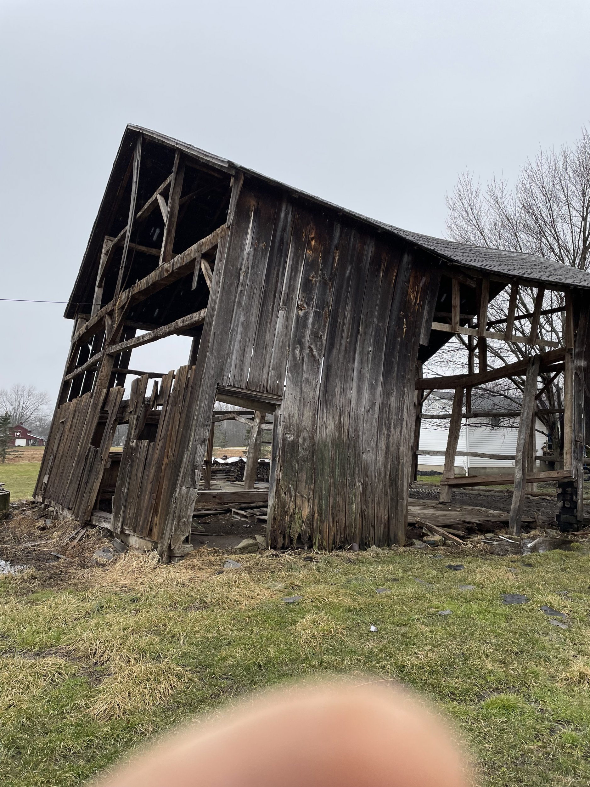

The only thing that I would have changed on my new metal building, were it not for the proximity of my great great grandfathers last old wood barn, is the size of the porch on the left. The old wood barn was in horrible shape. It was well beyond saving without investing a small fortune. It was leaning towards the side porch location on the new barn. When it did fall, it landed within an inch of the 25 ft long porch. The extra 25 ft of the 50 ft long porch that I probably could have had for another $500, would have been demolished by that fall.
Eventually, after I enclose the back porch and build a woodshed on the back, I will have almost the same covered space that I would have had, with the longer side porch.
Sentimentally, I would have liked to have saved my great great granddad old barns. Financially, it didn’t make sense. The foundations and the roofs were failing. The new one is much nicer for equipment storage and for working in, and it cost less than half of what the needed repairs on the old ones would have. I still have the feel of those old barns (and some of the best parts of them) inside the new one.
When I get a little farther clearing the rubble of that old downed barn, I hope to find the crane trolley and hay-forks that were way up inside, under the peak of the roof. I can fondly remember, when I was a young kid, and helped grandad bring loose hay up into the loft with those forks.
My memories of being a teenager, after he got a baler, and stacking those heavy bales up in that hot loft in the summer are much less pleasant. Just the thought of that makes me think “good riddance” to that old barn.
The pilgrims never designed that old barn for the increased weight of baled bay. Stacking them bales up in that loft might have built up some strength in me, but it weakened that old barn and contributed to the damage that led to its destruction. I used the same 6” square hand-hewn beams under the loft of my new barn, but twice as many, cutting the spacing in half.
