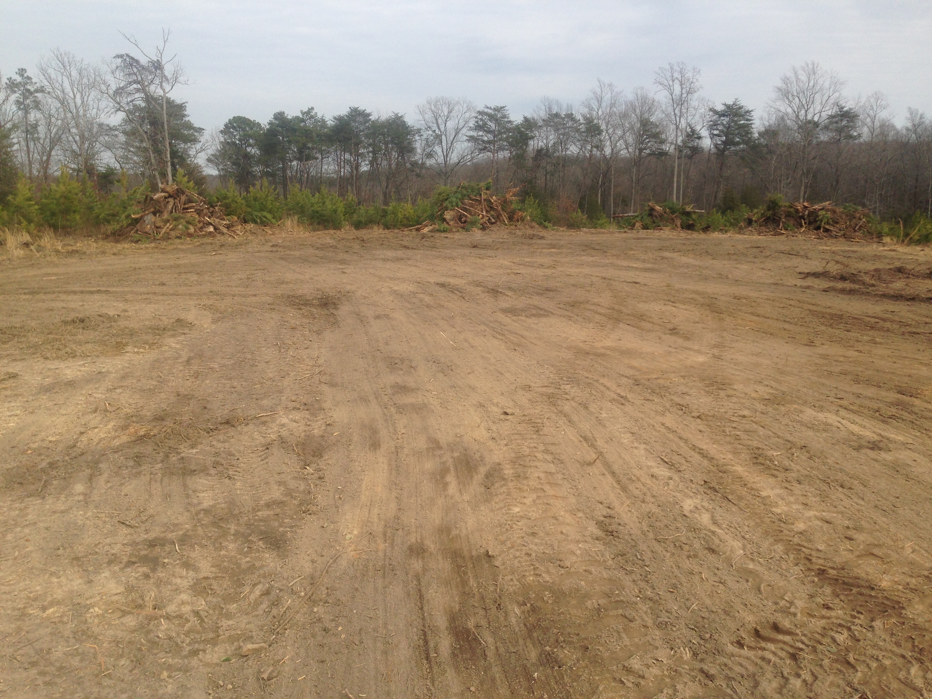

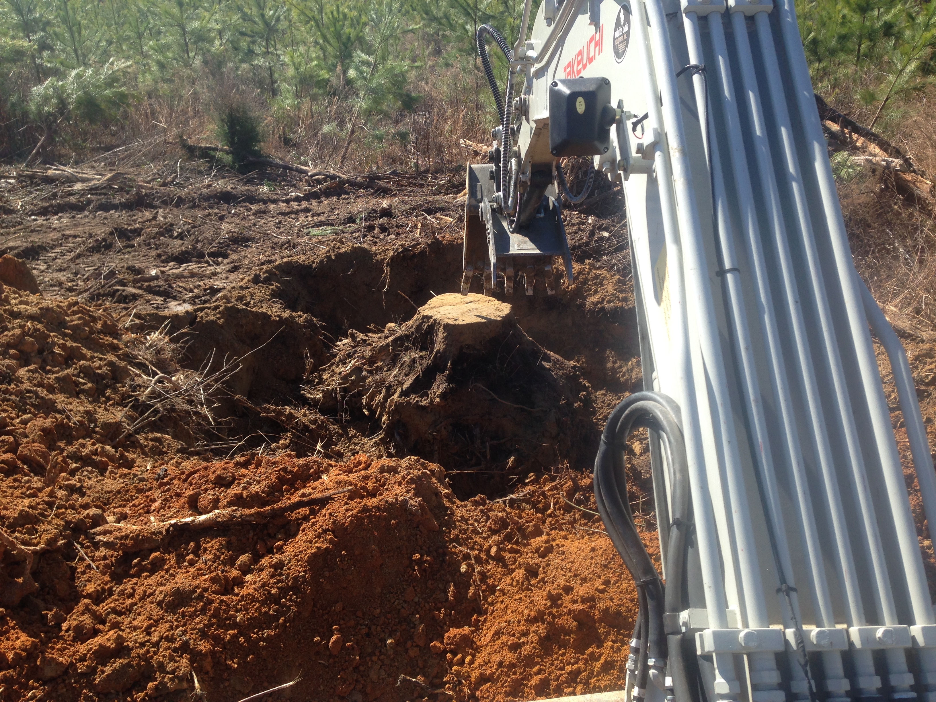

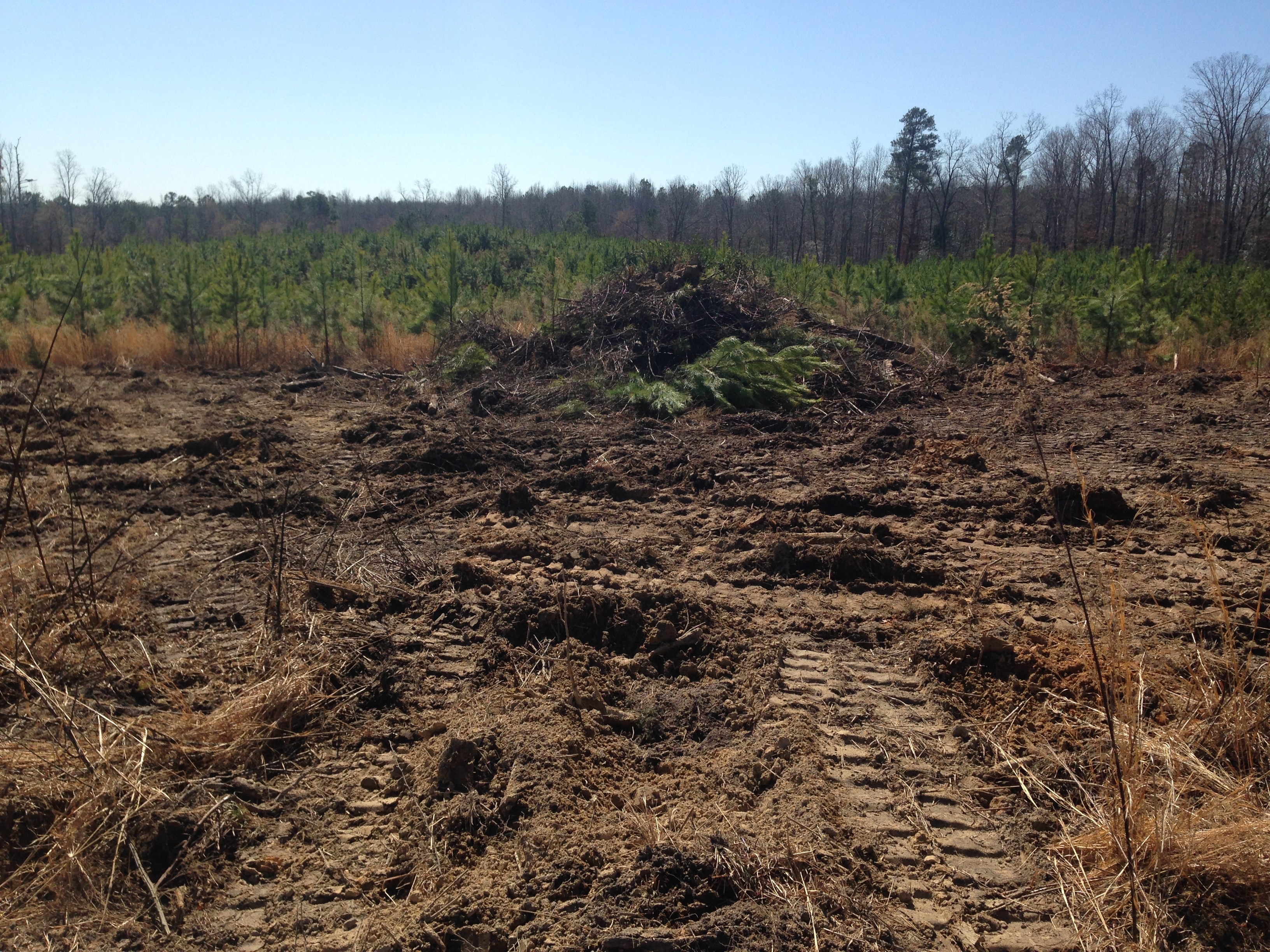

I cleared 2 1/2 acres with the biggest mini-ex I could rent with blade on it. I dug out big stumps and then used the blade to rough level everything. Then I used my tractor and box blade/pulveriser to do the final grade.
   / Subsoiler and Box Blade for Leveling Cleared Area? #15
   / Subsoiler and Box Blade for Leveling Cleared Area? #16
2 weeks straight, around 10 hours a day. I was vibrating for a couple of days after.
That's an impressive project. How long did it take? What's a pulverizer?

Yours are rotting. When I dug mine they were fresh. Took 35 to 40 minutes a stump. You will probably get it done a lot faster. Depends on how much you like running equipment. LOL
