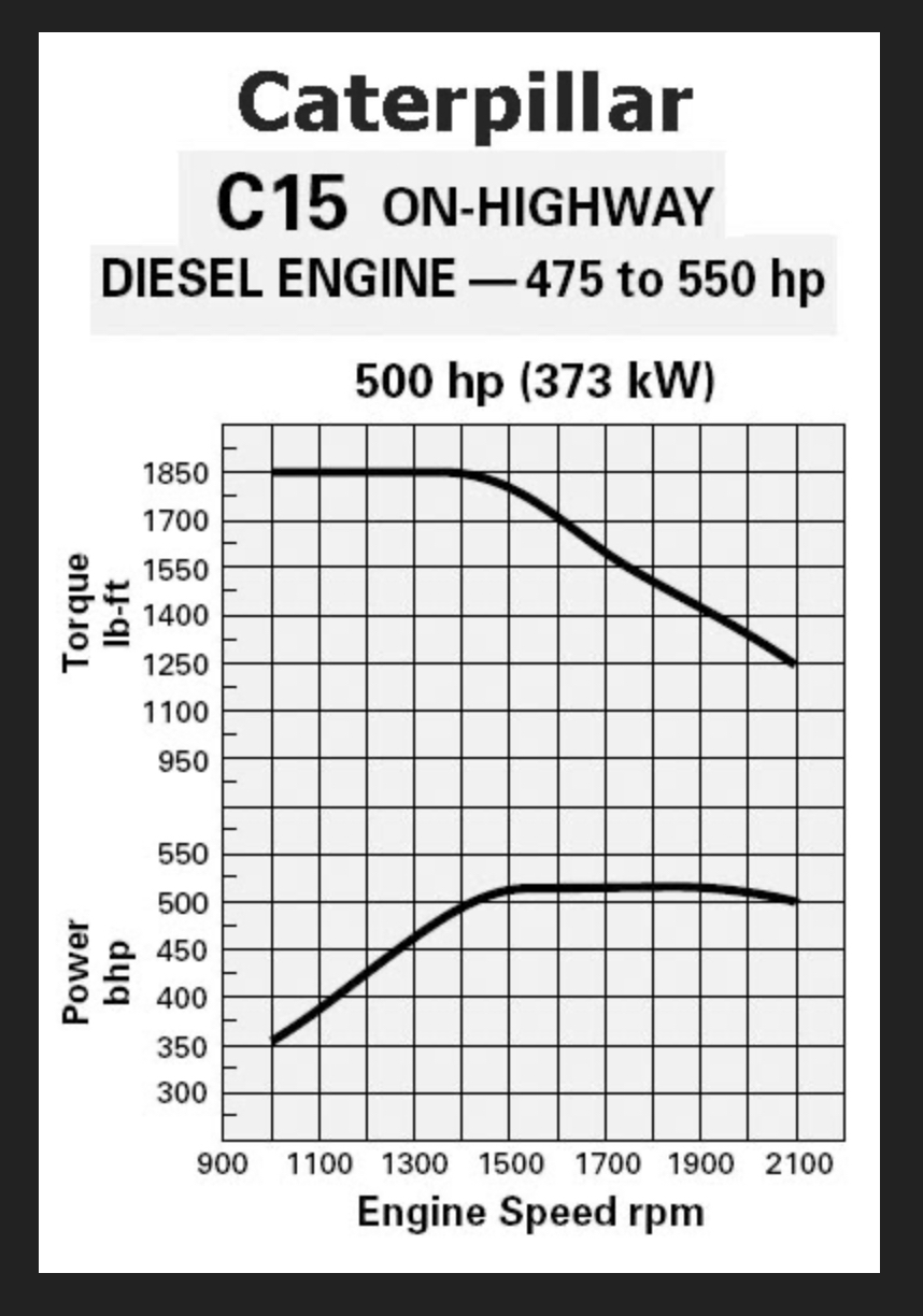

Your road tractor can make 1800ft-lbs of torque and lug a 128,000# load up a 6% grade at a road speed right......you think thats torque or power?
Well… according to the dyno, HP is falling off and torque is rising… yes?
IF my small Kioti, with its larger engine than some of its competitors, had dyno curves like the graph above (it doesn’t, I’m sure)… and I could compare that curve to a smaller engined tractor where the engineers concentrated solely on reaching 25 HP through rpm regardless of what that focus did to its useable torque curve… I’d choose flat torque over HP every time… which goes back to my original question… “why don’t manufacturers tout the real world differences between their tractors and the also-ran?”… instead of lumping everyone together under the 25HP tent…
Seems to me a valid selling point for some tractor makers…

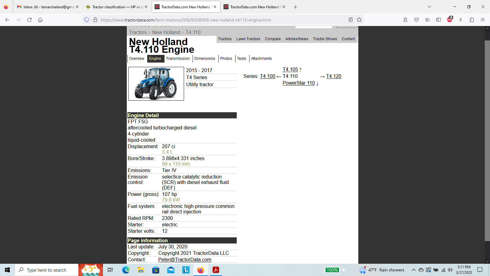

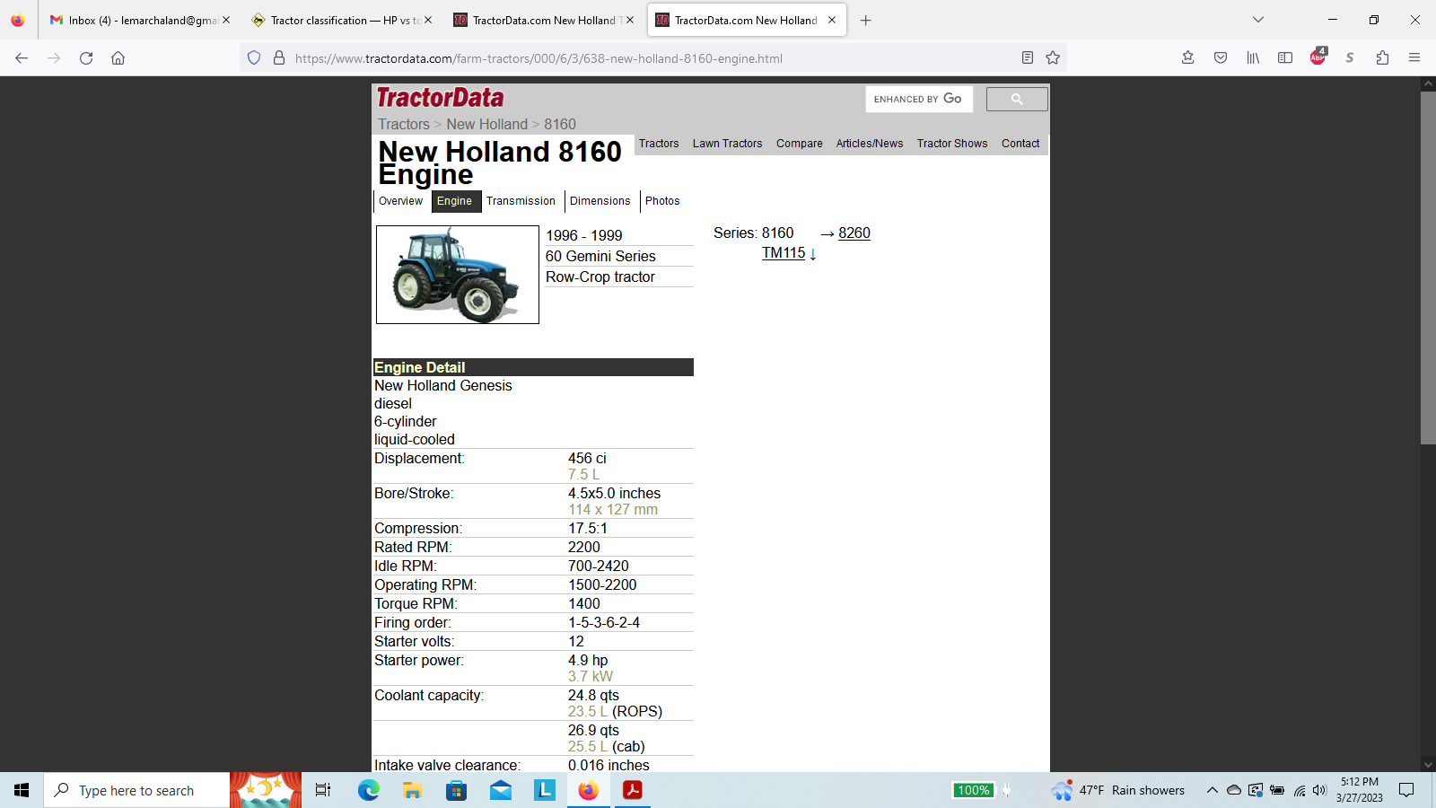

Two 90 PTO HP tractors from the same manufacture with completely different engines.
I much prefer the second one, myself.
/ Tractor classification — HP vs torque #54
Me too.
The Genesis (8160) can be a 40+ year tractor. The T4.140 is a fine tractor, but will die from it’s own complex design and a smallish engine pushed too hard.
I would say the Genesis Tractors were second only to the Boxcar Magnums as the most popular tractors ever built since the 80’s.
I’m an AGCO guy, but have a lot of respect for the Genesis and Boxcar Mag’s. Came close to buying a Genesis more than once.
I love my big Magnum primarily because of the big engine. You can turn the PTO hooked to a huge baler and it just takes it.

This is a dyno chart of one of the Cat equipped road tractors we have where I work (heavy construction)
I pull double, cement bulk trailers in western Montana… 128,000# give or take…
When I first drove this tractor, and came to “the hill” (6% uphill for a little over a mile), I would start downshifting, four or five gears, to keep the engine between 1,900 - 2,100 rpm which is at the peak of its HP range…
One day I got lazy… ok, I was “experimenting”, I let the engine begin to “lug” … and found the engine would continue to pull hard down to 1,100 rpm… I still needed to downshift a few times, but I didn’t have to keep the engine racing and the tractor/trailer climbed the hill at a greater speed than it would in a lower gear with the engine racing…
Which brings me back to the reason I started this thread… and I STILL can’t wrap my head around why it‘s HP performing the work when, in my experience, I see torque taking over when it comes time to do the heavy lifting…
As was pointed out earlier in the thread, two 25 HP tractors with two different displacements… seems to me the larger of the engines will generate more torque throughout a broader spread…
