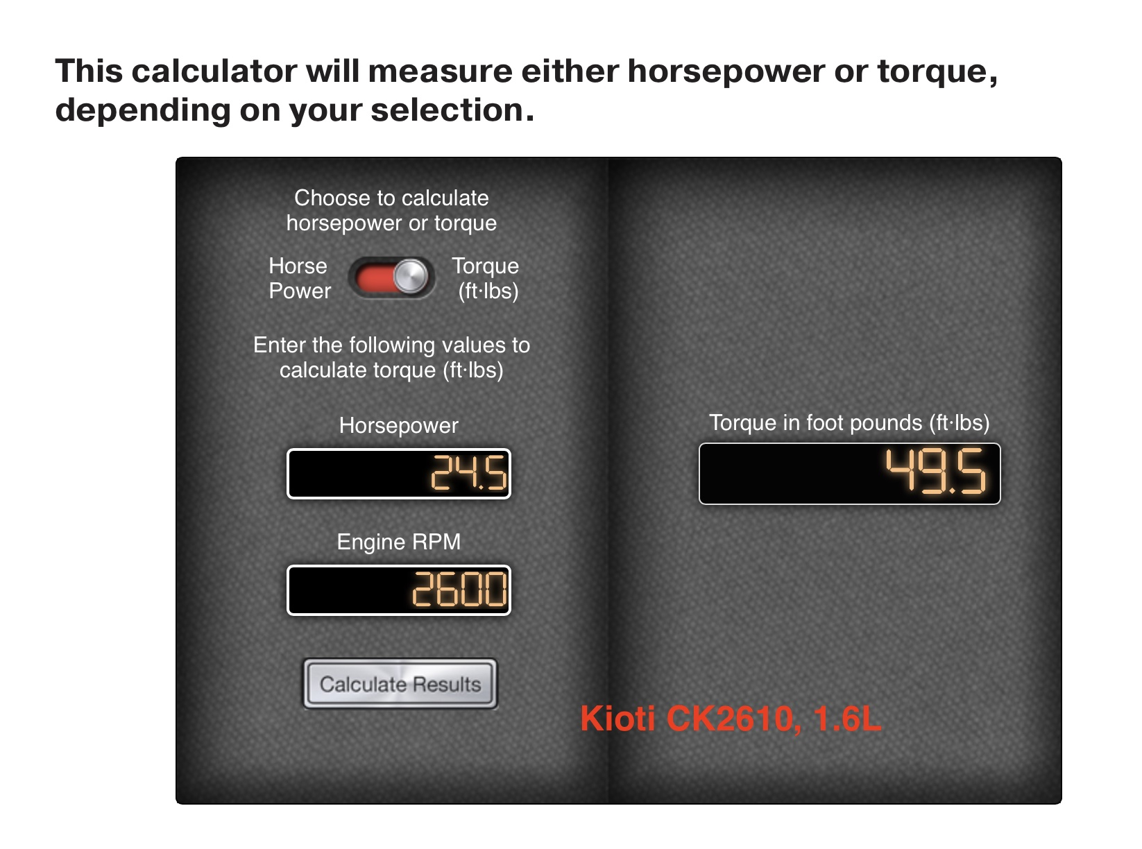

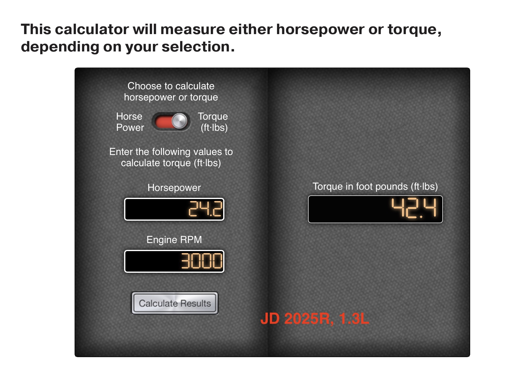

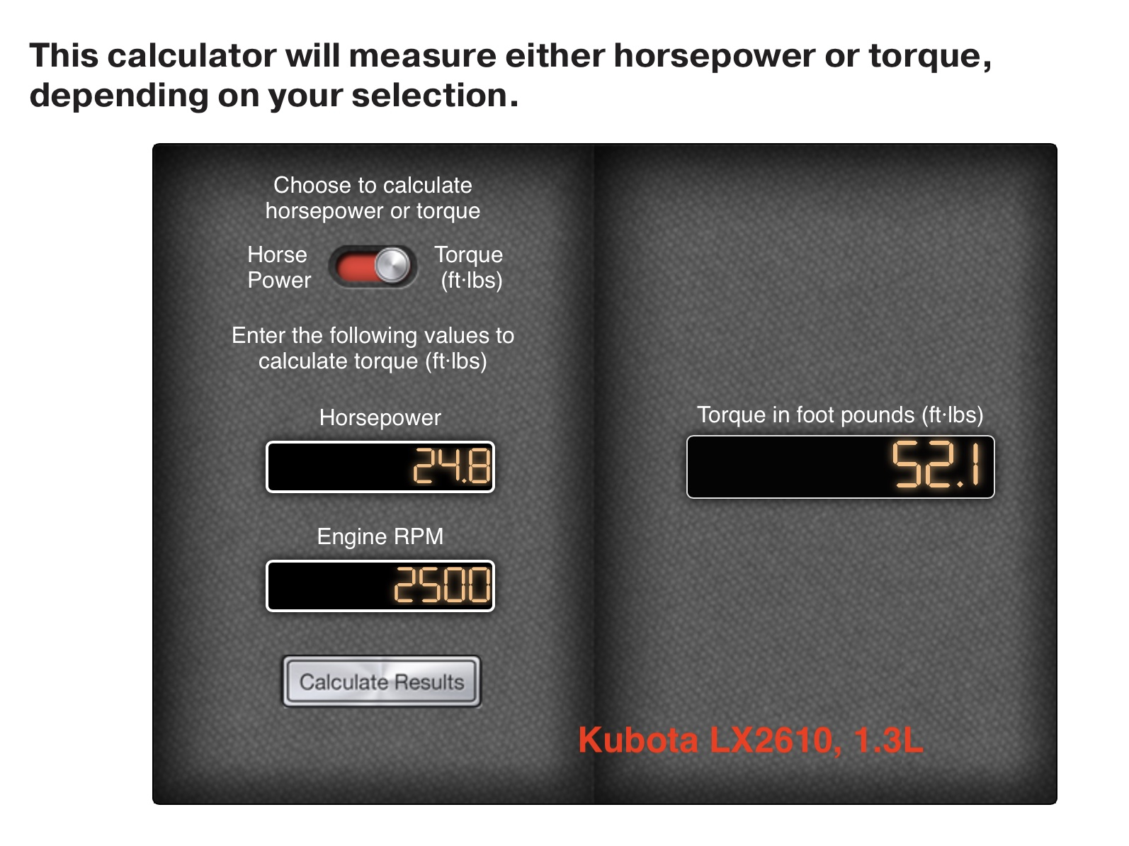

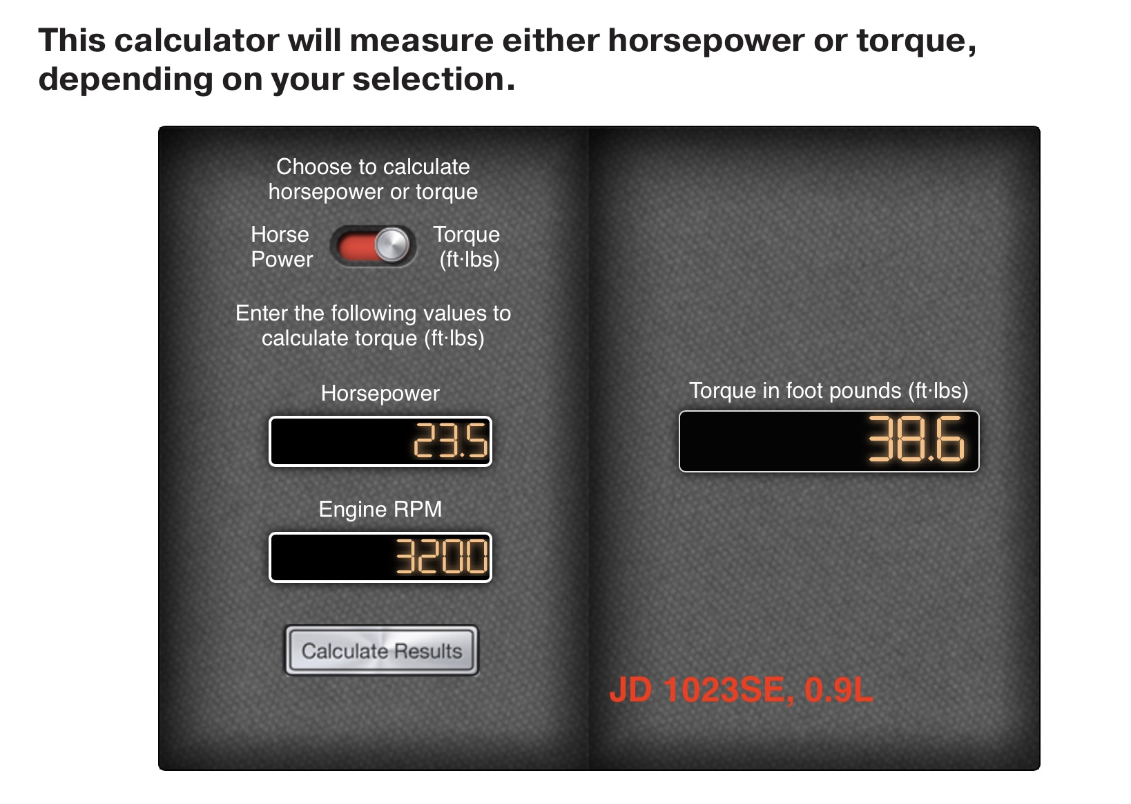

Well, that's a good example of the difference between "Internet lookup" versus "education".
Where did you get those calculators? …
Yes… you can find anything on the internet…🤓
This calculator is supplied by Spicer…Spicer Horsepower and Torque Calculator
It’s like dad always told me: “No sense talking to the monkey when you can talk to the organ grinder…” I figured Spicer knows a thing or two about multiply and handling Torque…
I don’t make my living on a tractor, I do hope to make my life easier with my purchase though.. That being said…
I come from a motorcycle background… each and every magazine road test I read comes with a dyno chart in the spec section of the report… observing the torque curve on various engines (in various states of tune) is revealing… the “torque spike“ (read: high HP) engine that’ll push a bike to over 180 mph on the banks of the Daytona Super Speedway will be utterly useless in a motorcycle that’s buried up to its skid plate in mud in the Tennessee outback… a “tabletop flat” torque curve would come in handy there… which is where, I believe, a tractors torque measurement might be a pertinent selling point…
of course there’s always the exception…
That's the point I hoped I was making - Apologies if my explanation was confusing.
I thought those calculators might be for something else than engines. So they are gear shaft torque calculators. They work well for calculating gear or shaft stress or any other place where you treat input torque as a constant and want output torque calculated.
For engines, where we are more interested in how we get torque as an input in the first place, it is the shape of the torque curve that matters. It can't be treated as a constant and give any useful info.
The formula is the same either way, but how it is used makes a difference.
