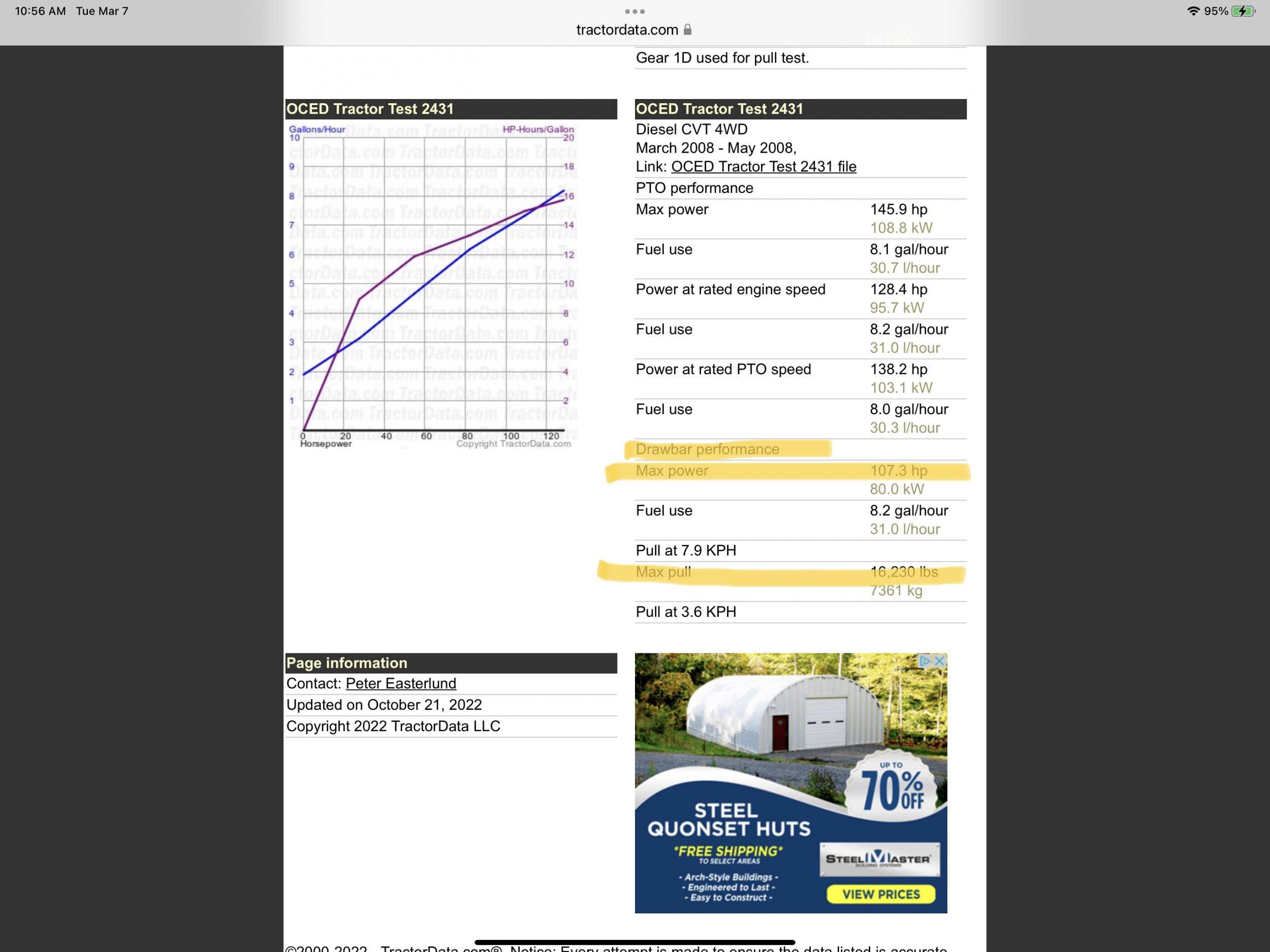

Some do give torque specs. Look on tractor data. I don’t really bother much with engine HP.
What you really want to look at for a measure of power is drawbar HP or drawbar performance.

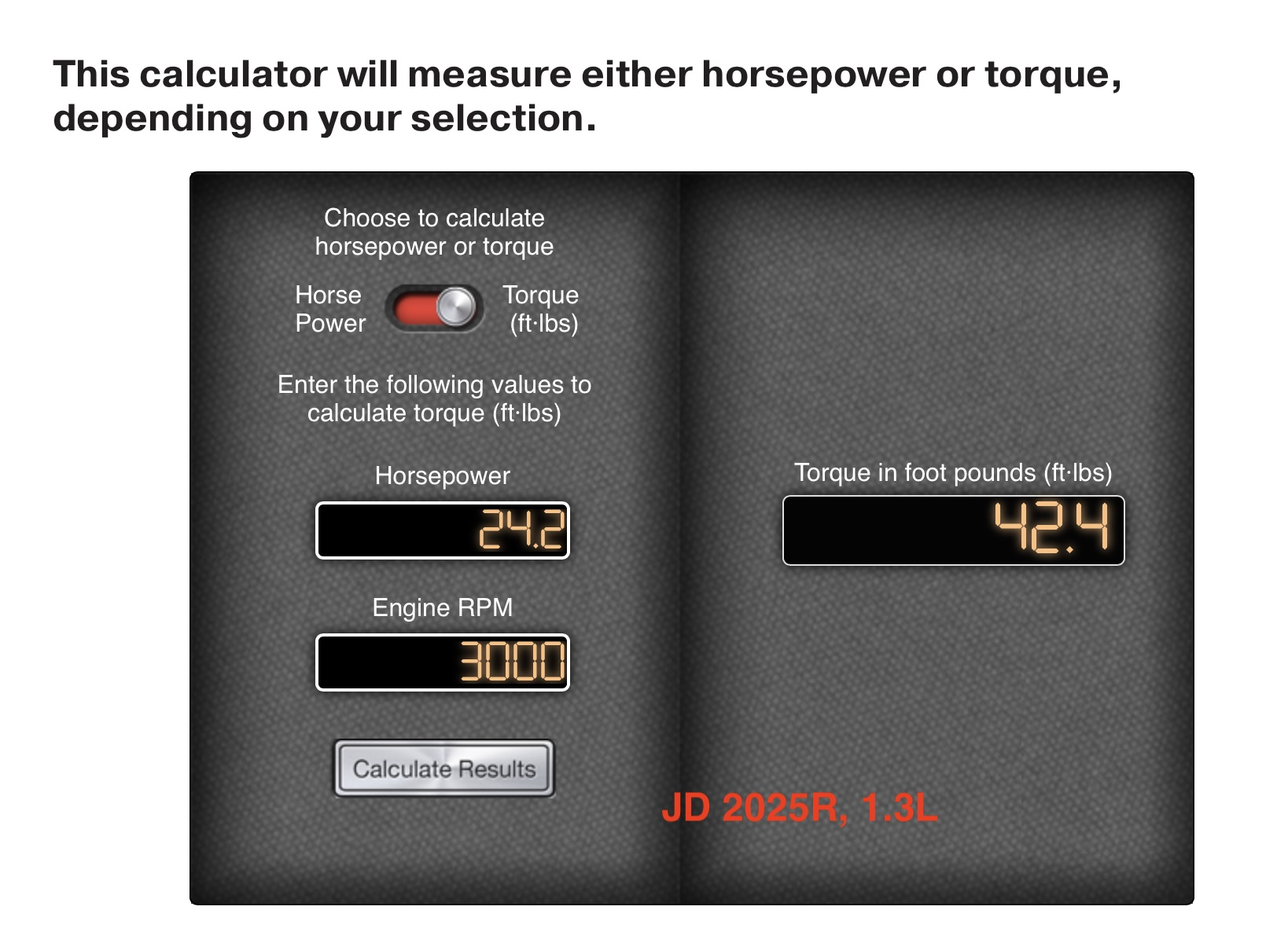

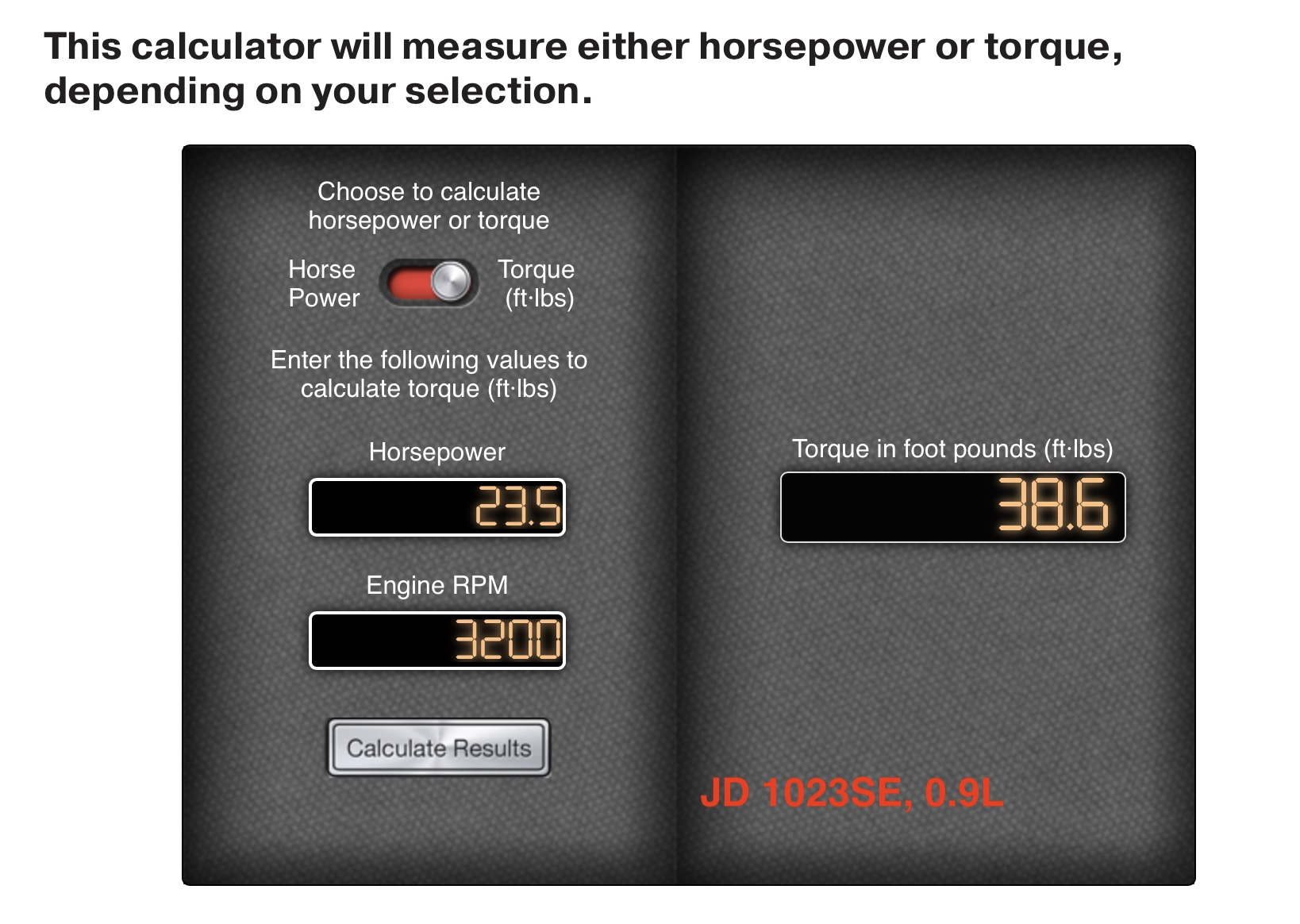

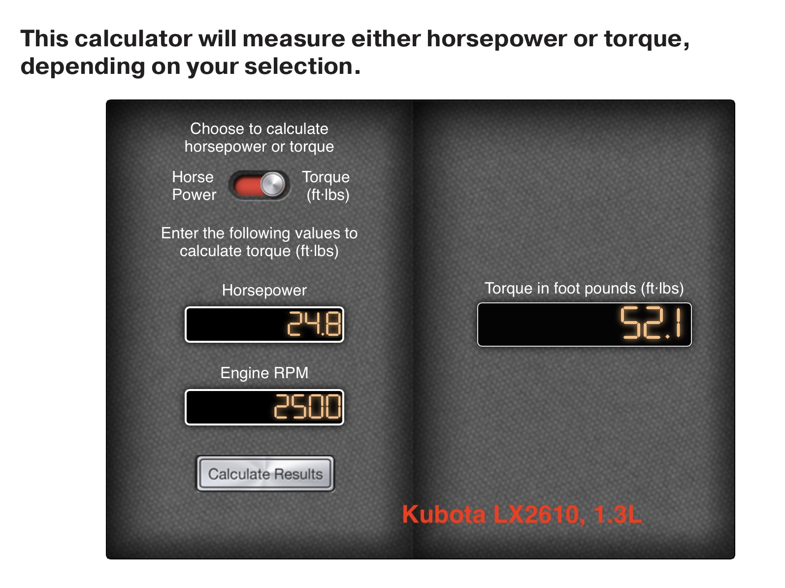

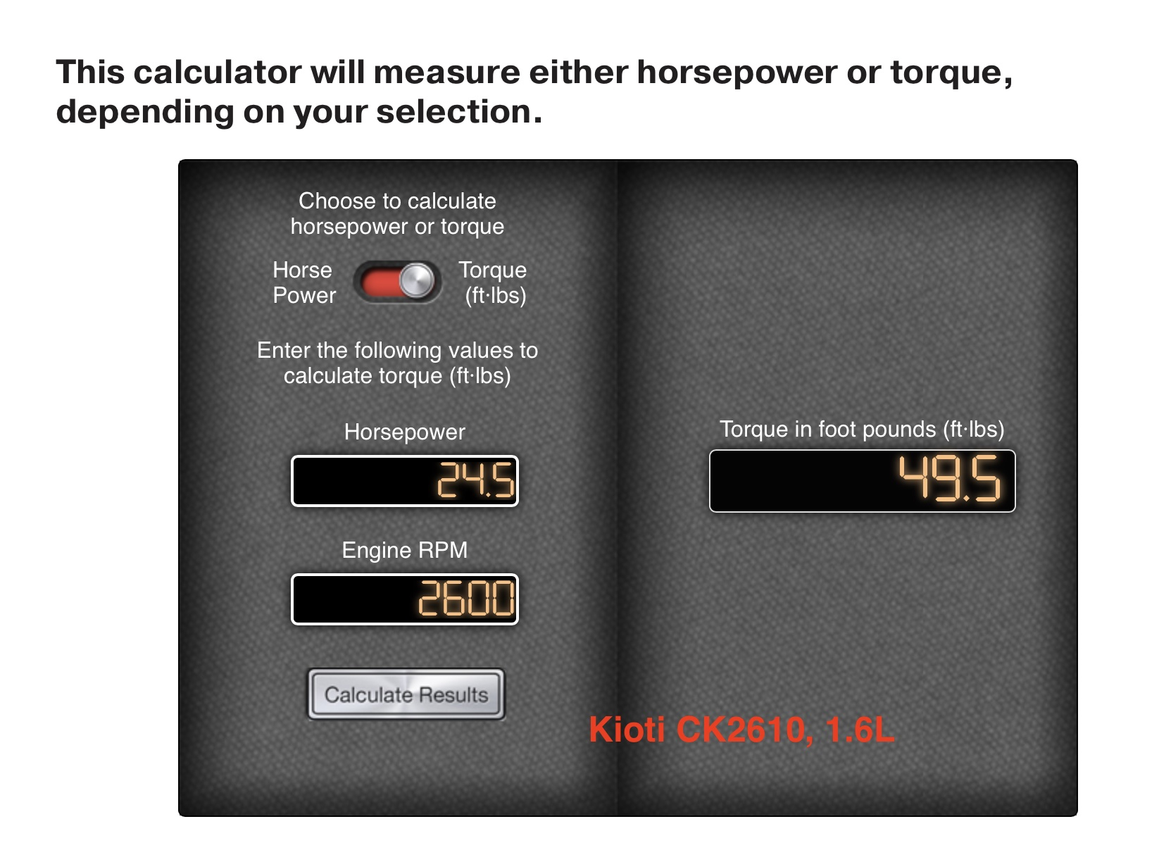

/ Tractor classification — HP vs torque
These four tractors are from the "25 HP" class... obviously of different physical size... Model and engine size I listed in RED... all the specs (rated HP, rated RPM) came from TractorData
Again, I don't get why Kubota doesn't tout their torque figures...

Yep. And that’s why I look at drawbar power first, since after all, this determines what the tractor will actually pull or drag.
If you are planning on tilling, dragging logs, freeing unstuck vehicles, pulling out stumps, etc. that is your go-to measurement on power.
If PTO implements is your need (mower, snow blower, etc.) then look at PTO HP.
I need both, so I try to select tractors that dyno (PTO dyno) well AND have high drawbar power.
What the engine makes on a engine dyno stand outside of the tractor is pretty irrelevant.
Well, that's a good example of the difference between "Internet lookup" versus "education".
Where did you get those calculators? The first thing that an engineer thinks when looking at the calculators is to wonder how they are defining a value for the torque? That's not an easy or intuitive programming problem. Torque is not flat, nor is it a smooth curve with RPM. It varies all over the place. And there isn't a standard for displaying it. At the minimum, there would have to be a catalogue of specific torque curves and some sort of look- up table for each and every motor at every RPM.
As to your original question, I think the value of HP is in salesmanship and simplicity. If your interest is in engine breathing, compression, gearing, and TORQUE.... you probably already know these things and are taking HP with a grain of salt & going for a look at the torque curve with rpm instead.
But there is no way that salemen or manufacturers are going to change.
