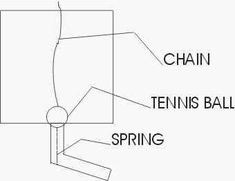

Maybe you could build something like this. Could be made out of wood or metal. Use PVC pipe, old tennis ball some light chain and a spring. If the tire starts to slip, pull the chain, and dump some sand on the tire. Let the tire deliver it to the road. I made the hopper square in the drawing, but slanted sides would be better. It could be as big or small as you wanted and shaped to fit the space. Carry extra sand in the back and refill as you need.
