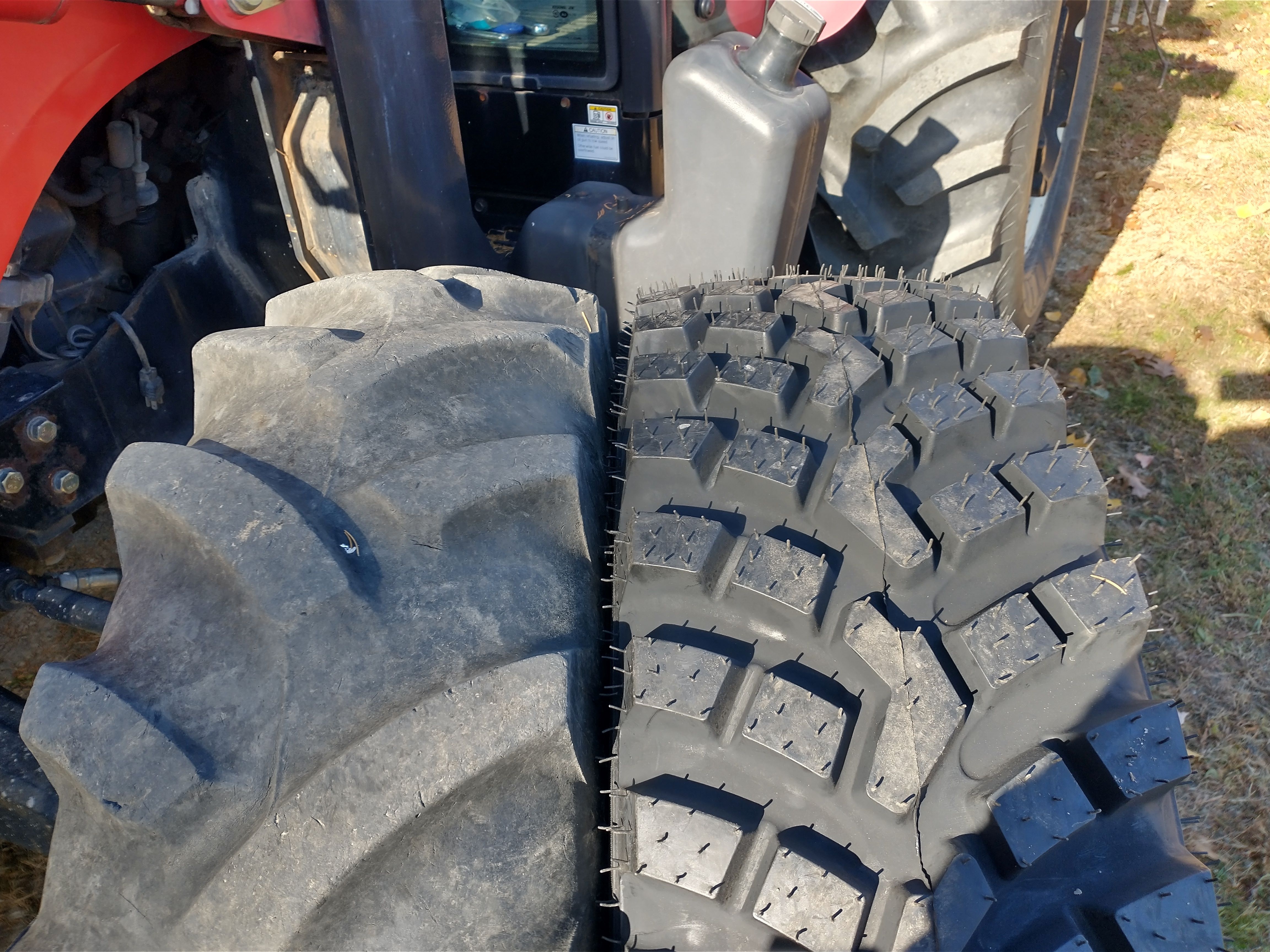

I switched one tractor over to BKT IT 696's.
I think they are a better choice then the R14's, I do have r14's on the little Kioti and they do good.
The BKT sitting side by side with the R1 it's replacing.
