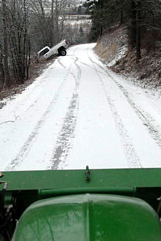

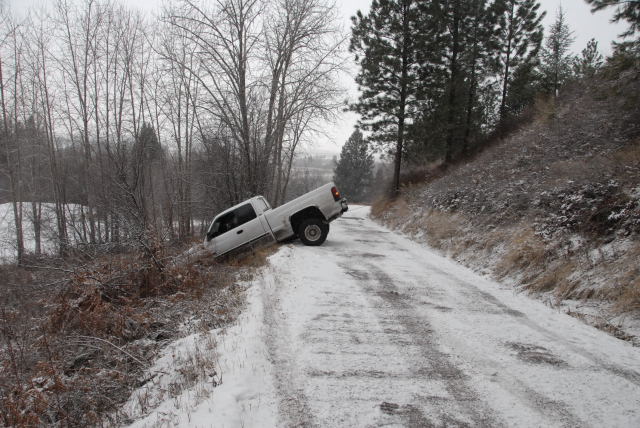

Sand, pea gravel, both work excellent. And, it is good for the other vehicles. This is what happened to my son who was too impatient to have it done after an ice storm. There was about 1/4" to 1/2" of ice under the 1/2" of snow.
It was much nicer moving vehicles and equipment around after the gravel spread (second picture)
