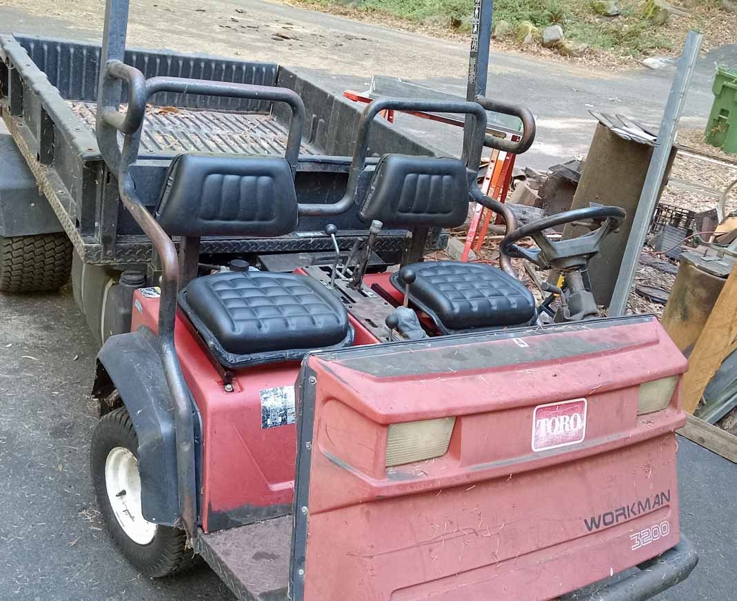

None of the ones I have seen, cab or open station have seat adjustments and use the same seats. If you are short or long legged, I guess they expect you to use a pillow behind you so you can reach the pedals! Adjustment would be nice, as I am almost a foot taller than my bride, and She always has to adjust the seat in anything we drive.

My Workman has the high range lockout switch, but it is disabled and the key is missing. That, plus the governor lead me to believe that Toro was trying to keep these machines from going too fast around the golf course. Employees will do some crazy things...
As for the dump bed, mine is over 300# and very sturdy. It has a Toro bedliner, and stake pockets if you want to use stakes.

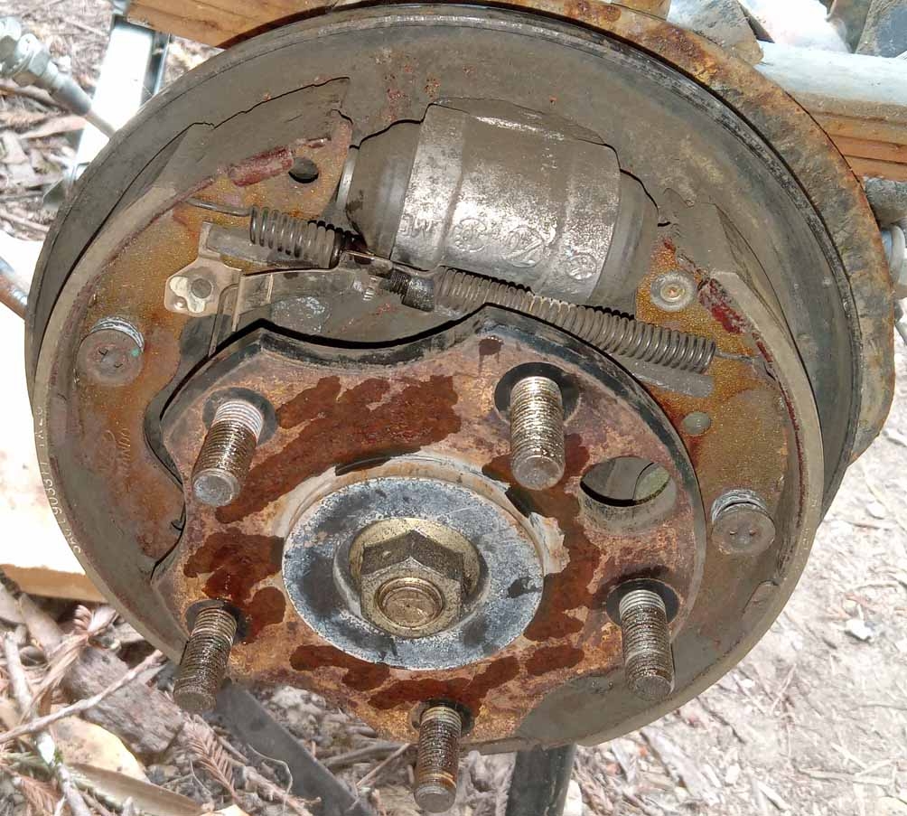

I pulled of the RR wheel to replace the tire. One lug nut was missing, and I could see the orphaned stud was not sticking out from the drum very far. Pulled the drum (with gear-puller).
Toro does not use pressed-in wheel studs; they use bolts! 9/16-20. So the one with the missing lug nut had worked its way loose, and collided with one of the brake shoe springs. The shoe adjuster on this side, as well as the one on the other side, are not turning. No visible rust. Gonna leave it alone.

Frozen self adjuster's are a common thing. I would have pulled it and added some penetrating oil, maybe heat... to get it free. Saves having to pull it down later when the brakes get out of adjustment. Brake issues seem to be pretty common on these Toro's. My White/Yellow cab had no brakes at all when my buddy unloaded it. He has sense gotten them to working welll enough to stop it, but it will need further work in a short time.

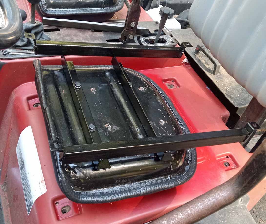

Well, it is about ready to sell.
I fabricated brackets and installed the 2-piece seats I bought from India (about $150). They look good and feel adequate. I was looking at over $600 to buy them from Toro. Plus the missing brackets.
Seats look a little funky but do serve, plus they are built on steel pans, instead of the OEM plywood.

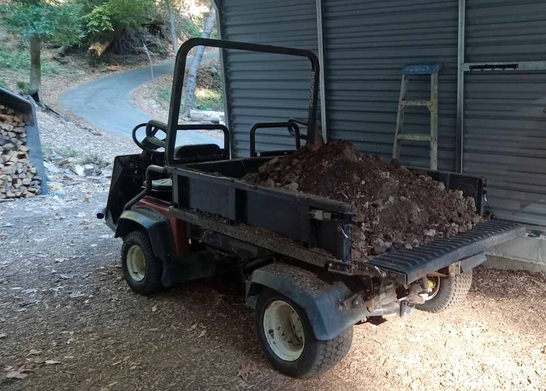

I love this machine.
I put a ton of dirt into it, then went and dumped it. The hydraulic dump that uses 2 cylinders had no problem lifting. And power steering is great.
Traction is a challenge for any unpaved hills, however. Even with the new tires I installed. Needs 4x4 around here.
