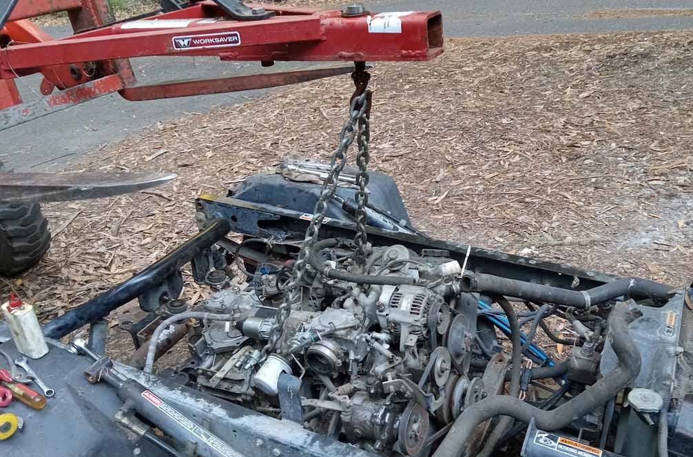

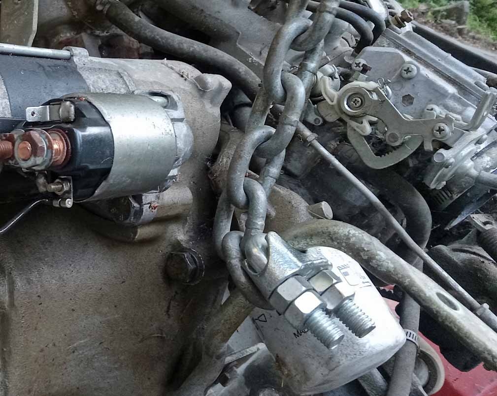

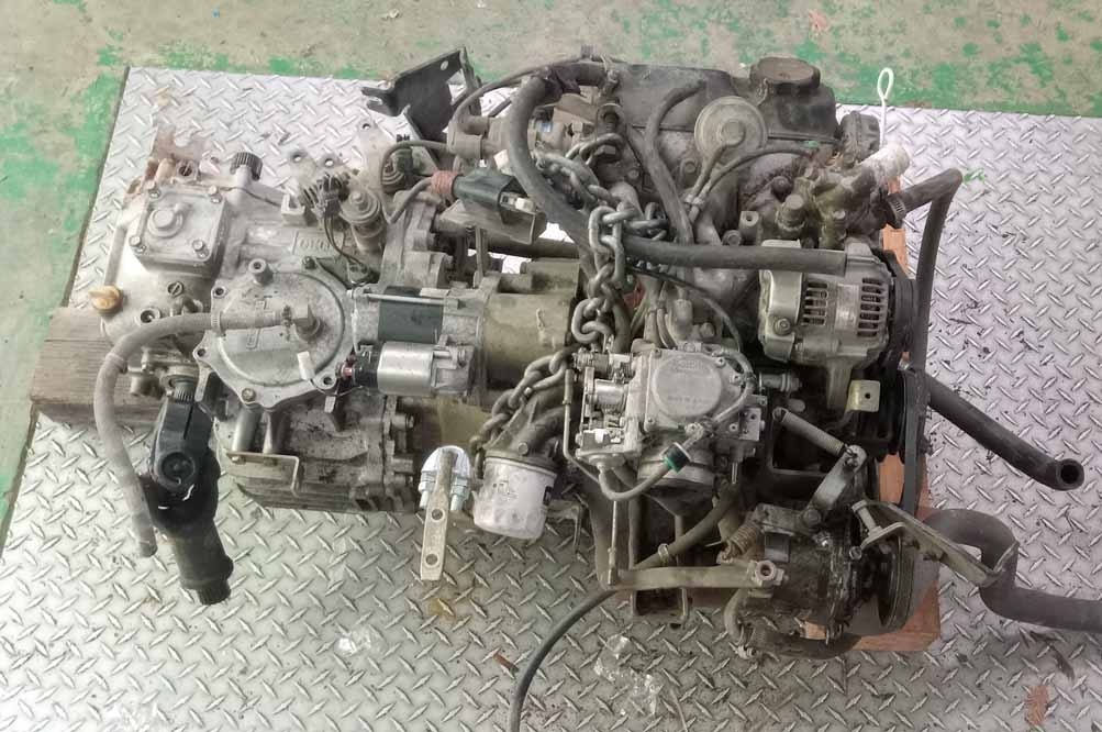

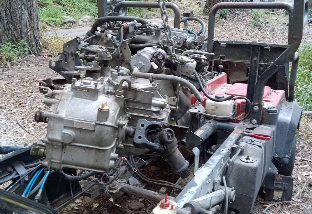

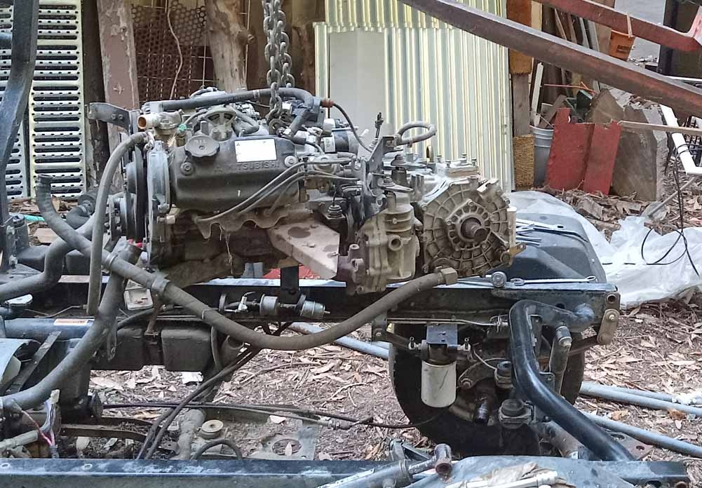

Anyway, then engine/trans is out, and on the floor of my workshop. I used my front 3-pt on my loader. The hangup was one of the half-shafts U-joint yoke would not slide off, so it came apart while lifting. This is gonna be tough to align when putting this back in.
Mitsubishi was nice enough to provide one lift hook, but not 2. So I used the thick steel bracket that supports the air box.

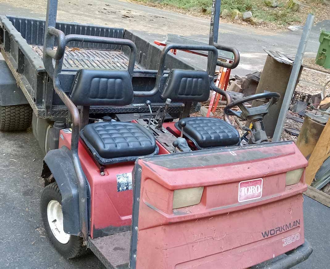

The Toro I dragged home today had the carb taken off by the guy I bought it from, but he had only pulled it and started to open it up when I emailed him about buying it. He only had one picture on Craigslist, and not a lot to say about it, other than front tire leaks down quickly, ran at idle before he pulled the carb off, hydraulic bed works, lights work, needs a carb cleaning and has a 3 speed manual transmission.
If he had put high/low range in the description, i would have given him a few bucks more for it. If he had put rear pto in the description, or took a picture that included the rear pto, I would have given him every penny he was asking for it, without question.

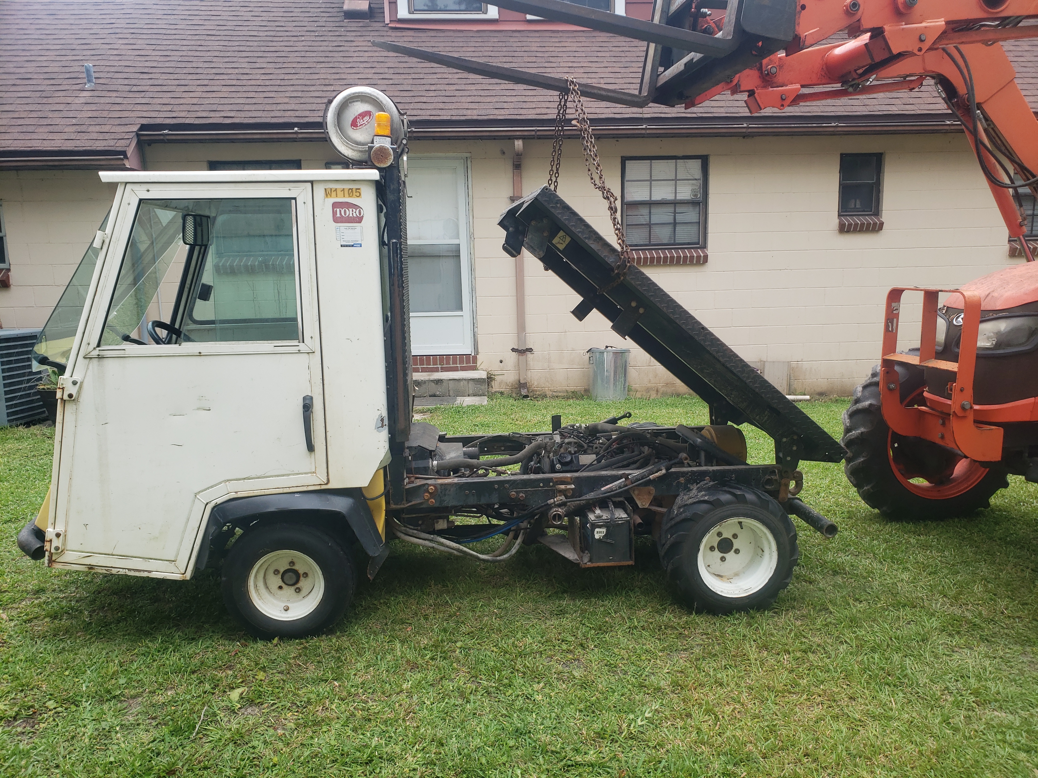

My KY Toro that is in TN, (We name them by where we find them so when my TN buddy refers to one, we both know which one is being discussed) is currently getting a partial rewire, as the heater switch connections got loose, and the high resistance melted the wires going to the blower motor.
New switch, new flexible heater hose (2.5") and one of the blower vents if we can find one. With all that replaced, it should blow enough heat to keep that little cab warm for my Bride when She runs it across the street to her Mom's house. It doesn't get that cold in Florida, but my Bride very much dislikes cold weather!

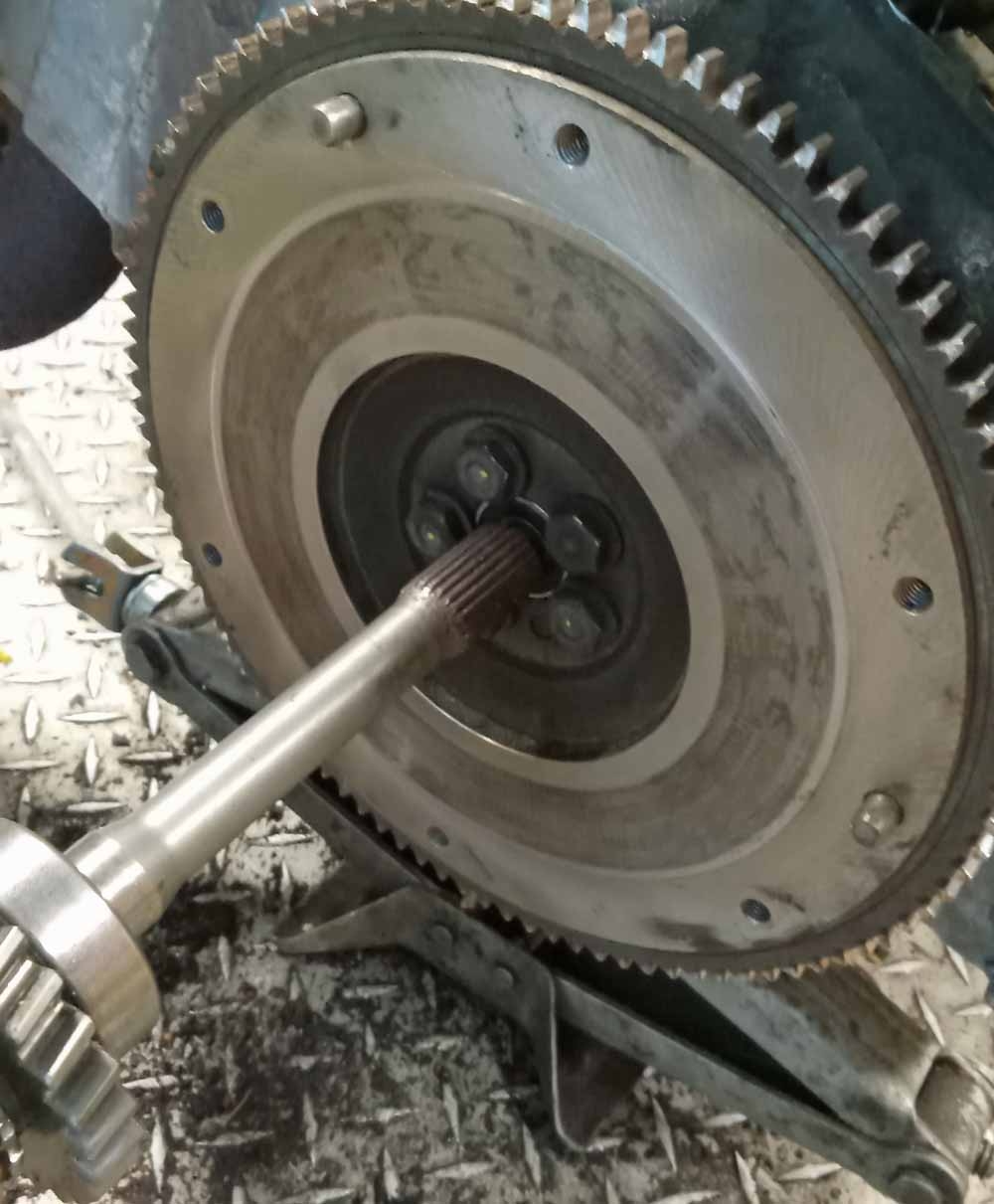

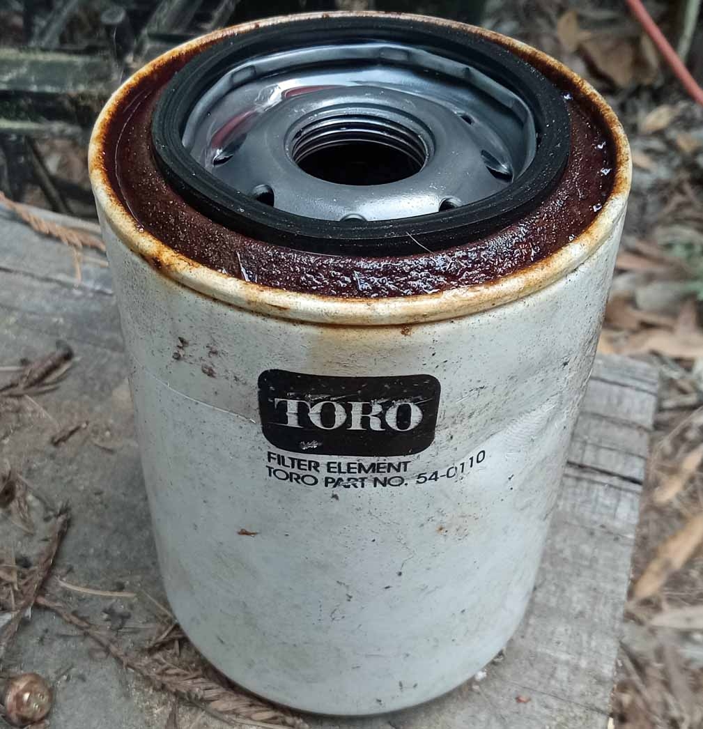

So, the engine/trans is out and on the floor of my workshop.

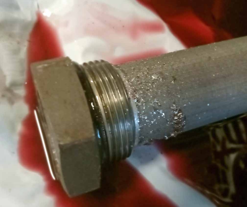

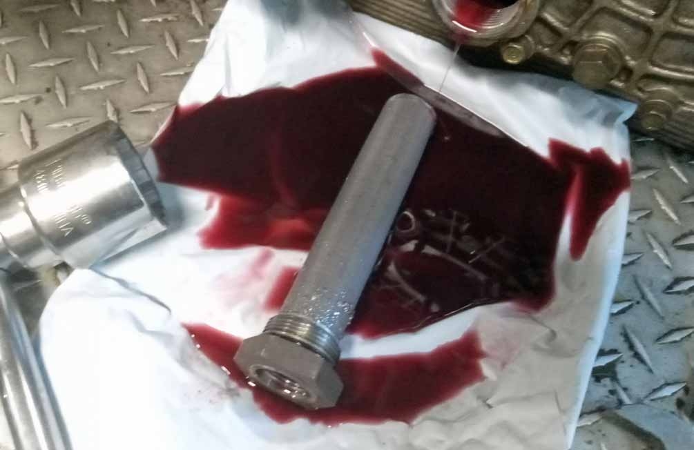

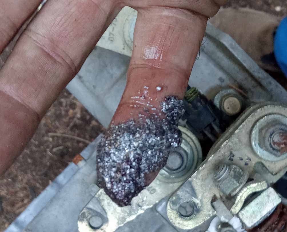

I did drain the hyd oil sump first, but there is still some ATF in there. I pulled the hydraulic inlet filter screen, and boy was it full of metal flakes. A magnet told me it was mostly ferrous, rather than aluminum or sleeve bearing material.
I stuck my finger in the filter opening and brought out what was below the filter. Wow.
That is a 48mm socket, used to remove the filter.

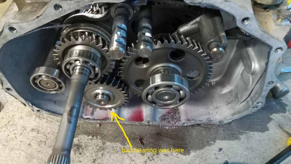

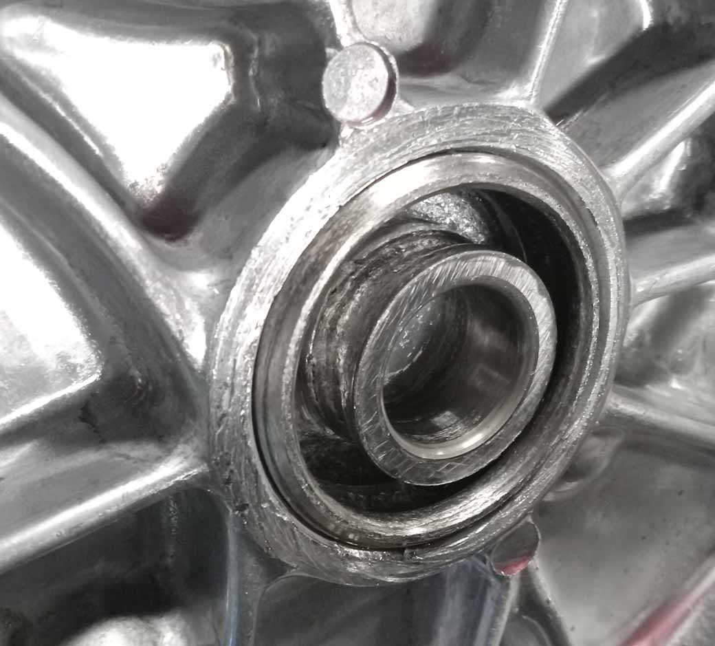

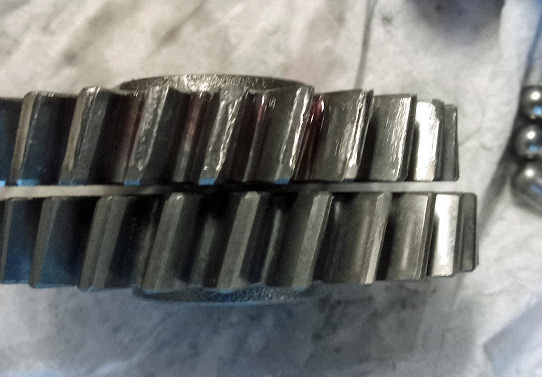

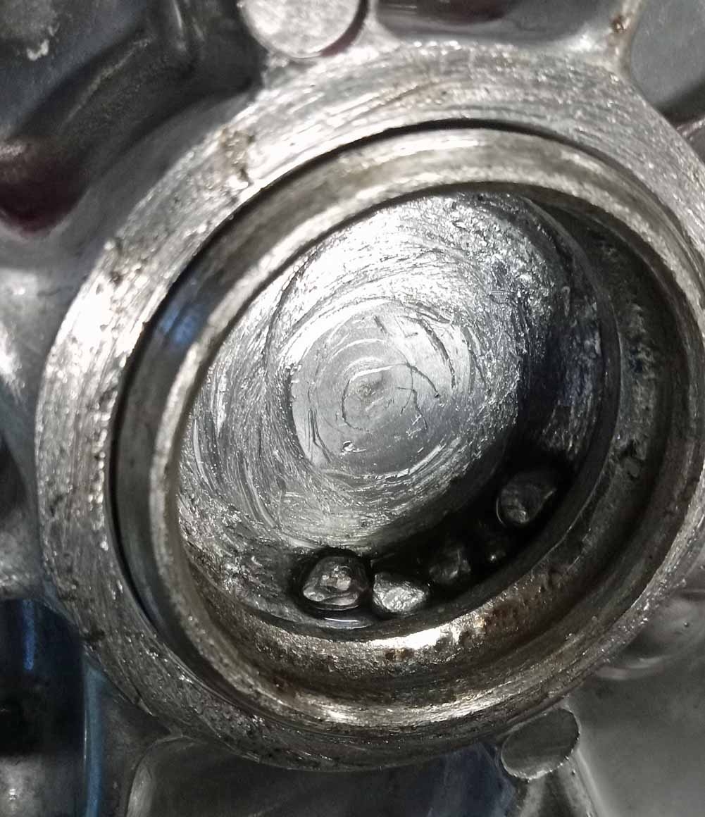

I opened the transmission, and the problem was obvious immediately: A disintegrated ball bearing. All that remains of the balls and cage are 5 balls, ground down by 2/3. The aluminum case is hollowed out quite a bit behind the bearing, but not enough to go through.
So, I harvested the bearing and the 2 outer gears on the countershaft. The old gear and its replacement are shown side-by-side. I would have replaced the aluminum cover, too, but the old one got corroded by sitting out in the weather since a year ago when I took it apart.
The amount of debris in the oil is so great that I wonder how the hyd pump still works. I see the differential pinion gear is scuffed a bit, but still serviceable. I bet the hyd filter is clogged.

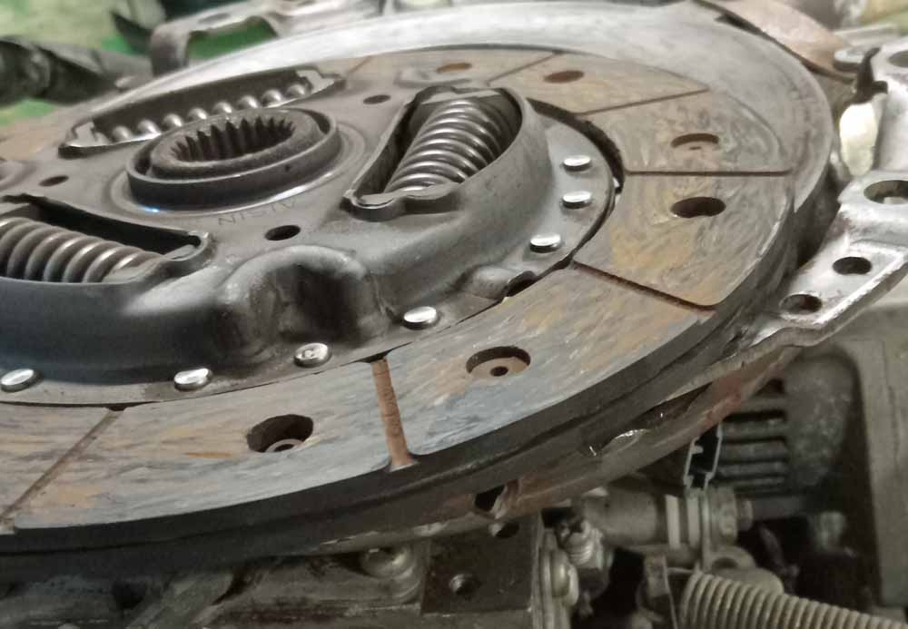

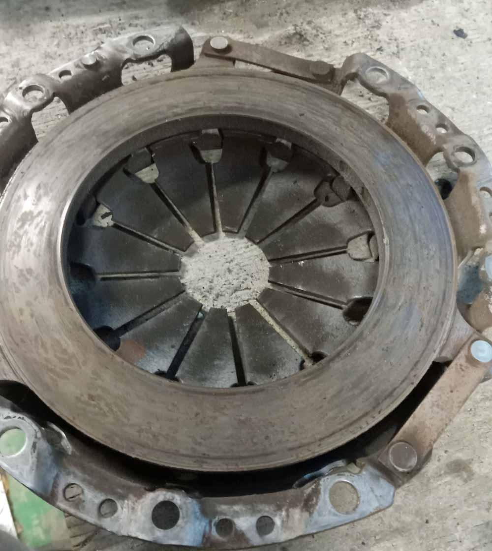

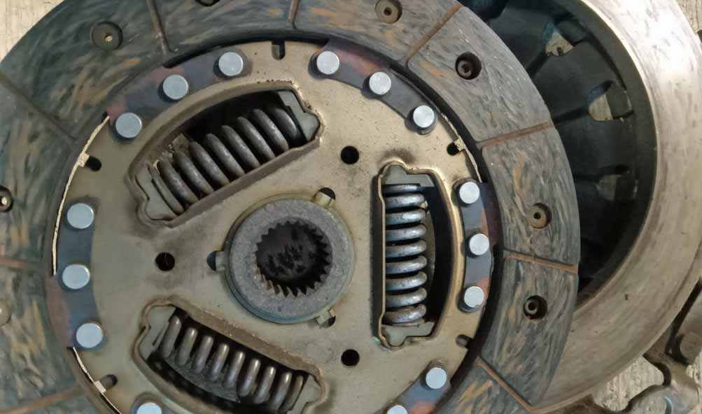

I took apart the dry foot clutch, and it is in great shape, leading me to believe that it has been replaced once. Throwout and pilot bearings both spin smoothly. I fully expected to have to replace at least the friction disk. Good news.
I am going to cut open the hyd filter to see how much it caught. Good news is my Zinga AE-10 filter, which I already have, fits perfectly. This is one case where a large mesh suction filter (50-100 micron) helps, and it probably saved the hyd pump and PS valve.

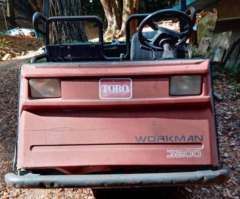

Yeah, I wonder why these incredibly robust UTVs have not really crossed over to the farmer/rancher/large estate market. Neither the Workman nor the Pro Gator. Probably the cost.
The frame on this machine is more substantial than on my Tacoma. And, at 5000 hours, it has seen its first major failure, which so far seems economically repairable.
