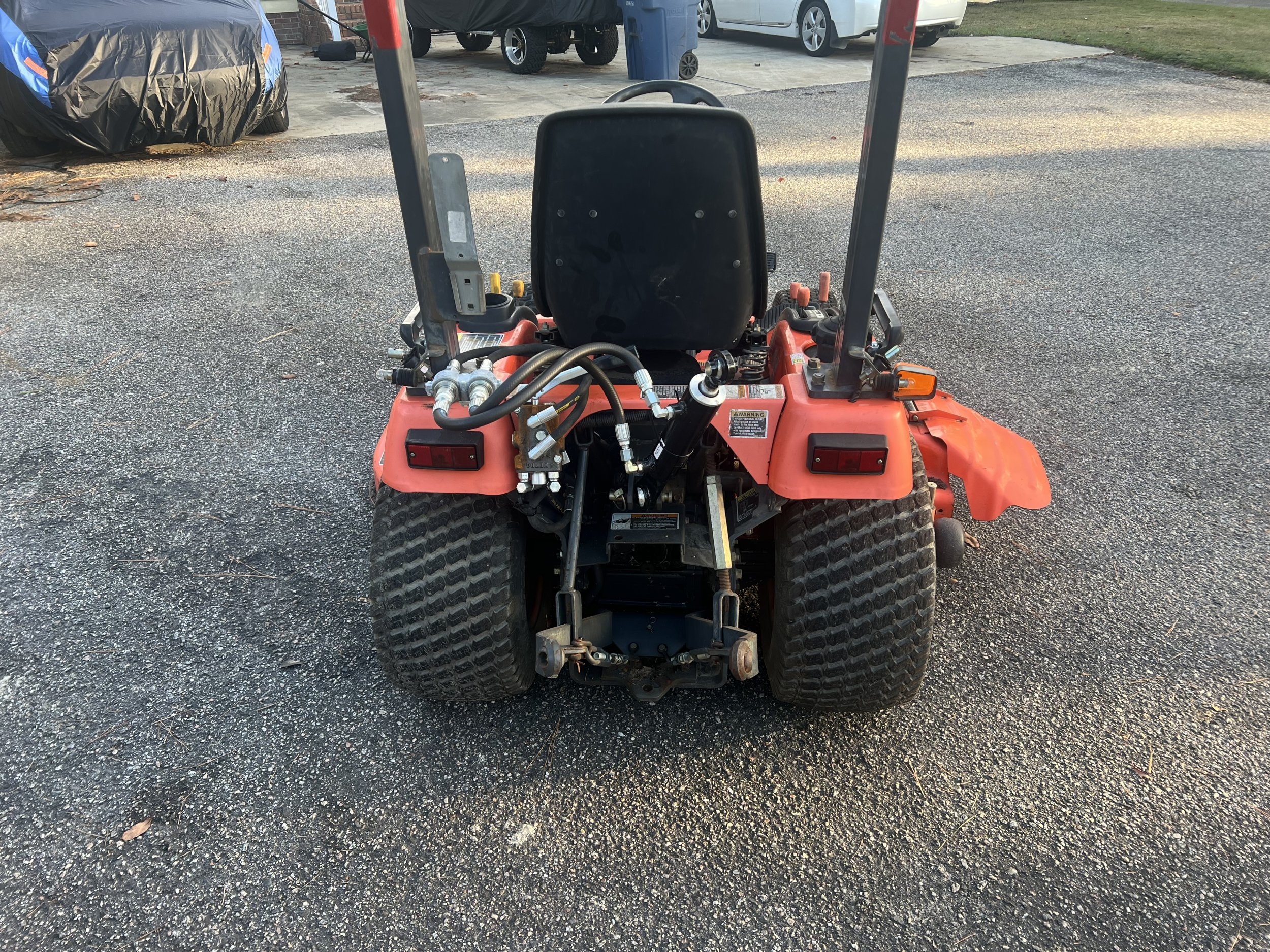

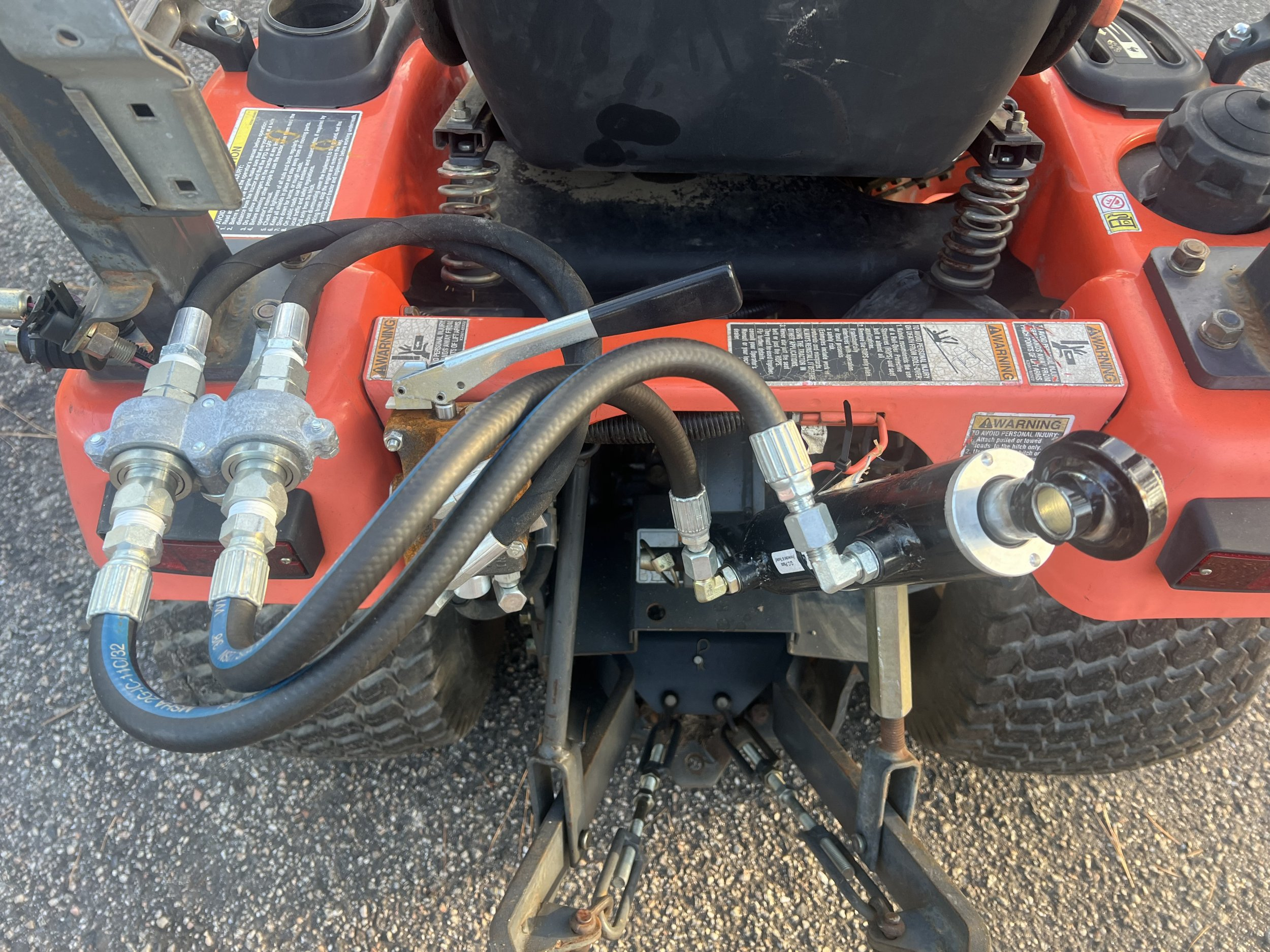

Unfortunately when I received my tractor back after over a month in the shop it wasn’t fixed and the top link was installed in an absurd manner. The first problem was that they replaced the treadle pedal but didn’t ensure that it sprung back to stop position when I take my foot off it. I learned this after running through a thick bed of azaleas. I discovered on this forum that a sticking pedal is a common problem on the BX2230. The other problem was where they installed the control to the hydraulic top link. They literally mounted it on the rear of the tractor right above the three point hitch. In my opinion this makes no sense. The point of having a dynamic top link is to have the ability to adjust the angle while driving. I could just go and adjust the turnbuckle myself if I was going to jump off the tractor and go to the rear of the tractor every time I wanted to make an adjustment.
Anyway, the dealership picked it up yesterday and begrudgingly agreed to fix the problems. I am a woman who is completely new to tractors but I’m not an idiot. The dealer tried to tell me that it’s common to put the top link control on the rear.

Welcome to TBN! I agree the valve orientation for the top link is not ideal. However in their defense it is sometimes difficult to find a good placement for a new valve on a small tractor. Hopefully they can come up with something that will work for you.
