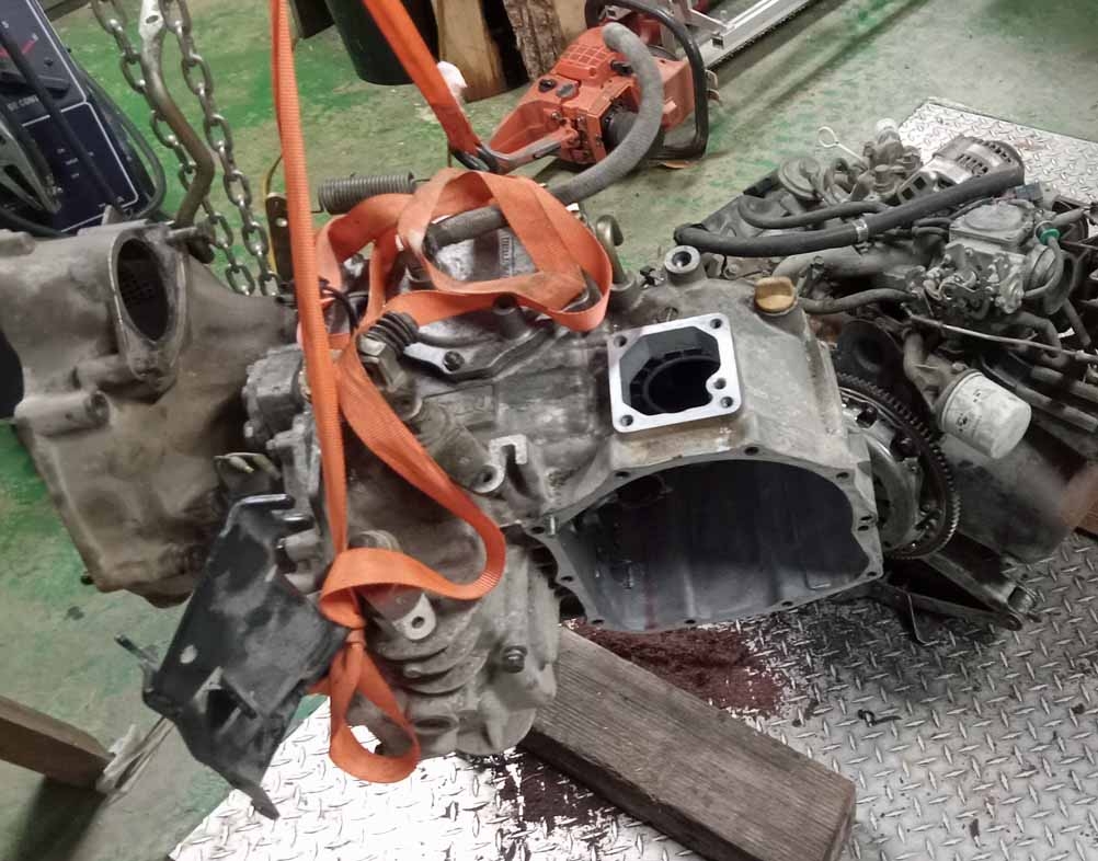

I just re-mated the tranny to the engine last night. Tip: leave the differential out while doing this. It makes the assembly much lighter and easier to guide into the clutch, plus you can turn the mainshaft by hand if the splines do not line up.
Bell housing is held on the engine by only 4 bolts!
Apparently the 3 cylinder Mitsubishi isn't a high torque engine, lol, or those 4 bolts would be a much larger!

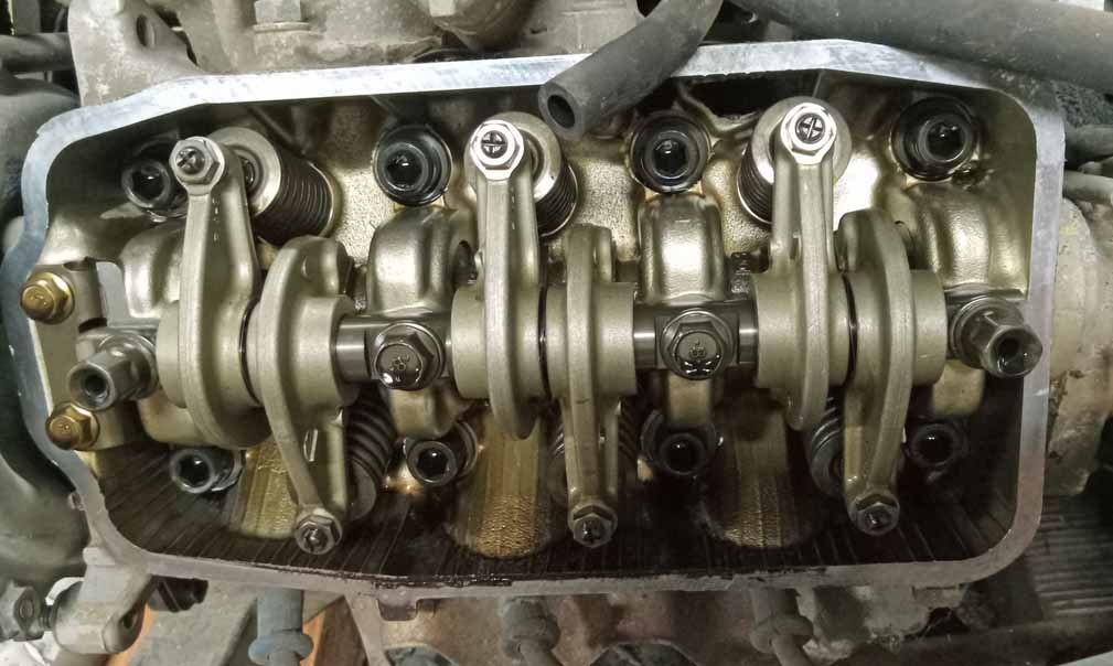

I adjusted the valve lash before reinstalling. Only one was off slightly, which probably made the slight tick I heard. Just 2 bolts hold the cover on, and no leaks!
This 3-cylinder engine of only 660cc seems well-made, with stout valve train components. No smoke I can see, even at nearly 5000 hours.

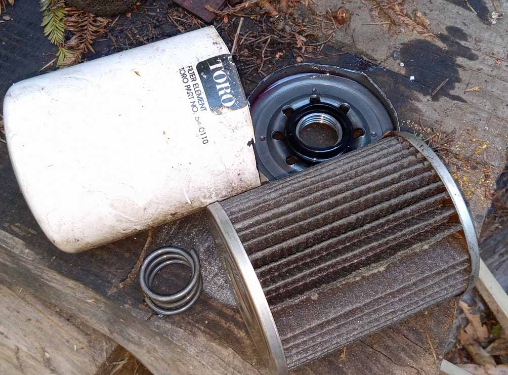

I dissected the hyd filter. Very sparkly in there, but apparently survivable. Maybe cuz the Barnes hyd pump is cast iron and not aluminum?
As of last night, the engine is back in. The most difficult part was not too bad: getting the half-shafts onto their couplers while lowering the engine/trans, without a helper.

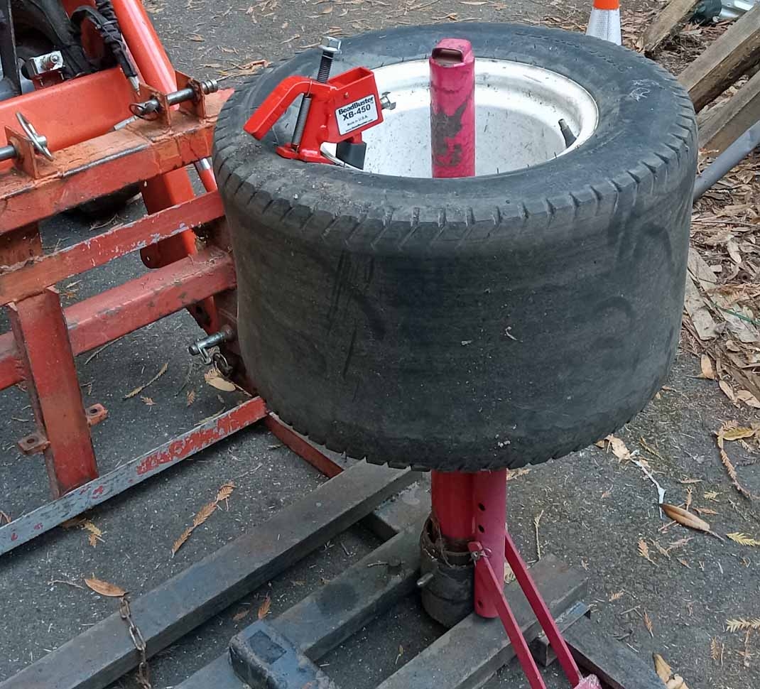

I just got my tires in this week. Working on the mounting now. One of the rears is so worn, it looks like a racing slick. 6-ply with 1710# rating. $$$$
Beads hard to break, but I have my trusty bead-buster. Spec for rears is 24x12-12, but the slick one is 13" wide.
