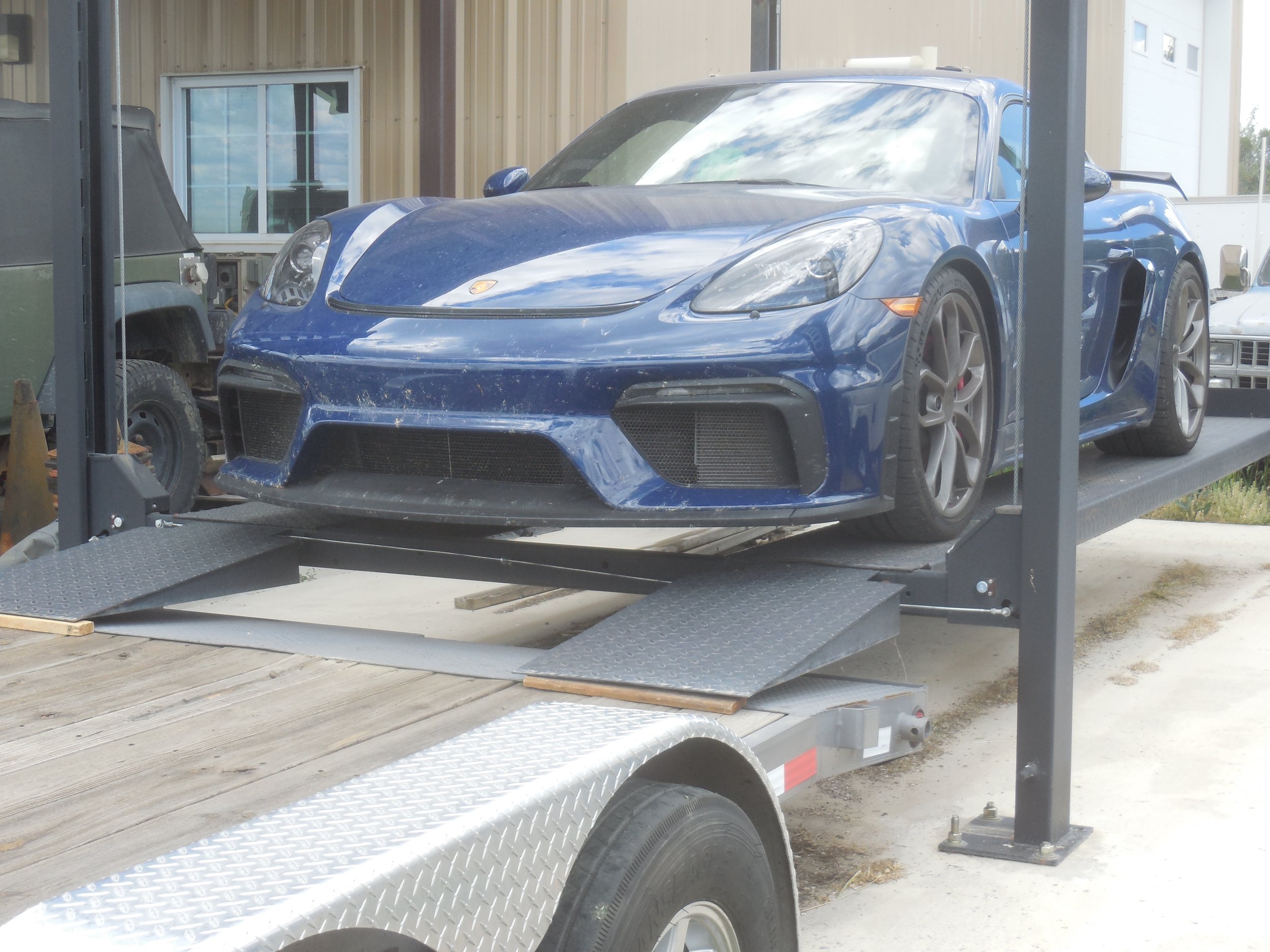

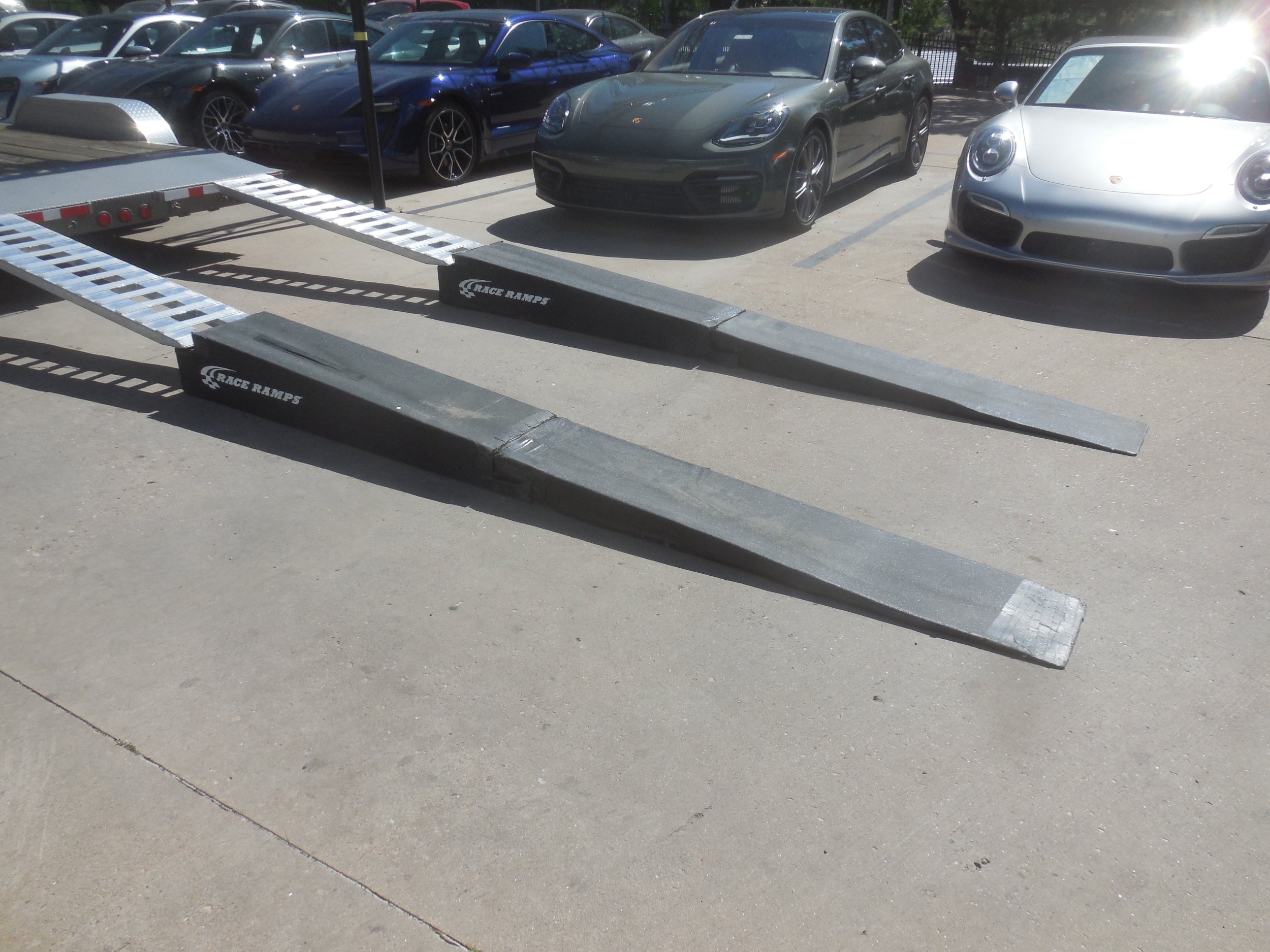

I resorted to load a car with a very low approach angle by backing it up on the 4-post, then driving it onto the trailer. Of course, that still leaves the unloading part of the equation, but the dealer it was going to has the really long 2-piece Race Ramps, which we used together with my aluminum ones.

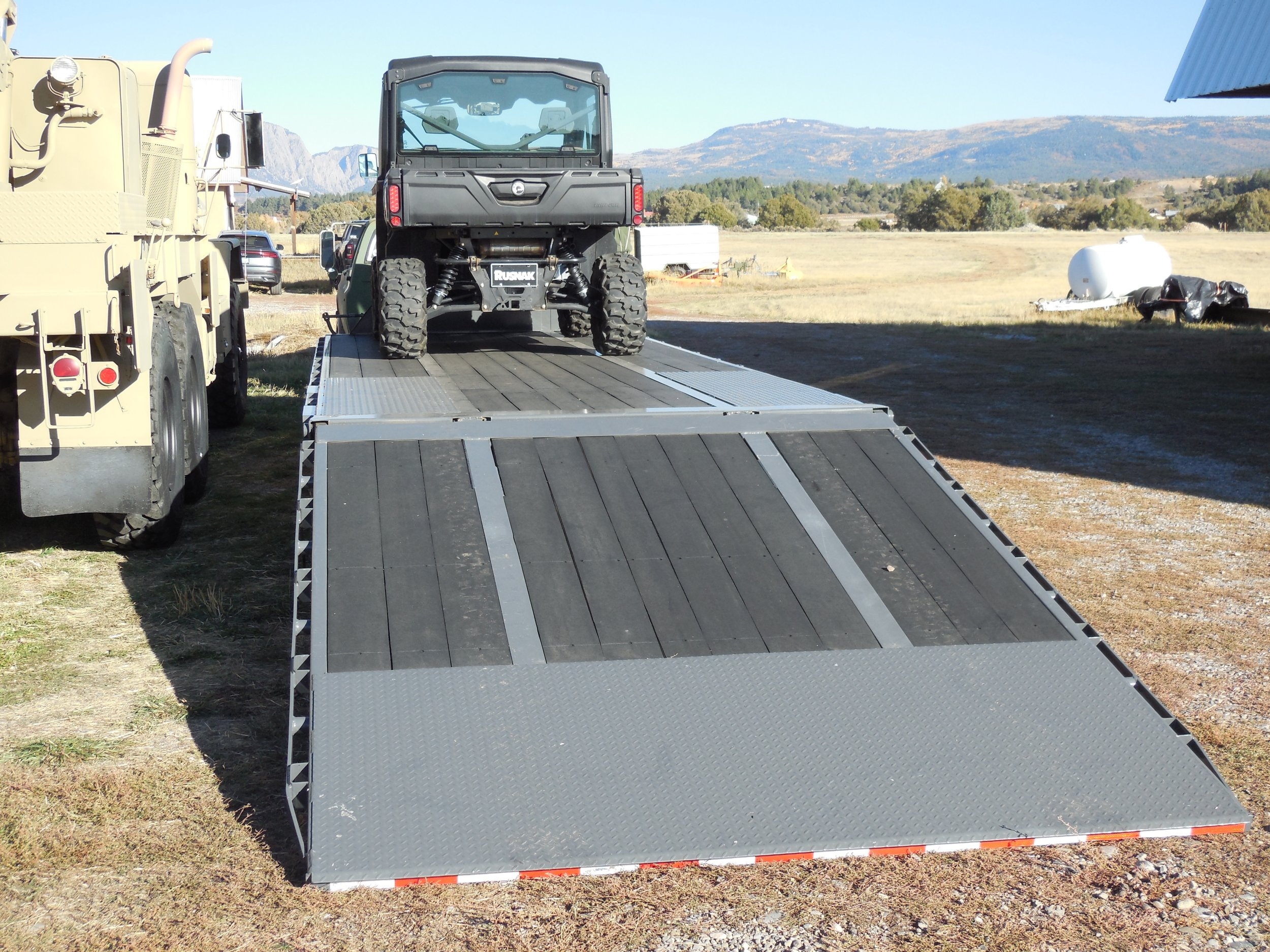

If you go with a deck-over the ramp situation changes quite a bit for Challenger usage. For example, I ordered my toy hauler (which is not a deck-over) four inches taller than stock to get it into places I want to go.
Well, its rear door/ramp needs to be propped up on supports, then ramps and Race Ramps are required to accommodate the approach and break-over angles. The pictured deck-over with the hydraulic tail is about as low as it gets, especially after dumping its air suspension.

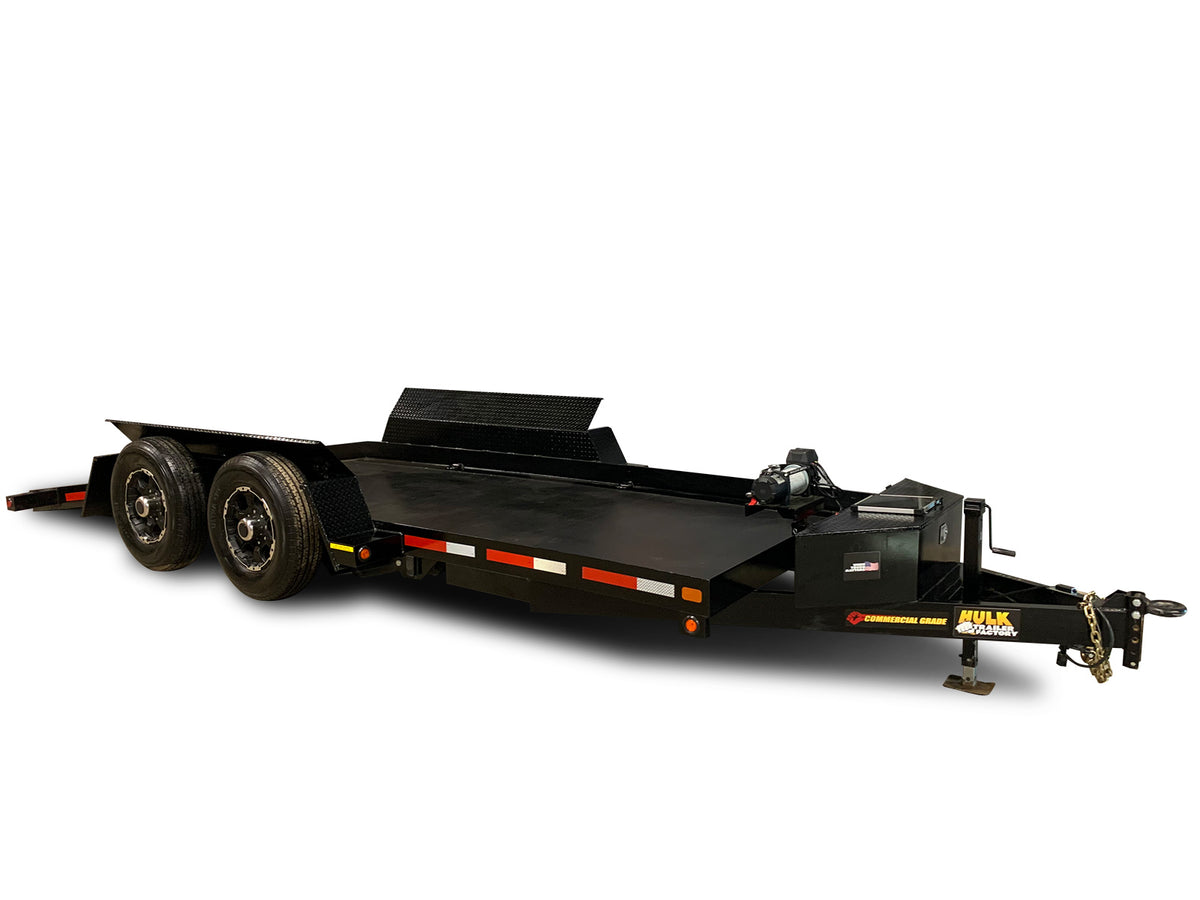

This MAXX-D deck over tilt trailer is made by a small company in Texas. The one that would fit inside my garage with tongue length would be the 22' model - its entire deck tilts for a 15 loading angle. It comes in a "gravity" or "power tilt" version - listed as the same price.
If I got the power tilt (with remote control) and had the long race ramps in the photo Too Many Kubotas posted (which I think come apart for shorter lengths to transport), couldn't I position the race ramps, and then lower the deck until the knife-edged steel deck ramp would stop and lay on the recessed edge of the race ramps? By stopping short of the advertised 15 degrees to marry up with the race ramps wouldn't this create a fairly straight low travel angle for loading and unloading the Challenger?

You wouldn't need the 2-piece really long Race Ramps in the photo. The regular 8-degree ones would likely work just fine with that trailer.
But, and this could be important, Race Ramps should be used on smooth concrete or pavement, or they'll eventually crumble.
That's one reason I prefer blocking up the door or trailer end with plastic blocks (intended to be supports for RV trailer jacks as I recall) or chunks of wood.
Now that the door/trailer end is supported at the desired height, I can use normal aluminum ramps. Well, the knife edged ones can need a little support (a piece of 2x4 or something) so they don't flip up when the tires hit them.
Anyway, that's a less expensive option that can be used on uneven and rough ground.

It's not only that Race Ramps must be loaded evenly, they need to be on a nice surface, like concrete, not gravel.

With the toy hauler it's a must as the door/ramp goes to the ground...or whatever stops it first, like those RV jack blocks. Then the door and the ramps can rest on the blocks.
f you end up buying the Texas tilt deck, I would treat it like I do my hydraulic dove and toy hauler and set the deck on something, then put aluminum ramps either on the deck or the "something" supporting the end of the trailer deck.
The aluminum ramps in post #53 are my short aluminum ramps, but since I had looked up the height of the dealer's 2-piece Race Ramps before leaving I already knew it would work.
And that was my girlfriend's car by the way, headed for a dealer to get traded in. That GT4 had a ridiculously low approach angle (about half of a Hellcat's) which is why I took the easy way out and used the lift to load it instead of cobbling something up with ramps.
