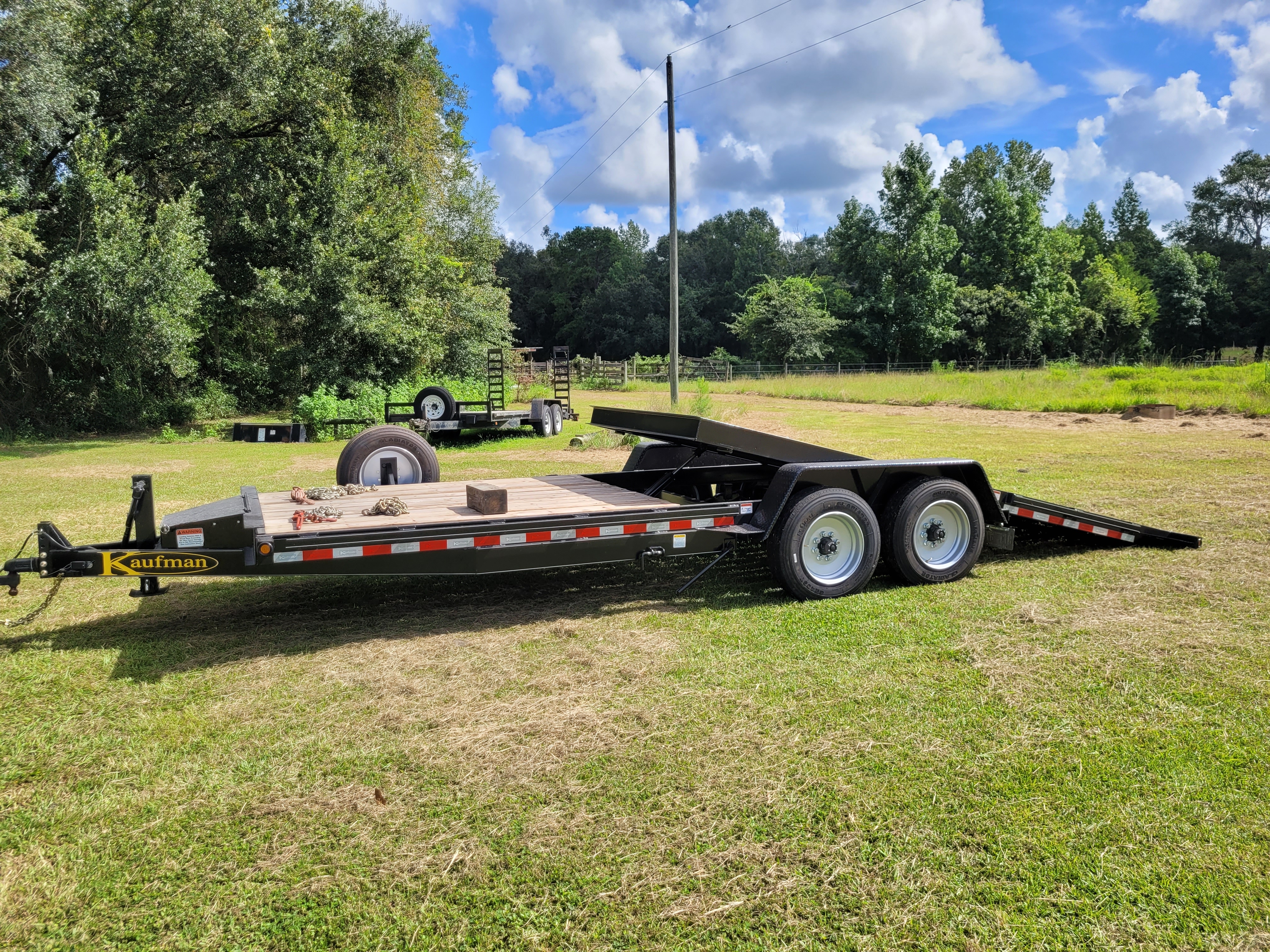

I have had a 10k 20’ full tilt ( manual ) with gas struts , trailer for 10-12 years, I love it. I also bought a 22’ ramp trailer Thats heavier and never use it. If I did it again I would get a 14/16K 22' with 4/5, fixed up front with manual tilt

I looked back at the sales receipt with all the upgrades this 22' Kaufman tilt deck was $8160.00 out the door from their South Carolina factory.

2-8k axles with 17.5 super single tires instead of 2-7k axles with 16" tires , and also a spare 17.5 tire on a steel wheel.
   / Is a Tilt Trailer the right way for me to go? #59
What year was that ?
August of 2023. I just looked at their website and it looks like the same trailer optioned like mine is about $8800 today, so a slight price increase but still a really good deal IMO.

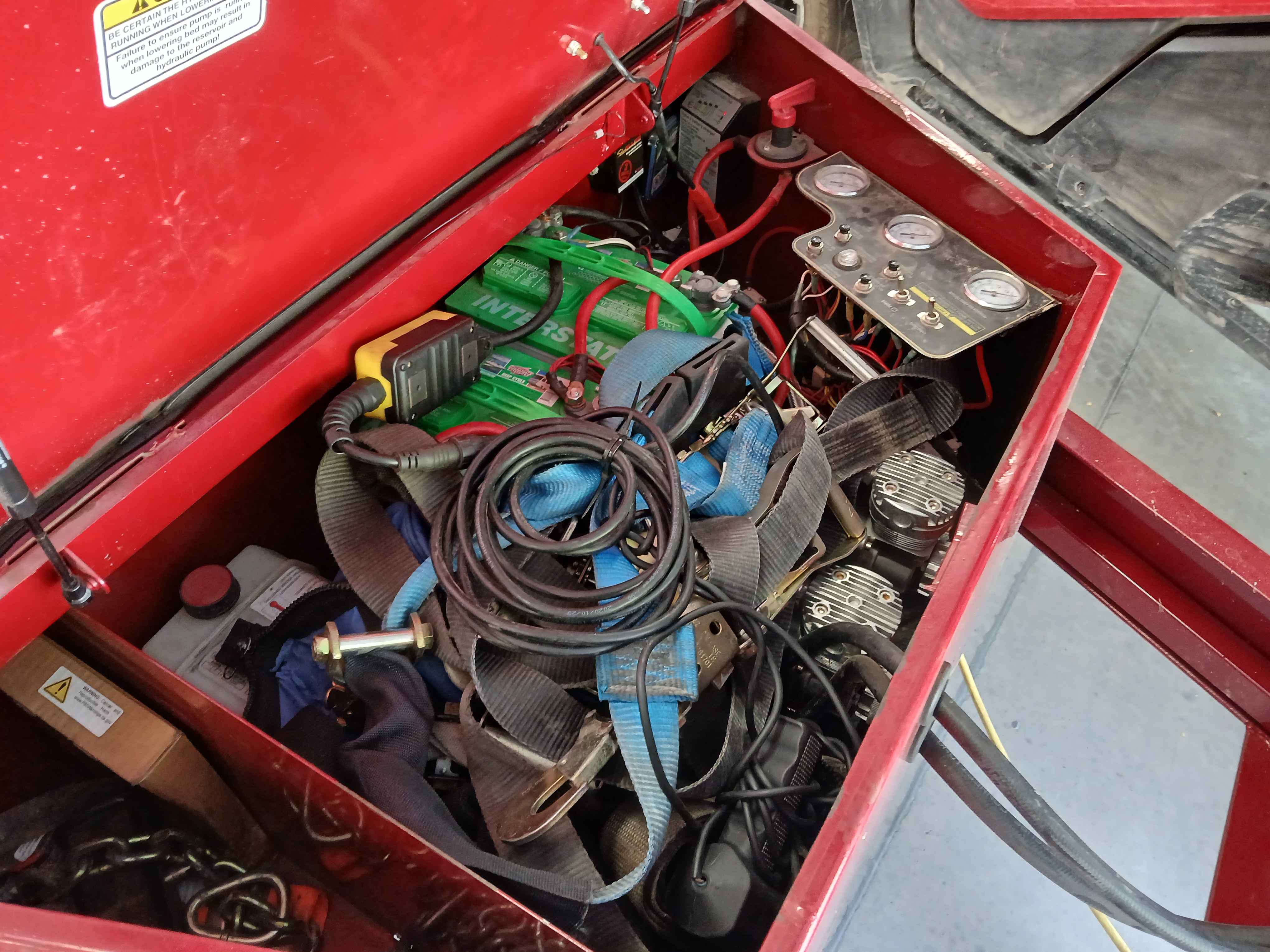

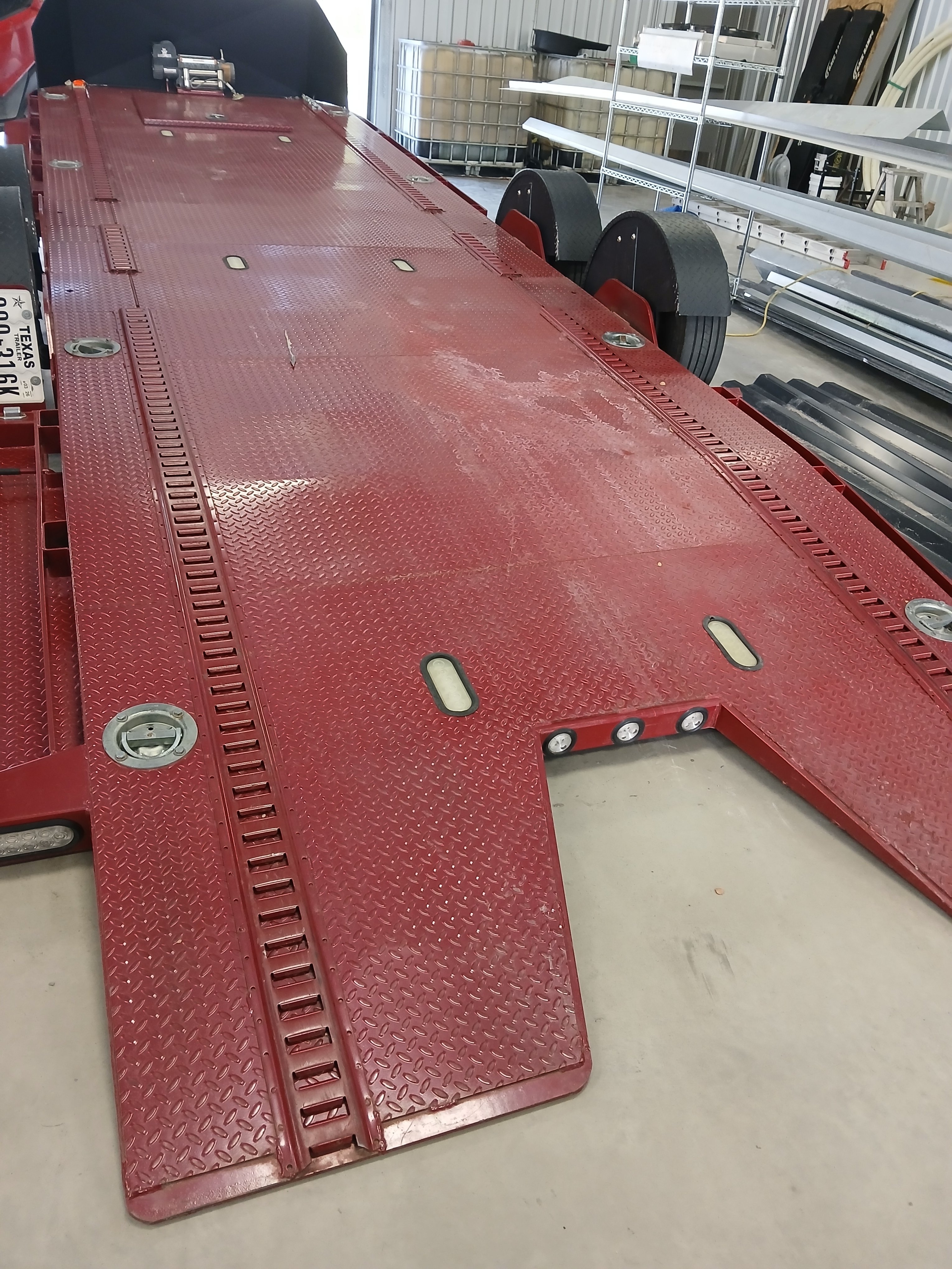

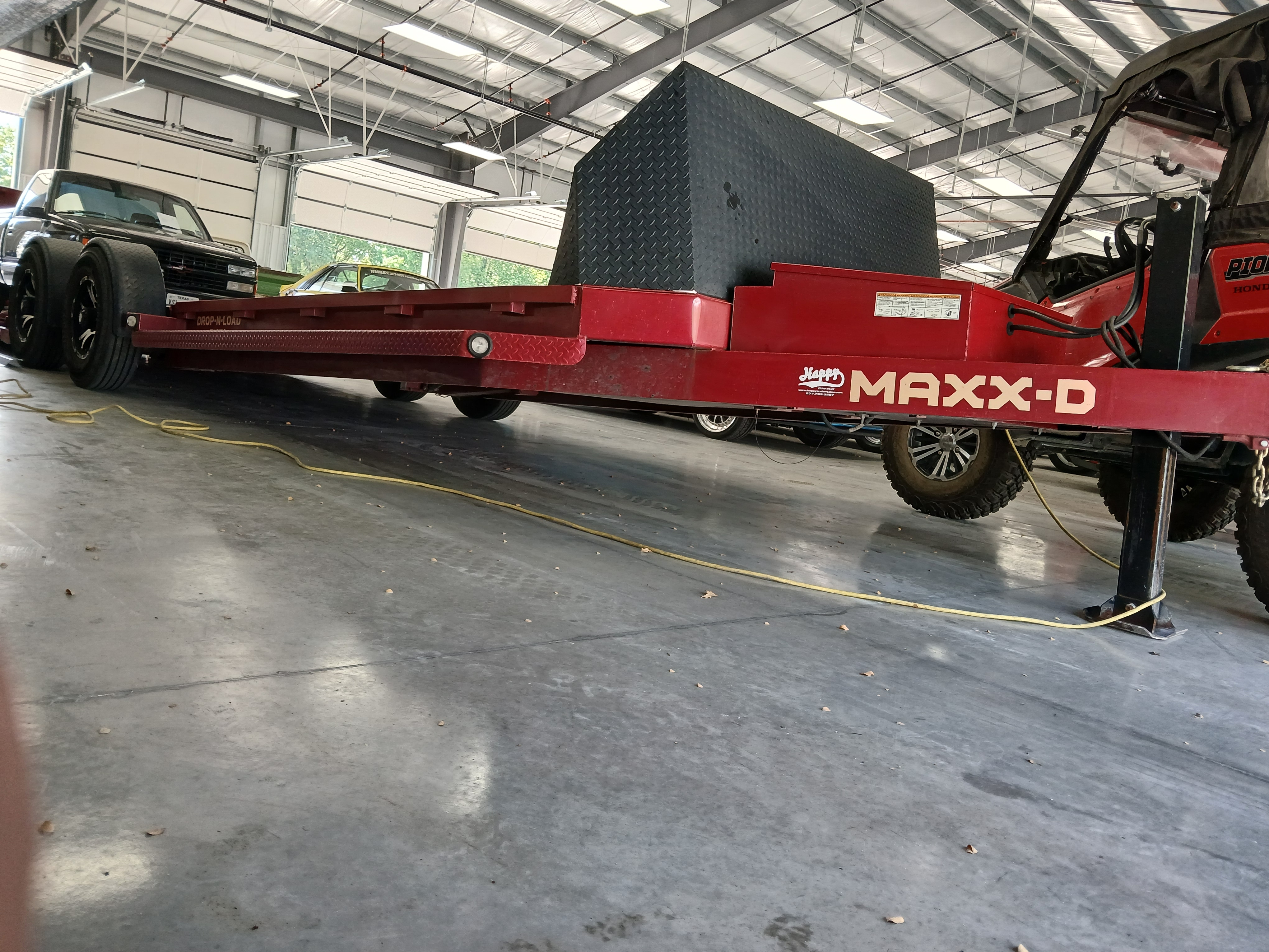

This one is very easy to load and secure loads.
And it's built like an anvil, if they had hundreds of moving parts and relied on batteries. It is easy to use though.
