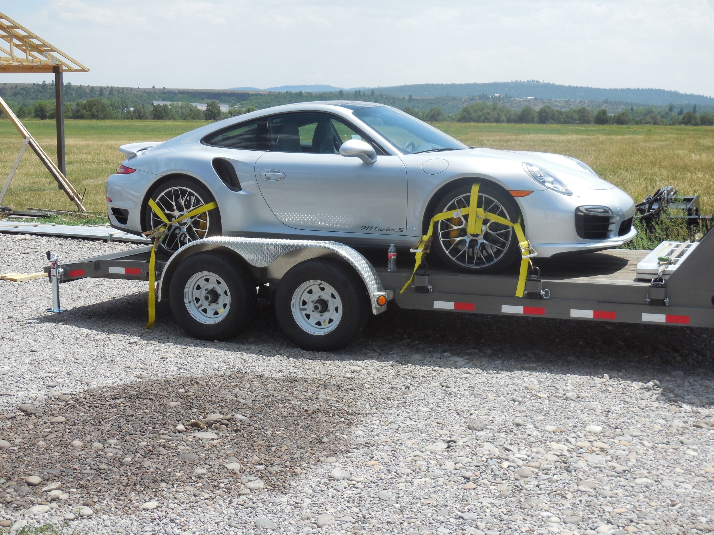

Mine has the foot or so tall rails and is only about 80" between fenders. I can get the doors open a few inches but not enough to exit. having a low slung trailer it does tow very well.
Flat bed trailers have advantages too.
How wide is the space between those 9" tall fenders?
Are they drive over style?
As I recall this one is 93 inches between the fenders, and they're definitely not sturdy enough to drive over. But removable.
/ Tilt trailer #42
As I recall this one is 93 inches between the fenders, and they're definitely not sturdy enough to drive over. But removable.View attachment 857222
Very nice, that extra 13" width and doors clearing the fender tops helps with cars. My fenders are at the rail height so a No go for a car.

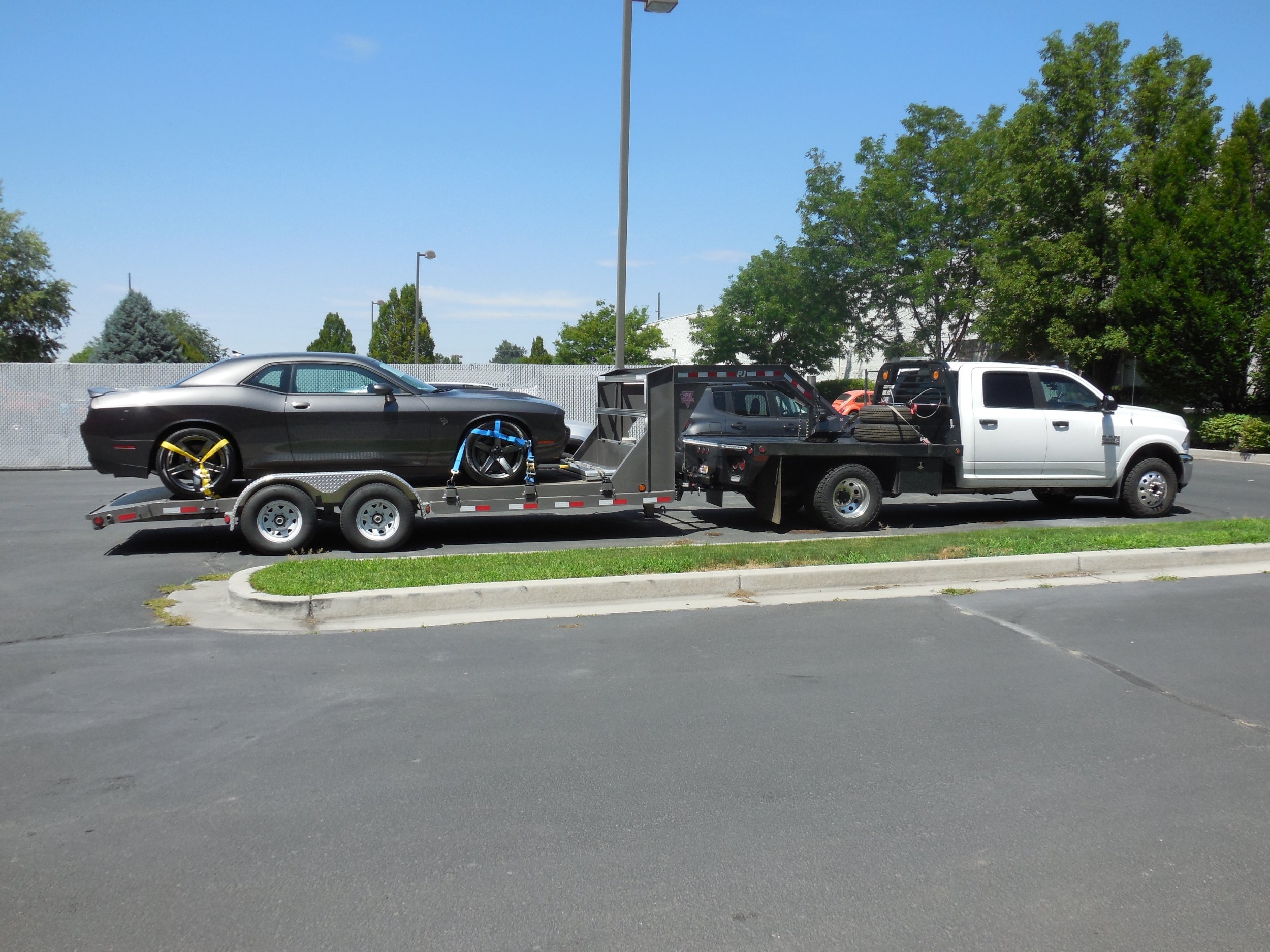

Your car has a 10 degree approach angle if it's like mine, so about 8 degrees on the ramps would be safe. You can use Race Ramps made for trailer use to add to the effective length and lessen the angles.
Using my small 18' gooseneck with a 2-foot dovetail, the ramps don't need to be overly long (can't recall what length I use for that car). It helps a lot if they are knife edged, by the way.
Maybe more importantly, if you go with drive-over fenders, is that they are not too tall for the doors to be opened. They need about nine inches if memory serves me
/ Tilt trailer #48
Your car has a 10 degree approach angle if it's like mine, so about 8 degrees on the ramps would be safe. You can use Race Ramps made for trailer use to add to the effective length and lessen the angles.View attachment 880564

To the best of my knowledge, my pedestrian 'Cat has the same approach angle and ground clearance as a Redeye.
Either way, I'm not fond of tilt decks (but a huge fan of hydraulic dove tails) so removable fenders might be better in your case than ones you can drive on. Although driving over them with a tractor wouldn't bother me one bit.
I brought tools to remove a fender when picking up the pictured 'Cat, but didn't need them. Look up "Best aluminum ramps" (I think it is), and you can get ramps made that'll work with your car and trailer combination.

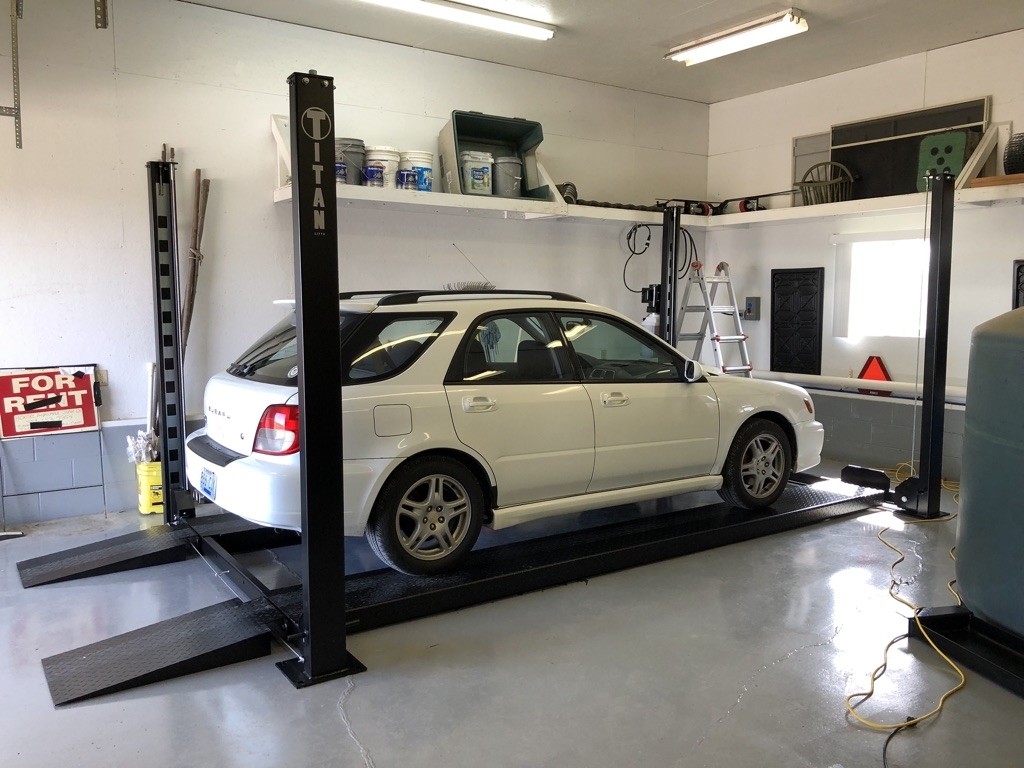

I have both steel and optional aluminum detachable ramps that go with my four post Titan lift so I probably could use those with a dovetail and its ramps to lessen the approach angle.
