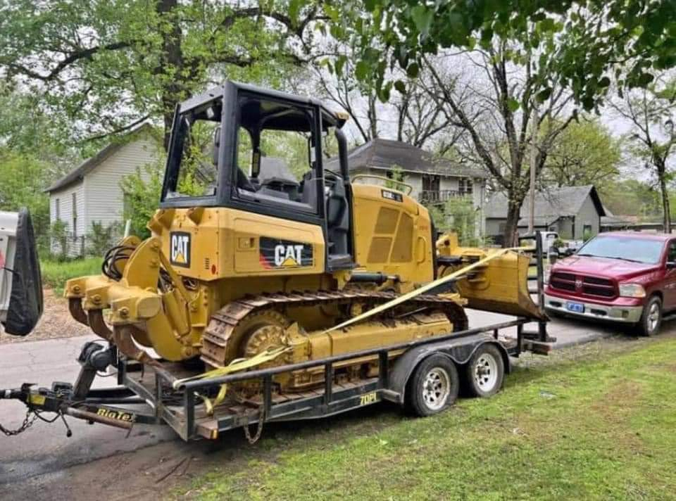

Looks like the tongue may be bent upwards.
Bruce
Yeah, and the back axle or hub is absolutely broken, the front one probably is but it's hard to tell when the tires flat and it's on the rim. Don't think it's photo shopped.

I will admit the dozier to me is little over the load limit of the trailer. Well, maybe a lot. How much does that dozier weigh? I do doubt it would slide out due to braking.
A few years ago, I drove by a trailer with piece of heavy equipment on it, laying on it's side. They had it chain down so good there was no space between the wheels and the trailer deck.
/ Tie Down Straps with loops for tractor #46
I think that’s a D3 XL which is about 20k pounds maybe more with the ripper attachment.
/ Tie Down Straps with loops for tractor #47
But it fit on the trailer so it MUST be able to haul it... :devilish:
/ Tie Down Straps with loops for tractor #48
Thank goodness he took the time to strap the ramp so that it wouldn't fall back down.

A grade 70 chain is absolutely stronger than a strap. I’ve never seen a grade 70 chain be cut by a load. Can you get by with straps hauling a tractor? Sure, probably most of the time. Am I ever going to? No. I have chains and binders and I’m crazy averse to being killed or being sued or charged for negligently killing someone else.
I can assure you, my loads are not tied down in a negligent manner.
I use an appropriate tie down method for the load.
I don’t always use chains, don’t always use straps.
To say a chain is always stronger than a strap is not always correct. There are many sizes of grade 70 chain and there are many sizes and qualities of straps. Again, absolutes.
I have seen chains cut by loads, just google semi trucks hauling steel accidents. Happens, not indicating straps would have done better in those situations.
/ Tie Down Straps with loops for tractor #58
If you’re going with the most common option of a 2” ratchet strap vs 5/16 grade 70 chain the chain wins by a lot. And that’s assuming the strap is brand new and in perfect condition. Use a frayed or sun faded strap and the chains lead just got a lot bigger.
I generally carry a mix of 1” and 2” straps, 3/8 and 1/2” G70 chains with ratchet binders.
They all get used depending on application.
Each is better than the other depending on application. Hell, I carry bungee cords and zip ties that beat out the 1/2” chain for some tie down applications.
