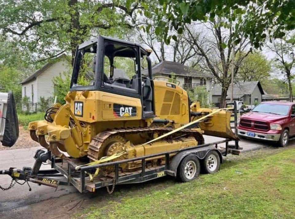

F=Ma -- in dynamics the force is the mass x the acceleration. None of us REALLY have a quantitative clue how many g's of deceleration the load will experience if we hit something, when we jamb on the brakes, etc. Neither do the people making the regulations. What we DO know is the huge backlog of millions of miles and trips worth of experience. Common sense: Does the tie down look like it would hold the load, say by dangling it stationary if it had to? That is one 'g' to dangle the load by the tie down statically. Probably overkill for most of us. A lot of things in life call for good judgement... so use it.
I think two examples will suffice here:
This was not a good enough tie down.

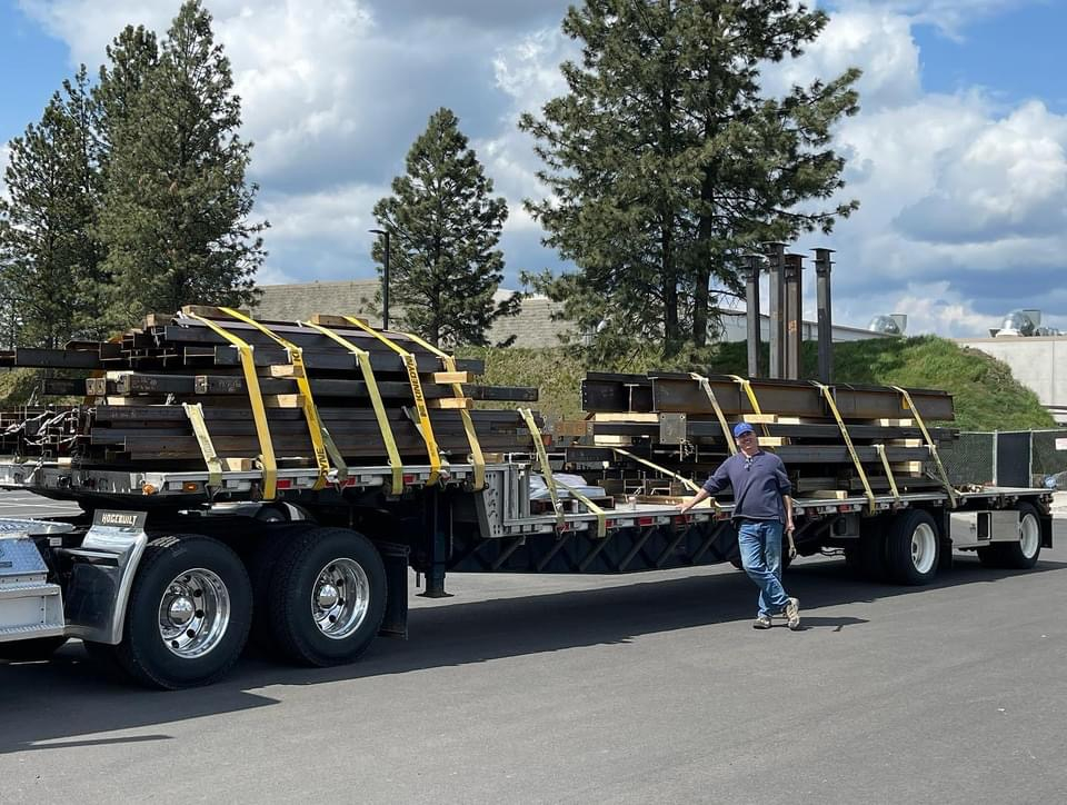

Someone mentioned that the fold over binders have been outlawed by the DOT? I was taught to properly seat them by giving them a "whack" with the piece of pipe that I used to tighten them to secure steel beams way back when. If I was hauling coils then I secured them with rubber straps just as a precaution since you cannot clamp down overly hard on coils. Never had one slack, never lost anything.
My "thing" is to take the time to basically use more straps (or chains) than the minimum. That comes from mainly hauling fence posts or pole barns. The smaller pole barns are the "worst" to tie down due to the post, purlins, tin, doors, windows, hardware on the same load. Heavy stuff strapped down first, light stuff on top with more straps. Then there are the roof trusses...

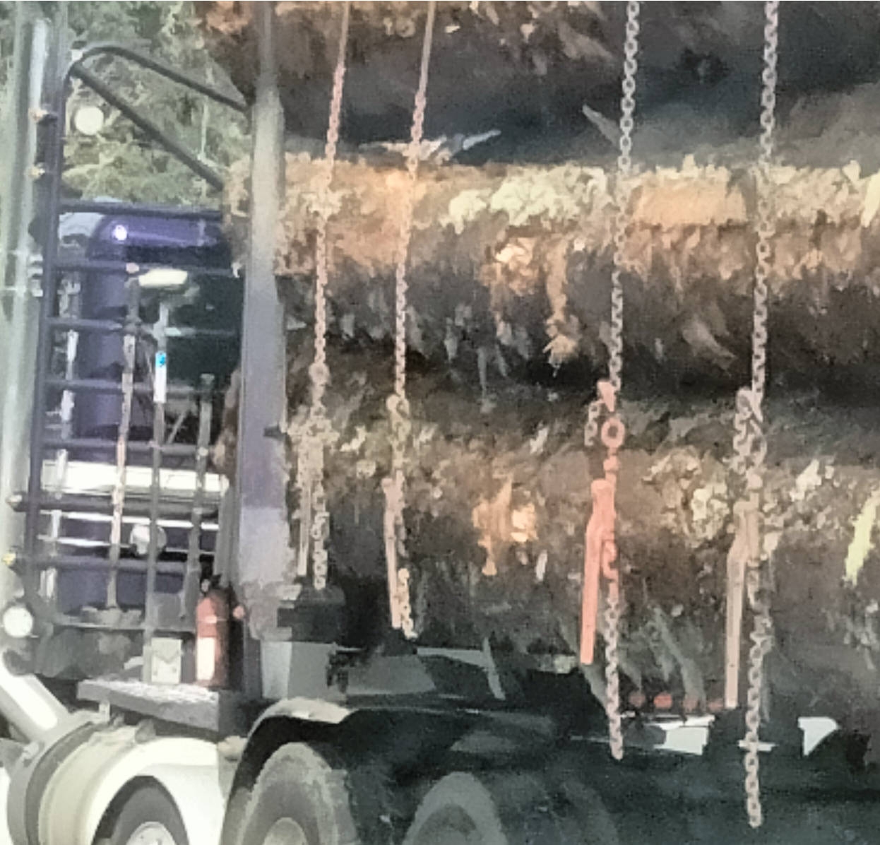

They definitely are still used on log trucks around here.
I don't know if they are load restricted by DOT.
The log loads are perfect for the snap type binders. They don't hang out wider than the load, and weight holds the handles downward.
Plus I've had issues with binders on solid loads like steel, not enough flex in the loads to get them adjusted properly. The logs likely have enough spring to tighten down well.
