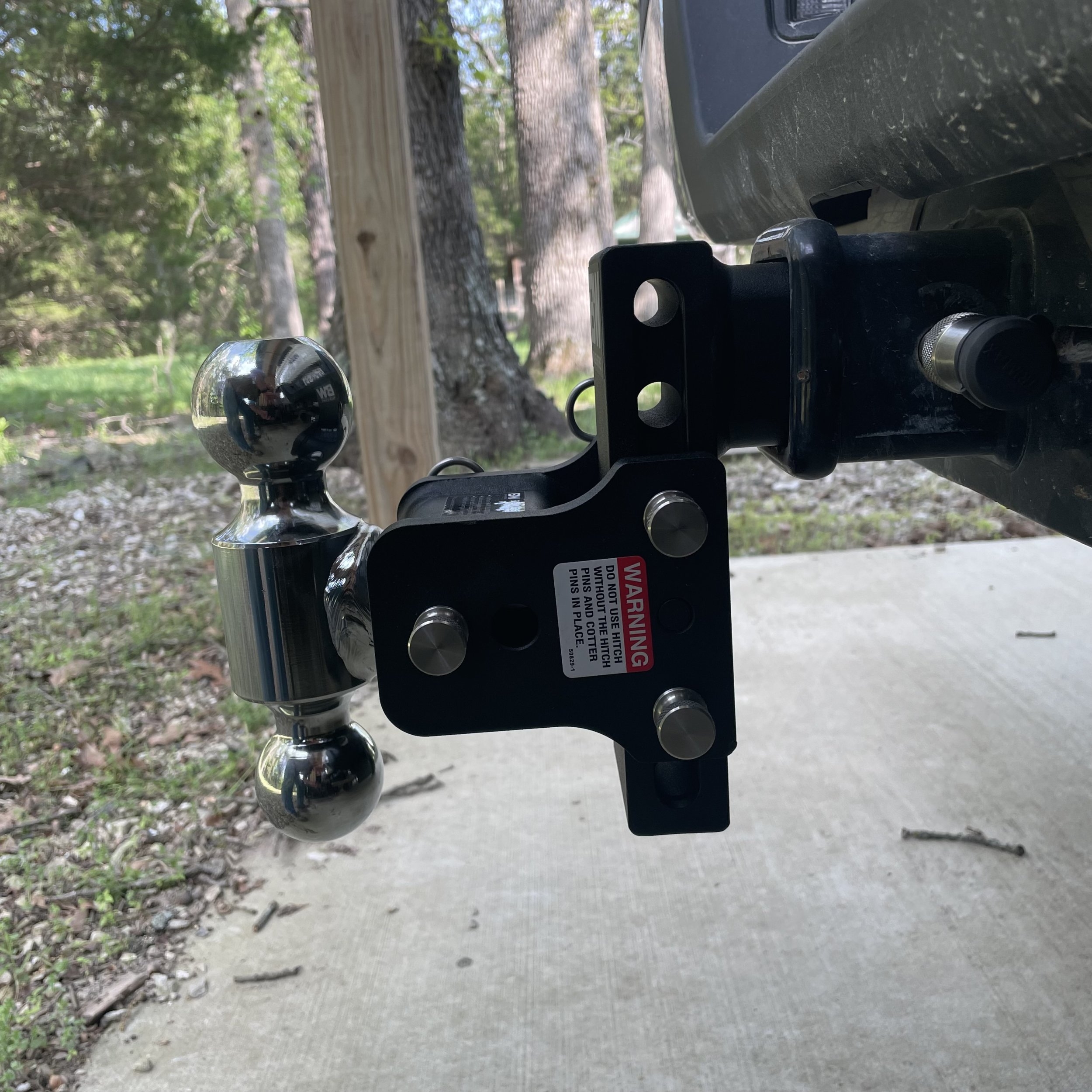

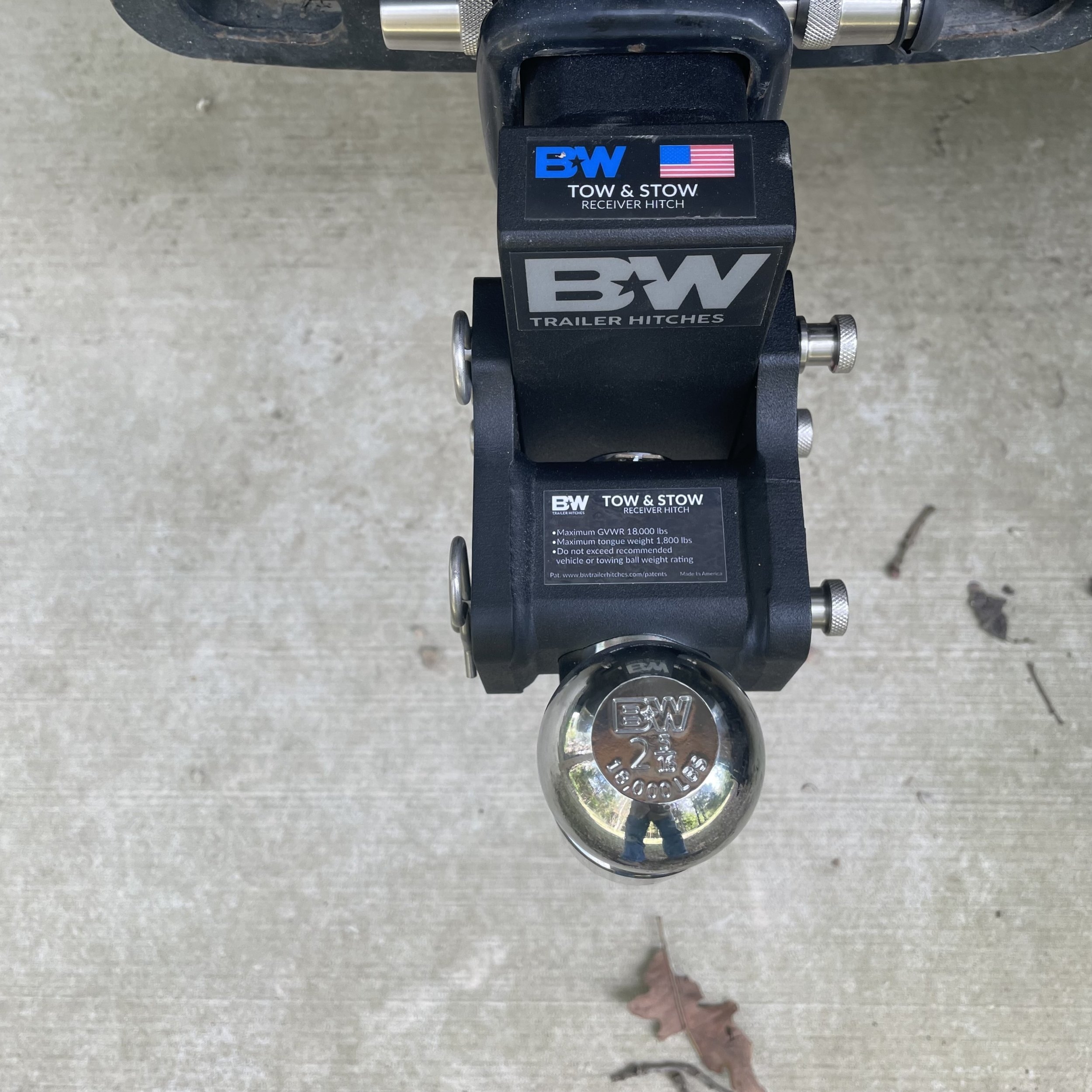

Good catch. I did not have a 2-5/16 ball so I picked one up at our local farm store. What I did not think about was the base of the ball was bigger, so it would not set properly, so in the pic the ball is tilted. Between me, the salesman and shop supervisor we decide i was good to get it home. It has already been replaced with a BW, 2-1/2 shank
That's the exact setup on my 2014 F250.

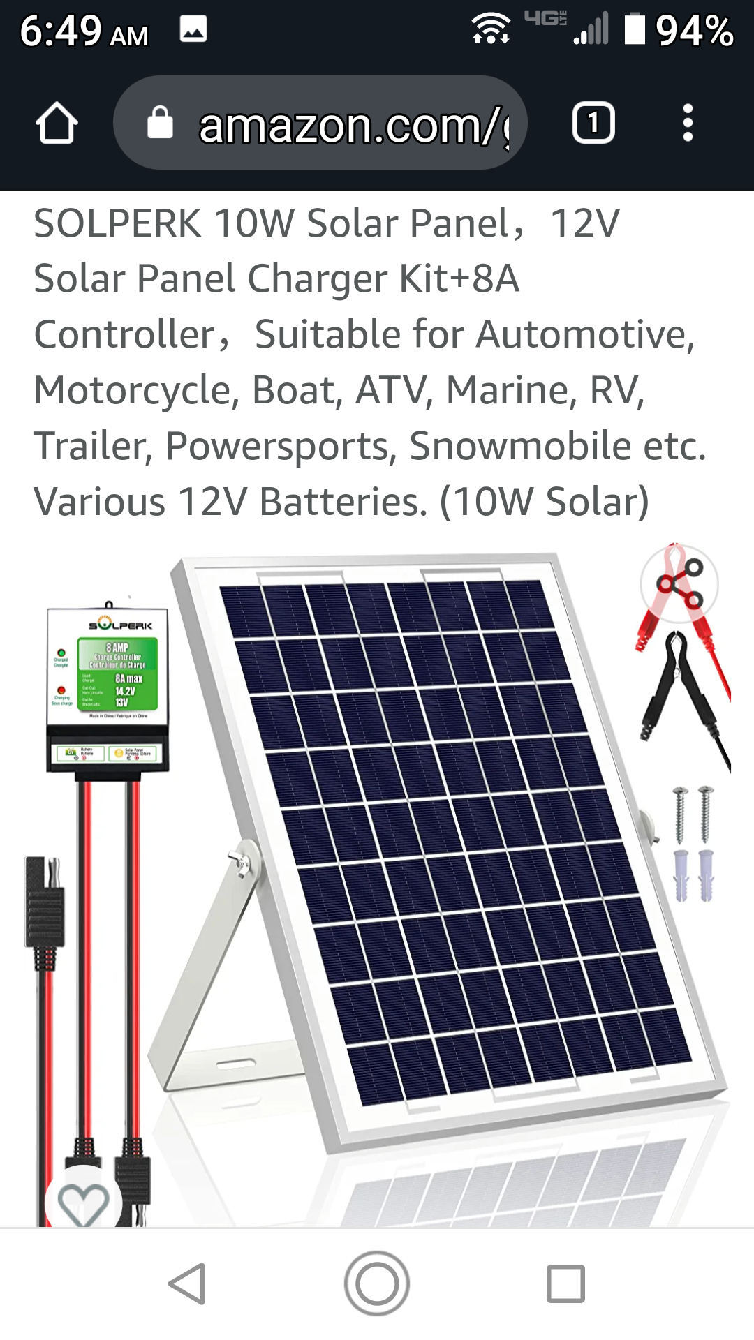

I know I will want a solar charger as this trailer will not be used daily. Any suggestions of brands, amps? I think I need a durable one, planning on mounting it to the top of the tool box. I know nothing about solar chargers.
