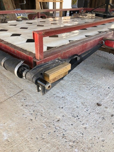

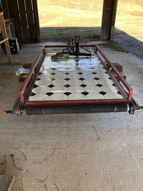

Your original proposal sounds like a variation of a parbuckle. (Google "Parbuckle" for images.)
My son uses a similar system for moving woodchips in his pick-up, He covers the whole truck from hood to tailgate with a tarp; after loading he takes the hood edge of the tarp back over the load to the tailgate to cover his load; at his house he ties the top rear corners of the tarp to 2 trees and drives away, rolling the chips onto the ground. (Disclaimer: Considerations of the density/weight of the chips, strength of the tarp and ropes, and speed of driving away are the responsibility of the practitioner.)
Your idea of using chain link as a "Mat" for its strength and a tarp to keep the stone, soil, or whatever from sifting through the chainlink has merit. Obviously, the load will be much more dense than woodchips and require strong lines. Also be aware that once the load at the front of the trailer has been rolled past the axle, the weight will be concentrated on the rear of the trailer, tending to bow the trailer, and the tongue weight will be negative, tending to lift the rear axle of the towing vehicle. Winching the load off may prove better than "driving away". Start light and experiment with incrementaly heavier loads.

Parbuckle… who’da thunk…
Yes, that’s exactly what I’ve envisioned… thanks…
Maybe I’ll continue collecting material for the bed parbuckle for heavier loads… keep the IBC totes for lighter items…

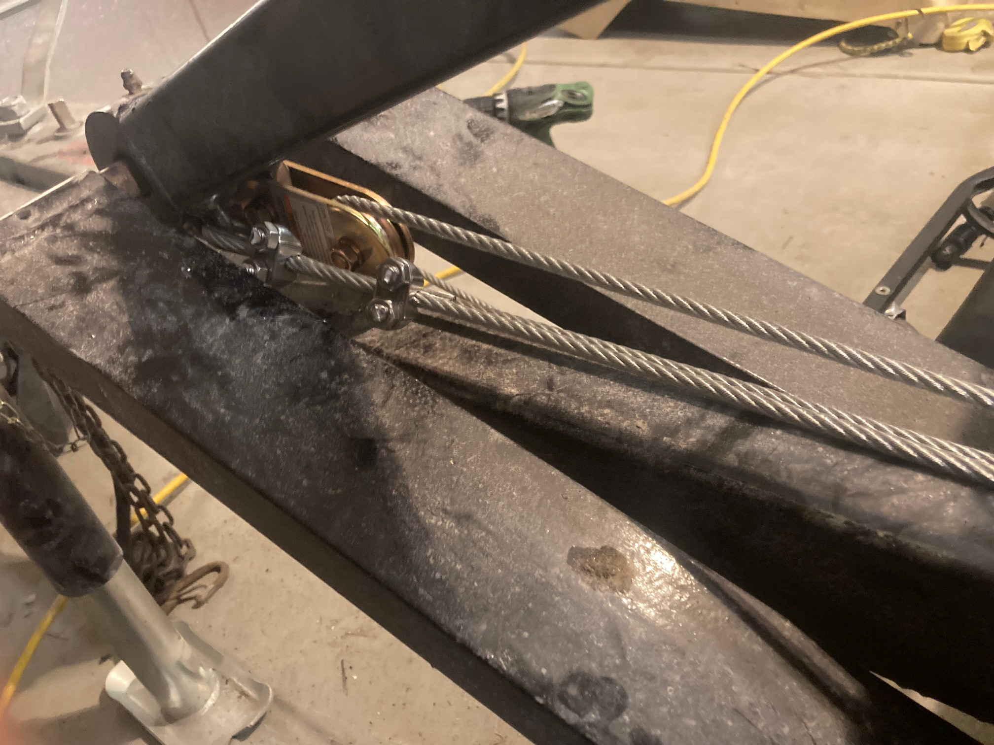

I use that set up on my trailer. Your right, the handle is too long. I JB Welded a socket in the end of the bar that the tarp wraps around and use a rachet with a cheater bar to unload. Works great on my 4x8 trailer that I use to haul dirt and firewood at the camp. I did staple a scrap piece of vinyl to the deck to reduce friction. My deck is wood. If yours is aluminum, it should not be needed.
I actually had hopes that my Milwaukee Impact Wrench would do the job, but not enough torque.
I had a similar problem with a long handle on an anchor winch on a sailboat. We solved it by using an cordless Milwaukee right angle drill and machining an adapter bit. Lots of people using that or similar setup now as a cheap & universal power winch for all sorts of marine chores.
It depends on finding the right high torque/low speed cordless right angle drill.
