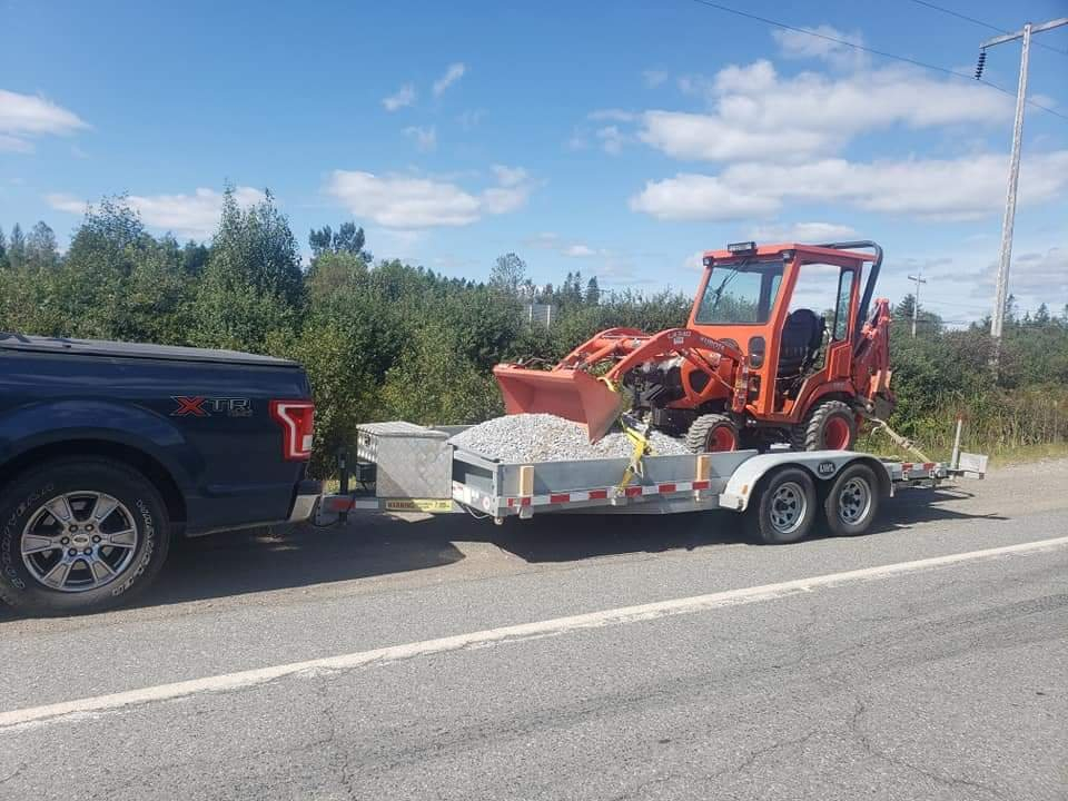

A little while back, on one of my BX Owners Facebook pages, someone posted that someone gave them a load of gravel they could have for free if they hauled it off. He got creative and this is what he came up with.
Then someone else commented below with this
That got my wheels turning. "I can do this". I thought it looked functional, and also looked presentable enough. I would love a dump trailer, but the MRS has already said "NO MORE TRAILERS". I haul my own mulch, compost, top soil, gravel, etc from local places just a few miles from home. Until now in the bed of my truck.

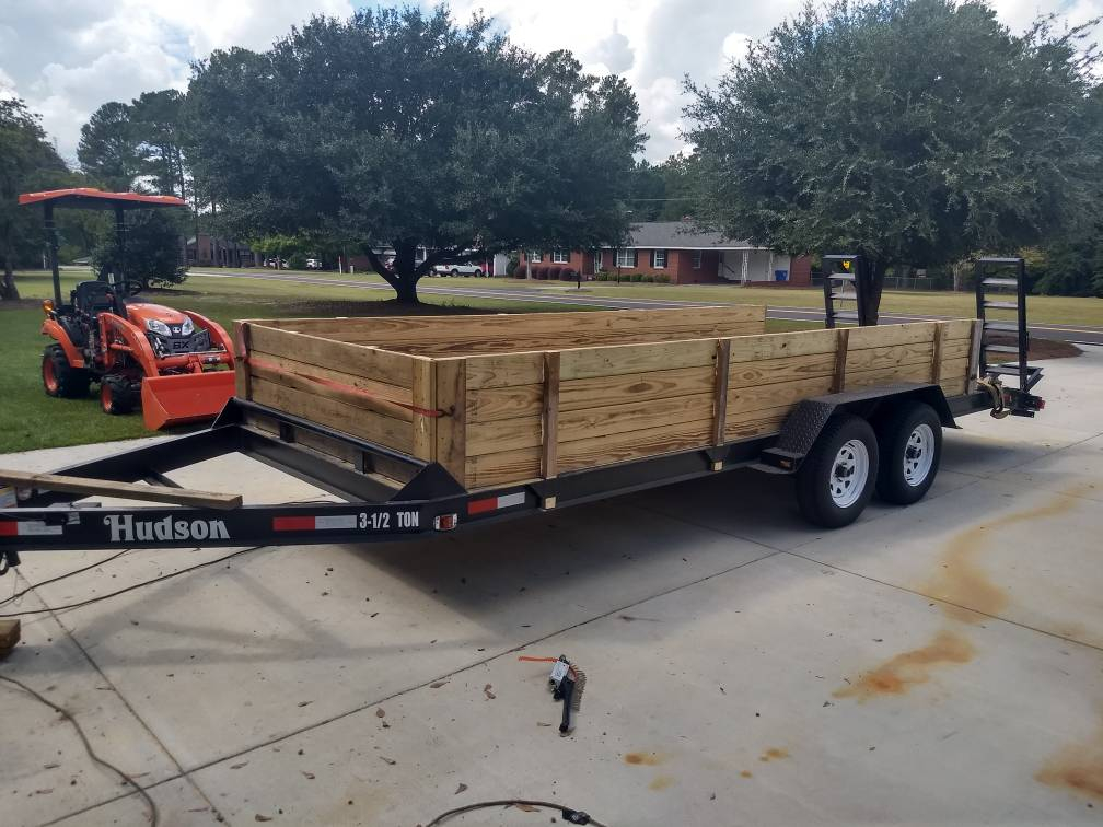

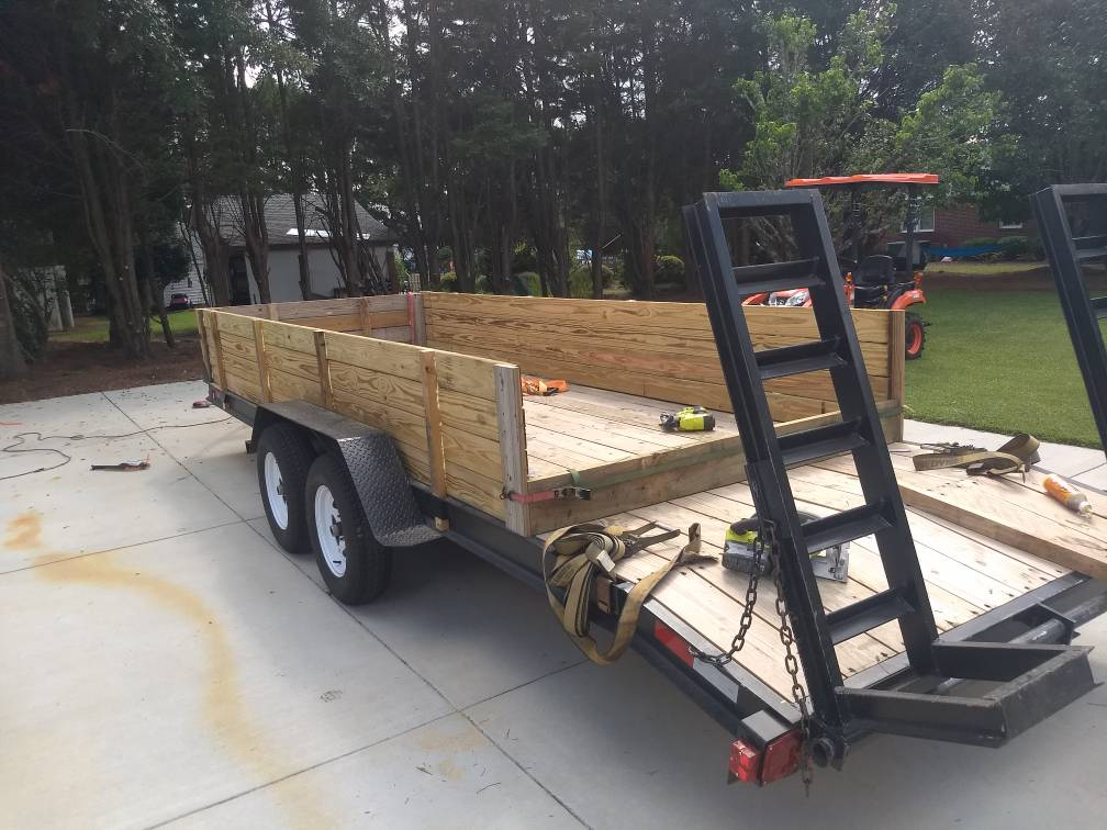

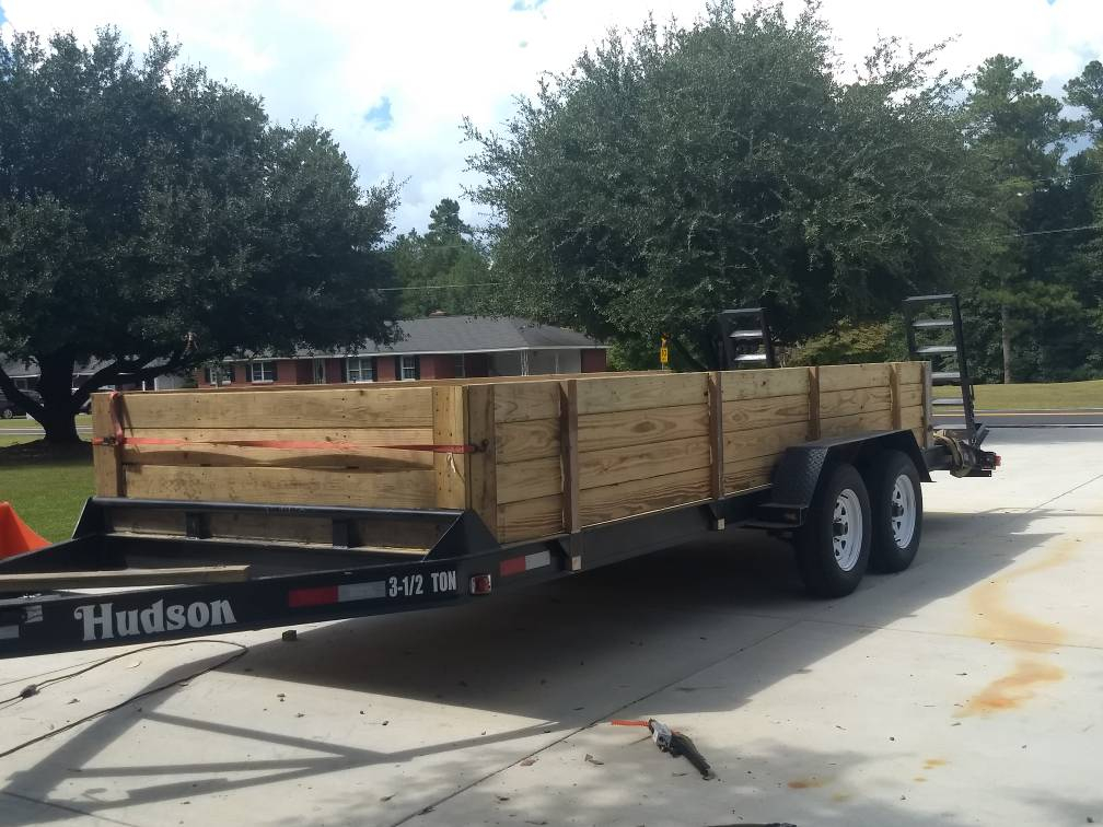

This is what I came up with:
The initial plan was just to put these on when I need to haul something. For instance, I recently got a friend with a landscaping business and a dump trailer to haul me 4 tons of sand and he charged $160. I didn't realize how little 4 tons would be. Turns out the sand is only about $13/ton if I go get it. I'll deal with unloading the hard way to save $100/load. I believe I can unload mulch or dirt with the tractor and bucket.
I built these planks to be easy to put on and take off, either with or without the tractor. I can do it either way just fine and I can carry them by hand to their resting place if need be. But, at my ripe old age of 33, I'm getting lazy. Hence the purchase of this trailer and a $15k wheelbarrow.

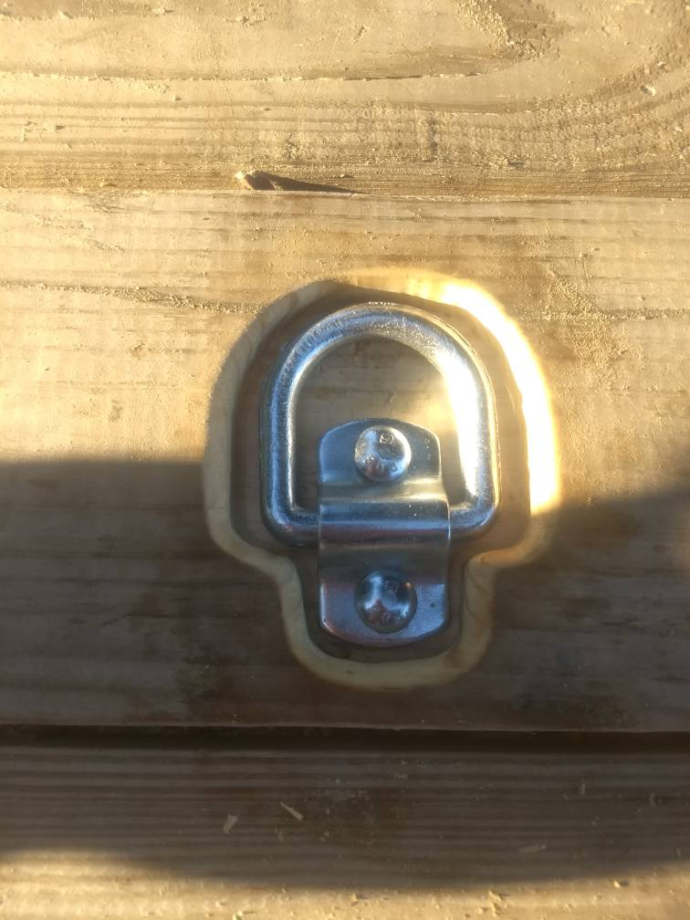

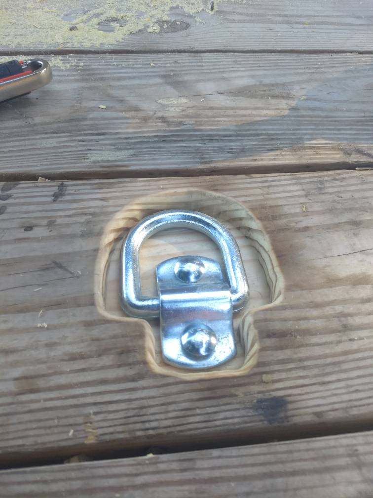

I would really like to leave the planks on, except they go into the same stake pockets that I need to tie down my tractor. Today, I cooked this up. They are 3666# WLL HD D rings from Lowe's, and are through bolted through the cross members under my trailer. I currently have 4 placed convenient to the ideal location to haul my tractor when the trailer is empty. Tomorrow I want to place two further back on the trailer that will be front tie downs if I ever need to tie the tractor down with a ton or so of loose material in the way at the front. If I had the tractor parked behind a pile of material, I'd use the second set of recessed D rings, and the rearmost stake pockets on the trailer, which are still available with the planks on. Now I can leave the side planks on and still haul my BX.

If ever I haul a heavier tractor, car, truck, etc I can still pull the planks off and use the stake pockets.

Yes, the gravel has to be covered. I'm not sure what made you think I won't tarp it. I'm fairly certain that it's the law everywhere for loose materials to be tarped.
I don't understand the second question. The side planks rest on floor that is already there with no gaps. Don't need two of 'um.

In that second picture that I posted of yours, has a board running across your deck boards. At first glance it made the deck boards looked raised ahead of it. But in reality, that cross board is your tailgate. I stand corrected. Jon

Nice looking job. Looks sturdy and able to handle just about anything you might want to put on it. It would be easy to overload that with gravel though.
I am in the process of reclaiming the sideboards I made for my car hauler since I don't plan to use it that way again. Simple 3/8s ply some 2x4s and a little hardware and a tarp to move 5 loads of misc. stuff from the west side to the eastside, averaged 225 miles each way. It did the job and kept everything dry over the mountains.
The first pic with the Kubota and the gravel really belongs in
It looks to be a minimum of two yards probably pushing 3 loaded all the way to the top of the sideboards and not covered. Unless that is a 14k trailer, it is just a smidge overweight I would guess.
I actually thought the same thing at first, I had to go back and look at the picture again, it was an optical illusion.

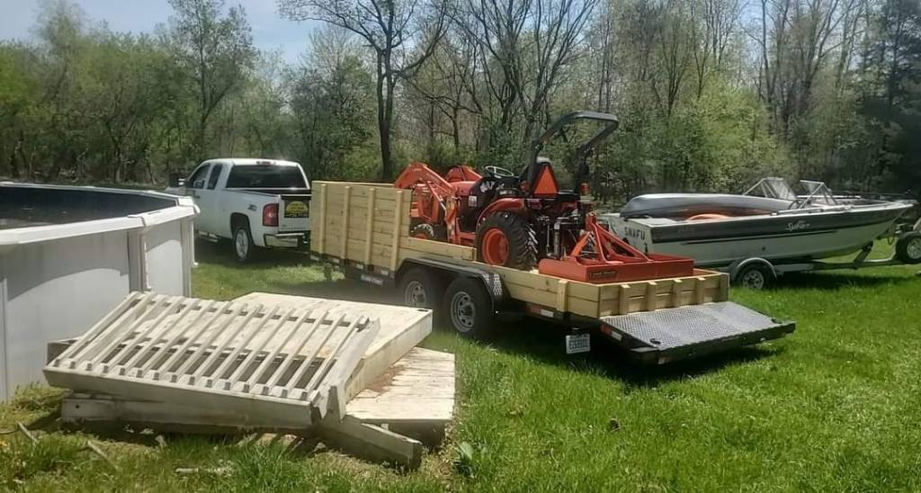

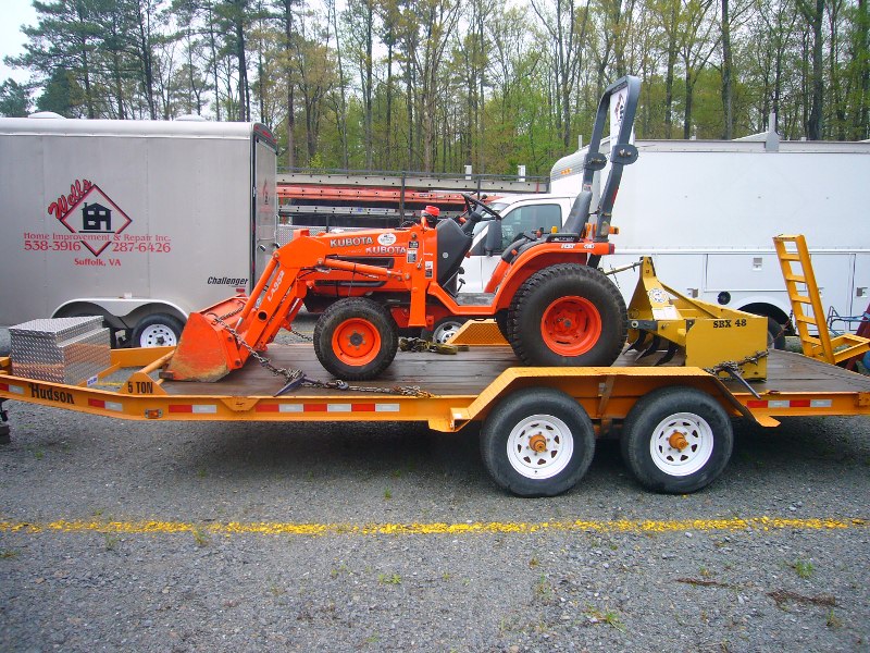

Hudsons are so adaptable.

I've been borrowing one since I was 15. I've window shopped Craigslist specials for a year or so now. I've looked at a lot of homemade headaches. It's nice to finally own one of my own!
