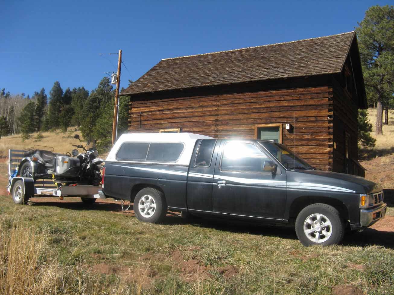

I have a small Aluma 638LW (63” wide, 8’ long) with a removable loading ramp… the trailer‘s GVWR is #2000… enough to transport my current needs…
(this isn‘n a great pic of the trailer but it’s all I could find)

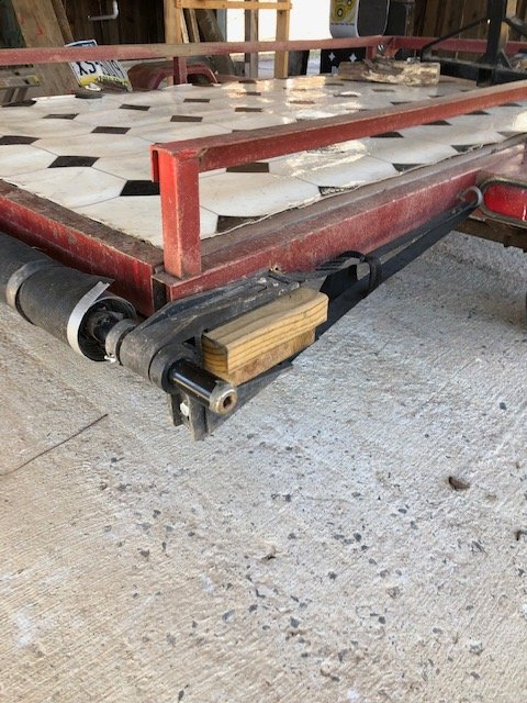

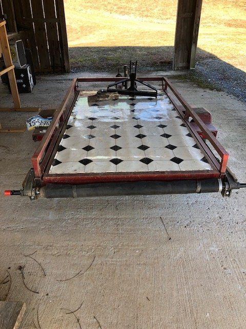

I use that set up on my trailer. Your right, the handle is too long. I JB Welded a socket in the end of the bar that the tarp wraps around and use a rachet with a cheater bar to unload. Works great on my 4x8 trailer that I use to haul dirt and firewood at the camp. I did staple a scrap piece of vinyl to the deck to reduce friction. My deck is wood. If yours is aluminum, it should not be needed.
I actually had hopes that my Milwaukee Impact Wrench would do the job, but not enough torque.

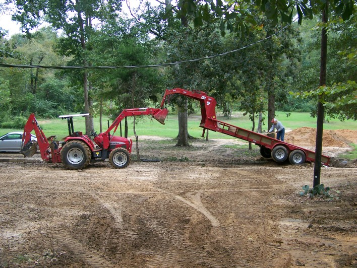

Maybe not a good plan if the hitch slips off the bucket and tears up some hydraulic lines, and it looks like some hand shoveling is needed.
The thought was a hook and chain here so that doesn't happen

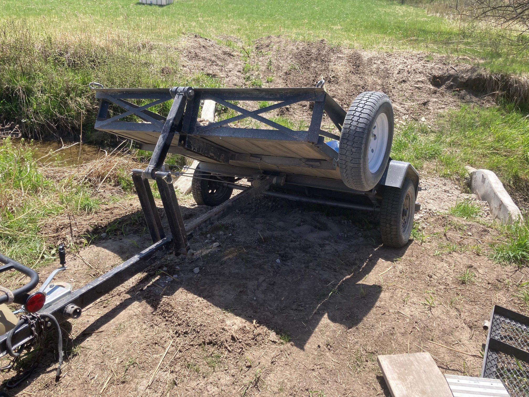

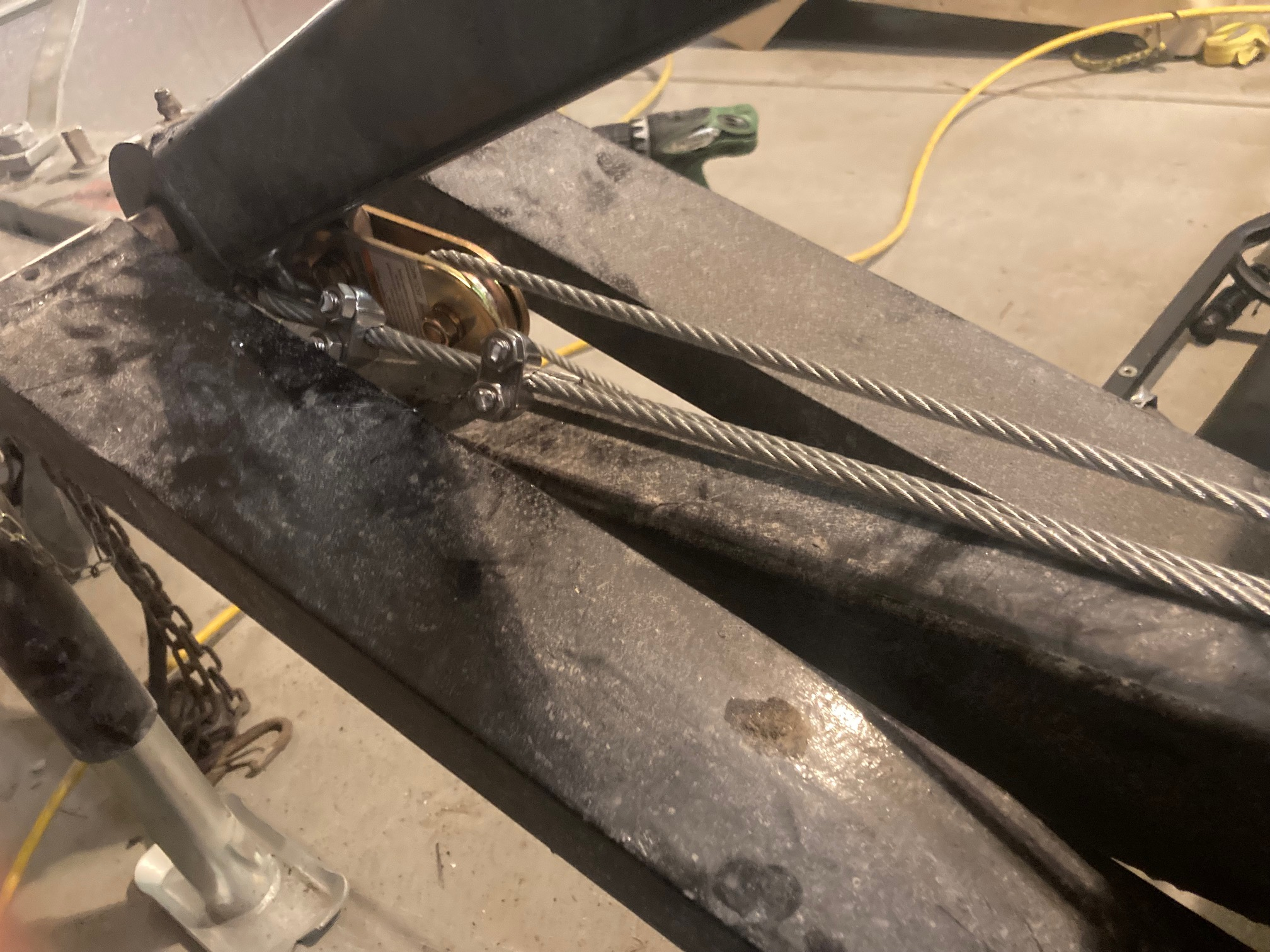

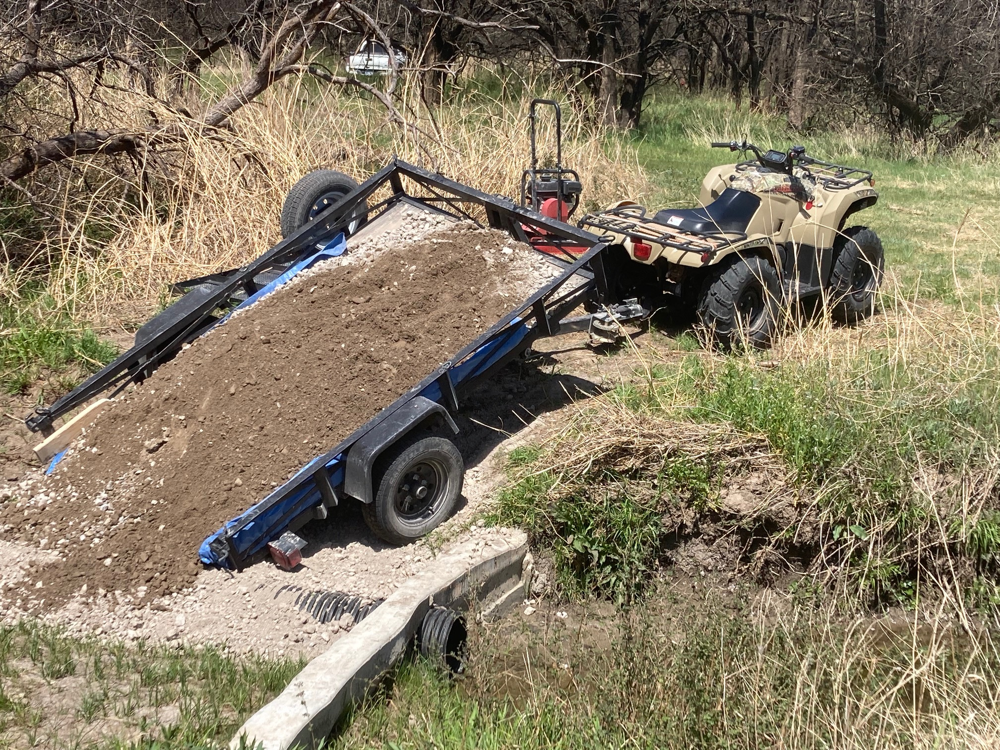

If you're a welder, you can make your current trailer into a dump trailer.

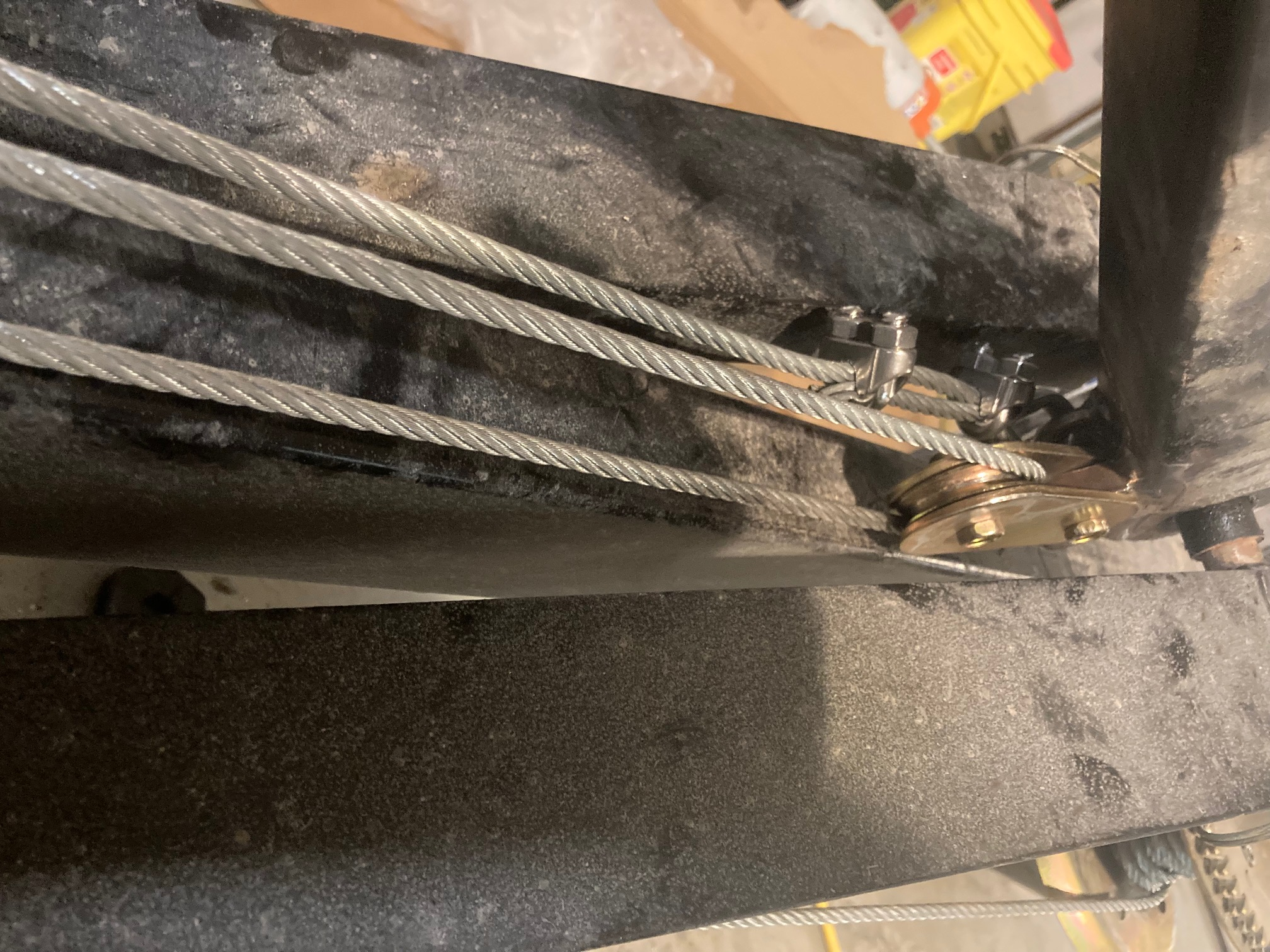

I have a standard 5x8 trailer I made dump. I added a piece of C-Channel to the frame above the axle, and built a toungue to extend back to that channel, with a heavy hinge on it. It uses a hand crank winch to raise it. My first attempt I had a single pass of cable and it popped before lifting 2,000 lbs of gravel. I reworked it with some pulleys to get 3 passes of the cable and now it will dump 2,000 lbs of gravel easily.
I also added cross bracing to strenghen the trailer and replaced the tires load range E radials.

I was at the camp today and took a few photos of the load handler mounted on my camp trailer.
That little trailer is a tilt as well, but the material would not slide off as easily as I liked, so that is why I got the load handler.
