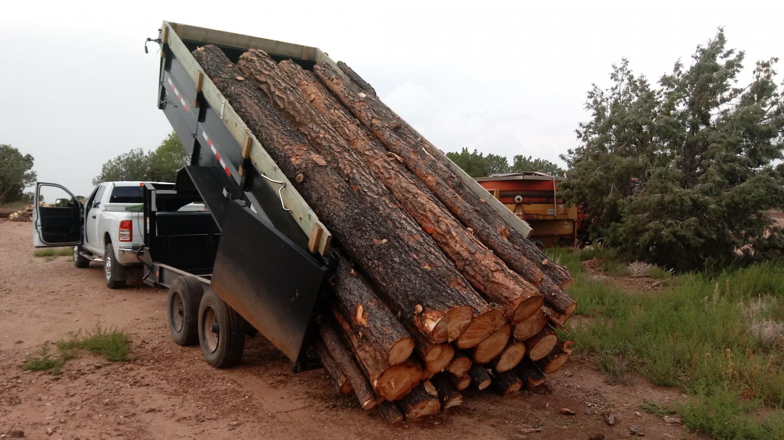

I've hauled 100's of similar or larger loads with my F150. The gravel pit I go to loads with the corner of the bucket also and they do a pretty nice job. However, sometimes you get it loaded more front or rear heavy than ideal- it's hard to predict precisely how the gravel is going to dump. I can tell by looking how the trailer is loaded and carry a shovel to adjust things if necessary. It's never more than a minute or 2 of shoveling to shift the weight how I like it. At the same time I clear the fenders or any other locations of loose material. It's much better to be tongue heavy than tail heavy.
/ Loading issues on Dump Trailer #157
Amazing...154 posts...did we lose the OP?
What was the chosen way forward???

I believe he is waiting on a couple quote from some heavy haul companies to make sure he can move his fully loaded dump trailer safely. According to this thread, turns out a half ton can't move it and will break in half... :)

I find the fact that we are debating whether a half ton can tow the OPs load rather amusing. Because he showed us all directly, how his can't. He can't handle the proper amount of tongue weight for safe towing of his load, Period. Could some max'd out levers on a WD hitch, or helper air bags keep him more level? Sure, but that is only masking the inherent under capacity of the base vehicle itself. Am I wrong?

What I find amusing is the above statement. What the OP is showing us is that he simply wants a better load placement on the trailer, NOT that his truck cannot handle towing the trailer and load he wants.
