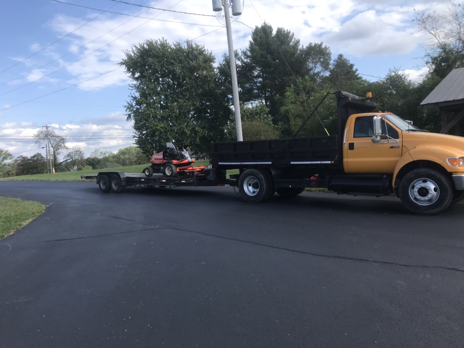

I agree. I use my 750 to move my lawnmower. There’s no way my 250 excursion or 3500 could do the job.
/ Loading issues on Dump Trailer #115
I agree. I use my 750 to move my lawnmower. There’s no way my 250 excursion or 3500 could do the job. View attachment 714632
Hope you have a WD hitch, looks like too much tongue weight.
And what if a basket of bunnies suddenly blows into the roadway! Will you be able to stop that load in time?
You better just step up to a full size 7 axle dump for that load
