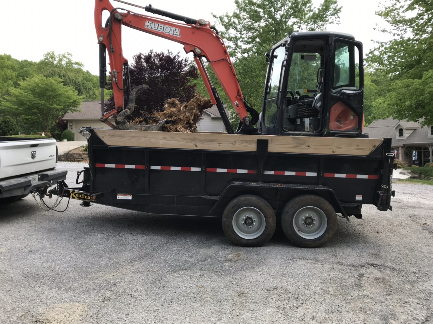

From the picture they are biasing to the front, if they centered the load in the trailer you should be about right for tongue weight.
It's common at my quarry for them to automatically bias to the front, guess they'd rather have someone with too much tongue weight then not enough.
If they "center the load" it qill pull like crap and pretty much be dangerous. Trailers are built to have 60% or more loaded to the front.
They are doing it right, loading nose heavy. The issue is, the original poster doesn't like his back bumper dragging the pavement when loaded close to his trucks maximum capacity. He wants more of the weight carried by the trailer which easily becomes dangerous.

The axles are set back from center, if they loaded the bed centered it will still provide a forward bias compared to the axles. Loading front heavy on a trailer that has axles set back will put excessive load on the tongue, especially for lighter duty tow vehicles with less margin for error.
Most good dump trailers will have the axles set back enough that loading the bed centered will provide adequate tongue weight for safe towing. His appears to have proper axle placement.

The way the trailer's geometry is setup, because the center of the bed is ahead of the center of the axles, you are guaranteed a front bias if you load the bed evenly. If they could do that everything would be fine. But when they load the bed with a front bias on top of the front bias of the trailer geometry, it's too much tongue weight.
To me this is simple, you can see that in the basic physics of the trailer layout and I could verify it with the scale data. This should not be complicated to understand.

I got a 6x12 10K dump trailer earlier this year. Due to tow limits of my 1/2-ton truck, I never purchase more than 3 tons of material. When loaded properly, the trailer tows great. But I'd say 80% of the time, the local yards load me with a forward bias, creating too much tongue weight. I picked up three loads today and they were all forward biased, some worse than others.
I installed a W.D.H. to help in these situations, and it does what it is supposed to but won't cure poor loading or too much tongue weight. While pulling onto the scale for my first load this morning, I carefully noted the measurements as each axle went onto the scale, before and after being loaded. While eating lunch I did some math. The trailer has only 300# tongue weight when empty, which matches what I measured with a bathroom scale a couple months ago. When loaded too far forward, tongue weight was 1140#, more than my truck is meant to handle and visually way too much even with a W.D.H. If loaded evenly, it should have been in the 700-800# range.
I'm trying to decide how to deal with this. At this point, my only solution is to carefully raise the trailer bed to shift some of the material rearward, but that is a pain to do and needs careful judgement (not all loads slide the same). I am wondering if I should fab up some sort of sealed chamber at the front of the trailer bed to block off volume so that material cannot physically occupy the front couple feet of the bed (it would have to be angled to force material to flow to the rear). Somehow I need to prevent operators from loading with a forward bias and the only solution I can think of is to eliminate that volume. Any other ideas?
Have you thought about a weight distribution hitch (Reese is good)? I used one when I had a light duty F250 pulling a heavy horse trailer. I plan to use one with my heavy duty '96 F250 with a heavy trailer. I also had extra shocks installed in the back to prevent the back of the truck from dropping too much. Of course, distributing the load correctly is needed as everyone says.

Most operators will bias the front of the box because that is where dump trucks want loaded and on trailers too much tongue weight is safer than letting the “tail wag the dog”.
I have had a few loads loaded too front heavy. Lifting it to shift the load is not going to work, you’ll just end up with the whole load at the back. I keep a shovel in the toolbox and will move what I have to, to drive safely.

Ask the loader operator (or the scale operator if they radio the loader) to have them center the load in the bed and ignore where the axels are. Your axles are behind center for a reason - for forward bias to eliminate wagging. The engineers that designed the trailer knew what they were doing. The axels will take 90% of the weight of the rig+load. That is why you have two of them and why they are where they are.
Don't "block" the forward space, that will just make a bad load top heavy when they bury your block, which is worse.
