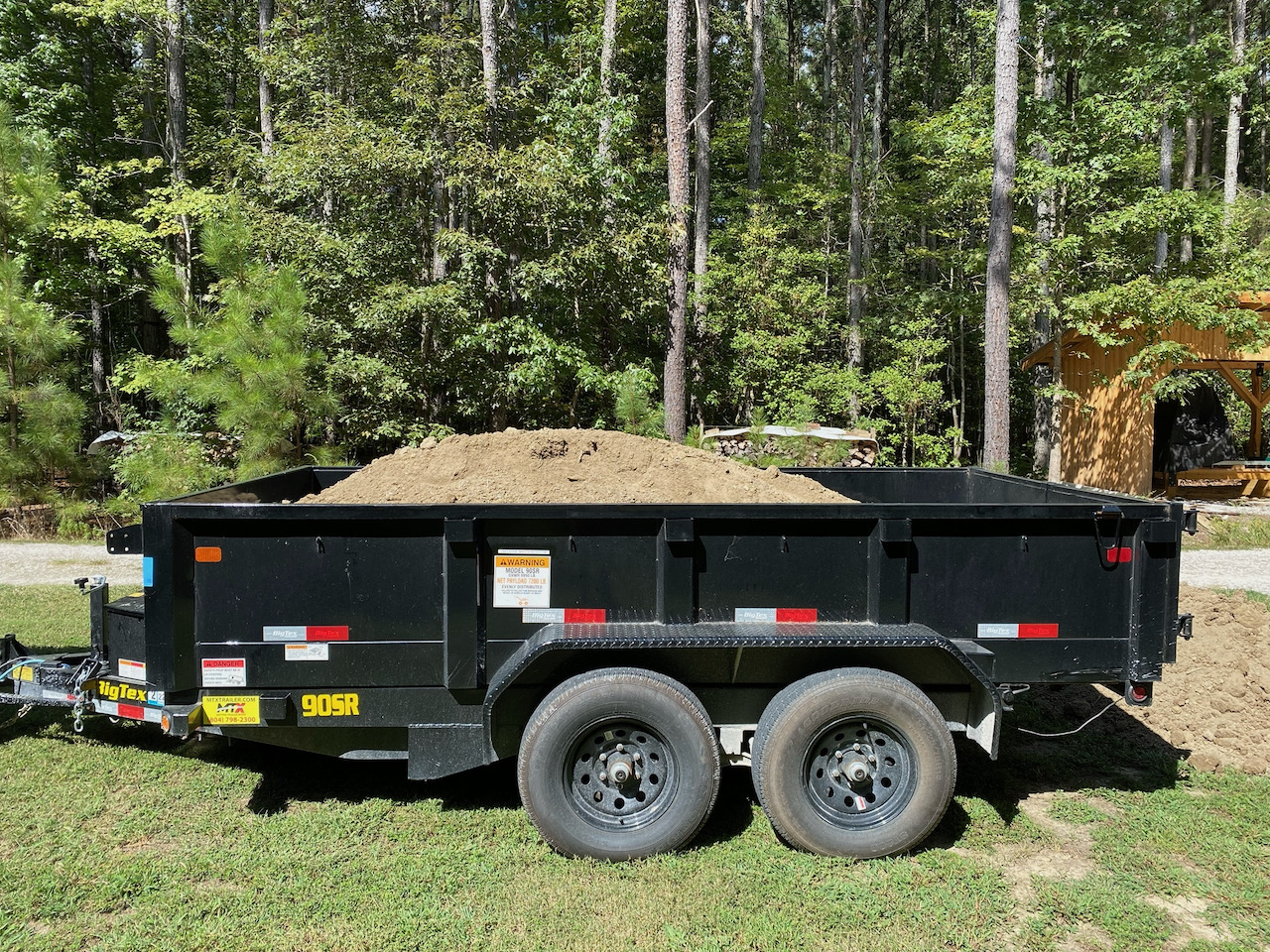

Forgot to add photo, this was one of the loads from today:
Never let them load without giving them direction.
If the person doesn’t want to listen don’t pay till they get in and shovel it where you wanted it.
I almost always direct to the loader how to load, with the only exceptions really being those who I have dealt with for so long that I can trust them to get it right based on the trailer. What you need to understand is many of those guys loading in some places have very minimal training and sometimes the person training them has no real experiance and really isn’t qualified to be a pimple on an operators butt!
Remember there is a difference between someone who can get some dirt moved around and a Real operator.
