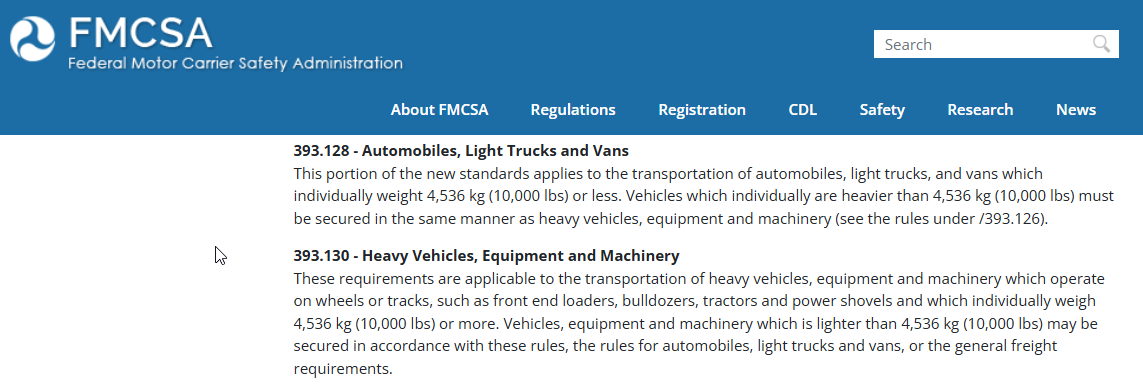

@RayIN posted a good guide.
So for the legal aspect of tying down. Per 393.128.b.1 since you load is under 10K you must have at minimum 1 tie down on the front and the rear of the tractor.
However since you have a loader and a backhoe 393.130 applies. Per 393.130.b.1 you must also fully lower and put a tie down over the loader and a tie down over the backhoe. This does not count as your front and rear tie downs.
I prefer to go above the minimum and when hauling a backhoe I will run chains on the tractor like @Shawn T. W. but go from axle knee to opposite trailer side rather than to the brush guard / weight bracket. This controls the sideways motion and put the tie downs on completely separate parts of the tractor so in a crash you have a lower chance of that part failing. I use 3/8" grade 70 but in your application 5/16" would be much easier to handle and plenty strong. If you have 4 chains on the tractor DOT generally will leave you alone as that is what 393.130 requires.
Over the loader I run a chain between the bucket and the arms.
On the backhoe I run a chain through the bucket linkage as it will control the back and forth better.
There are lots of ways to tie equipment down and everyone has their own idea. But I would view the law (1 tie down on loader, 1 on tractor front, 1 on tractor rear, 1 on backhoe) as the minimum requirement.

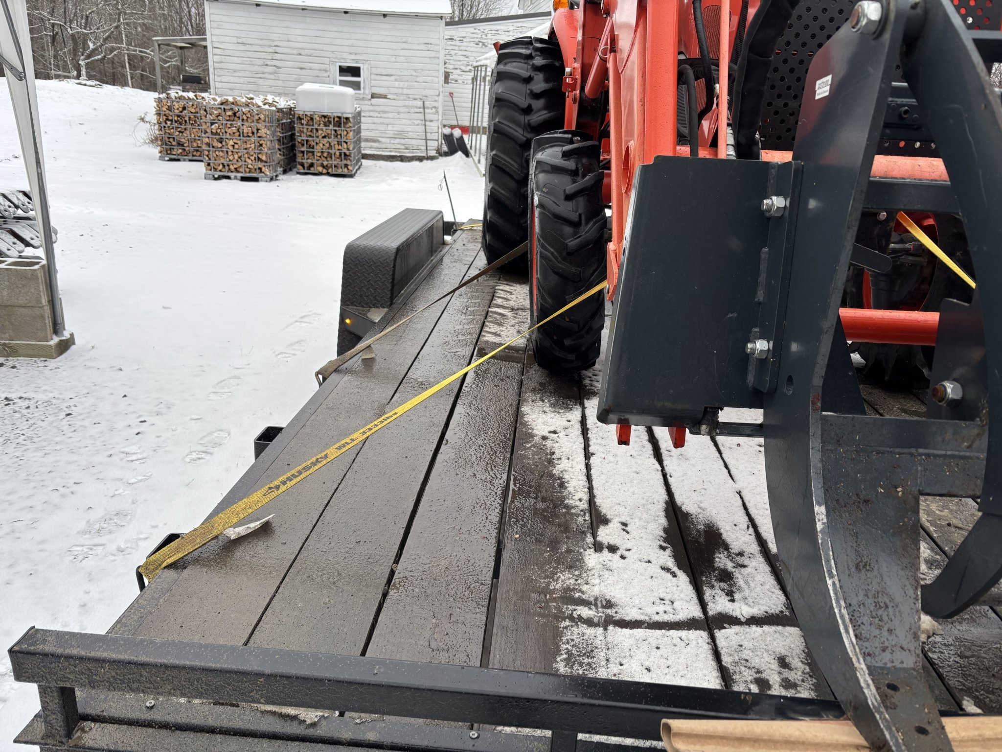

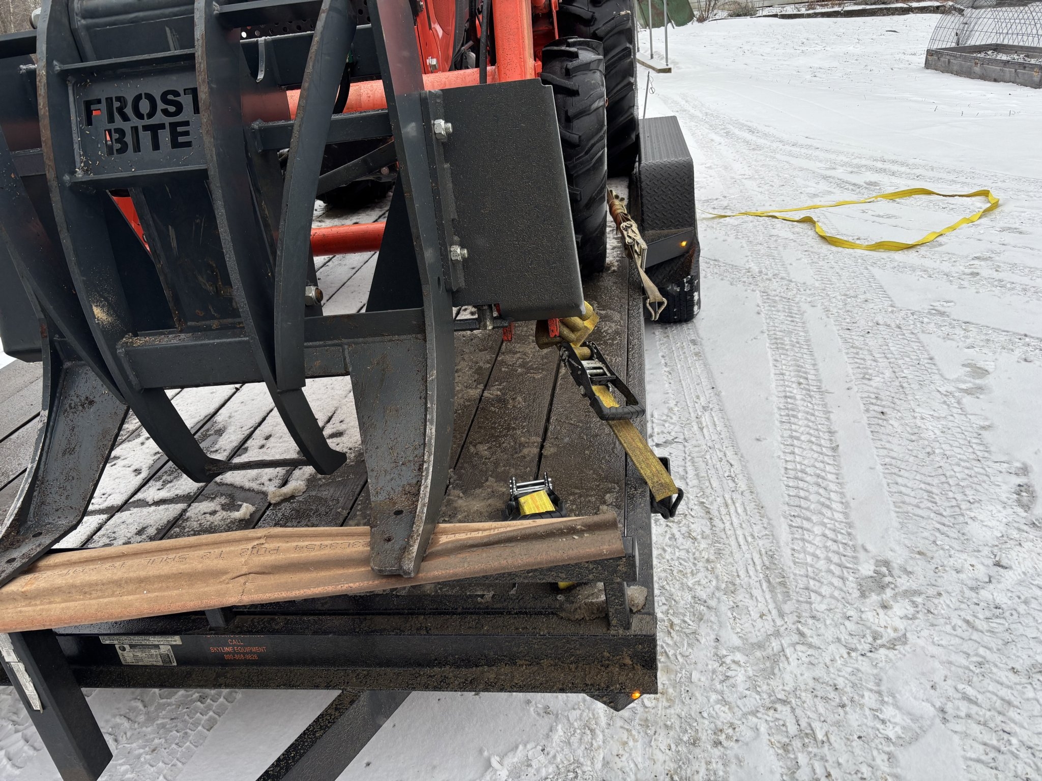

Just saw the following posted on another forum, posted yesterday ... They wrote:
The other day I trailered my tractor to my friend’s house five miles away. I used three straps, one over through the clevis on the drawbar, one in the middle over the backhoe frame, and one over the frame at the front where the brush guard mounts.
I will NEVER do that again.
Around a turn, the machine slid across the icy trailer deck. Thank god it didn’t slide right off.
From now on, I’ll be using four separate ties to each corner.
And here are the provided pictures ...
Four separate straps/chains on the tractor would have prevented this ...

/ Correctly tie down John Deere 3032e #11
As would a half hitch at the clevis. A three point triangle tie down, needs a half hitch at the center point or you can have side movement issues.

Equipment under 10,000 pounds can be secured the same as automobiles per the DOT FMCSA rules. That only requires two tiedowns, one tiedown on the front and one on the rear. I agree that four is better and not that hard to do.
