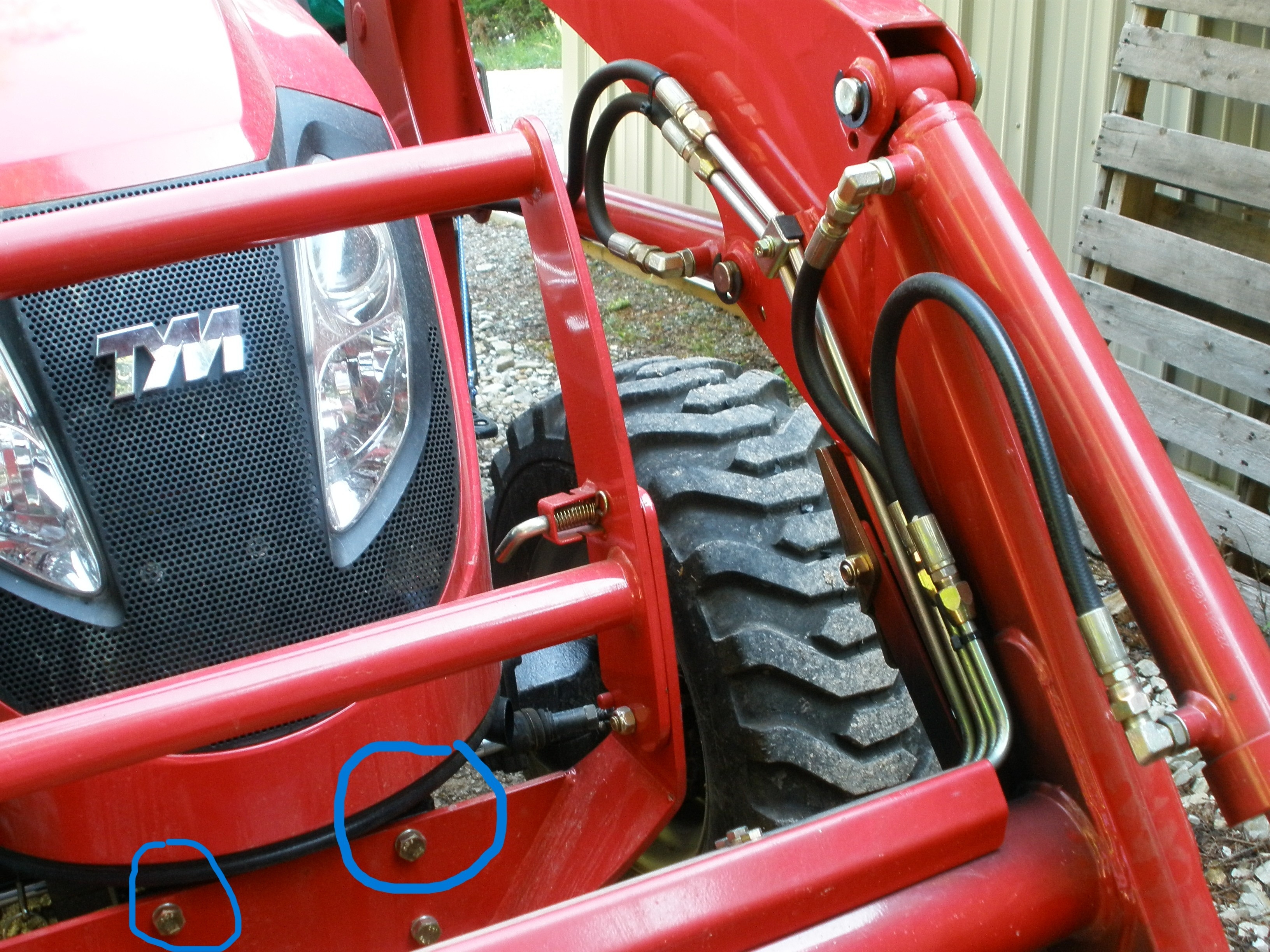

I replaced two of the bolts on the front frame with eyebolts. These bolts are threaded through the frame so I installed threaded bolts that were longer and I added a washer and nut to make sure they held. I use the eyebolt to tiedown the front of the tractor when I trailer it.
The picture shows which bolts I replaced, I never took a picture of the upgrade.

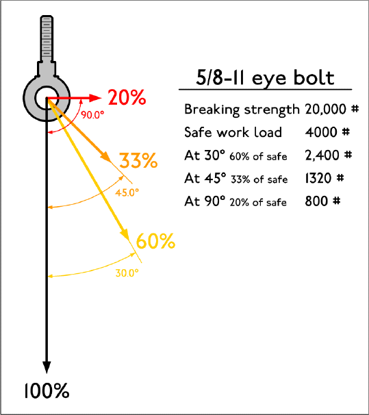

Im not sure of the shear strength of a bolt on device to hold back a tractor…especially a tractor hooked to a trailer that is involved in going from 60mph to 0mph in a matter of seconds….. think crash
/ Bolt on tie downs
The majority of frame connections on the T233 and T293, are bolted. And depending on what steel, at what heat treatment that steel has, bolts are better than welding, if you don’t have the ability to stress relieve the welds and re-heat treat the steel.
So, I would rather stay with bolted connections like the factory engineers did. The strength of bolted connections is pretty much dependent on the quantity, grade and size of the bolts.
