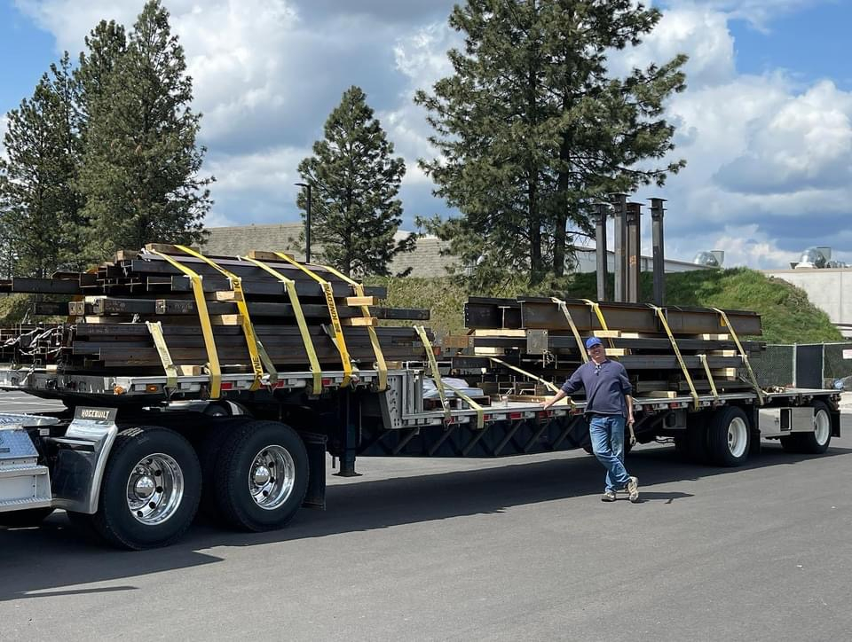

Chains are generally used for dynamic loads (equipment with tires/tracks). Straps are generally used for static loads, like these steel beams I fastened before the trip. You’ll note that the edges where the straps rests on have corner protectors and cut section of used straps. Wood don’t generally require them unless it has sharp edges.
