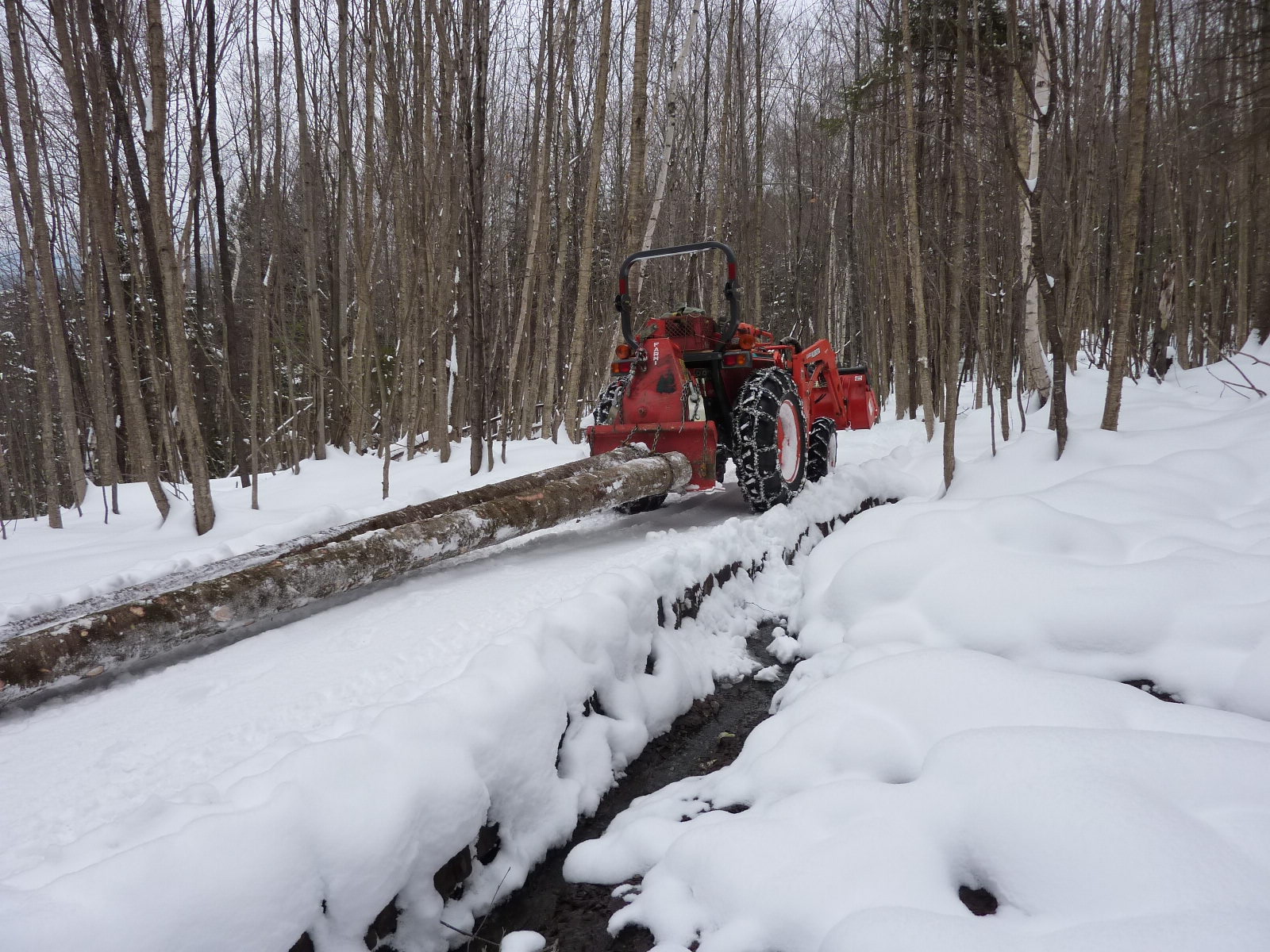

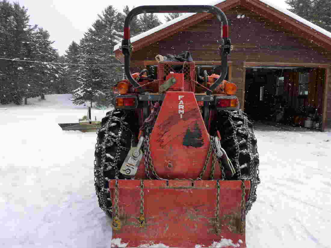

Thanks for the input. Do you guys think Ag tires will be alright or should I look into some chains
   / Thinking about logging #24
I used to pull logs like that with an old Massey Harris (same as Massey Fergueson) 50. Probably about 35hp. I agree with what others have said, hook up a draw bar to 3pt hitch and sinch up the log with a chain close to the bar so you can lift the front side a bit. You should be able to pull it without a problem. Should be a fun project.
   / Thinking about logging #25
Chains help but I would try it w/o the chains if there is no snow. I have chains but except for a few areas only use them in the winter. If you are talking about running in snow try it w/o but be prepared to get chains because you will most likely need them. Snow tuns to ice when packed. I use a studded H pattern chain.
If there is no snow the ag tires might slip in gooey mud or if you have some smooth wet ledgey hills to climb. They will also slip on a big wet root you try to climb over. Don't forget to use your diff-lock when you need it. If you get stuck drop your log. Move ahead a chain length or two. Hook back up and pull the log ahead through the bad spot, then back into it again and pick it up. In the rough woods with a stiff framed 4WD tractor a lot of the time you really only have two diagonal wheels on the ground because nothing is flat. After a while you will know how to pick where to go for the best traction.

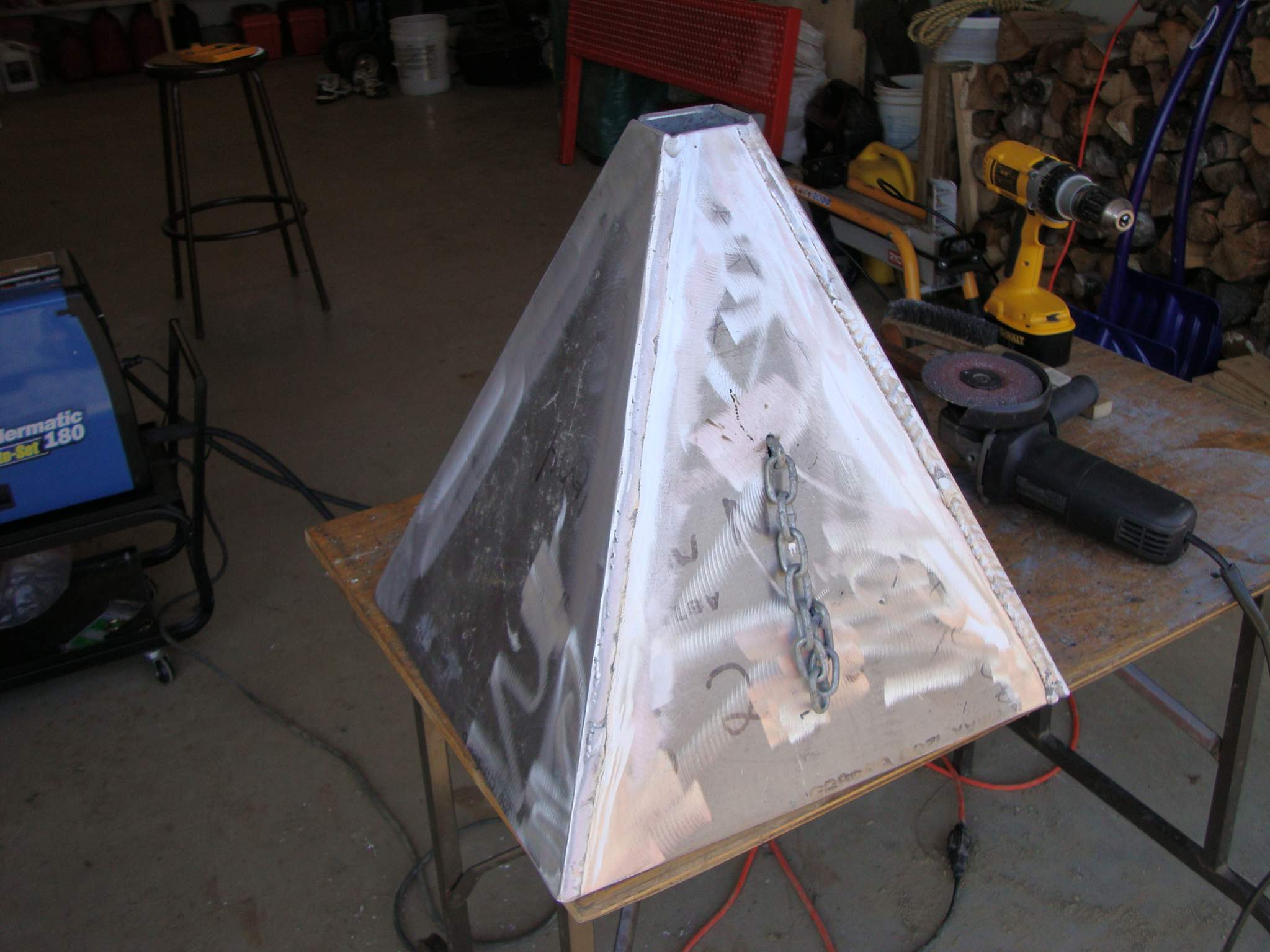

I have a log frame I built a couple years ago, it's essentially a log winch without the winch. You hook off the chokers to the hooks at the top, lift the butt up so it's tucked in behind the frame and can't hook on anything, and away you go.
It is about as safe as skidding logs can be, which is to say you've got a decent chance of surviving.
I use a skidding cone to get the logs out to where I can get at them without them hooking on everything along the way.
I finally got tired of fooling with ropes and snatch blocks, and bought a second-hand logging winch this fall. If or when I'm ever finished with it, I should be able to recover most of my investment.
