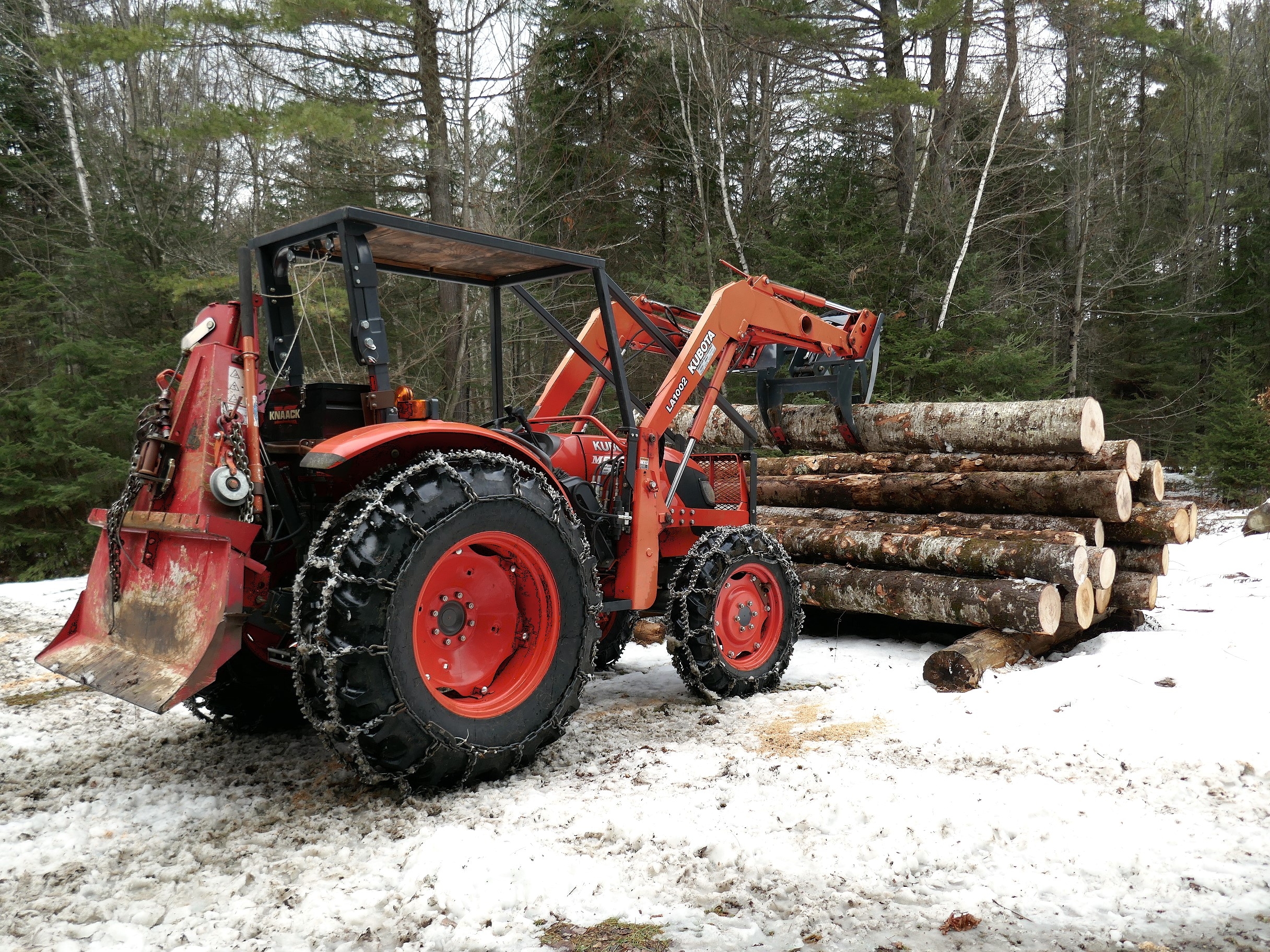

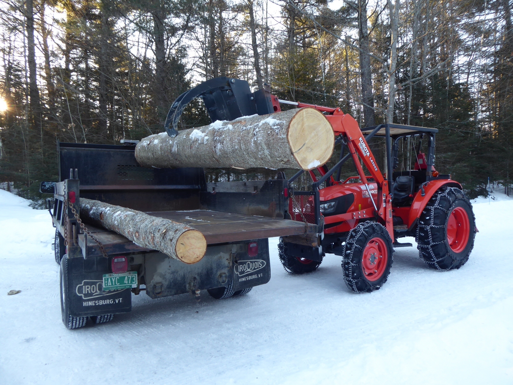

That production level is way over what I do as well. However, I would not be at all afraid of using a Kubota MX series tractor for that sort of work. I would be seriously concerned about using your NH TC33D for that - not only would it take a lot longer, the temptation to push the limits with the smaller tractor would be just too great for me. (Speaking from experience: I own a TC33D. I managed to crack the clutch housing. The only thing that kept my tractor in one piece was the backhoe subframe & and FOPS/limb risers I'd had installed some years ago. I was able to limp back home, and a local tractor & heavy equipment repair guy put things back together for me.)
I like the MX series for woods work: I researched a lot of brands/models when I considered replacing my TC33D. The hydraulics for loader on the MX series are not as exposed... more protected than some of the smaller Kubotas or competing brands. I would still look at adding a belly pan, limb risers, Falling Object Protection (FOPS) and grill guard. Possibly some other operator station and engine guarding, depending on whether or not you are doing off-trail work with this tractor.

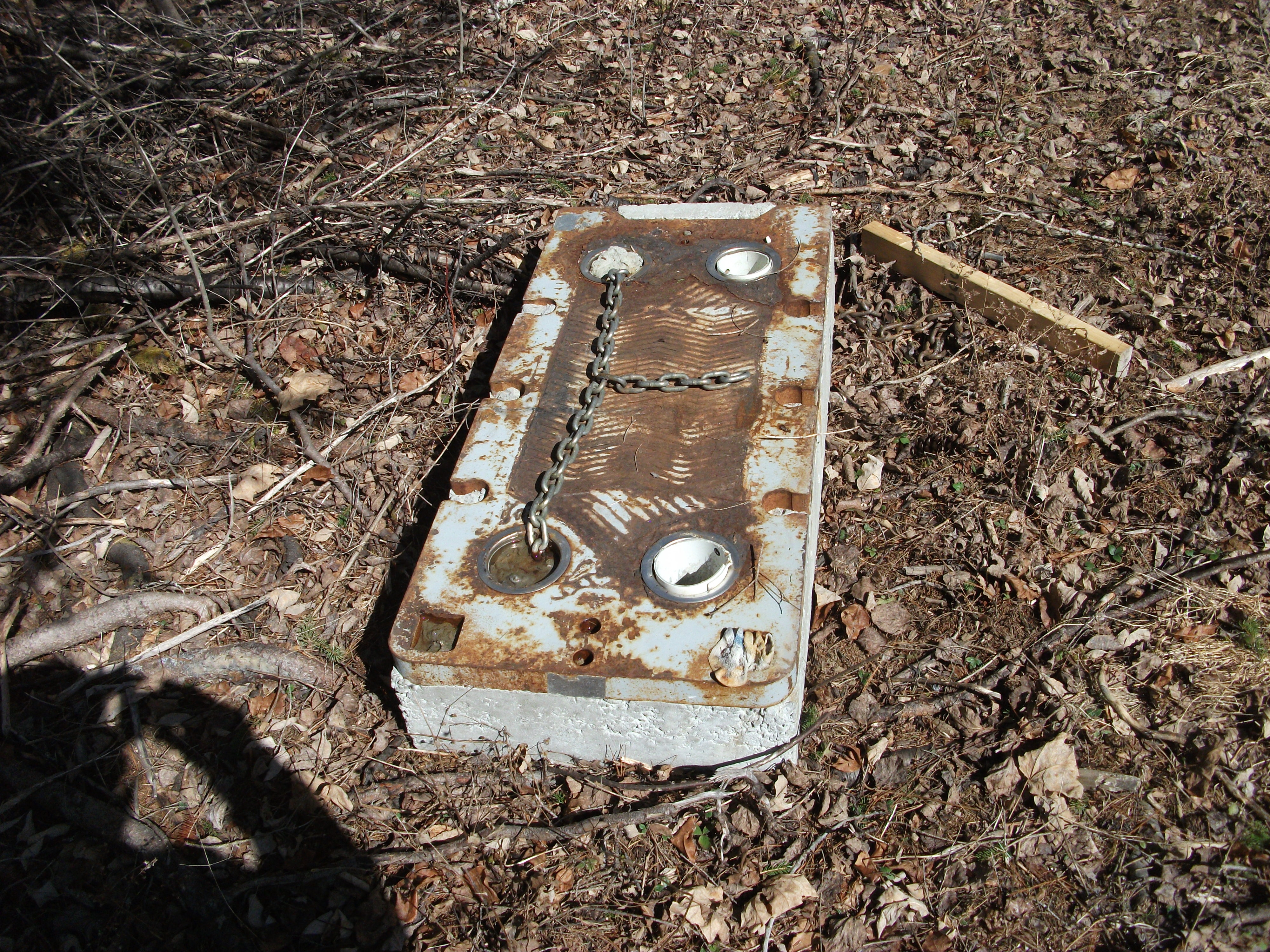

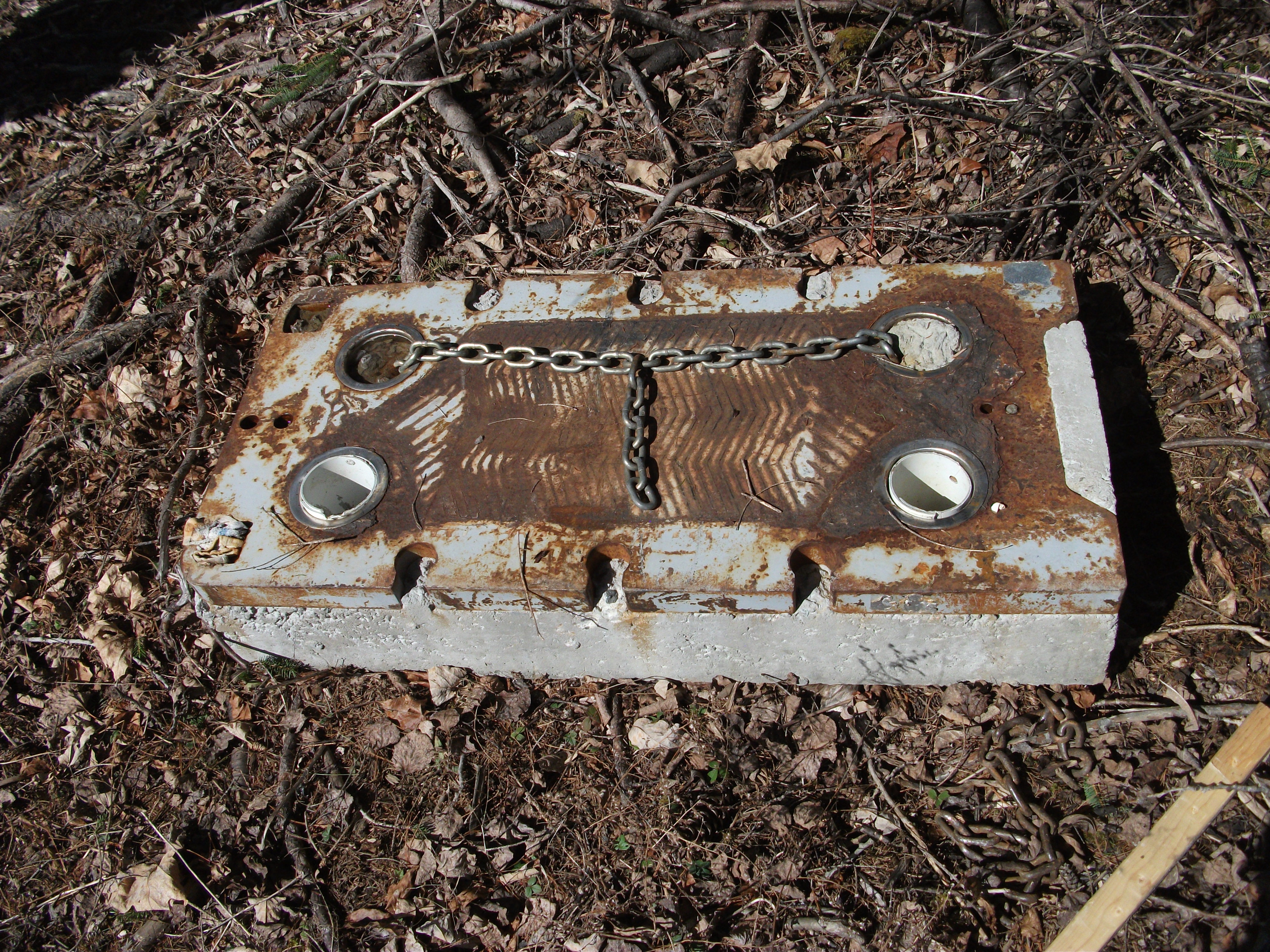

That's great idea Hoobie. How do you mount your counter weight ? Hang it off the slotted choker rail or some other way ??
gg
I poured a concrete slab around a 42 inch by 22 inch industrial heat exchanger metal plate. There were 4 holes on the plate. I buried the ends of a chain in the top two and left a tail on the chain. The bottom holes are open.
I back up to the weight, drop winch, hook a choker slider onto the tail and winch it up to the top pulley. It is now laying more or less flat against the back of the winch.
Then I run two short chains, one on each side, from the slotted choker rail through the bottom holes to the outside back of the weight. These I connect with a chain tightener. This snugs the unit up tight and secure against the back of the winch. My ball hitch is still clear and available to use below.
I try to use it for heavy loader work. I can load a dump trailer with gravel then fill my bucket to the max and travel longer distances [ up to a mile or so ] to work on woods roads. Once I got a system down it takes less than 5 minutes to install. And I dump it off anywhere.
Sorry I don't have a picture of it installed.

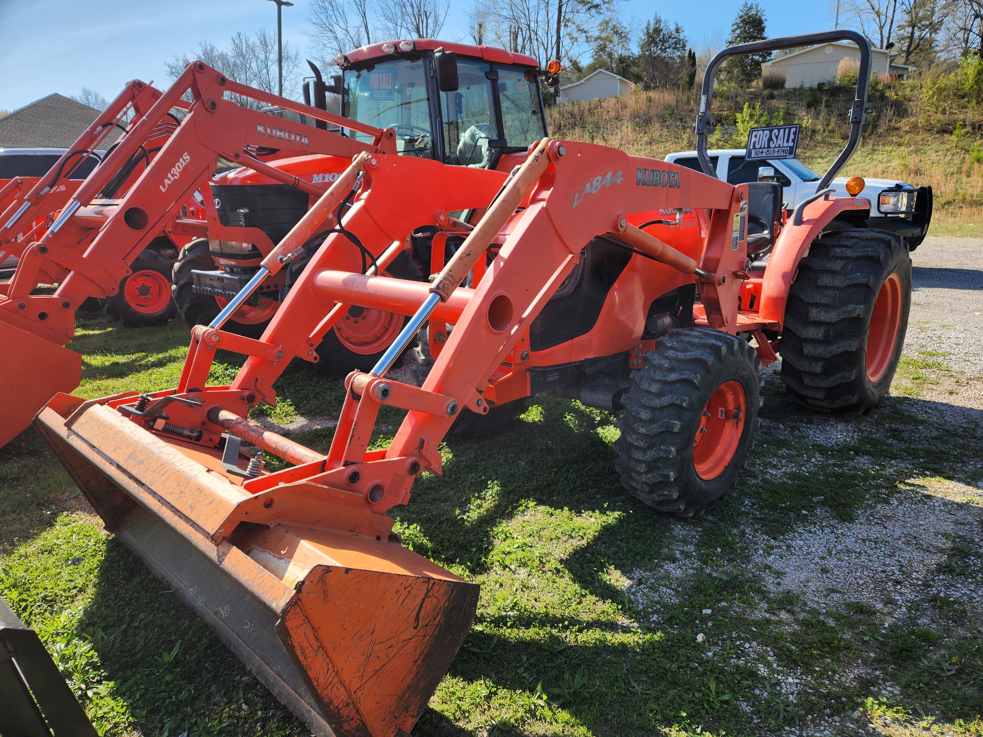

I have a Kubota MX5100 HST 4x4 with Loader for sale. Pre emissions. 610 hrs. $26,000. John 904-813-4740
/ Hello everyone , need advice on upgrading a logging tractor #25
Interesting - The MX5100 is one of the ones I was interested in: it's a tough tractor, but at least according to the specs I can find online, not as tall as the current Kubota offerings of similar power/lift capacity. Wish I was not so far away from you, I'd come take a look.

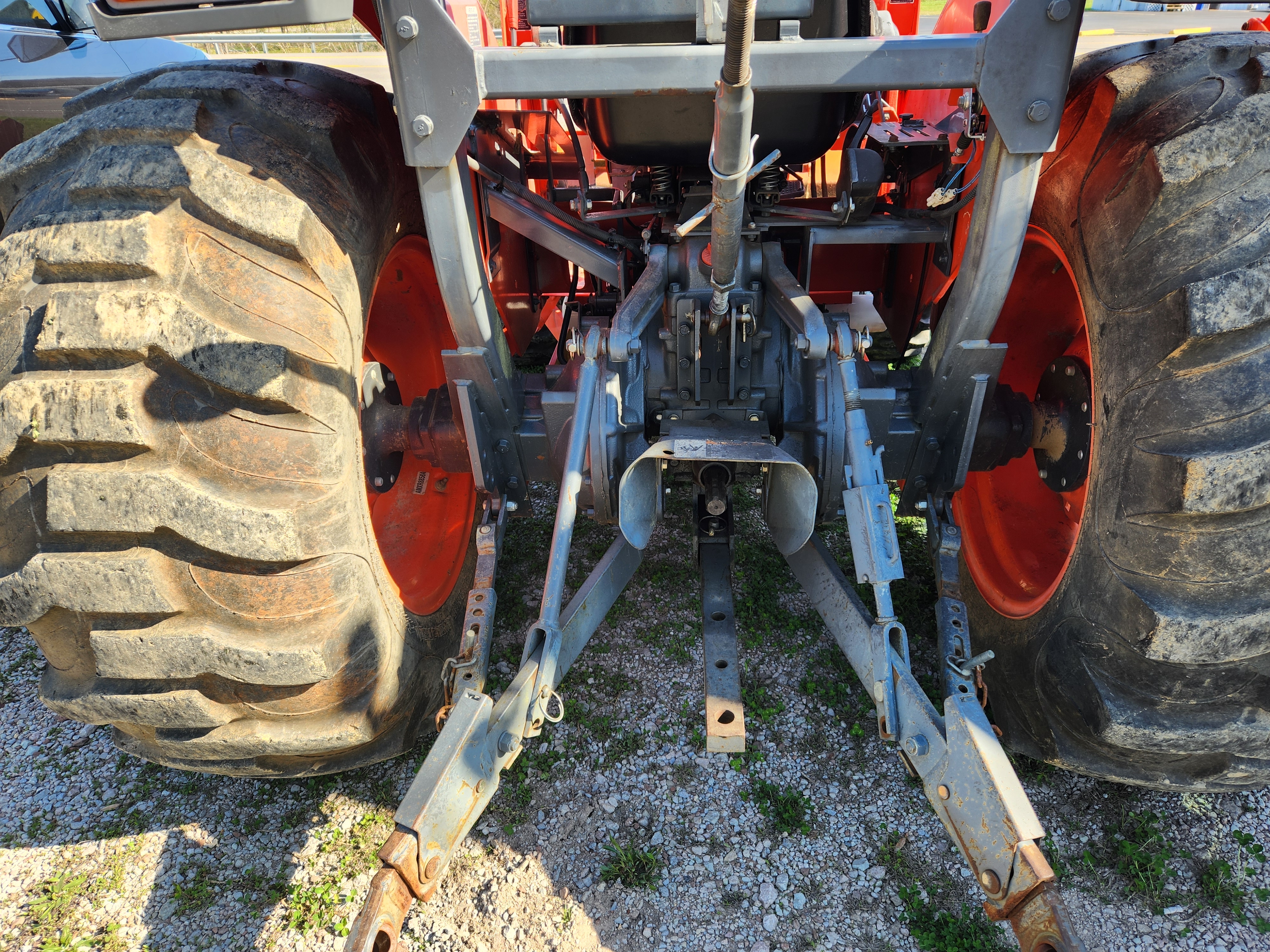

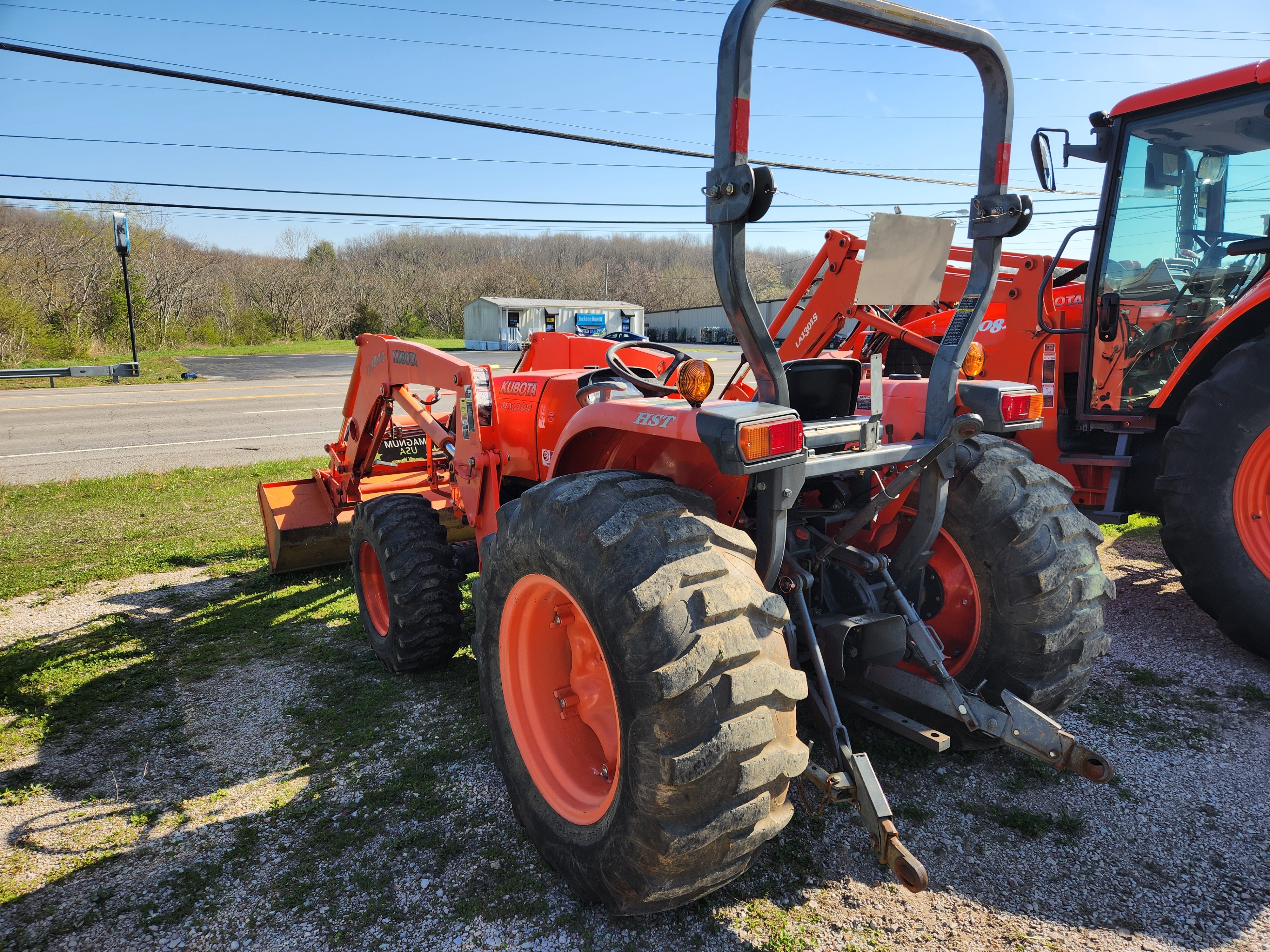

Here is some pictures.
