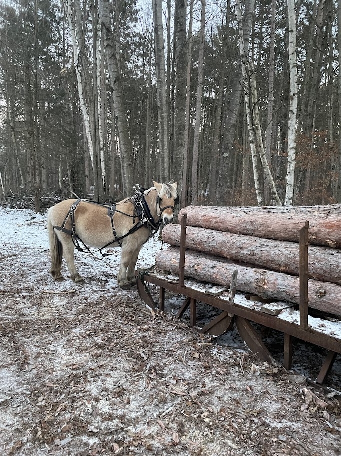

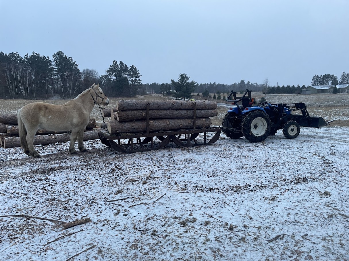

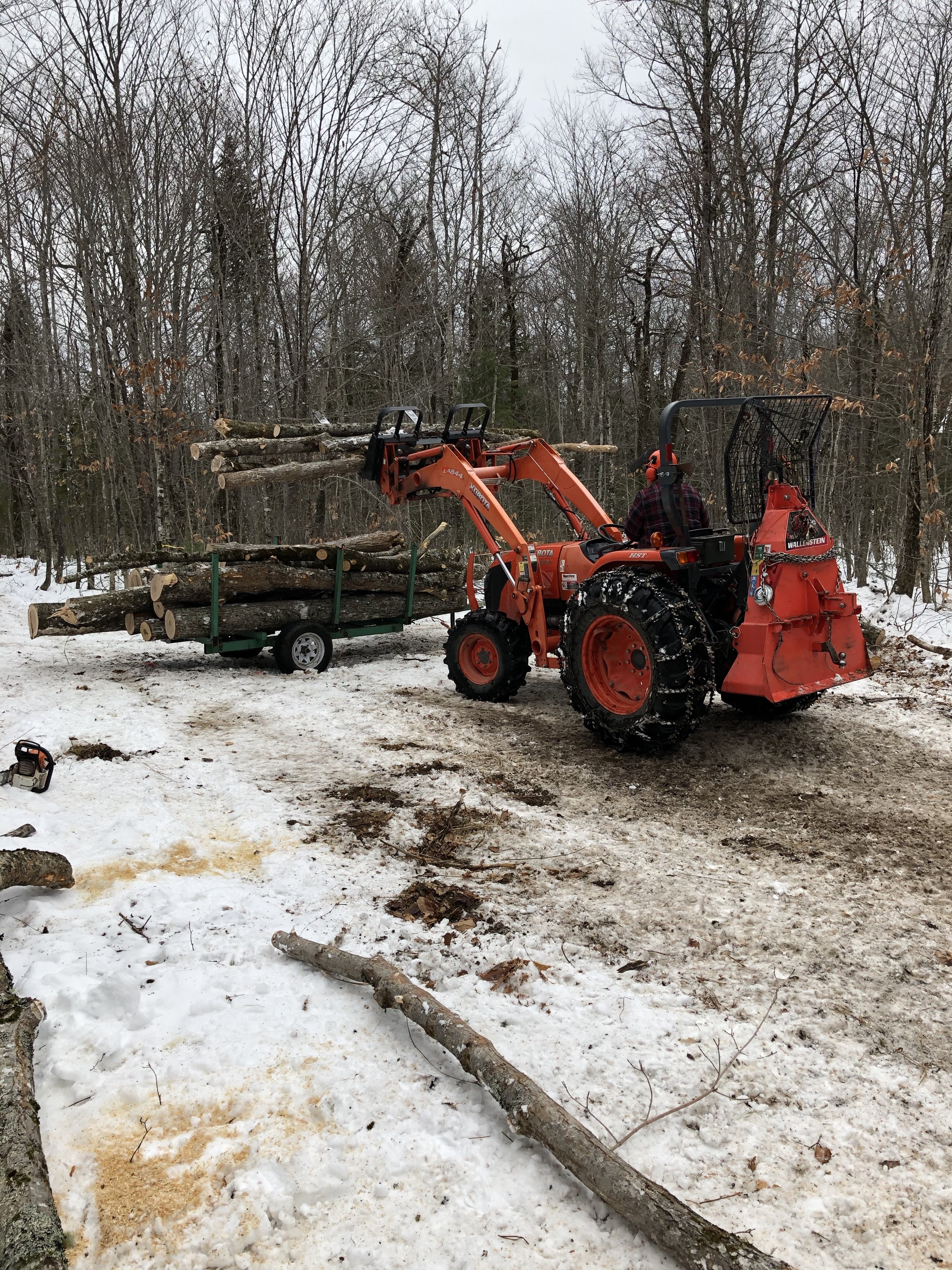

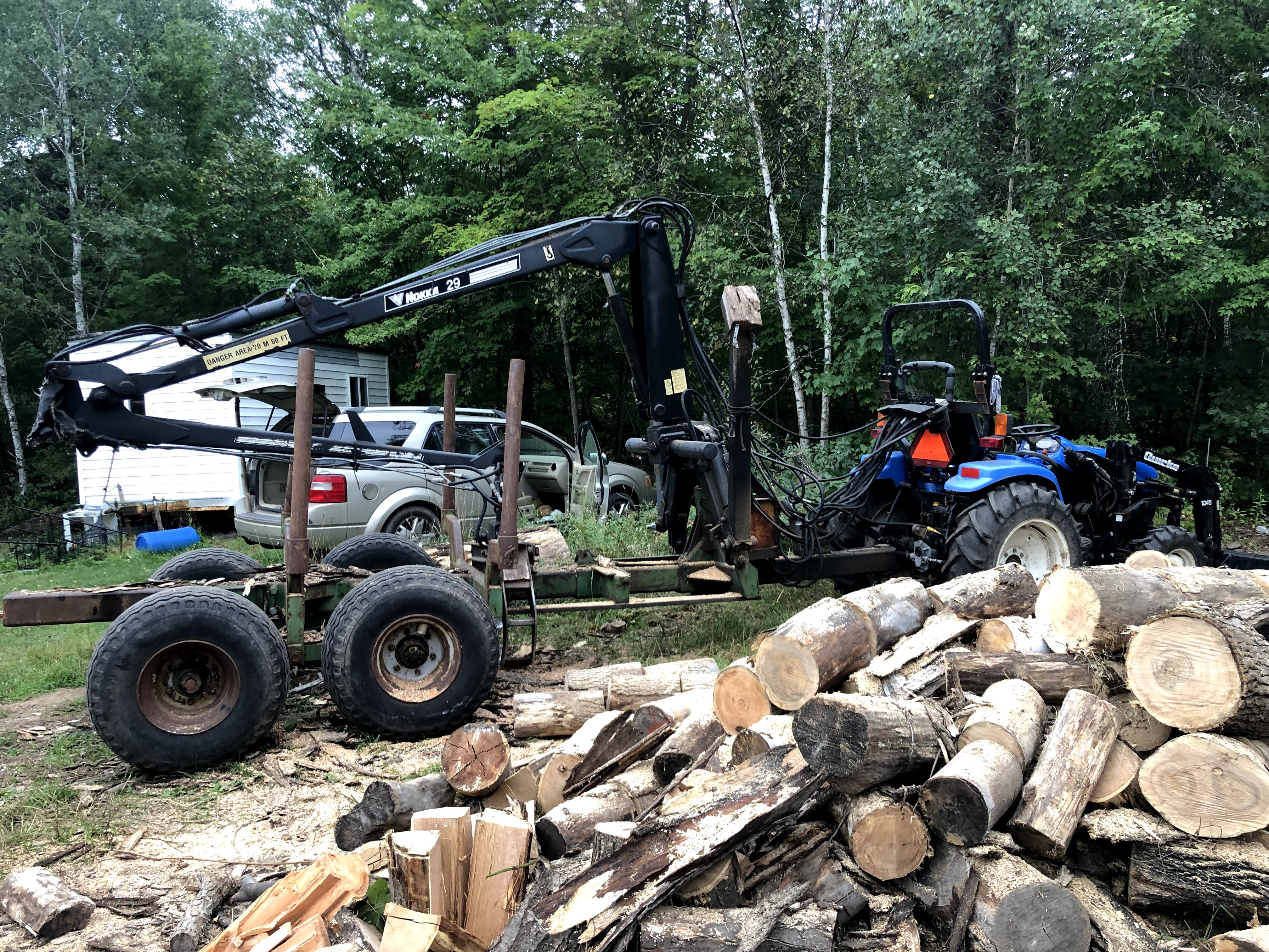

Hello everyone, I have a few questions on logging tractors. Right now I have a TC33d and it has been a great little rig. I mostly log with horses but have the tractor there for assist and to pull a sled or trailer in hill situation. I have been thinking of getting a 50hp tractor to replace this one or something close to that. I also have a Fami 501 winch. This winter I skidded to trails with the horses , loaded sled with the tractor and hauled it out. It was so simple and fast. I have a few questions . Lets say I haul out about four loads a day like this one in the pics and or between 2 to 4 cords a day. I do my loading of sled/wagon with the tractor and pull out around a 40 deep with it. How long would a decent tractor loader last doing that with a set of forks or a Frosbite style bucket on it ? Also would a Kubota MX5800 be enough tractor to do this or should I get a gear drive tractor. I may also pull a logging trailer with a loader some of the time but mostly I would like to just load and unload with the tractor its self.. At times I do some rock work and landscaping as well where there is a lot of loader work..

That looks like a pretty nice trailer and loader you have. Pretty easy to understand why you would like a bigger tractor. I’m curious what state do you live in ?

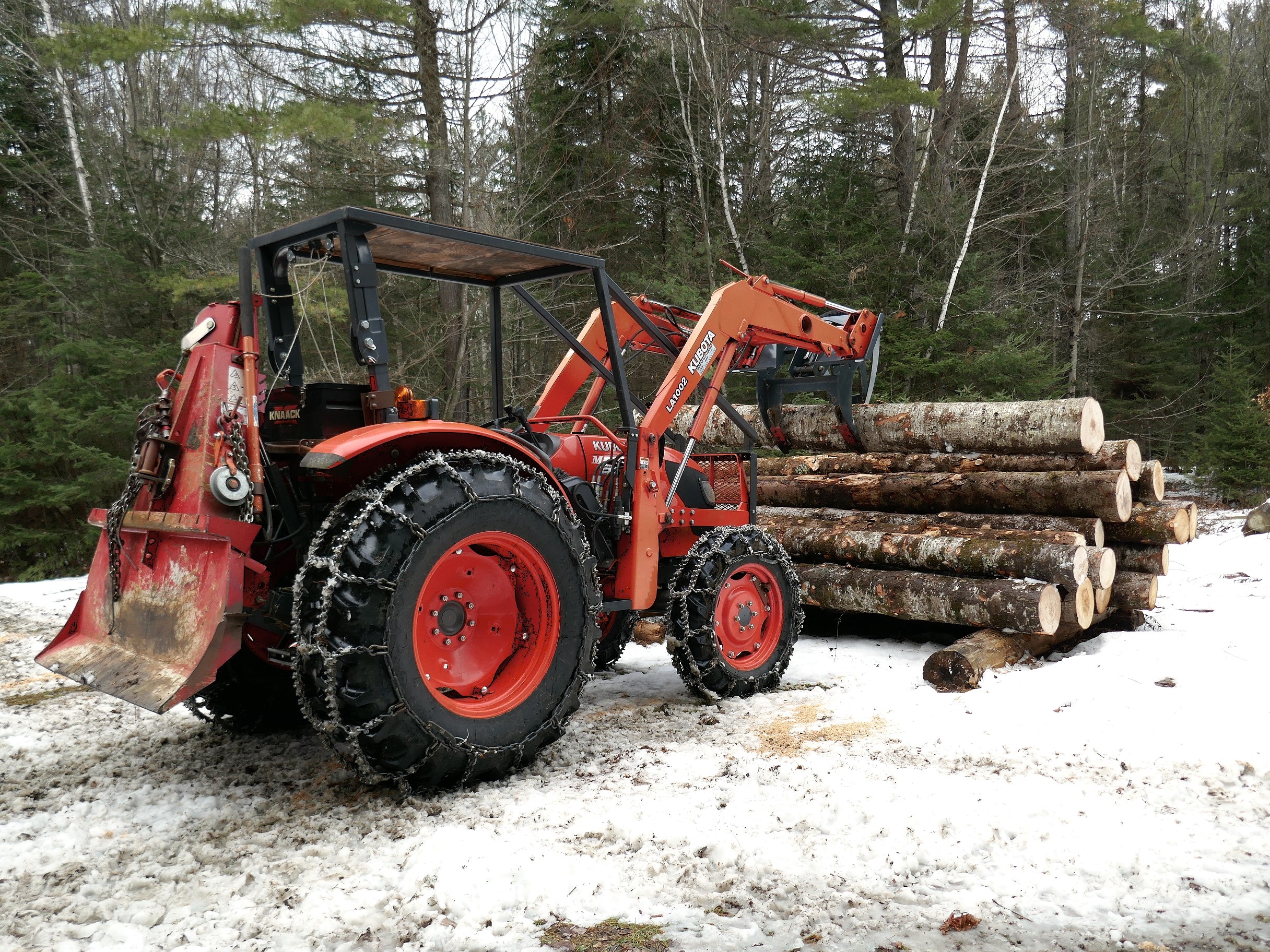

Welcome to TBN. I'm not sure what you are asking but usually it depends mostly how you take care of it. I think a 50 or 60 hp tractor will suit your needs fine. I have a Kubota M5640 (56 hp gear drive, 7500 lbs) with a FrostBite grapple and Farmi 501 winch. I will handle what you are showing fine. I have never operated an HST so can comment on that other than wonder why it matters. There are plenty of them out there in the woods.

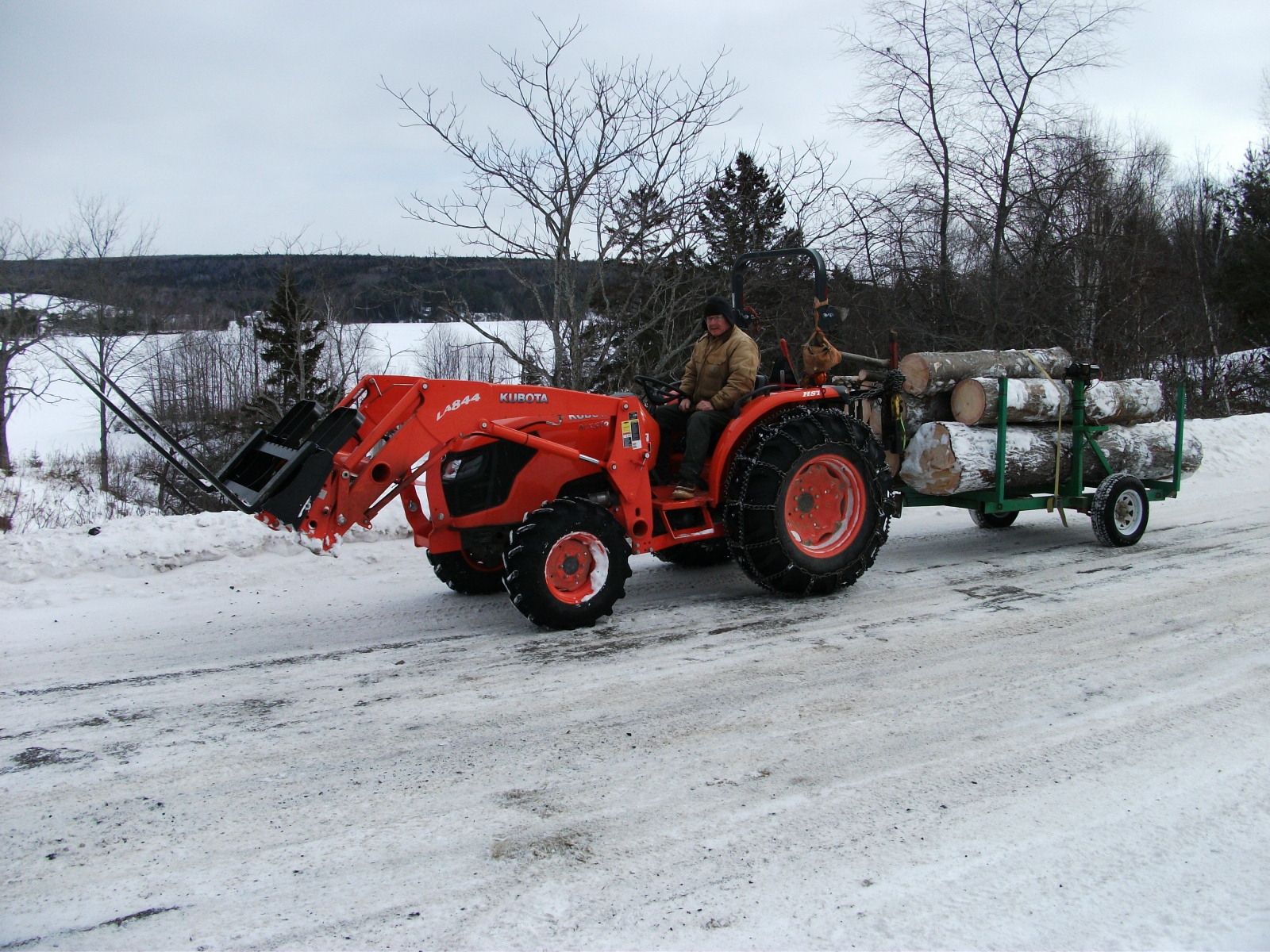

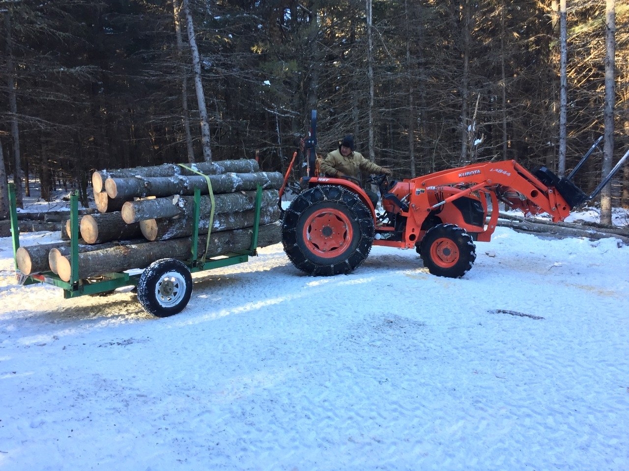

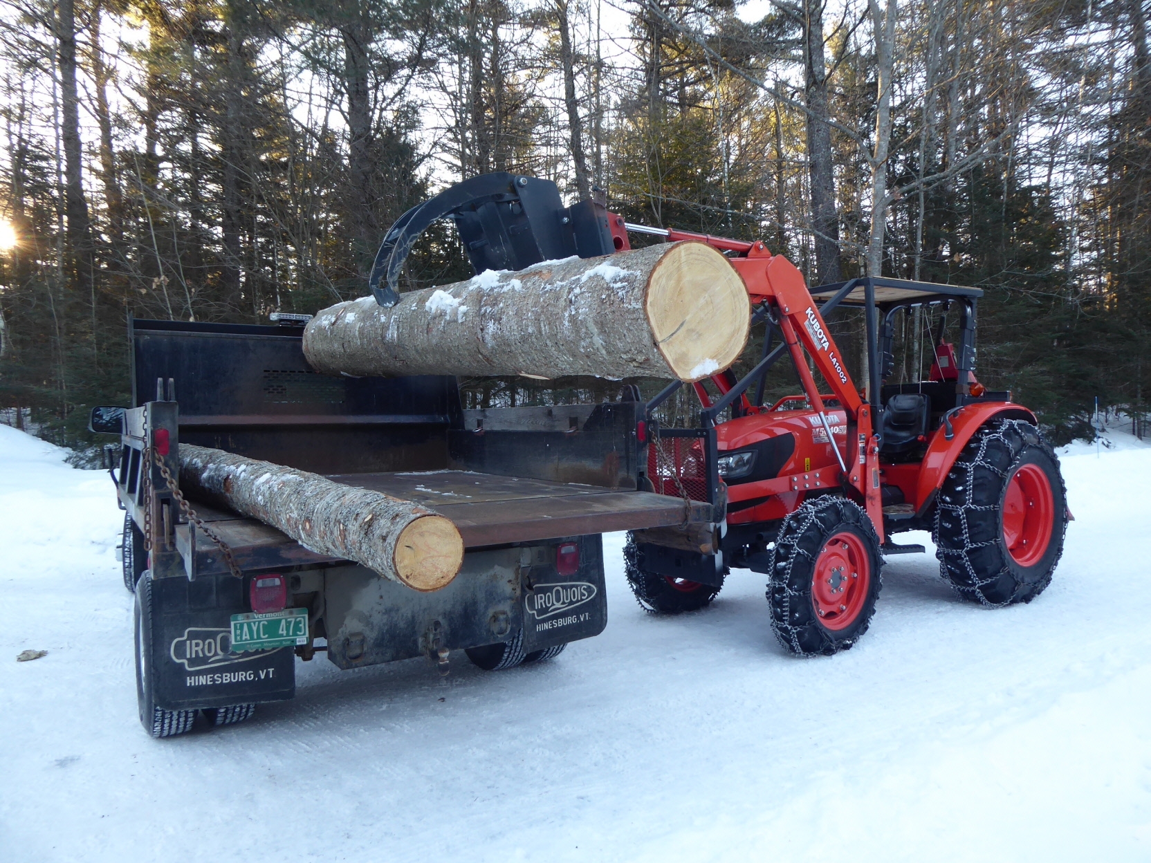

I have a Kubota mx5100, 50 hp with hydrostatic transmission. Going on 1700 hours on it with no issues. I do a fair amount of woods work with a Wallenstein winch. No grapple yet but I use forks. This tractor suits all my needs, winching, loading and hauling. Tires are loaded. I have a 900 pound homemade counterweight I can quickly lift with the winch when needed for extra heavy loader work. Combined weight with winch is 1400 pounds. Winch is equipped with a removable ball hitch which is great. And a good set of chains is essential here where I live.
I find the HST is great for what I do. In all my year round work I do a lot of what I call creeping work. With HST I have total control. But that is just me. Many prefer geared transmissions.
Good luck.
That's great idea Hoobie. How do you mount your counter weight ? Hang it off the slotted choker rail or some other way ??
