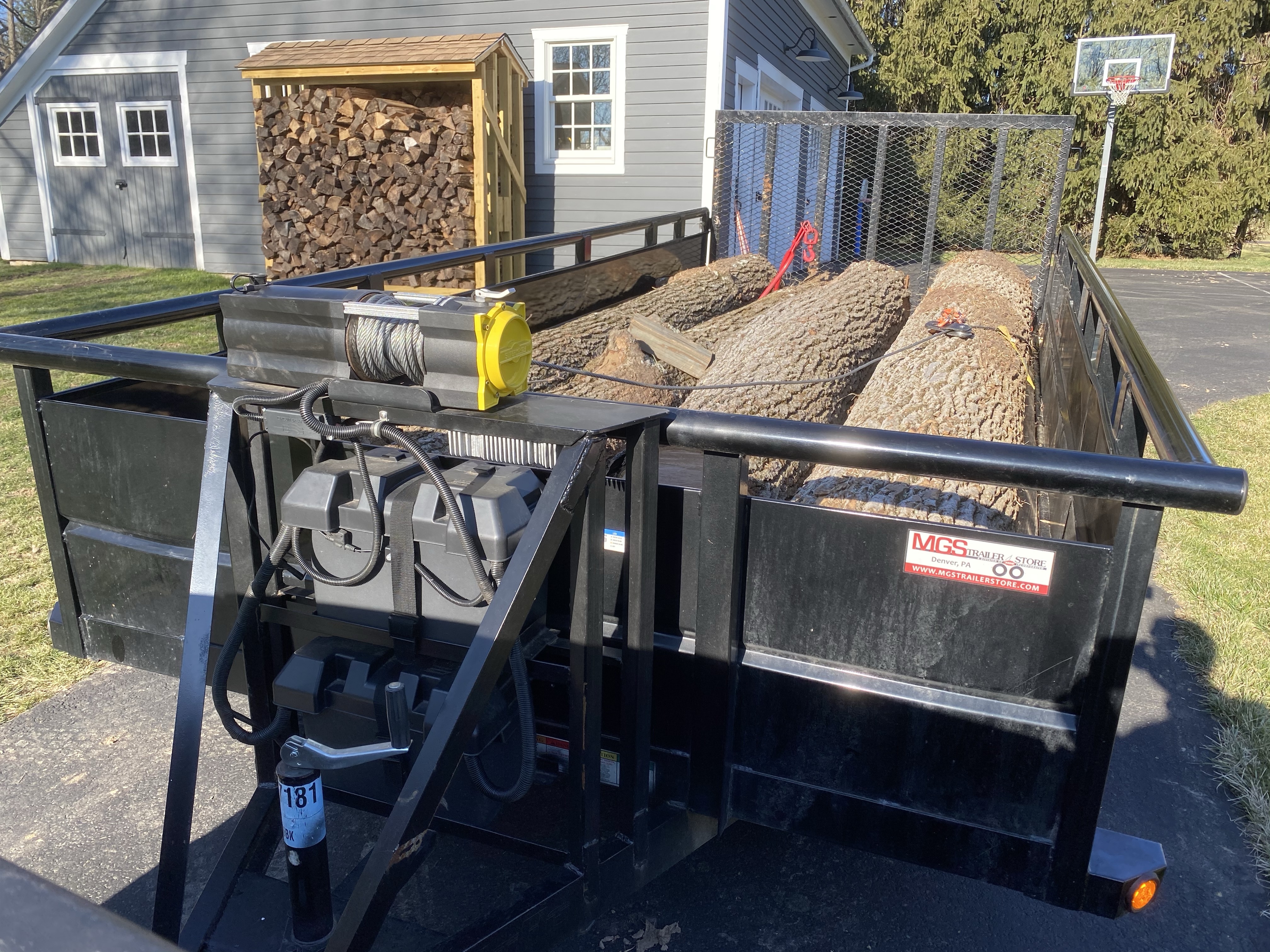

I know there have been several threads on trailer decking here, for various applications and trailer types, but here's one more: It's time to replace the decking on my log and tractor hauler, which is a Big Tex 70TV closed-side landscape trailer with 2x6 PT decking.
The PT works well for skidding logs in with the winch, or dragging them out with the tractor. Slick enough to allow logs to slide, no paint to damage, and yet grippy enough when dry that things don't slide too badly on their own.
Then again, when it's mossy and wet as it was this weekend, it's as slick as greased ice. I took a header while loading a rocking chair onto the trailer today, don't know how I didn't manage to break anything on myself or the chair.

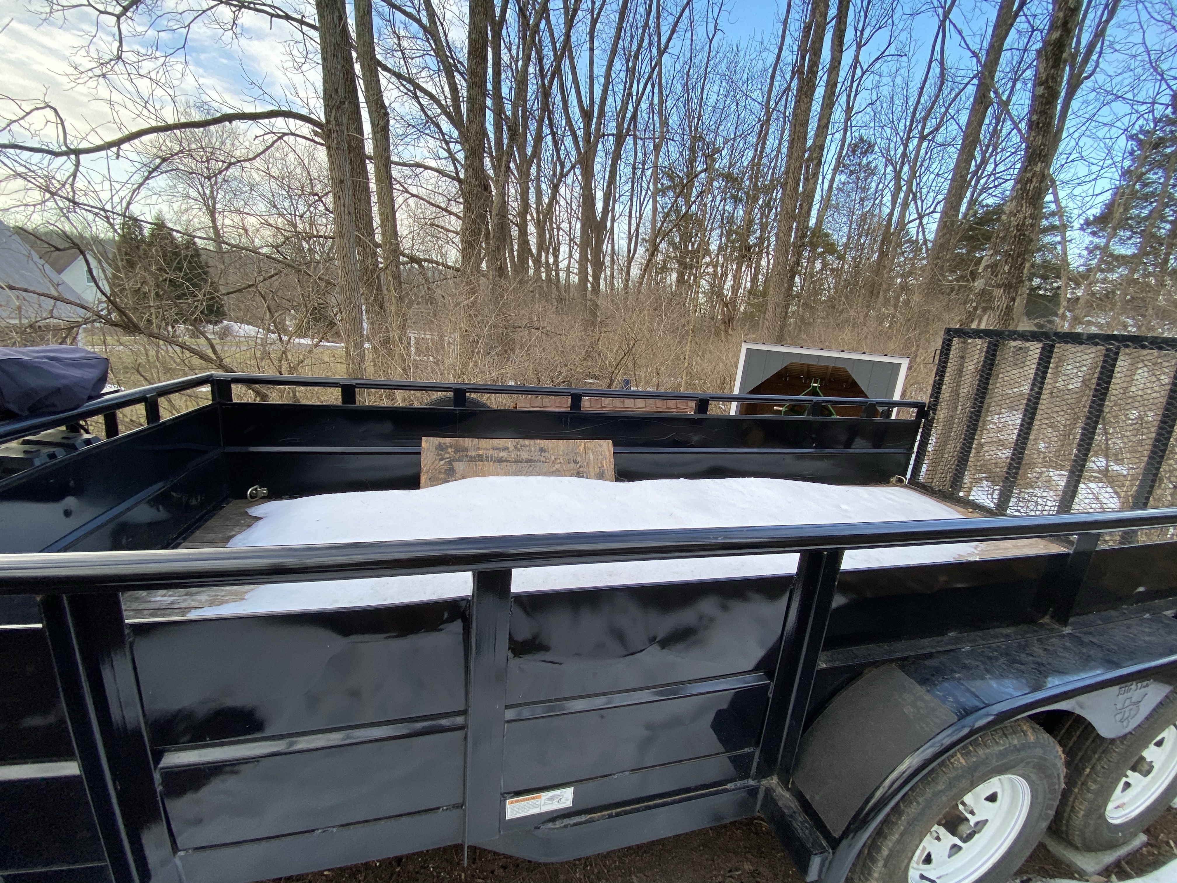

It spends its life outdoors, but I'm been debating building a roof over it to protect the new decking:
I don't love the new PT, at least partly because it's so corrosive it causes any metal on the trailer in contact with the wood to rot. But it's a cheap trailer, used for cheap things (firewood = saving money on oil, tractor hauling = saving money on paid hauler), it doesn't make sense to invest in Ipe or Mahogany decking on this thing.

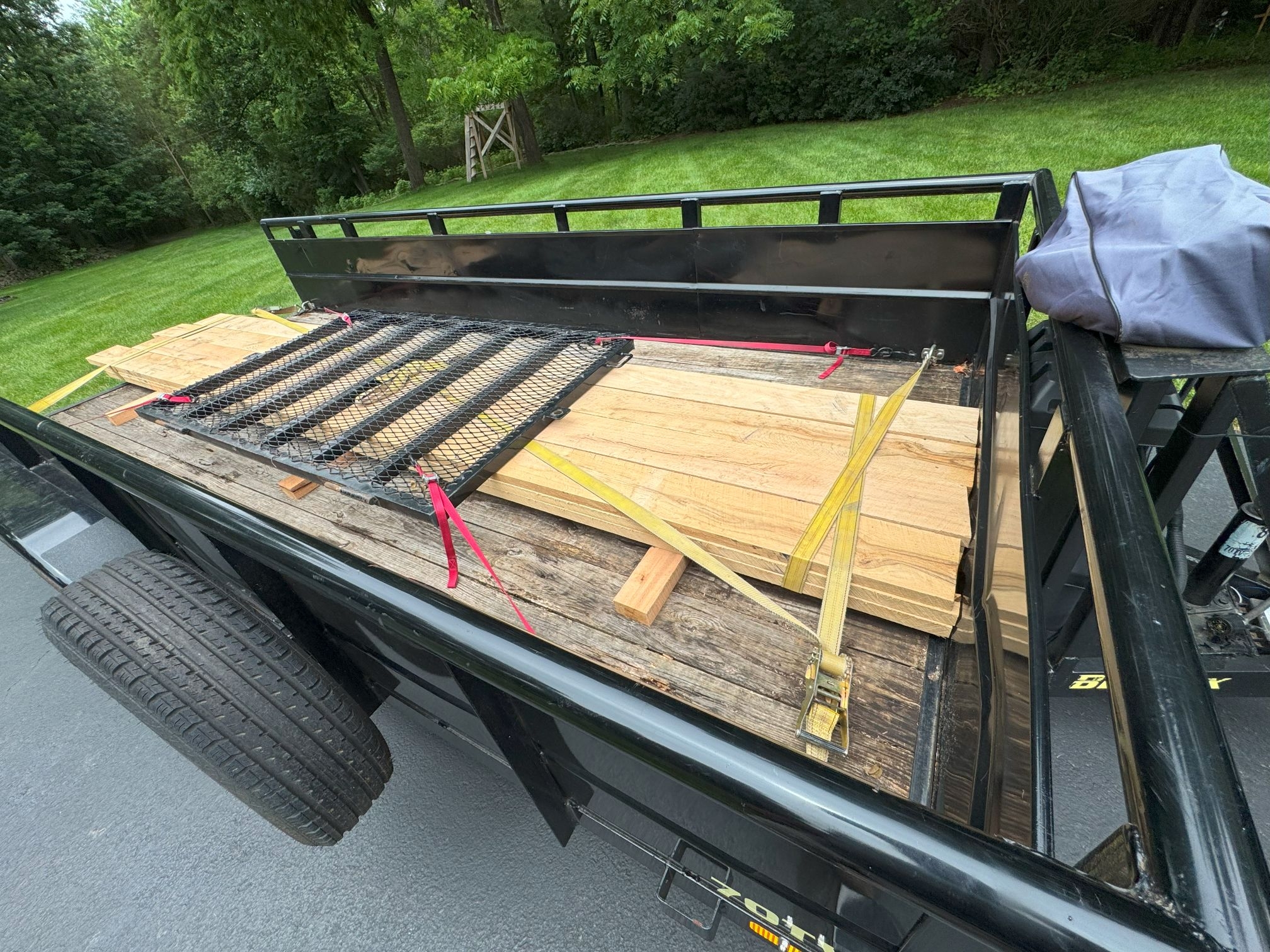

Okay, just ordered white oak to be sawn. Total cost is $450 for white oak in 6/4, versus $325 for red oak, so no real comparison when considering superior rot resistance of white.
I'm also going to take the opportunity to relocate my two large batteries to the rear of the trailer for more manageable tongue weight, while I have the decking off. Will also be a good chance to needle scale, wire brush and repaint any areas that need it.
I might even get around to building a lift-off roof to go over the whole rig. I had looked at that years ago, but prior to losing a deck in under 10 years, had figured it wasn't worth the effort. I'm re-thinking that, now. A lightweight A-frame with a pair of lifting hooks at the ridge, covered in cedar shake or even corrugated metal, would protect the whole trailer when sitting in the woods. Set it on the trailer railings with a few tie-downs in the corners to keep it from blowing off, and then lift it off with the loader to set in the lawn when trailer is in use, given I only use this trailer a half dozen times per year.

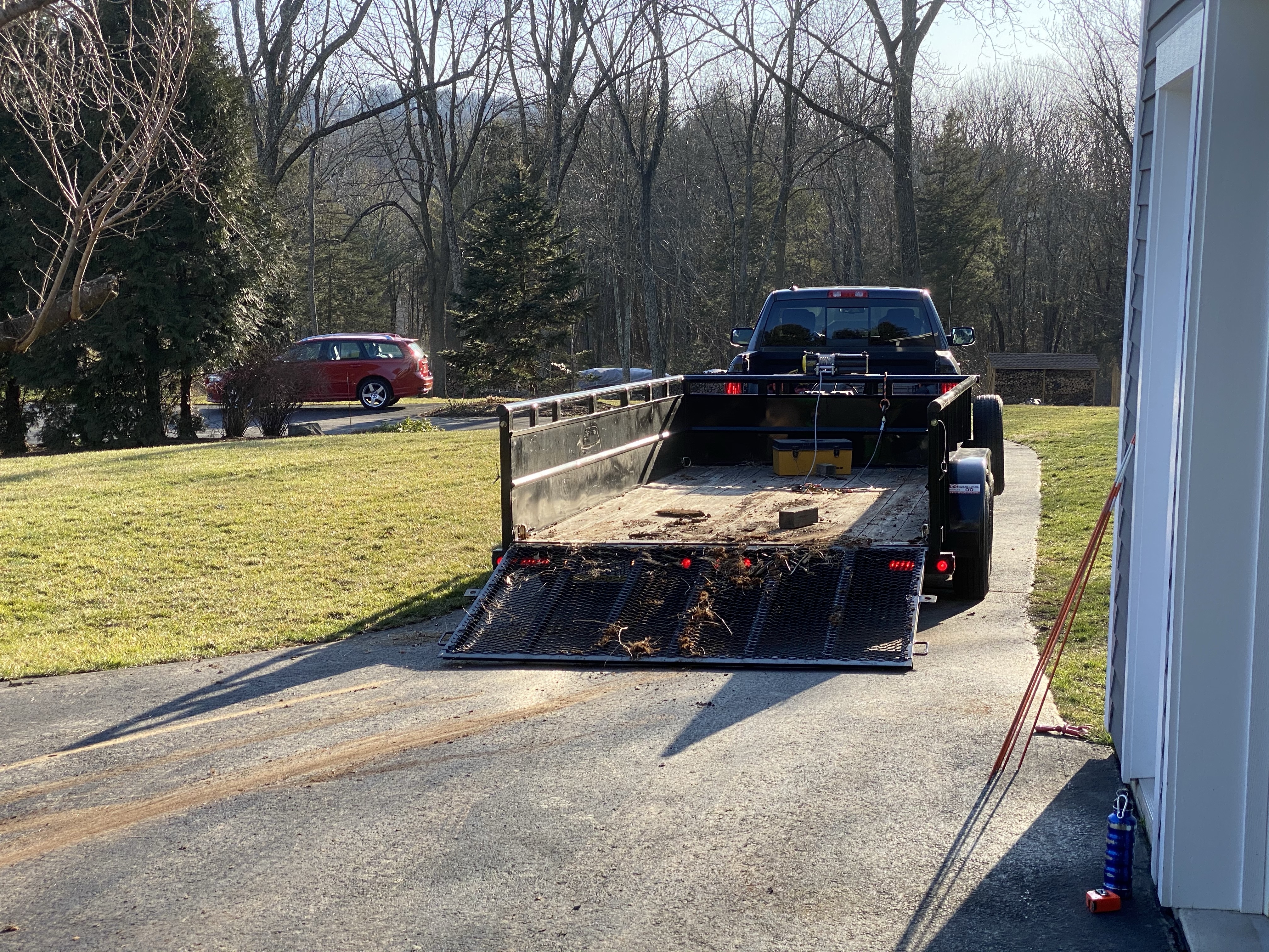

This is the current tailgate, albeit mine is mostly destroyed due to dragging hundreds (thousands?) of logs over that corrugated metal:
I could cut it at the mid-length point, weld in square tubes and hinges, to make it fold back on itself after raising.
The frame on mine is in good shape, but the corrugated metal is all bent to hell, so finding something better to weld in it's place wouldn't be the worst thing in the world.

Well, I picked up my new decking this morning. A dozen planks of 6/4 x 8" x 16' white oak, freshly rough-sawn. They'll go on stickers in a sunny spot on the driveway for a few weeks, with a clear plastic tent arranged around them as a solar kiln, to dry while I remove the old planking and do some refurb and modifications on the trailer.
