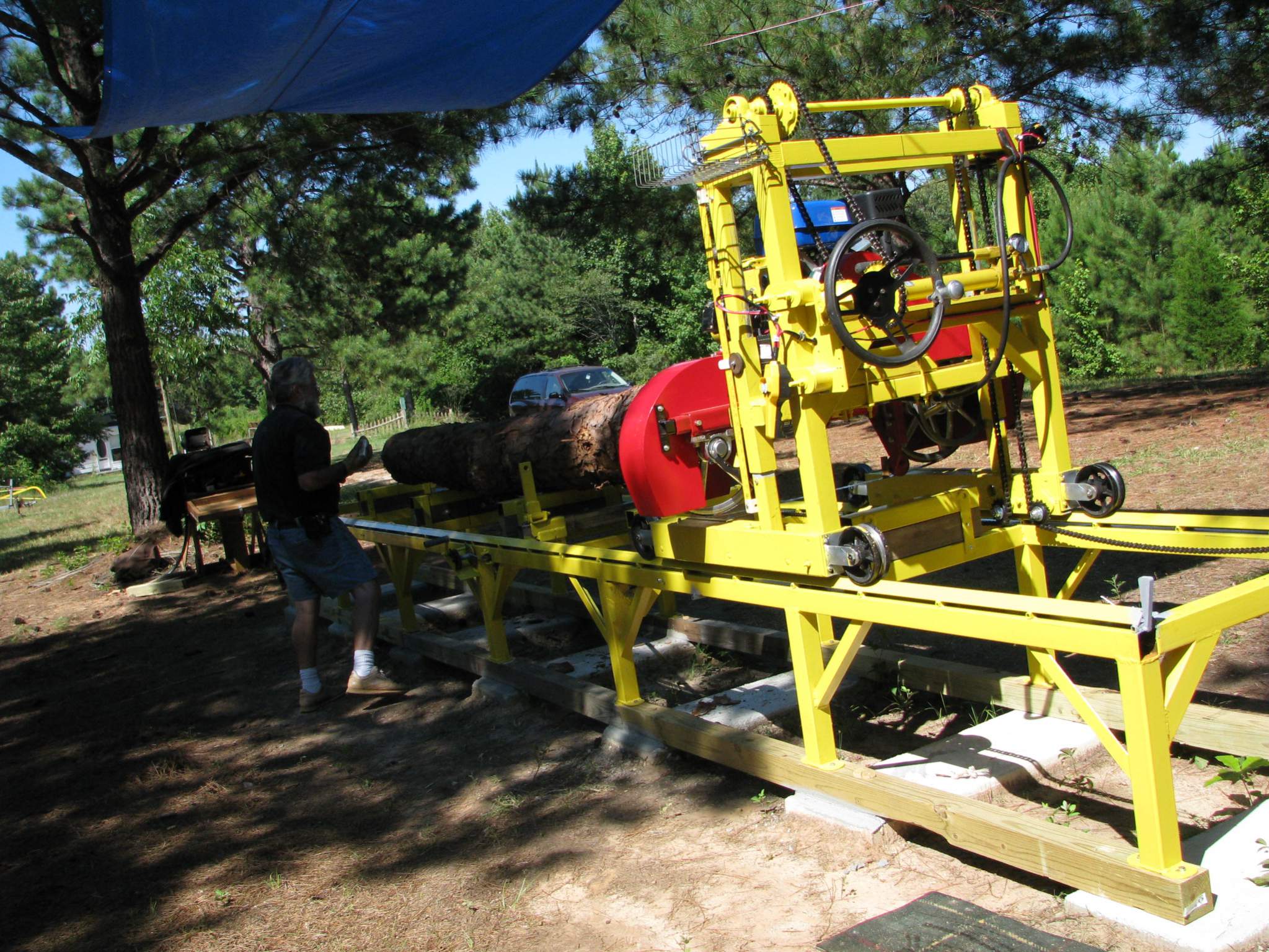

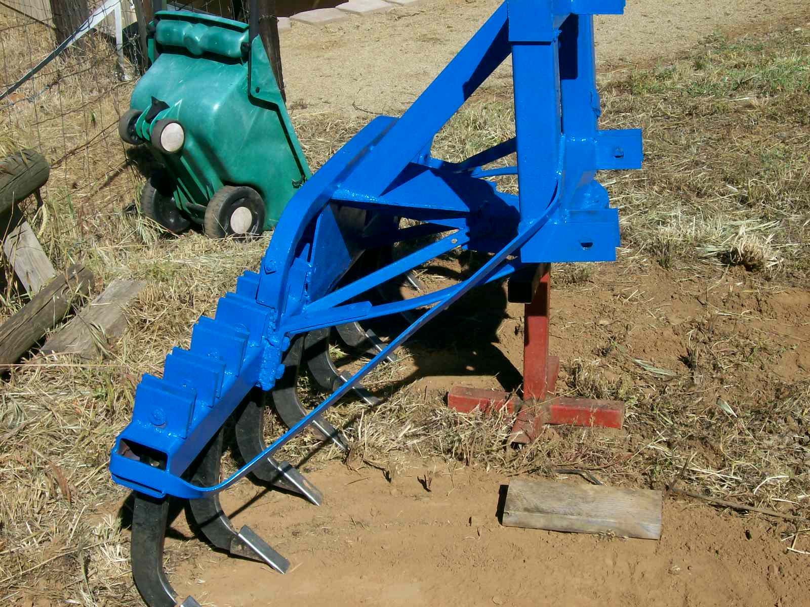

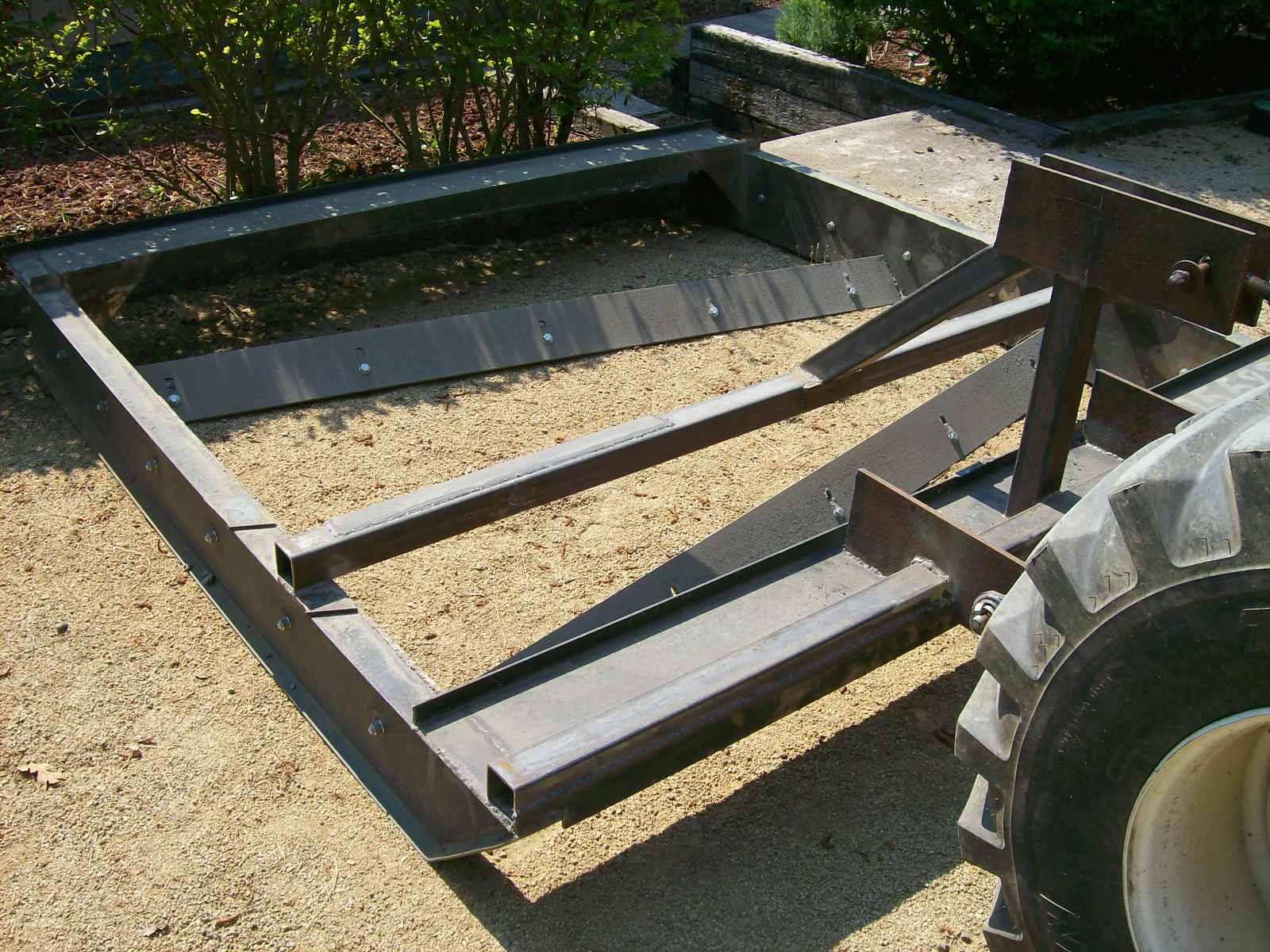

Two of the items I have built using my SP135 Lincoln using .035 fluxcore . Sure it is not the fastest welding when in a high range with limited duty cycle , but then neither am I . :thumbsup:
The ripper use to be a single gang old disk , the curved metal was there as was the some of the frame . Will have to look for the pictures of the boulders and 8" cement drain pipe that I yanked out of the ground .

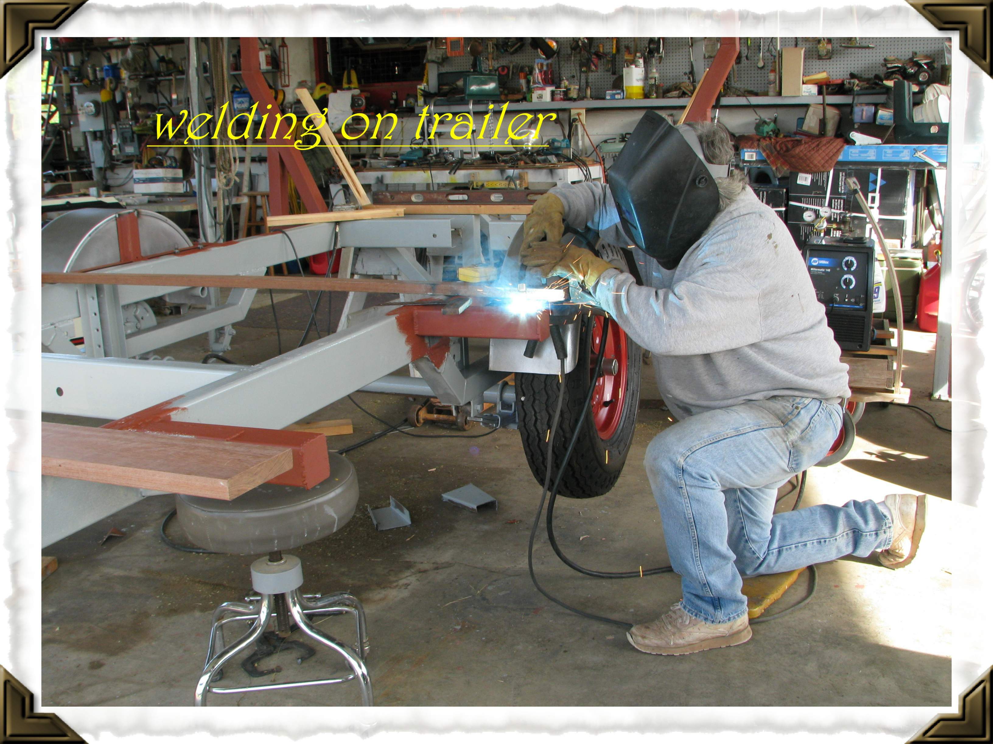

I made a living being a fabricator after a restoration business. I"ll never not have a welder. It has allowed me to build all kinds of things from scratch...
built this quad trailer from an old pop up camper frame about 15 years ago..
built this one all out of scrap...I built it to haul 15K....
I could go on for days... a 220V smaller mig like a lincoln 180-190 is an ideal choice for a homeowner/small shop owner. With flux core wire (no gas) will allow you to weld thicker (1/4-3/8")stuff relatively easily
