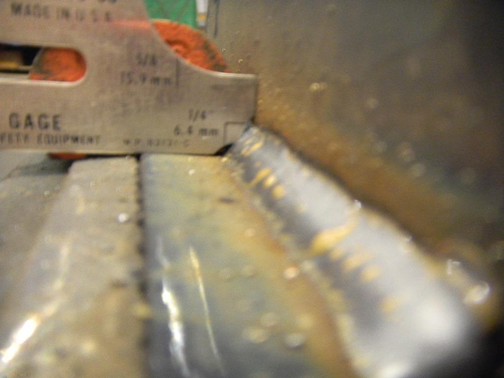

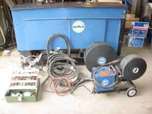

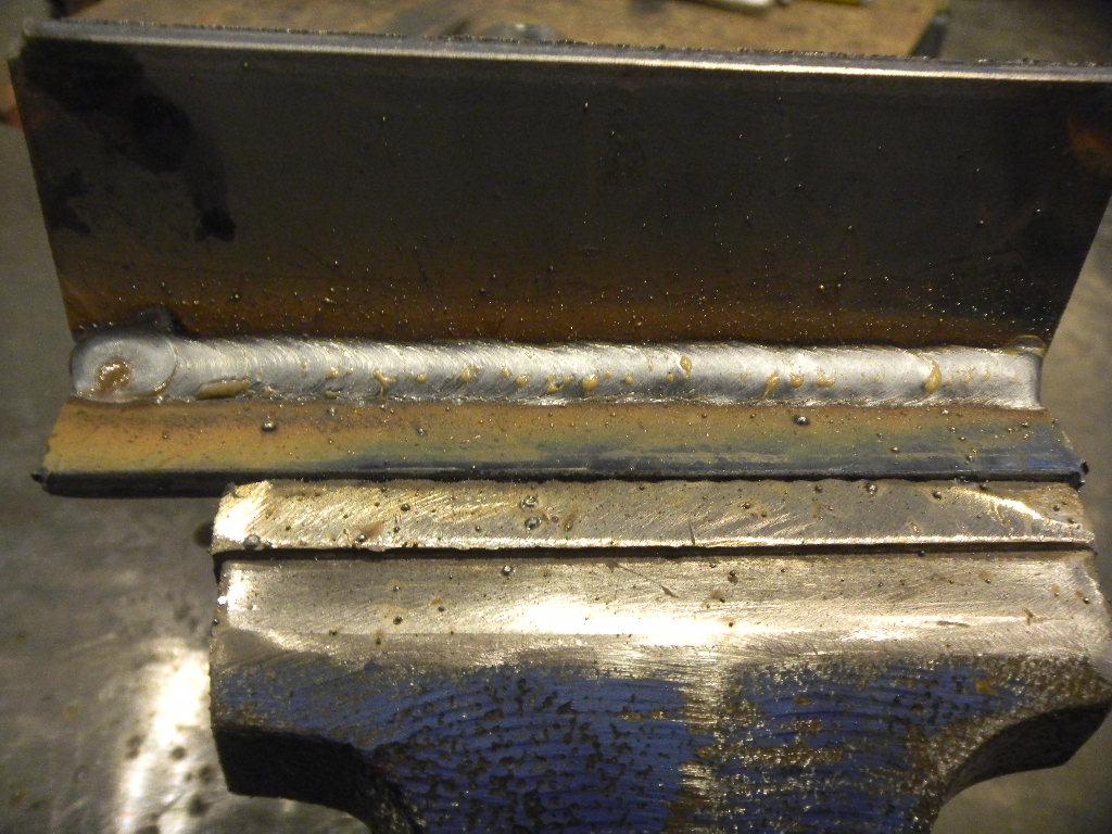

This subject came up a few days ago, either here or another site. It has to boil down to joint design! If splicing 1/2 thick plate with 22 1/2 degree bevels I'm not sure I've ever run a machine that can do that in a single pass. 1/2 inch thick material with a fillet weld on each side, sure. Good rule of thumb is, the weld should be half the thickness of the material. So that would be a 1/4 inch weld on each side. Here is a picture of an honest 1/4 inch Mig weld. I remember when I first bought my Trailblazer 55D, I was working in a beam splicing yard. I had to weld 3/4 inch thick plates to the flanges of the beams. The drawing required 3/8 inch fillet welds all the way around the plates. I had an on site inspector who was a royal PITA! I think he put a weld gauge on every weld. To keep production up I was running 5/64 inch Innershield at 400 + amps. Hard to remember every detail because this was 1983 I could get either 12 or 18 inches of honest 3/8 inch fillet weld in under 60 seconds. One thing I do remember like it was yesterday, every morning I had to replace the Tweco lead fittings at the machine. The rubber would get so hot it would melt, and drip onto the bed of the truck. Here is a picture of the Trailblazer.
