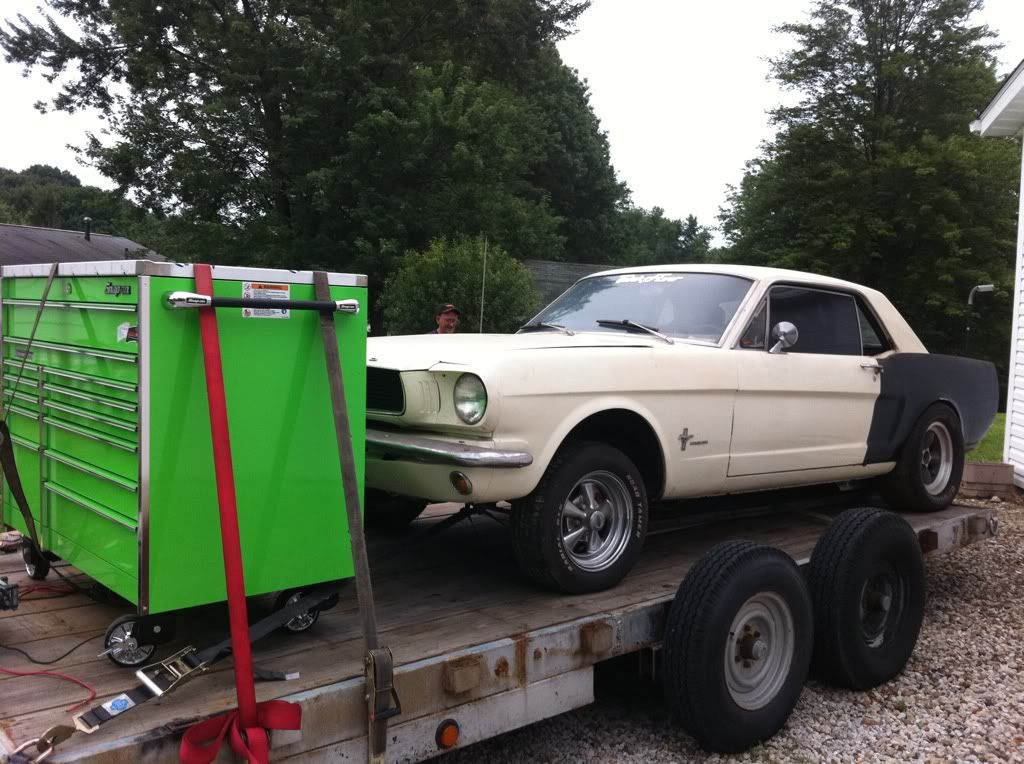

I made a living being a fabricator after a restoration business. I"ll never not have a welder. It has allowed me to build all kinds of things from scratch...
built this quad trailer from an old pop up camper frame about 15 years ago..
built this one all out of scrap...I built it to haul 15K....
I could go on for days... a 220V smaller mig like a lincoln 180-190 is an ideal choice for a homeowner/small shop owner. With flux core wire (no gas) will allow you to weld thicker (1/4-3/8")stuff relatively easily
