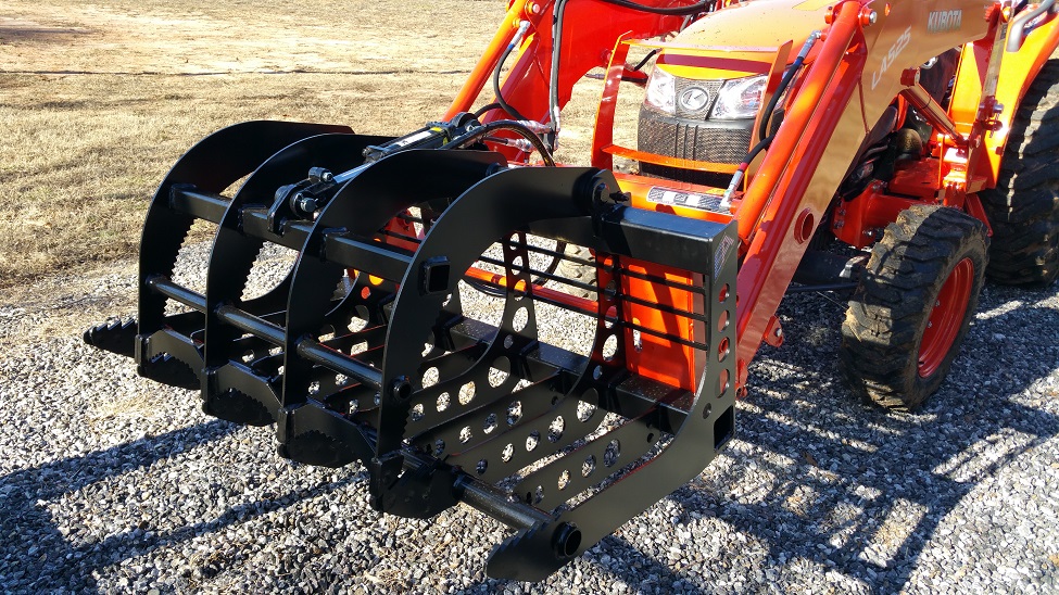

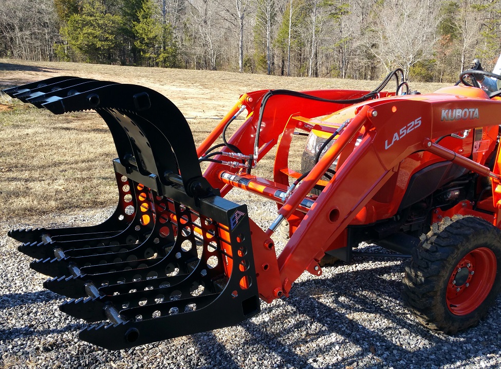

This past Saturday, I helped my father in law hook up a 50" Wicked Grapple to his brand new Kubota L3301. :cool2:
I took lots of pics!

OK that did it Travis I'm ordering one. Did you need to make any changes in the grapple's standard hose lengths or connectors for your Kubota? The LA534 (I think that's the FEL on the B2650) is probably about the same as your father's. I may as well have it come with whatever connectors and hose lengths the work the best.
We added a little extra length, making them 60" long. There's a guy over in our EA Channel Facebook Group who just received one last month for his B2650. He posted a few pics back on Jan 17, so check it out if you're on FB. Our couplers are a different series from the Kubota/Land Pride, so we sent an extra pair of couplers for his tractor and added $20.
His outlets are in the center, but they are pointed to the side instead of forward. This configuration will require longer hoses or we can include 90 degree fittings(that's what I sent him).
