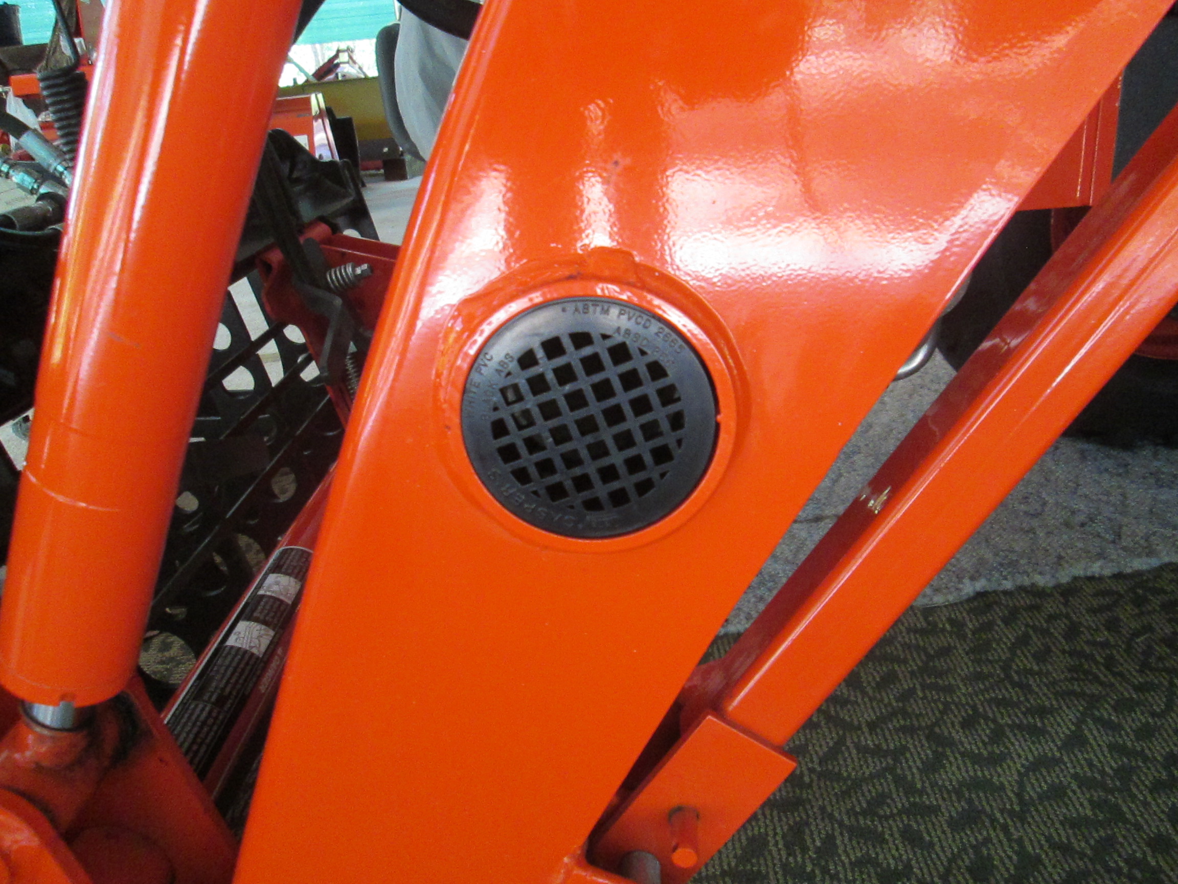

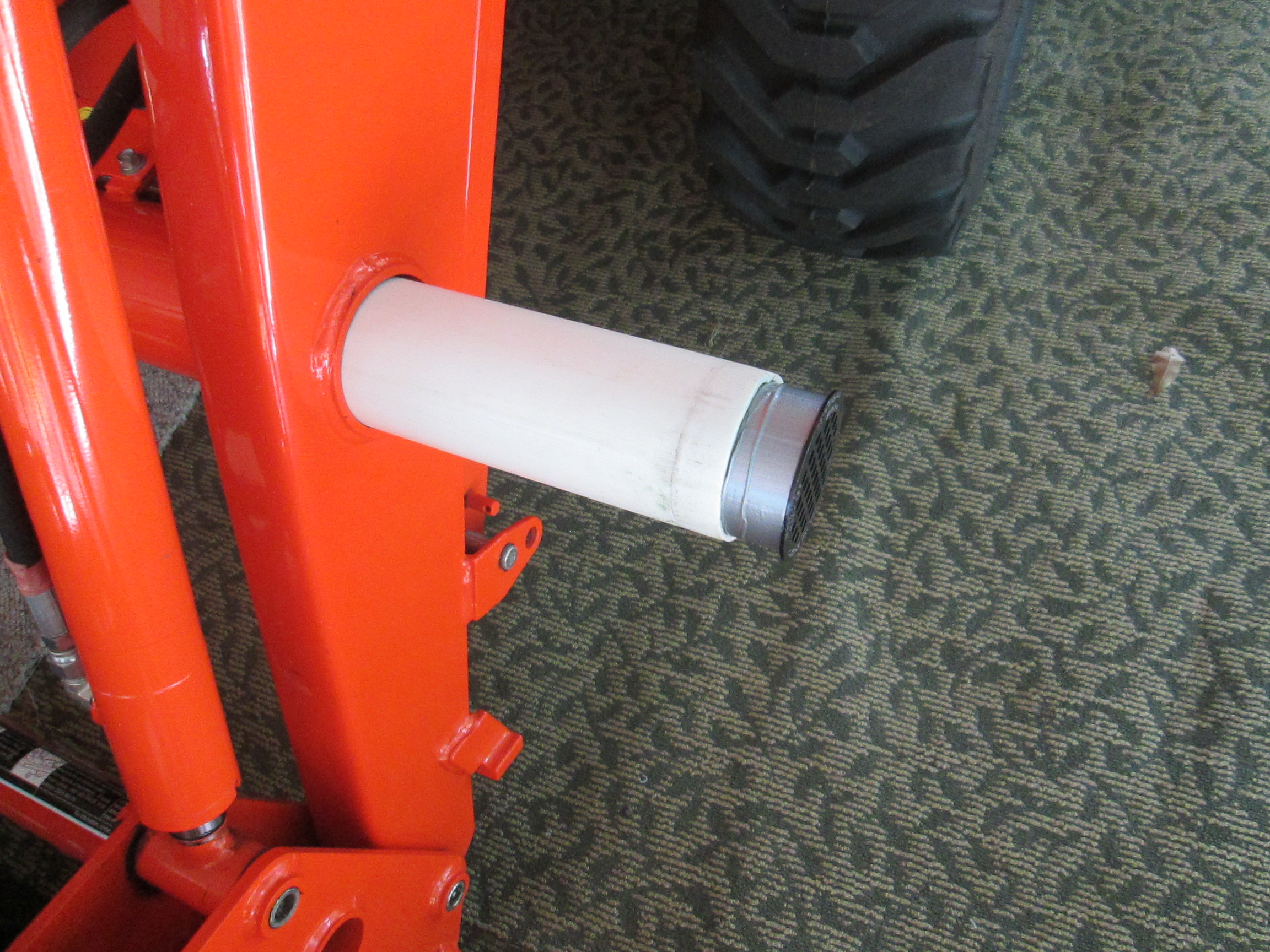

For all you ETA grapple-bucket fans, here are some pics of my handy towing/lifting/rigging-chain storage... I am sure that many/most of you have already seen this or iterations of it and perhaps have designed your own adaptation... I give you my rendition herein and look forward to YOUR ideas/application(s)... The loader-tube-liner/'chain-holder' is salvaged (free) drainage pvc (ADVANTAGE: It has a thinner wall, lighter-weight, and allows more room for a LONG chain) and the vented ends are heavy-duty pvc drains... The pipe/end-plugs have added friction via duct-tape...
NOTE: I also replaced the original small (4"x4"x12") OEM plastic tool-box (behind the seat) with a steel (6"x8"x20") and the addition of a OEM bracket... The bracket/parts/tool-box cost approx. $50 and is MUCH more useful/professional... I will be happy to post pics if there is any interest... BTW, this is not tractor-specific, as I understand this is a universal issue and this tool-box-issue remedies many such problems... LMK

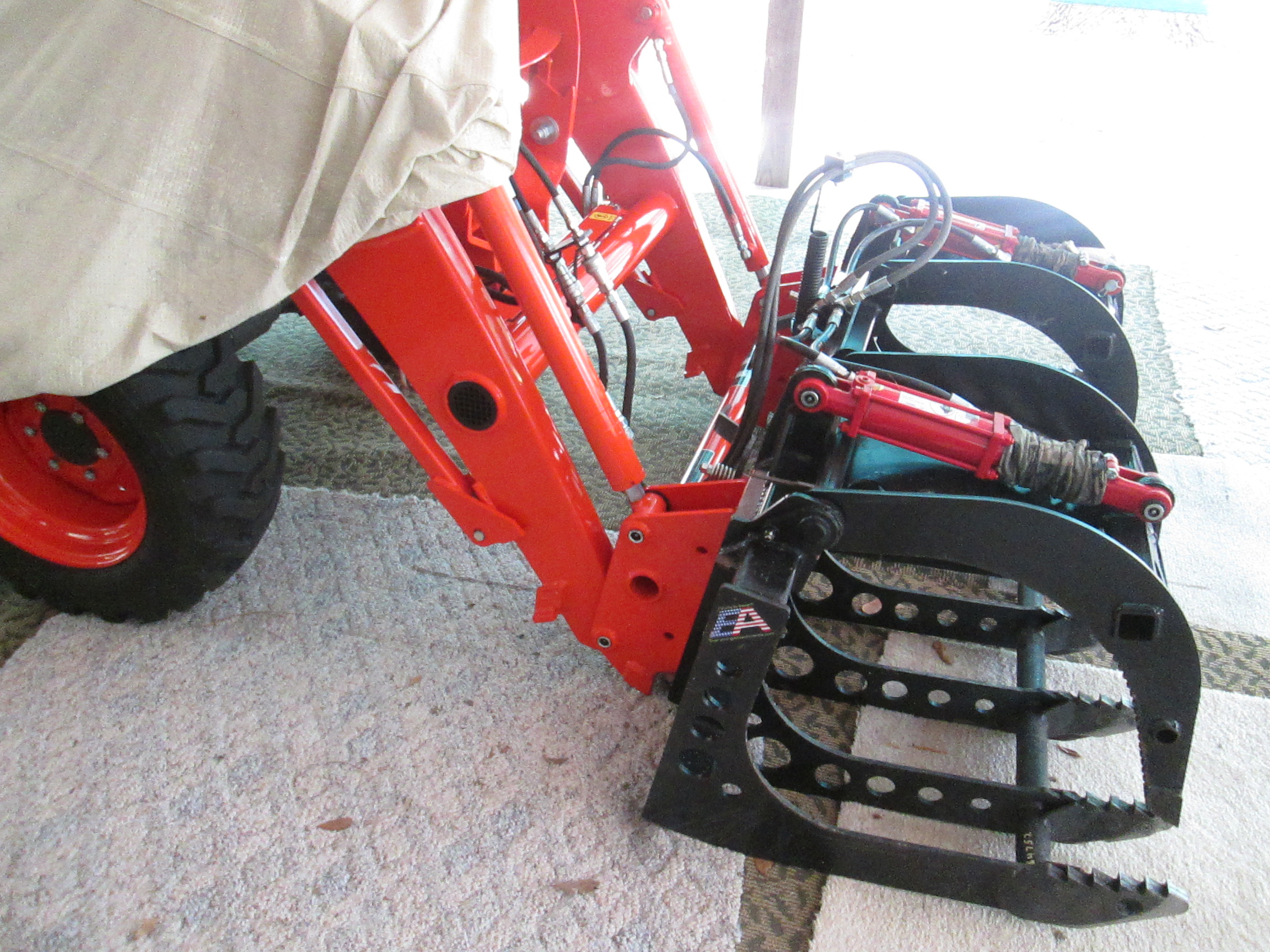

I would like to see the Tool Box upgrade, What is covering your hyd cly shafts and why ? Thanks
   / The WICKED Root & Debris GRAPPLE!!!!!!! #3,264
The hydraulic cylinders are wrapped with oily rags to keep the from rusting and to protect them from getting damaged/scratched... It would be difficult/inconvenient (almost impossible) to store the grapple-bucket without leaving the cylinders exposed...
Attached are 4 pictures of the steel-tool-box retro-fit and 1 small plastic original... I did not take a pic with ALL my tools in it but in addition to them it also holds a full-size grease gun and if I leave the lid open it will hold my small STIHL-Pro climbing-chain-saw... NOTE: I ordered/installed an additional mounting bracket, the tool box is secured with 1/4" rubber-sandwich (between the 2 rear brackets AND on the bottom) and 1/4" rubber matt inside/lining the bottom (this rubber matt covers the 2 bottom mounting bolts)... I hope this is clear and helpful...

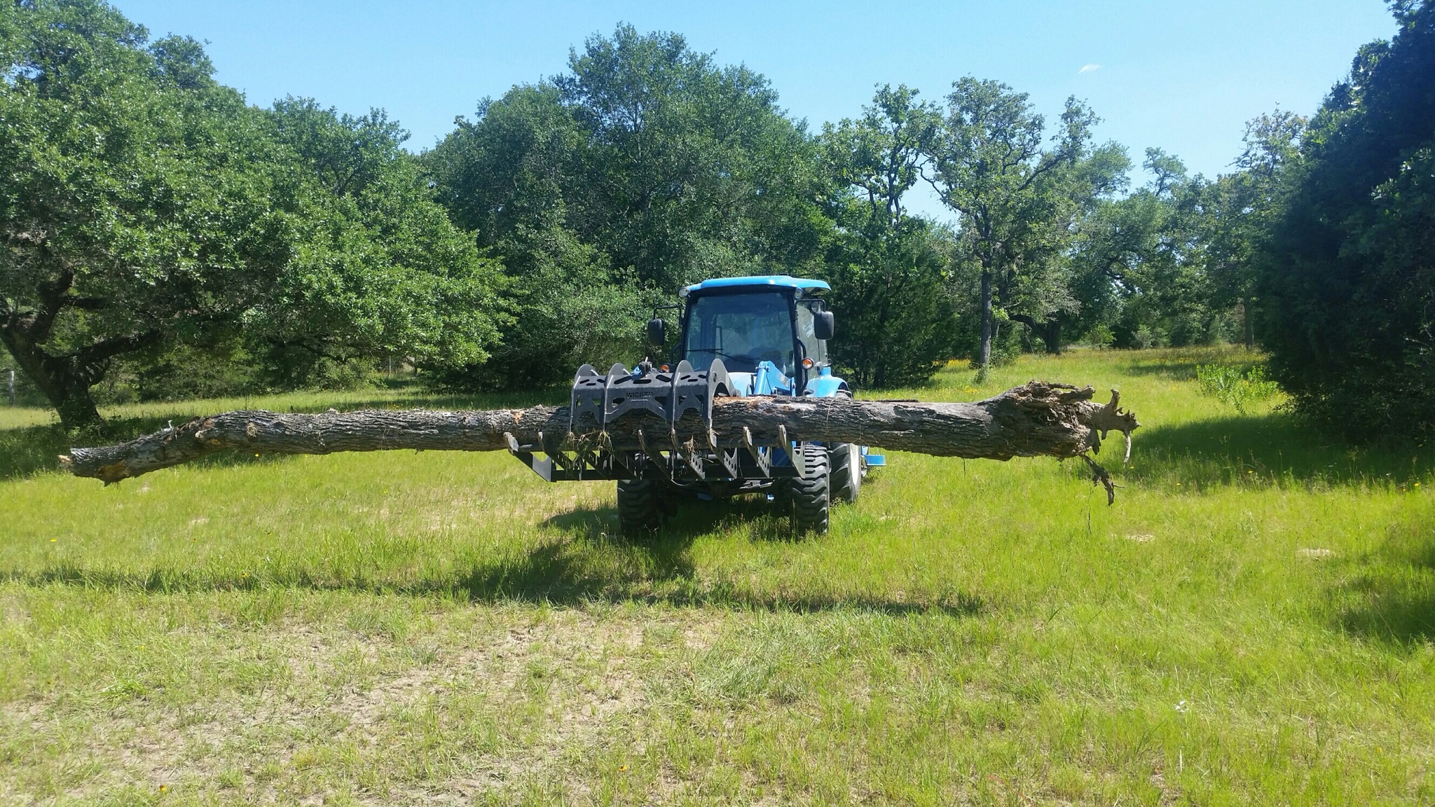

This was lifting our back wheels off the ground
so we just repositioned it for more chainsaw work.

Awesome! Man, I know it takes a LOT to lift that tractor's back wheels off of the ground!!

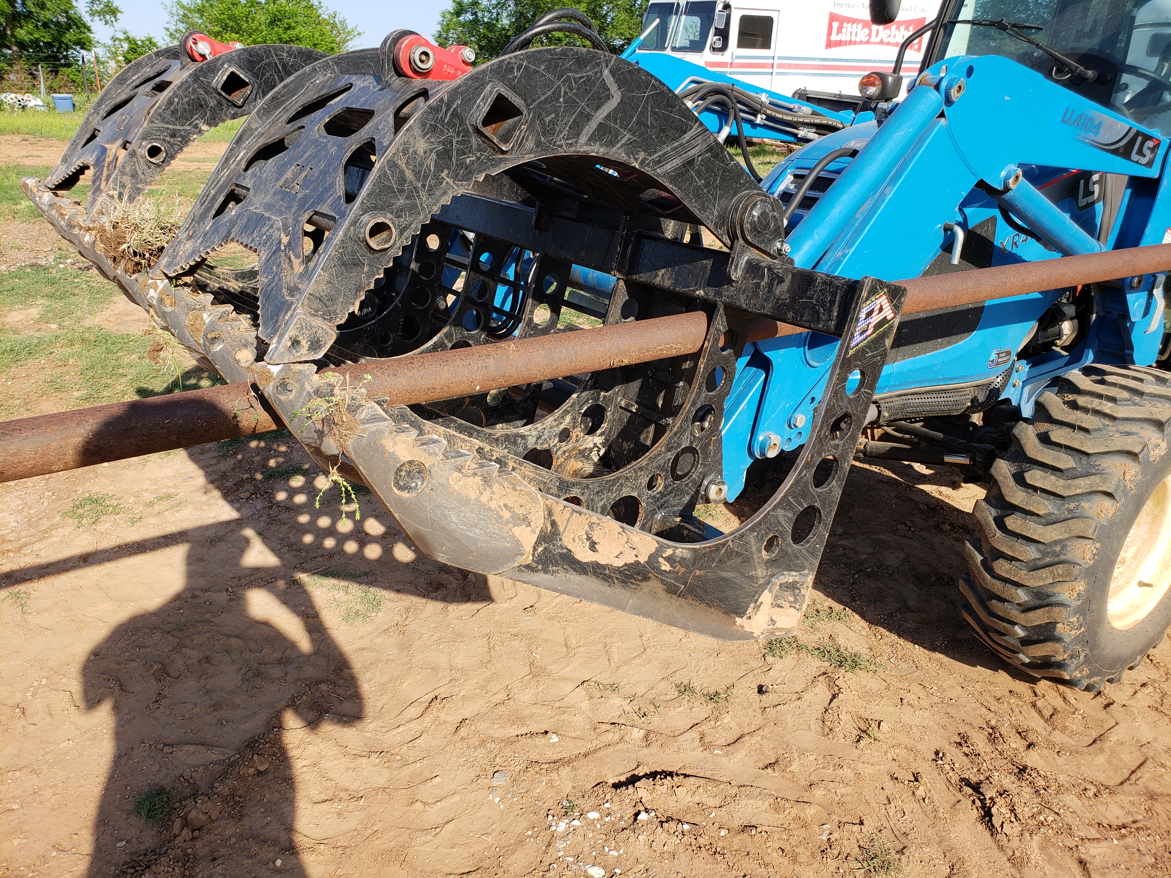

And speaking of uses for the Wicked Twin here's yet another. I needed to move this 30' pole to the back and there isn't 30' of width to get back there. So I was able to get under the end of the pole and slide it through the Wicked Twin until I could pick it up and walk off with it. To get if off I hooked it on a cross tie and back away. Be careful hauling like this, keep the pole down beside the back tire or it can hit your fender. Also lifting it up too high will hit your turn signal.
Here's up close how the pipe went through.
   / The WICKED Root & Debris GRAPPLE!!!!!!! #3,275
