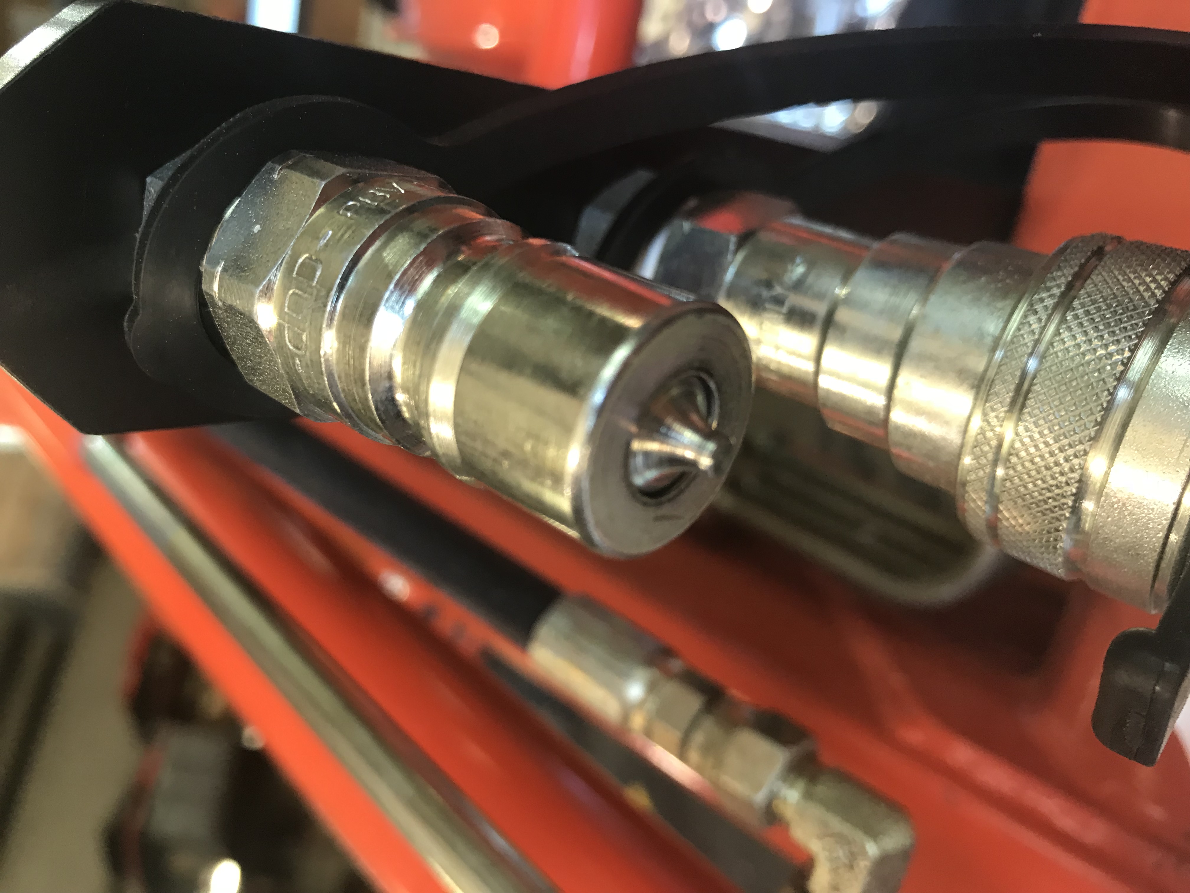

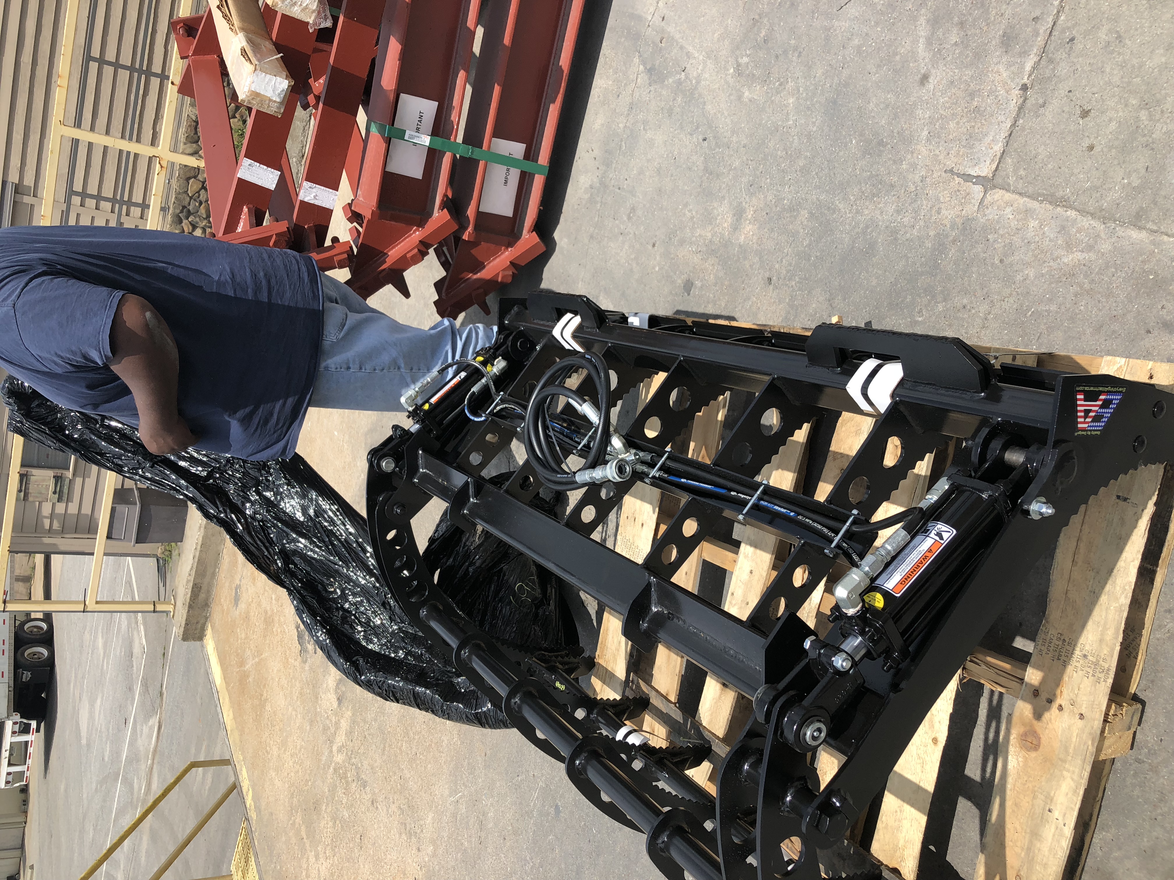

Now on the dock at the yard. The guys have looked it over and accepted it. Not sure when it will get brought down to me. Might be tomorrow... might be Friday... who knows. But its close!
From the pictures as best I can tell those appear correct quick connects. See my W R Long third function pictures also attached.
Sweeeeeeet! :dance1: Good times, easy work and a happy Kioti 2610 comin up!! :drink:
Yes, looks like we're spot on with the couplers. :thumbsup:
