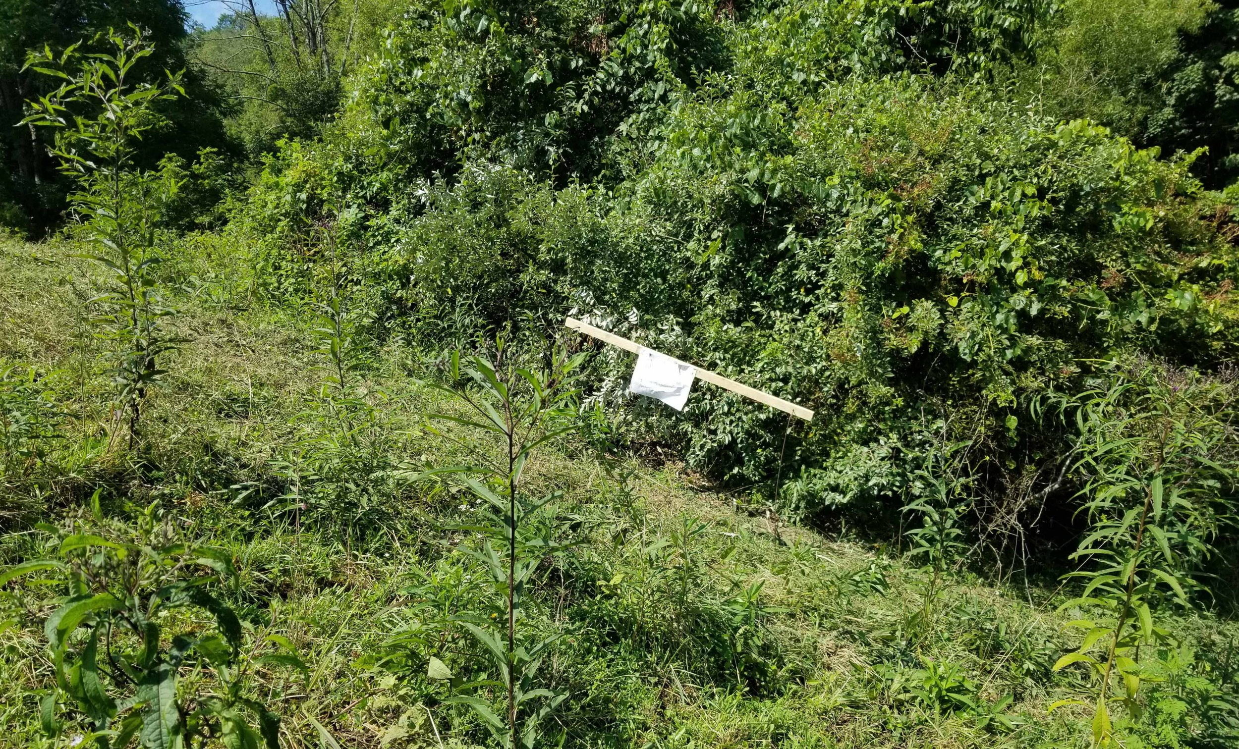

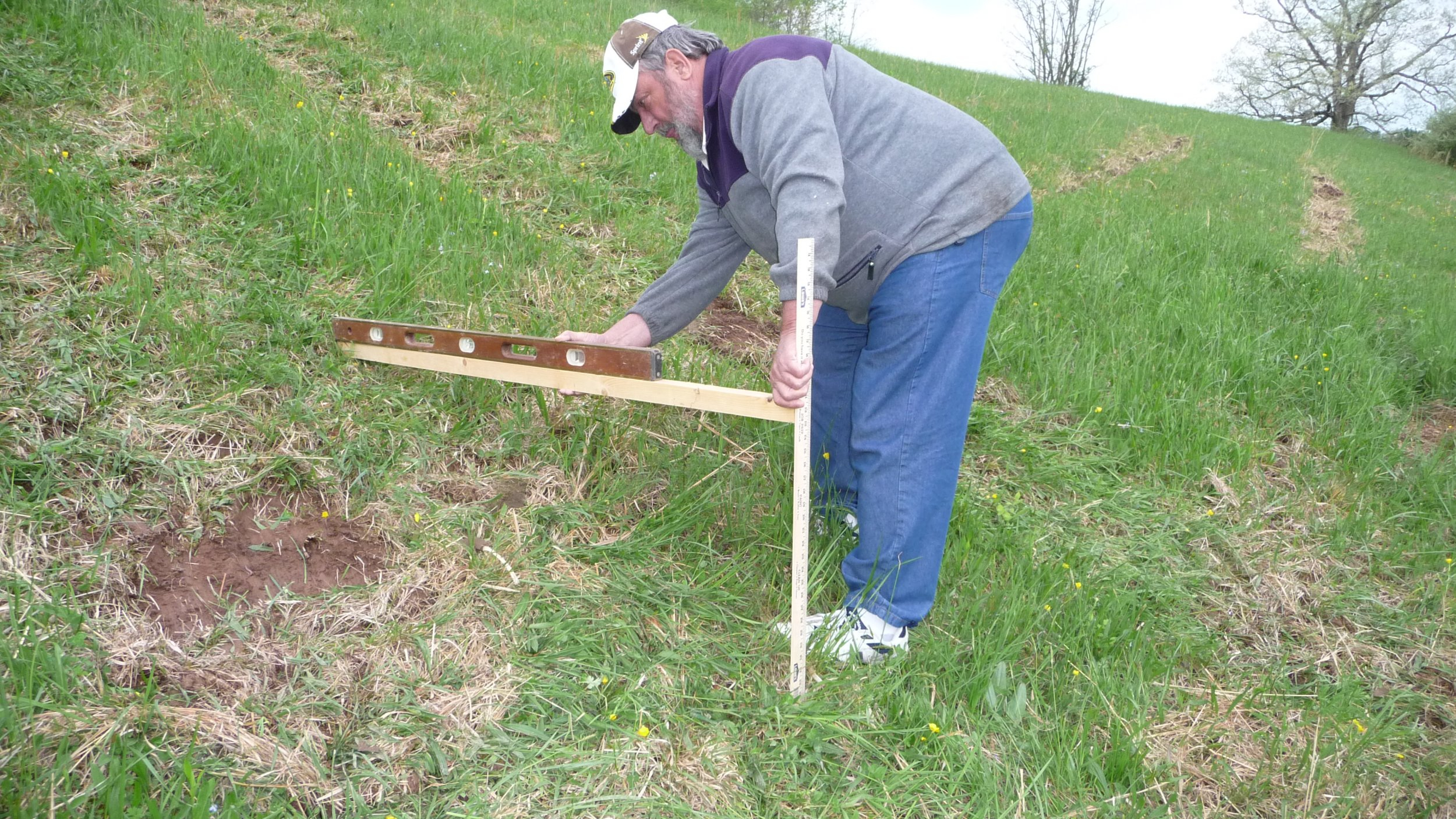

I made a incline measuring rig, just to verify how steep a stuff I was mowing, etc. On foot. Not used while mowing obviously. Weighted string serves to mark the degree/% of slope manually. And of course the old way of doing it...

Two important things. you need to determine the state of your land. Unless you are working on other peoples land, you should know what you are working on. Measure it. The lay of the land is very deceiving, what looks like 5 degrees can be 7 or 10. Know the capability of your equipment and know how you move that equipment over the land. For Instance, never go down a steep hill with the loader fully loaded, back down the hill, keeping the weight up hill. Mow uphill on steep ground. Once you have worked the land long enough, you will learn that the leaning feeling is just that and you equipment is capable without fear. Of course, take every precaution.

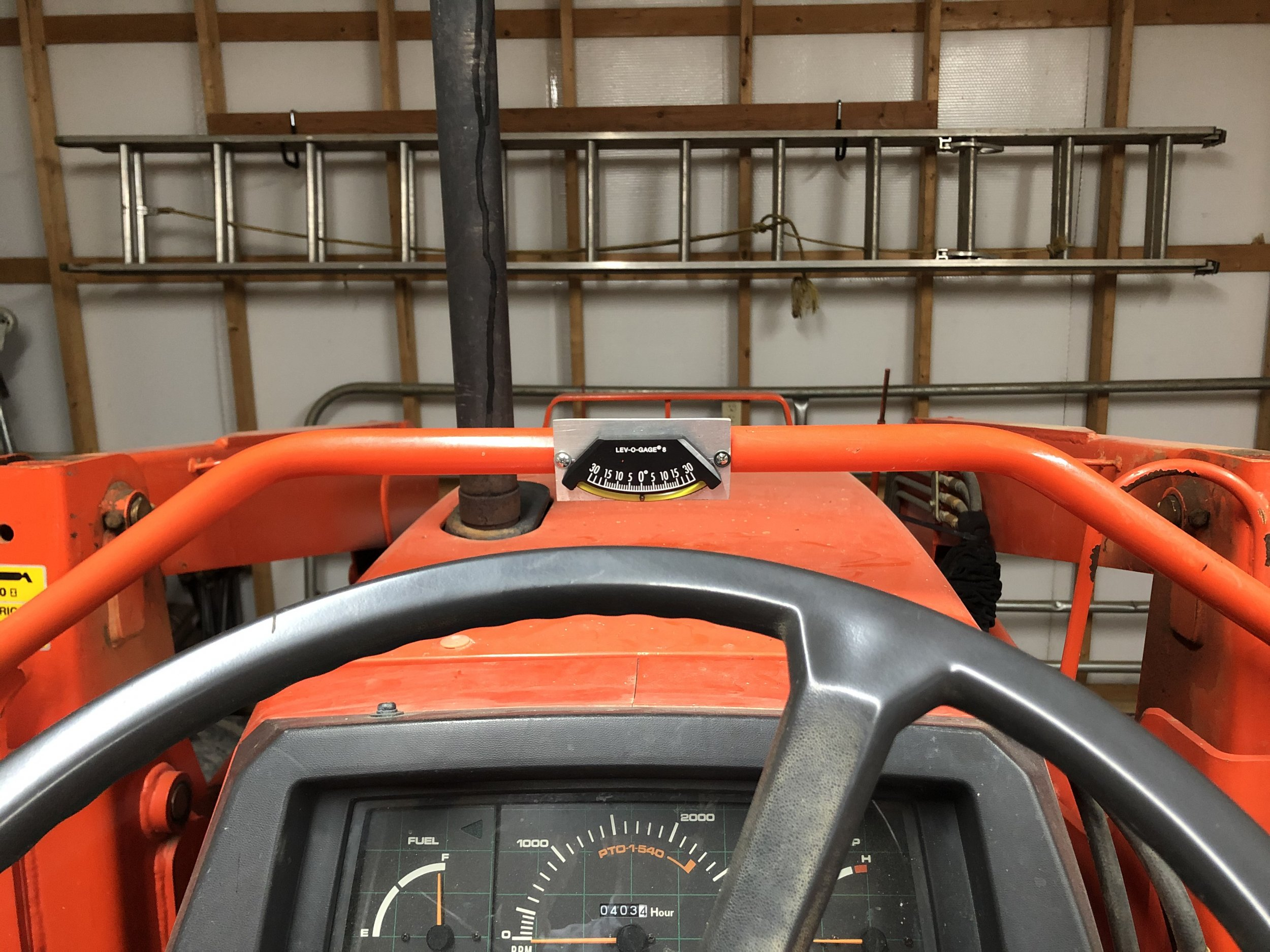

I’m in the same boat... I bought a very hilly piece of property in west TN. Very nervous about some of the areas that need to be cut. I put this on my Kubota M6800. It’s more to help me learn where my comfort level ends than to push the edge of the envelope of the tractor’s limits. I used rubber washers when mounting it to try to deaden a little of the vibration.
I mounted the same thing on my Side by side. I ride questionable areas in that first to see what the inclinometer shows.
