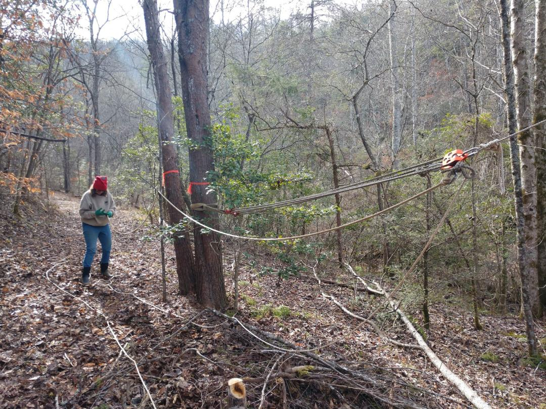

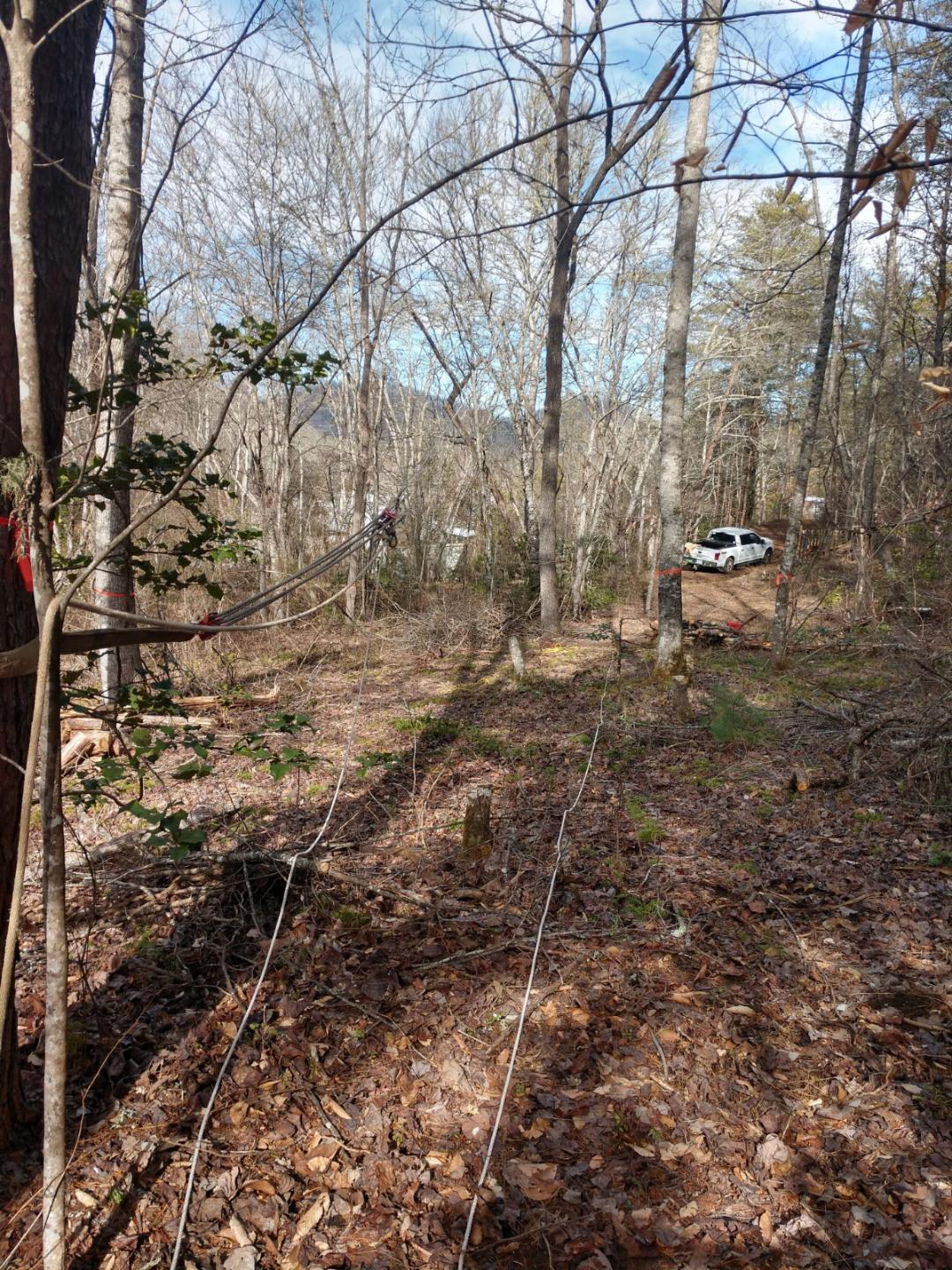

Thanks for the pics!!!! Are you wanting to clear cut this area?
Yes. where the pull-line is lying on the ground is approximately the old lane to the back of the property (complete with pine trees growing in the middle that the tackle is secured to…🤪) and to the left and right I want to grow stuff. Out of frame on the left (when looking at the pickup) is a little branch, so this area is always naturally irrigated.
lots of vine roots and thorny-stuff runner roots. . .

Problem is I do seasonal work from January to May, and we were all laid up with acute bronchitis all of December, so my the time I have time again, everything will be in full leaf and the ground will be muddy, and nothing will be planted . . . I may be plowing some weird disconnected furrows !!!
Ok, for a lower budget approach, lets break it down a bit. To satisfy the immediate need, a good size garden is 200 sq.ft per person. In your second photo, looks like a decent spot might be behind the truck, between the rope and water (assuming you can use that creek for the garden needs). Theres nothing wrong with breaking down your desires to fit into smaller steps. Get a garden established then open up more area a little at a time.
Have you created any kind of master plan for what goes where/when? Doesnt have to be anything fancy, but try to at least put it to scale, nothing worse than trying to fit a 40 x 60 building onto a 10x10 pad. :oops:
