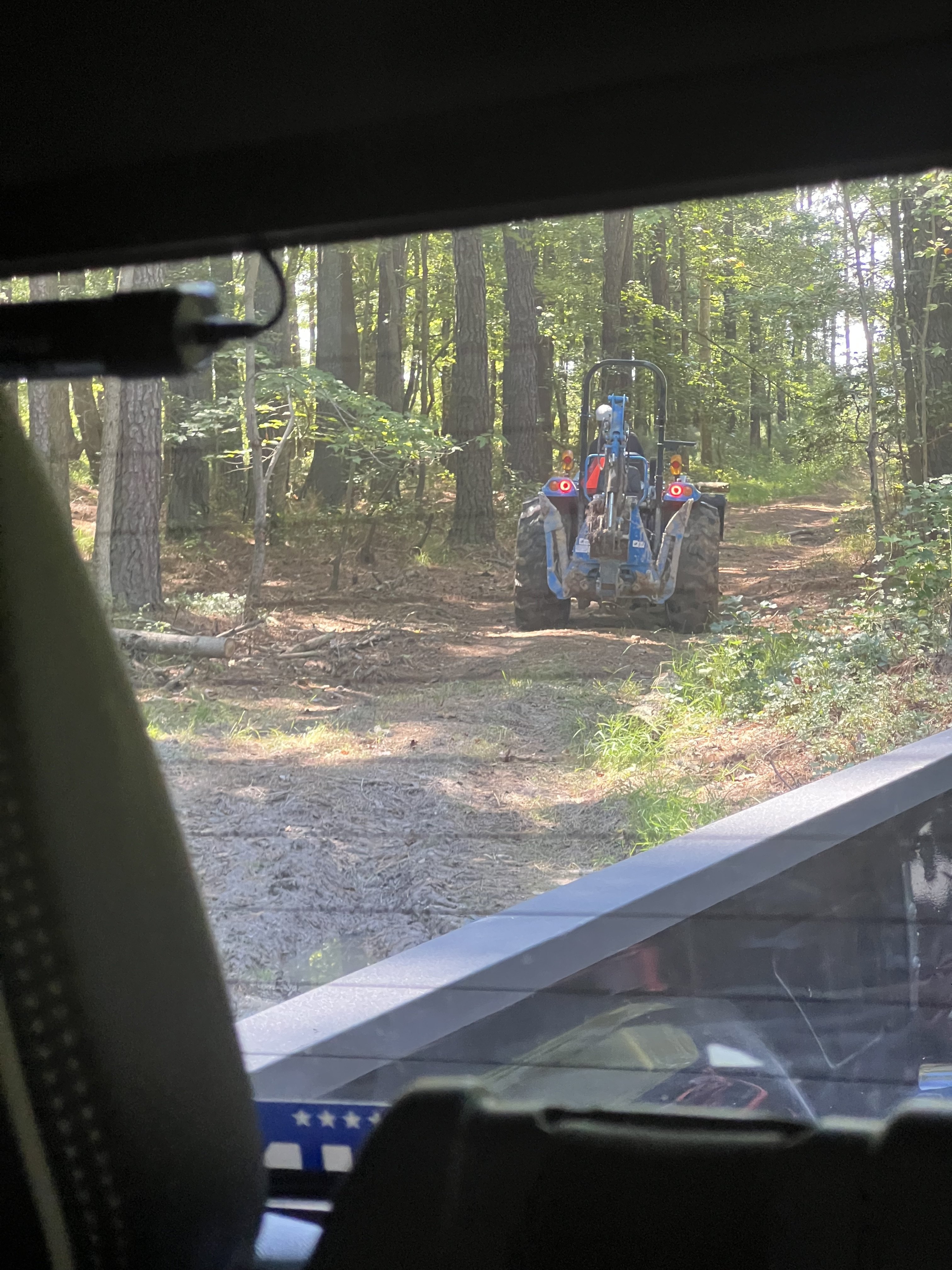

The 12K winch mounted on my tractor. BTW a snatch block doesn't change the pulling force unless the end of the winch cable is anchored and the snatch block moves with the load. If it is anchored to a tree it only changes the direction of the pull.

Then it’s not being used correctly. The block attached to the load of course.
/ Stuck, really stuck #84
you're right. The difference is if the winch is mounted to the same vehicle being pulled. If the winch is mounted on a different vehicle than the one you are pulling, the fixed/anchored snatch block just changes the pull direction.

It’s simple to remember that the block must be in motion to double the pull minus friction of course.
/ Stuck, really stuck #87
There are times that a redirect is required. And there are those time that a redirect of the cable through a snatch block does not increase the pulling power of the winch and the snatch block is being used properly for one of its designed purposes.
If the winch is mounted on the vehicle you want to move, the snatch block could be attached to a deadman location (such as a tree) the cable doubled back to the stuck vehicle or nearby anchor point. Thus would increase the winch’s pulling power, but the snatch block would not move as the vehicle moved
There are many ways to use a snatch block, some will increase the pulling power of the winch and others will not.
Redirects are a proper usage design of a snatch block as is the usage to increase pulling power.
If the winch is mounted to the tractor, and the cable goes out to a pulley mounted on an immovable object, then back to the tractor, that's a 2:1 mechanical advantage.
/ Stuck, really stuck #90
I don't think so.
- Winch mounted on a tractor, cable out to an immovable object is 1X mechanical advantage, or full pull.
- Winch mounted on a tractor, cable out to a snatch block that is fixed to an immovable object than back to the tractor is 2X mechanical advantage... twice the pulling power but half the speed.
The block does not move.
