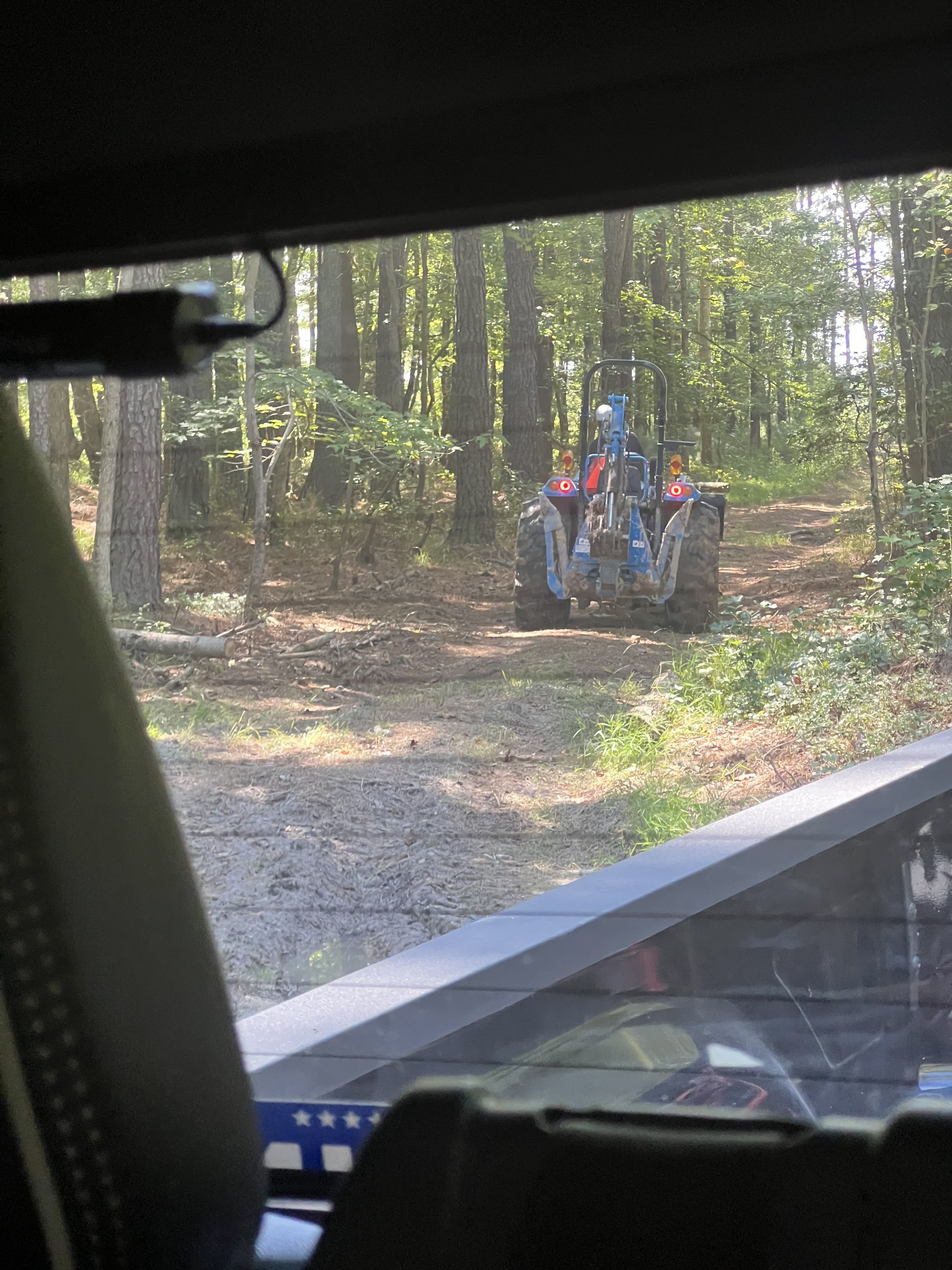

After seeing the picture of the hoe I can see why the hoe is useless to get unstuck. It's tiny.

Say you are sitting in the seat, what is to the right and forward? Any trees? I ask because if you can pull lightly from the righthand ROPS to shift weight to the high-side rear tire maybe an operator teasing it forward while the winch biases the weight can get it out. The pull coming also from forward will help it not fight itself. Can we assume that you can lock both rear wheels to drive together?

Warn 12k, snatch block and yanked right out (well, twenty minutes).
