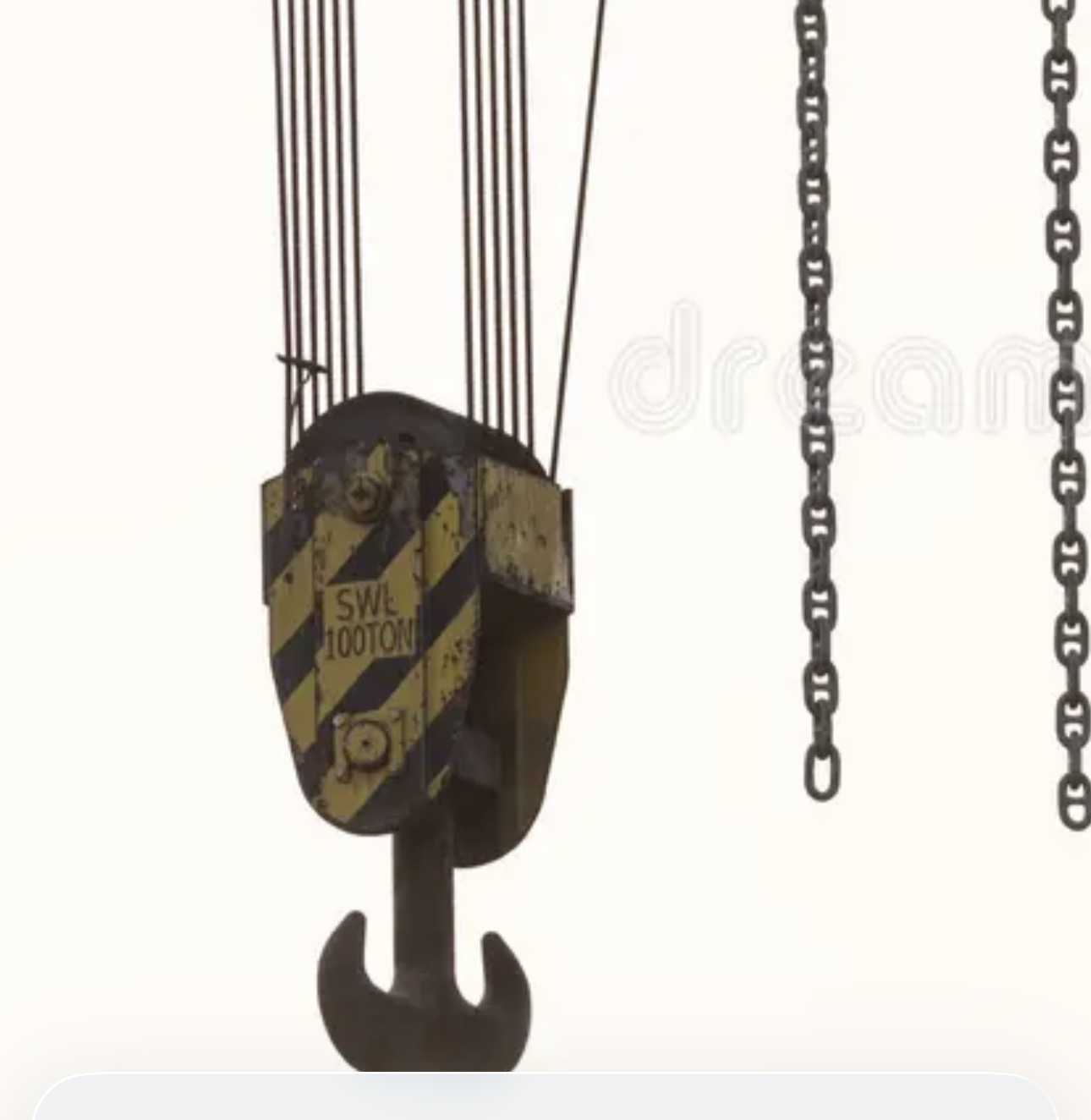

We had lots of stuck trucks with the utility company drivers. Ten wheel drive trucks with big winches (hydraulic drive no voltage and amperage concerns) were the rescue vehicles. I still have a rope block in my shop mezzanine triple pull. Don’t ever use it as my 36’ Gradall handler has a decent winch.

I can hardly wait until somebody brings up using two snatch blocks. Or three.
The amount of confusion about using just a single one is amazing.
This is true. There are all sorts of sites that show how to use snatch blocks as well as plenty of YouTube videos. Folks just need to look and learn.
