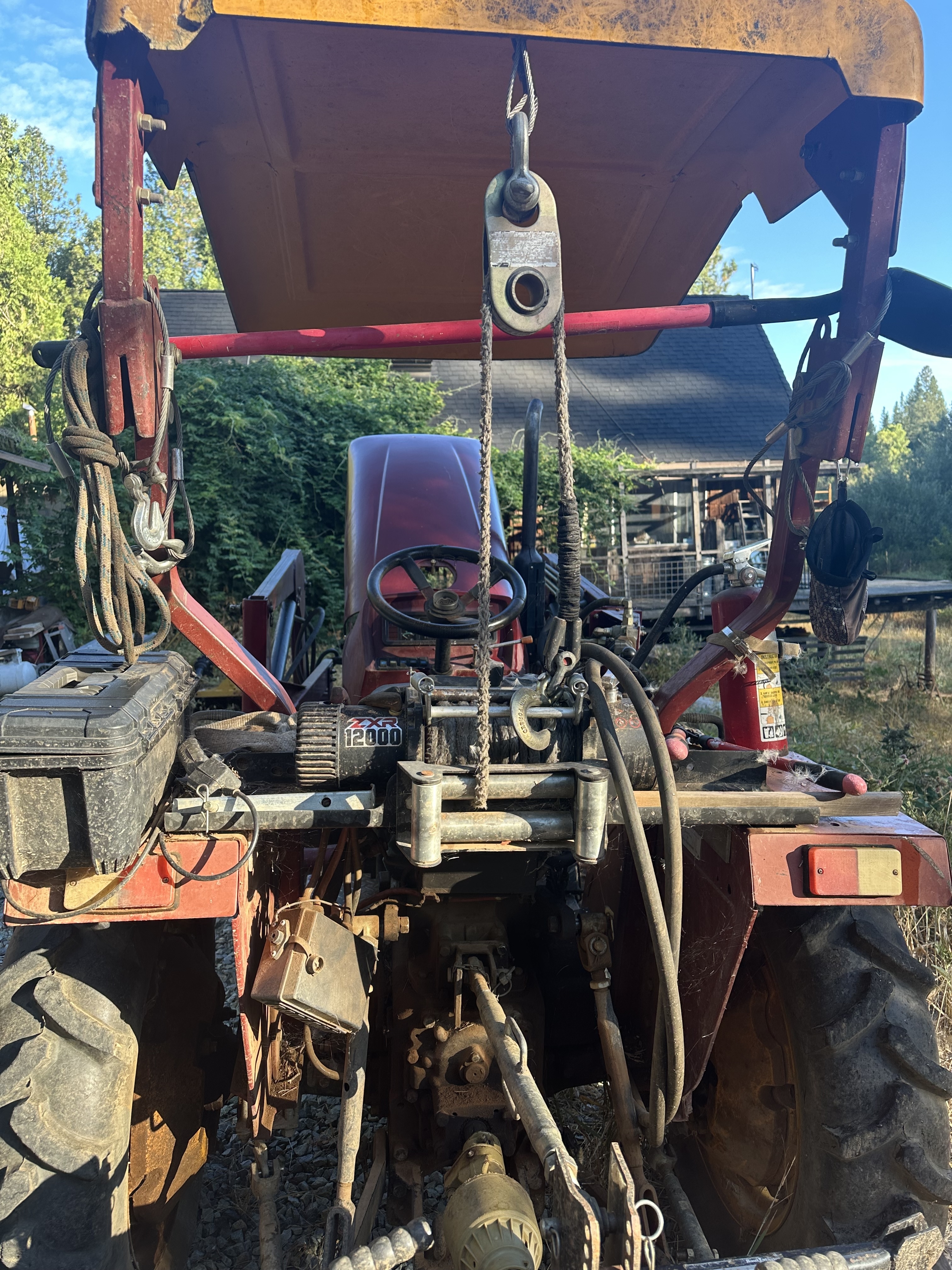

I got stuck near the creek in very muddy soil. 4WD and all four slipping. Added a Harbor Fright 12,000 pound electric winch to the rear Roll Over frame, working shin deep in the mud! Unstuck!

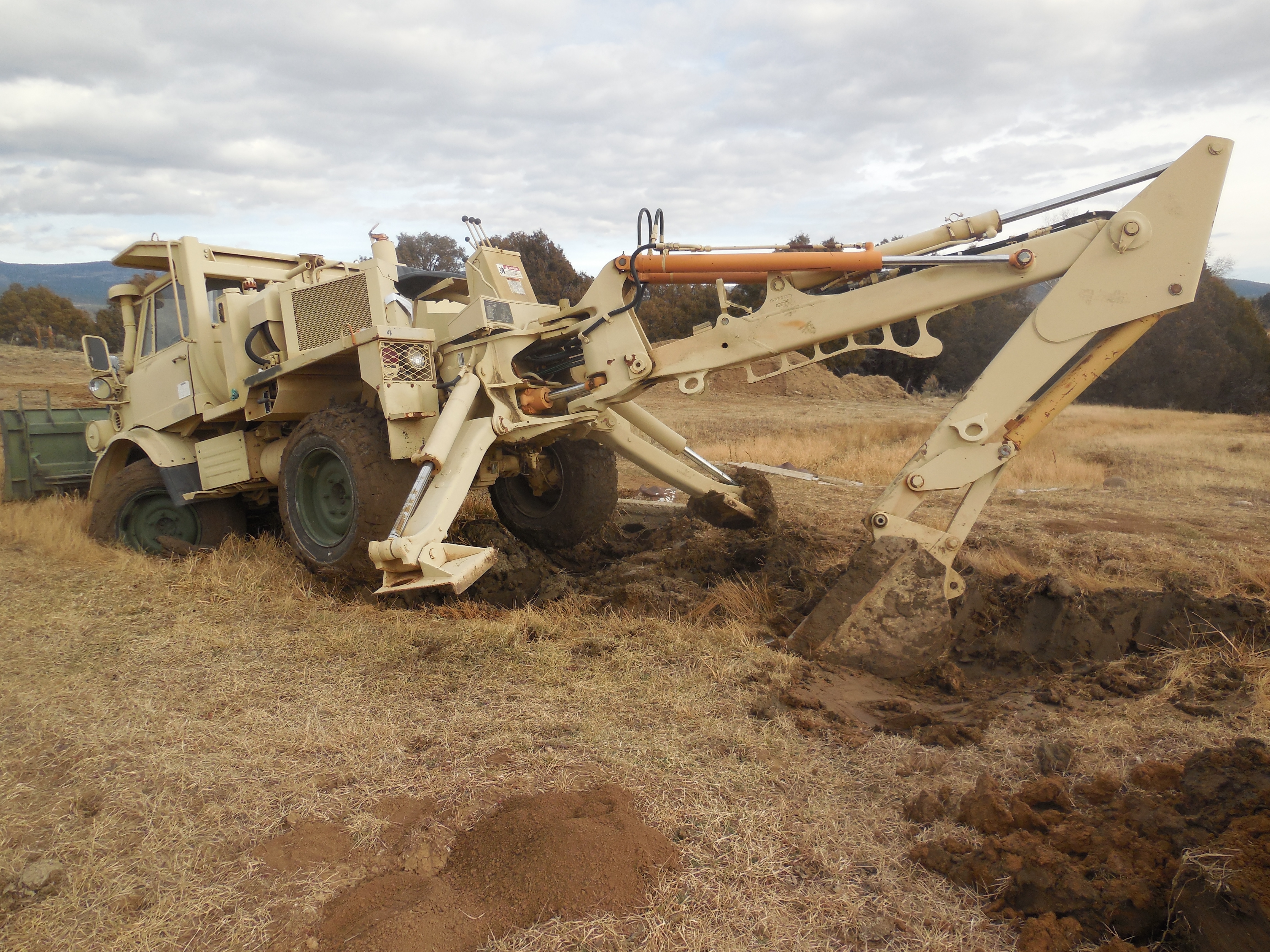

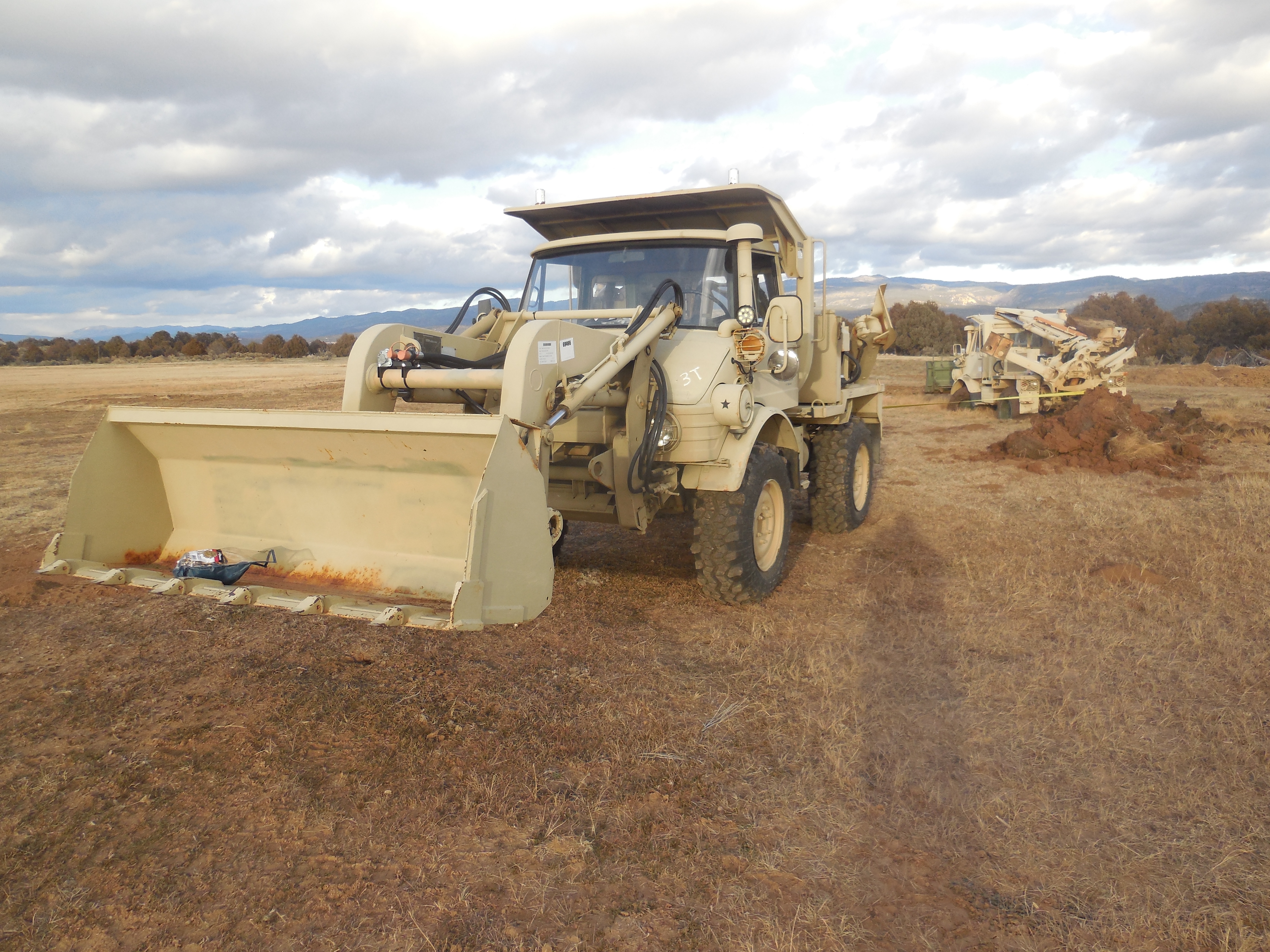

Stucks happen.
What worked against me in this case was the long travel suspension, making it quite hard to lift the rear out. It kept slipping back into the holes.
Another drawback was having the dozer blade installed. Instead of being able to lift the front with the bucket and slide on it, the blade dug in when the rear was high enough.
Oh well, pulled it out with the other one. Now there's an 18K winch on the stuck one, which would've allowed me to winch while driving it out instead of pulling dead weight.View attachment 4036223View attachment 4036224View attachment 4036225

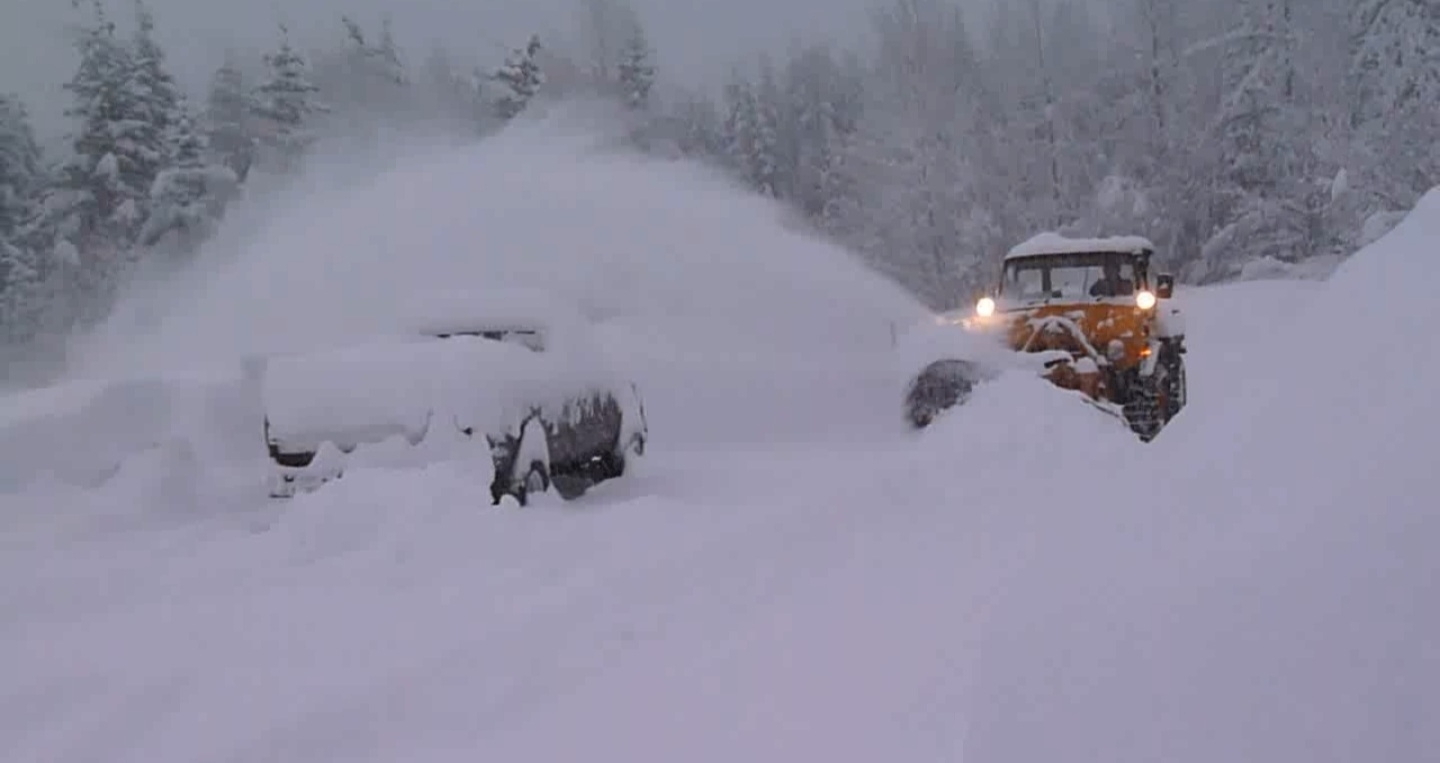

Love your Mog, put a blower on mine, don't do much farmin' up here.

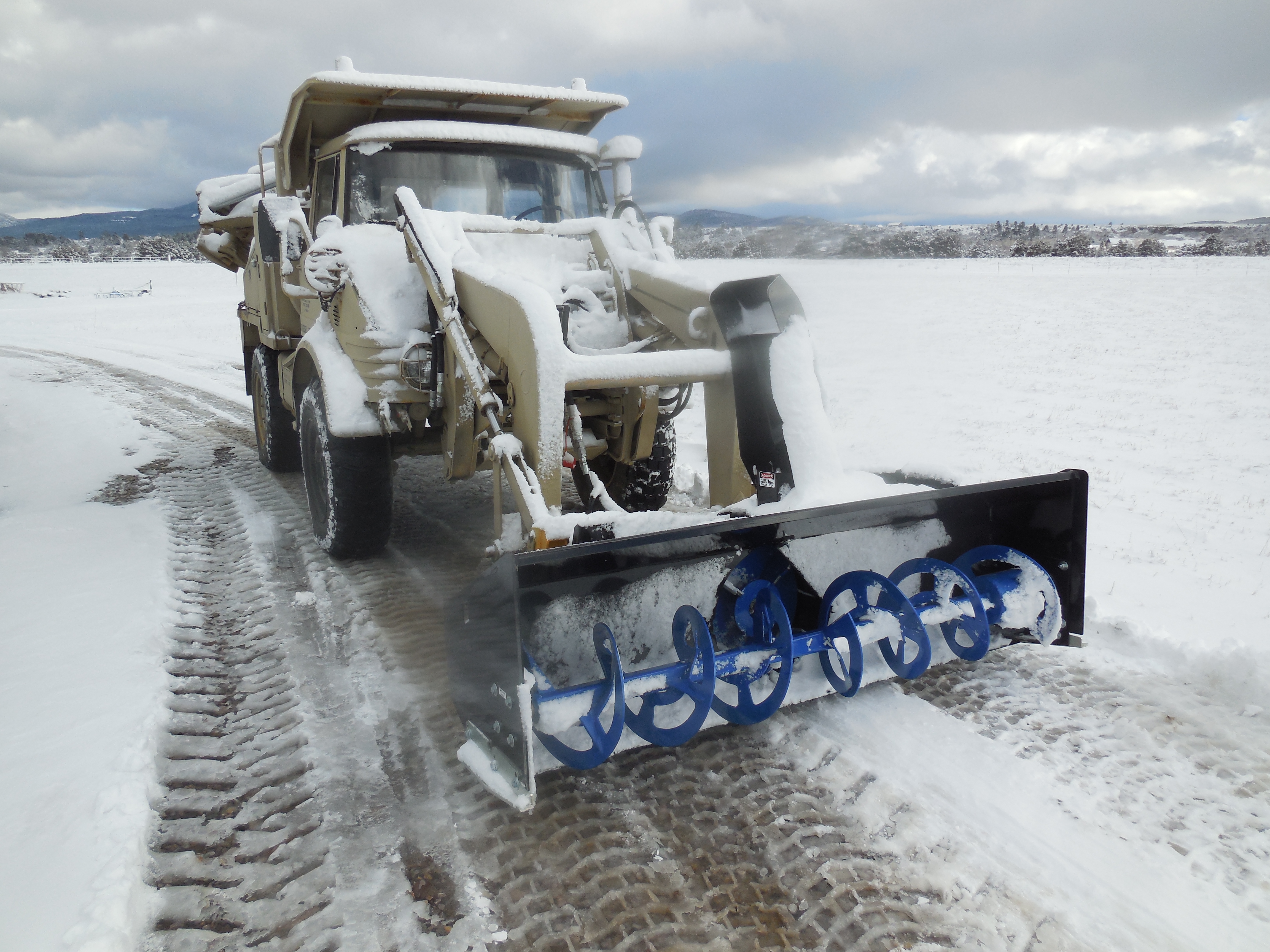

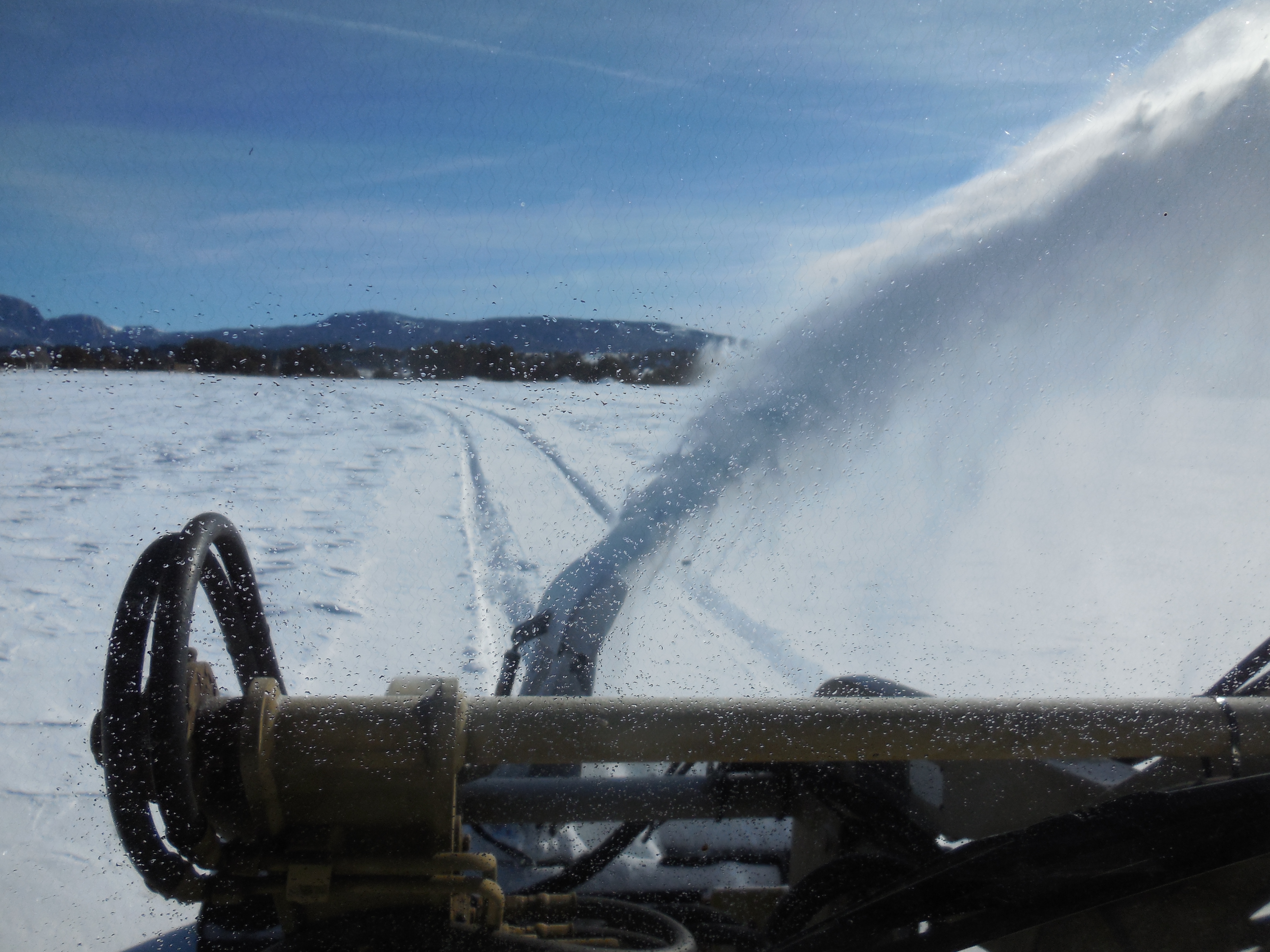

/ Stuck, really stuck #66
Nice! I ran a 'blower on my first FLU419, the one that was used to pull the stuck one out, until getting a skid steer to run the 'blower.
I miss the heated windshield, it made things much easier than the simple wiper on the skid steer.
