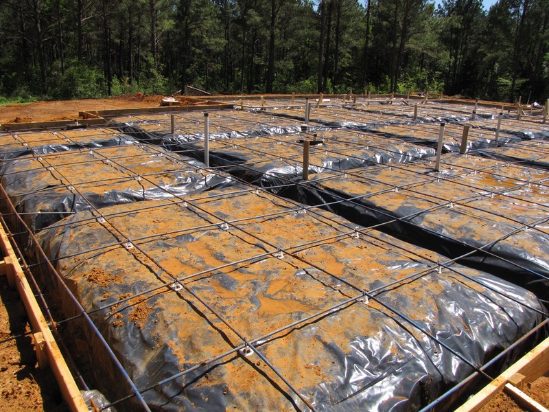

In an earlier post I implied that there was no foundation for the block walls, I was wrong. Here's the foundation just before the concrete is poured. The square closest to the camera is pretty much where the storm room is. The slab has 12" wide x 24" deep footers around the outside and 12" x 16" internal beams. The blue is the reinforcing cables and are about 3' apart which varies depending on location. I've heard of Post-Tensioned concrete used in commercial buildings before, but this is the first time I've seen it in residential use. I really like it. The concrete does have cracks in the slab which started showing up a week or two after the pour. (The concrete here is not that good and DOT will not use it for anything and the one company is the only one within an hour's drive.) The foundation company lets the slab cure for several weeks then comes out and tightens the cables which closes the cracks and keep the whole slab under compression.
The foundations the builder does is one of the best in the area. I know this post on the storm room does not sound very good on the storm room, but that is only one part of the house. He learns from his mistakes and he's said he'd do the next one differently. Unfortunately, he learned at my expense on this one, but I benefited from his experience in other areas.
   / Storm Shelter build #26
Very nice. A huge pet peave of mine, and a red flag on everything else that's done, is not seeing chairs under the rebar. Nice to see they used them on your foundation. Seeing that you have red clay, I'm surprised that they went with beams under your slab. I know that's done in the DFW area where it's all black clay because of the amount of movement you get in the soil, but red clay is so stable that it's never an issue up here in the Tyler area.
On the FEMA plans that I'm familiar with, and I didn't open your link to see if it's the same plan, they want the rebar bent and tied into the footings in the slab. Then you lower the cinder blocks over the standing rebar. I did my swimming pool this way and it's a HUGE pain, but worth the effort for the amount of strength it provides.
Cracks after a pour are from too much water. Adding water makes it easier to spread, but then that volume that the water creates is lost to evaporation and curing, leaving a void in the slab. Cracks are created by that void.

#27
They were supposed to put the rebar in and told me that was the plan, but then didn't do it. They ended up drilling holes and epoxying the rebar into the slab.

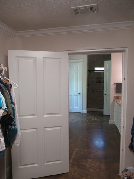

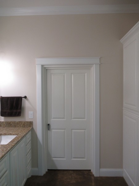

Ok, here's the finished product photos.
Here's the inside looking out. That HVAC vent in the ceiling is a return air vent (air moves from the closet to the intake of the air handler) and the supply vent is above where I'm standing. You can see some of the wood graining on the ceiling. That ceiling is simply painted concrete. They used Hardie sheets to make the wood grain in the concrete.
and the door will open almost against the wall (165* according to mfgr). Mine won't go quite that far because of the drywall in the way of one bolt (which I may adjust later).

I see the door has 4 hinges but how many cogs seat into the other side of the door jam? Is it 6?
